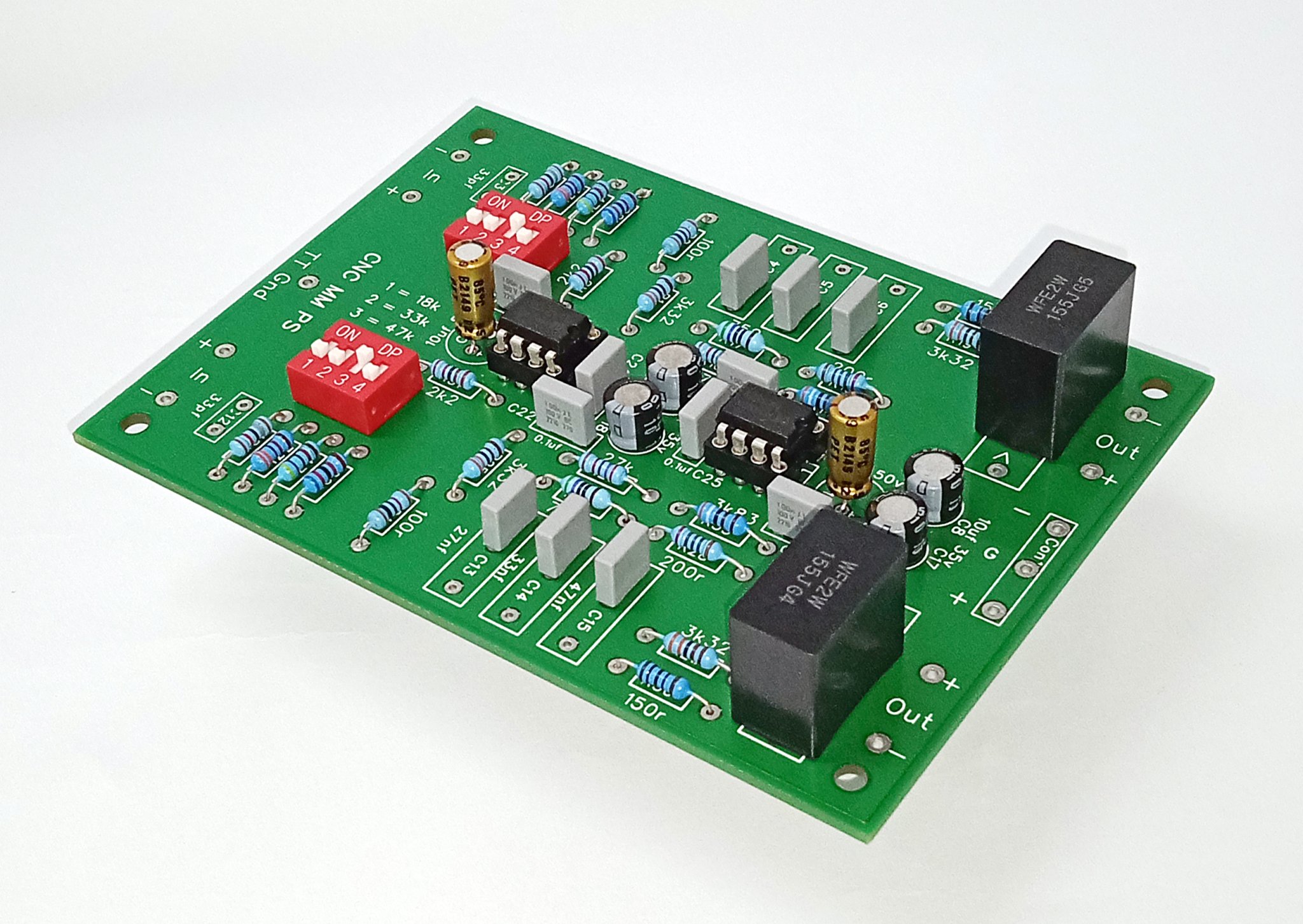

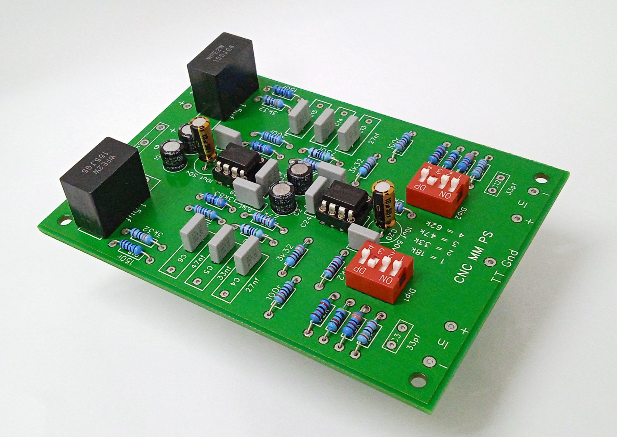

Hi Sachu, I have a CNC in my second workshop system, however to to the position of the speakers, I cannot balance the system with the gain dip-switches. Is it possible to put a variable resistor in there place, as is done with the AD797 MC phono amp.
Cheers
Hi Derek
You can use a variable resister for gain there. There are total 4 gain resisters 2x100R and 2X150R.
If you decrease 150R to 100R or even lover you can get additional 2-3db of gain, increase them to 200 R or more would decrease the gain. I would suggest to use some kind of connectors to swap resisters.
Regards
Sachin

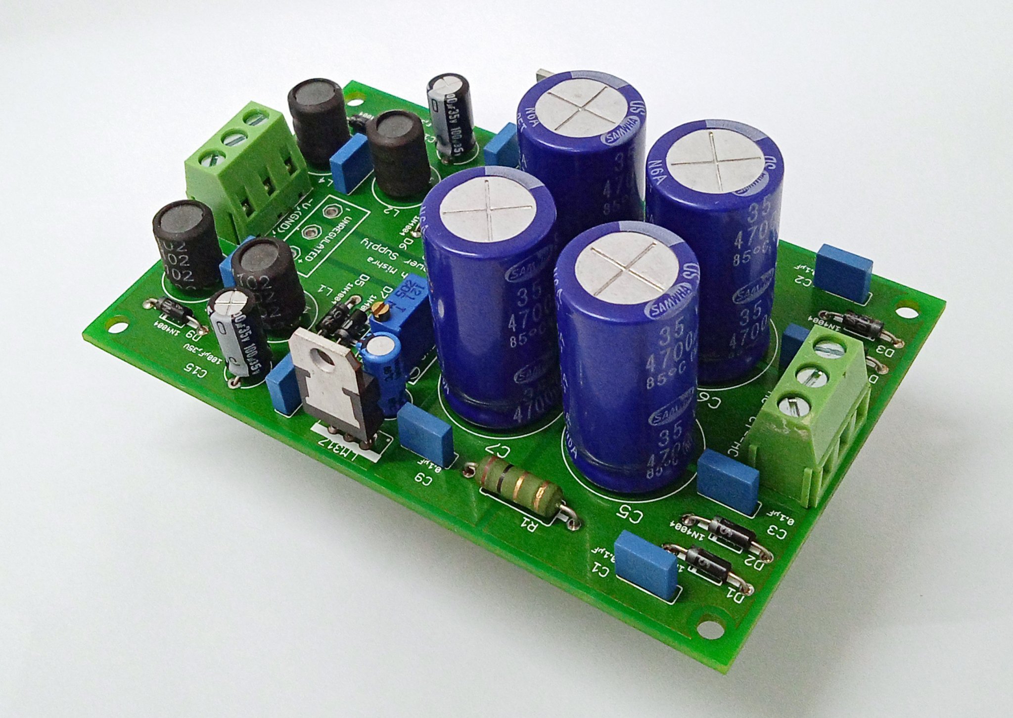

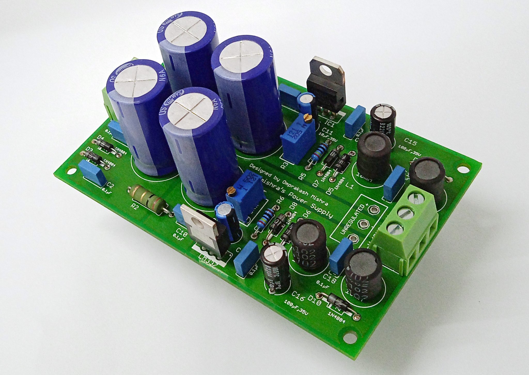

Got another kit from Sachu888. As my earlier board was sold (Preamp). Sharing some pictures. My this build has some nice quality parts.
Waiting for transformer to test.Thanks Sachin.
