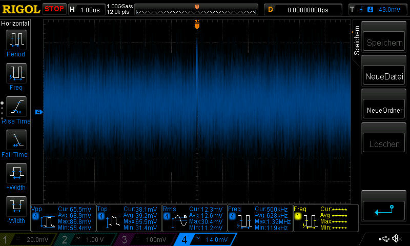

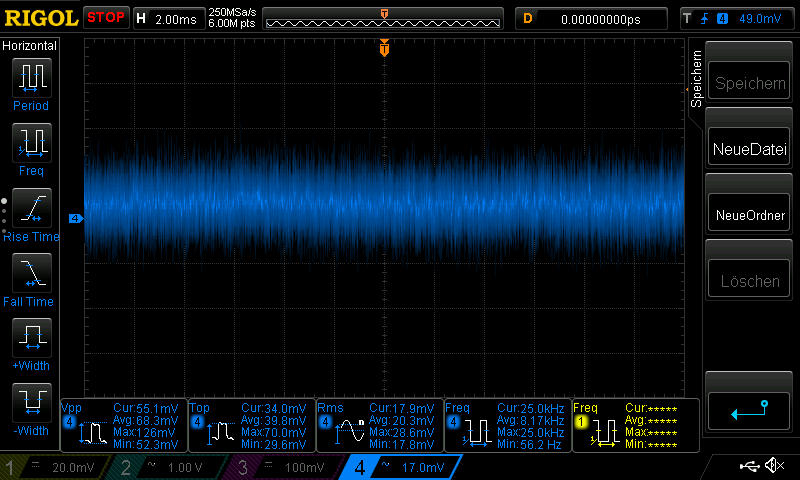

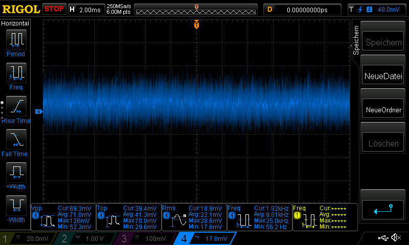

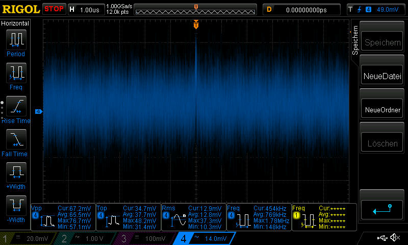

Good evening
i am impatient.😉😀 so i mod my board. i put out the ams1117 and use a origin LD1117..i use instead of the original 470µ sanwa at the output a 22µF 35V nichicon.
pic 1+2 no improvement...same noise...this is what i expected. pic 1 with adum4160, pic 2 without
at the crystals the beads where ready as wrote before: C18, C21 and C23
i use for each 10nF ceramic which i had at home.
pic 3+4+5 with adum 24/48k, without adum 24/48k, without adum 24/192k
much better🙂
noise at amp dac on 24_48k_highres resolution with adum4160 with LD1117 and 4,5nF and XO 10nF ca.jpg87.6 KB · Views: 214
noise at amp dac on 24_48k_highres resolution without adum4160 with LD1117 and 4,5nF and XO 10nF.jpg87.7 KB · Views: 209
noise at amp dac on 24_192k_highres resolution without adum4160 with LD1117 and 4,5nF and XO 10n.jpg88 KB · Views: 215

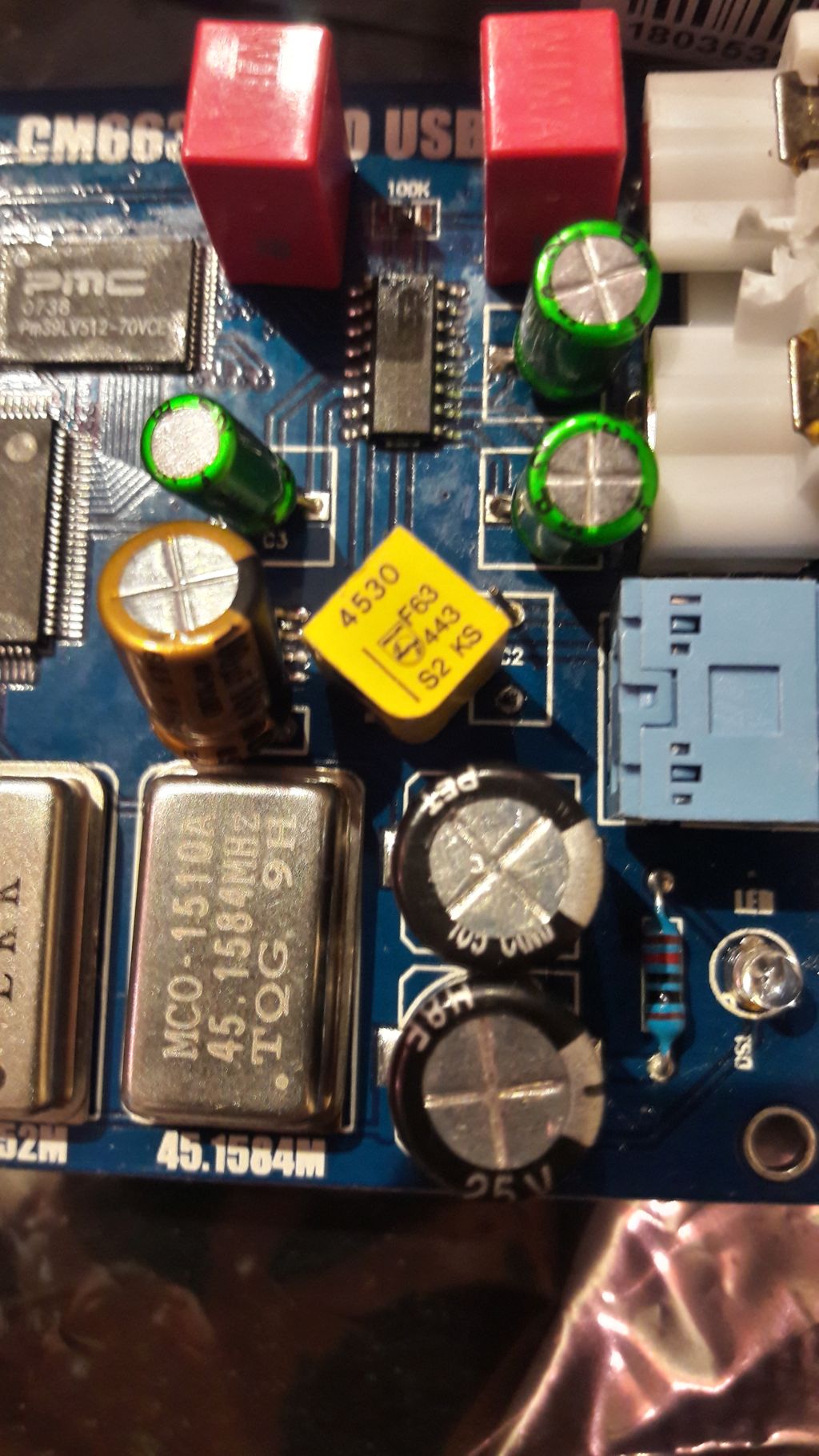

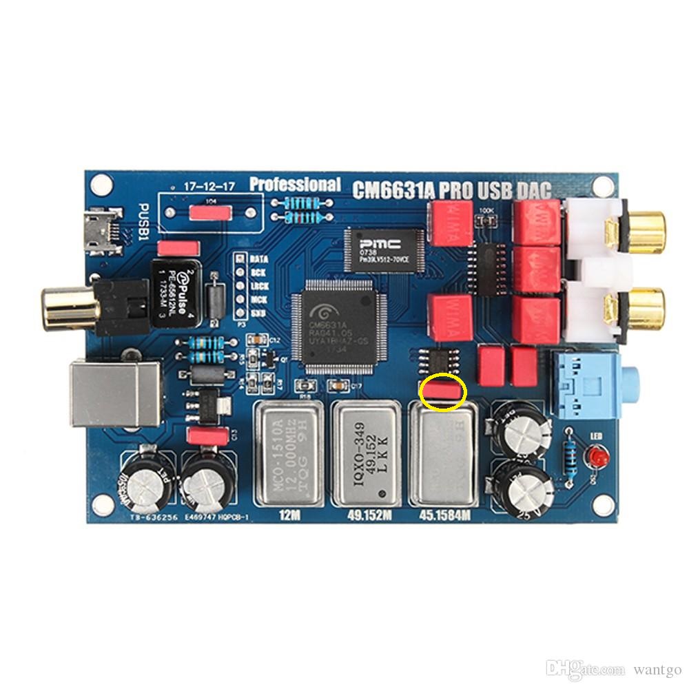

...modification part 2...
Hi
i am impatient...😀
here is the pic of my next step:
yellow cap is the lucky found in my box - for Aoutl L+R 4,5nF 63V poly?
one cap upside the other cap is other side...no space here
left bottom the nichicon ufg 100µ/25 for the AVCC
left the green is ues muse (green) 10µF 16V bipolar for Vreg pin 6
right nichicon muse ues bipolar 22µf/16V for NEG pin11 and CN+CP pin9-10
jsut short test if its working....oh yes .............after 2 hours the green + yellow monster get better 😀😀

That looks like a Seimens KS polystyrene or maybe polypropylene, very good parts.
The polystyrene take forever to settle in the where the sound stops changing.
Might want to look up “burn in” and see if you think it applies to what you hear, if you haven’t already. Is amusing to see the different opinions at the least, no matter what you think about it.
Glad you found a good combination of parts.

hi phase
no...this yellow caps are with the lable "philips"...(4530 F63 443 S2 KS)bad picture...sorry
better pic....40pcs NOS PHILIPS KS443 8250pF 8.2nF 63V 1% STYROFLEX HI-END POLYSTYRENE CAPS! | eBay
this caps are not in use since 10-15years...so i will see. the other boards i will use the recommended Wima FKp2 4,5nF.
th other caps for Vreg, NEG and CN+CP i do not have any kind of the types as written in the threads what i read...so i try what i have at home and i know the green muse well. at my YJ tpa3255 boards i try this and i am always happy with the sound
regulator:
actually i plan to build 1 board with just "3,3V" low noise regulator. i look for the AP2114 because its cheap and low noise and has the same pin config.
my target is to keep the alu case...so this version with the yellow caps is not aim this...😀
soundcheck:
the frist minutes i was disapointed because the sound was strange, nearly everything comes from mid...no really soundstage but i know this from new caps and a sepcially from the muse ues...during reading and music was running in the background it was a small "burn in". i stopped reading threads and concentrate on listening....after 2,5hours ...it was a noticable big change in sound....its sounds "normal"...and the muse are start to glance.
chris
Ahh yes, I see now. They look very similar to the other ones.
I’m pretty sure they are better than most everything that you’d be able to find nowadays, they should be fine after all these years.

...2nd board arrieved..

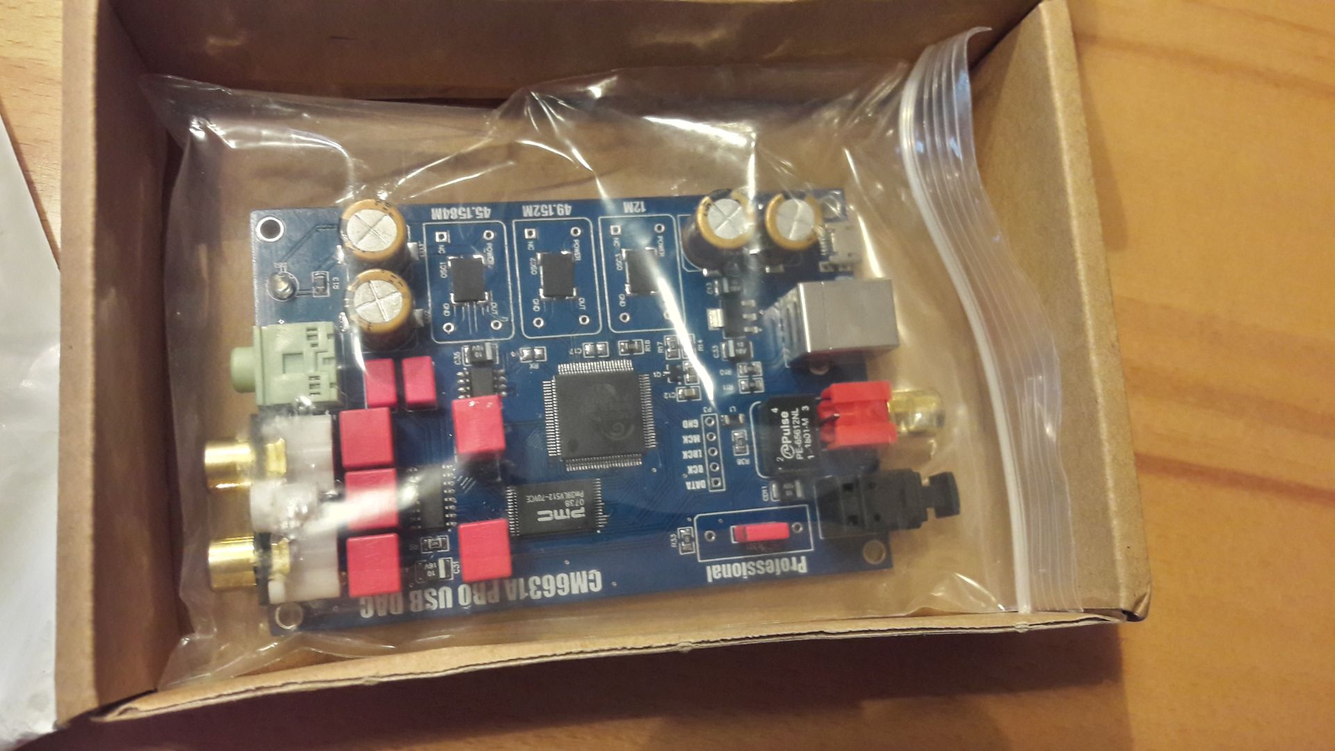

Hi
i got my 2nd board...on the pic you can see a different version.
my question is:
should i change this black crystals with the other Silver crystal which i still have from my damaged board for fair comparision? which are better?
thx
chris

I wouldn’t have the slightest idea which is better.
Maybe there are data sheets that could give you an idea perhaps before risking damage by swapping that many parts?

...sound check..
Hi
after the last mod i let the DAC "burn in".i have a separate room so i get about 30 hours since my last mod.
to make long short...
yeah!! this DAC sounds realy fine now!!!
i compared with my not mod D50 (-4dB...i read that in the forum) and with 24/192k setup. Tidal master recordings.
the sound is smooth and no nervous or "crying" sound comes out. i mean a had always 8 volume step between D50(louder) and the "cheeky" ES9023. but now its much more quiet and the difference is 4 volume steps. relaxing lay back sound comes aout...fine..🙂...yes the sound stage is not as deep as with the D50 but the rhythm and the tempo is really "well done"
i have to update with the better regulator 3,3 + the Mic5205...etc.
