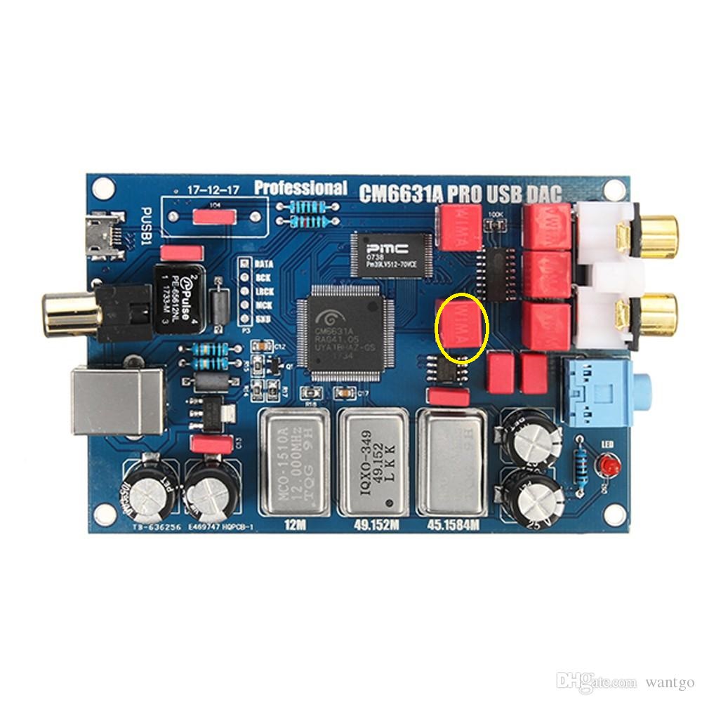

CM6631A + ES9023 cheap board - modification...?
Hi
i bought this board to have a cheap USB/SPDIf converter...more or less it lay around...the sound is not bad for that money !! (thx to abraxilato for that hint)
2017 CM6631A Digitale schnittstelle 32/24Bit 192 Karat Soundkarte USB zu I2S/SPDIF Coaxial Ausgang Unterstutzung Connect Decoder Upgrade DAC in 2017 CM6631A Digitale schnittstelle 32/24Bit 192 Karat Soundkarte USB zu I2S/SPDIF Coaxial Ausgang Unterstutzung Connect Decoder Upgrade DAC aus Verstarker auf AliExpress.com | Alibaba Group
before i start with mods on other boards i want to learn on this cheaper board:)
yes i go throug some other posts and foud some advices for the ES9023 chip....but i found nothing about my board.

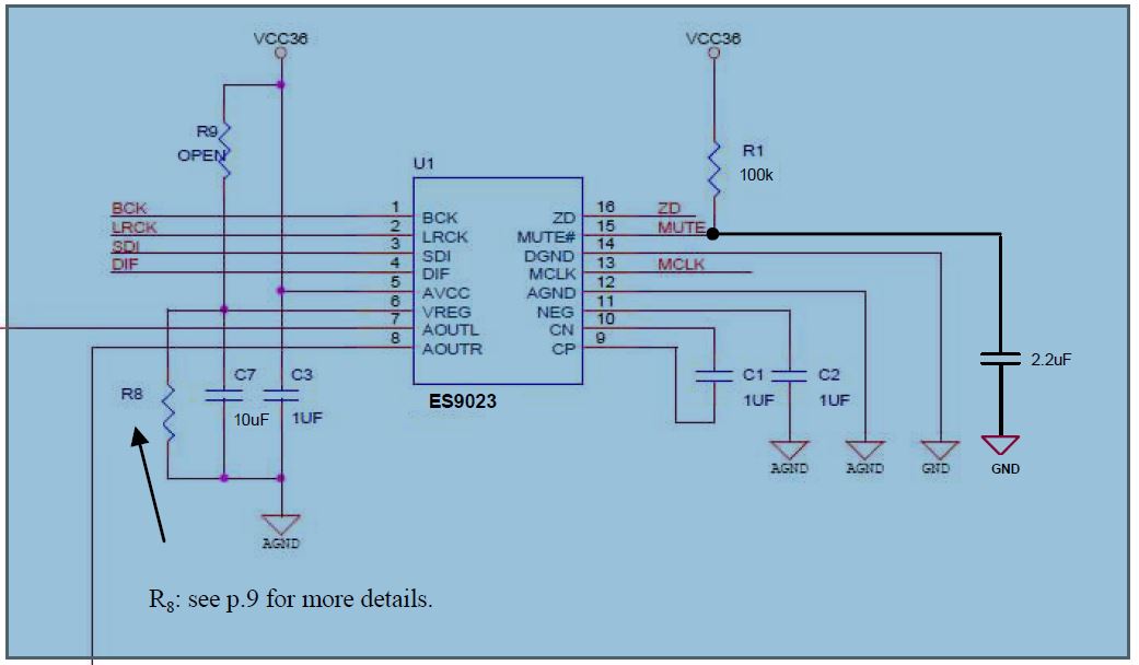

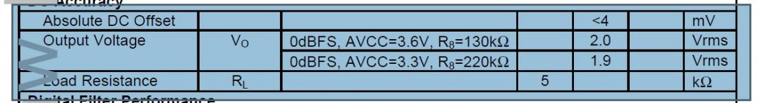

Es9023:

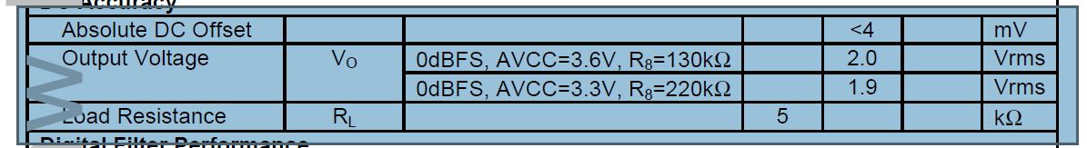

its on the board with 2 caps to GND (220/100 marked) and according to the datsheet (pin 7+ 8 Aoutl+AoutR) they are not needed so i move them. i had a 2nd board but after some cap changes i never works again....so i re cheked all caps compared to origin bought caps. so all caps are good and measure with my LCR some a origin WIMA. so the quality is fine. only these 2 caps at are strange (at 10khz i go 220 but ESR is"OL" and the LCR meet jumped to RP mode....) these caps are at the buttom yellow pianted...neverthe less you do not need it
pin 6 Vreg:
here i found on the board no setup resistor which recommended in the DS -R8 should set 130k (for 3,6V - 2Vrms output) or 220k (for 3,3V - 1,9Vrms output)...just a caps is there so what do here?
PIN 15 Mute: this is set to +VCC with the pull up of 100k according to the Datasheet...ok
the voltage for all chips on board comes from the AM1117 3,3V
shold i change this to AP2114 or LT1963 or ADP151 ???
what about the internal charge pump? its the internal "generator" from e.g. 3,3V to an + / - voltage for the internal opamp in the ES9023 chip. is there a modification to do?
the driver in Win10 is working.if i go into the setup/advanced i can see the C- media driver and if i want to change /update the driver i got the positive feedback that my driver is the latest...so fine:) Tidal is use the "USB 2.0 HD audio device"
if somebody is interest to help me you are very welcome :D
chris

...first mod done..Vreg resistor...
Hi
After some compare sessions with my Tooping D50 (its not needed to power on my Gustard A20H) i made the first really compare session yesterday evening.
i use Tidal master recordings to compare. i use 5 titles and connect 4-5 time for a fair comparison.
The D50 is powered / no mods (just -4dB volume settup) with an power pack (poweradd 10000mAh) and its new but is used it for 40hours i guess.the CM6631A board is running about the same time so its ok.
the mods are:
no caps at the outputs (post 1) and i add a non smd restiors under pcb the cap at Vreg (see pic)..3,3V power for the chip its recommended to use 220kR....but i just have a 180,1kR measured...so i try it.
Sound check: Windows setup is 24/192k for both devices
Without Vreg R:
the sound of the cheap board is nice not tonal mistakes, room is deep but i miss more darkness, soundstage ok. no harshnees, no blub bass.....fine for that price. btw... if you use the alu case for that board ... the mistake of L+R channel is correct shown on the alu front....;) funny...
D50 :
if i switch on and checked the setting in Tidal /Windows an start playing its immediatly noticable the the darkness and the kind how instruments/voices can have more room for living and a better swing in/swing out....ok its about x10 the price...now its clear that the separation and th focus of voice/instrumnts is missing for the CM6631/9023 board.
With Vreg R=180k:
to be honest i do not expect a change.......but.....yes the seperation and focus is better....first i really dont belive it and i switched additionally 3 times to approve that phenomenum...meanwhile it was past 10:00PM but i can recognize this changes.
nice sounding board i can say...:)
chris

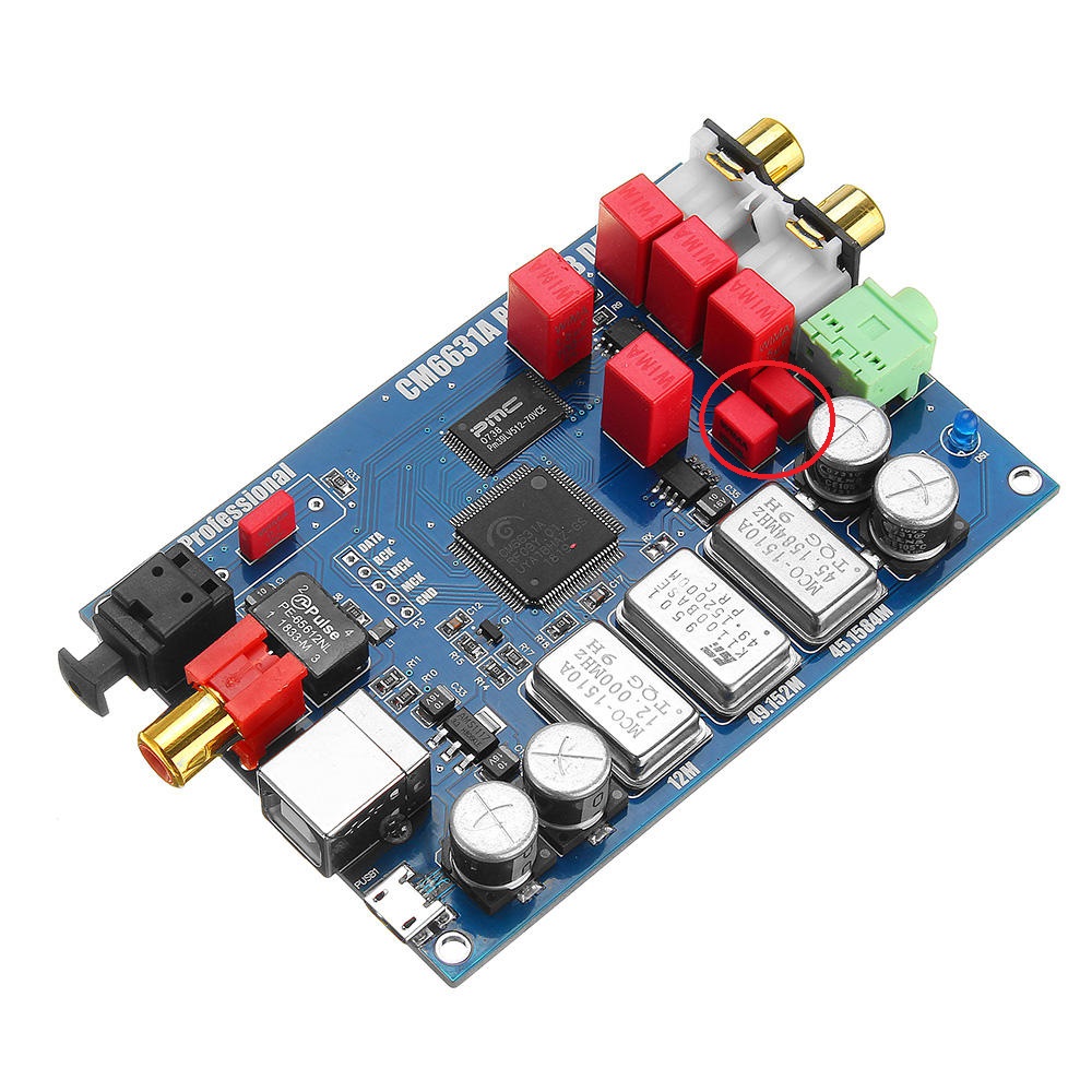

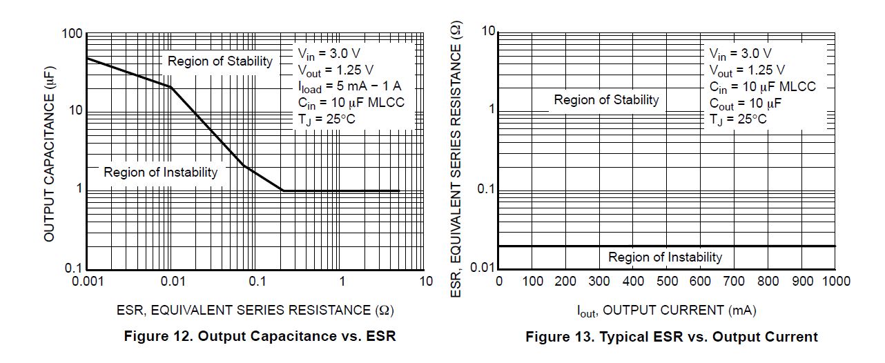

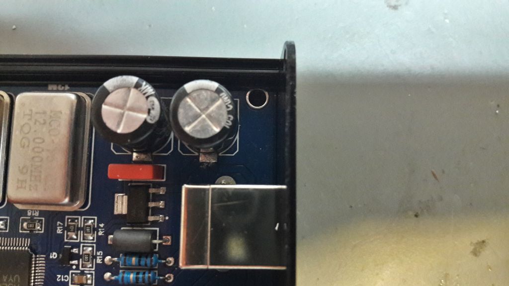

AMS1117 regulator values
Hi
i have to wait for the second board for better A/B comparerision....

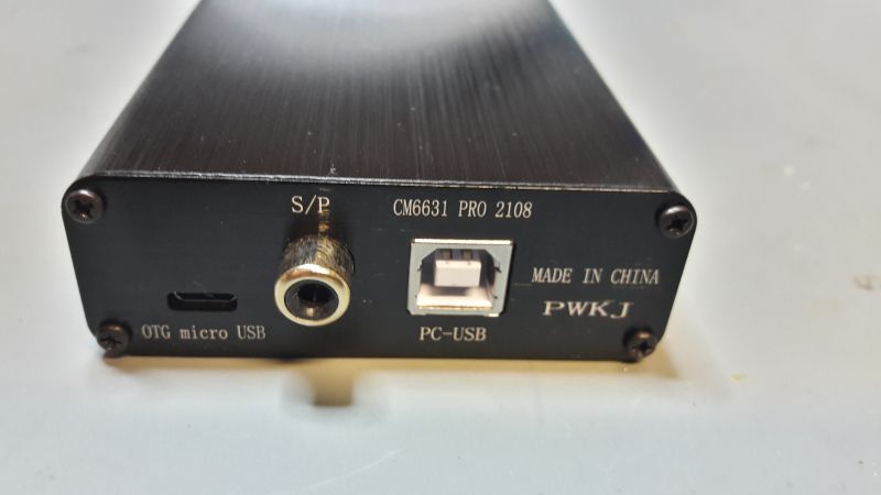

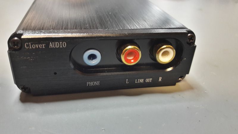

i want to show you the case. (pic 1+2) ....here you see the correct out L+R...;)
meanwhile i checked the ams reg. values which are on the board. --> pic3
Cin =470µF/25V
Cout=470µF/25V + red wima with 0,015µF(foil cap)
according to the datasheet its not ok. i found for the input no value so i will keep it.
Cout:
here i found just 22µF tantal or some post 10µ ESR about 30mR...so look at pic 4. so my next step will be to keep this regulator but change the values what is recommended......or i have into the box.....incl. measurements.
if i write nonsense ...please let me know..;)
chris

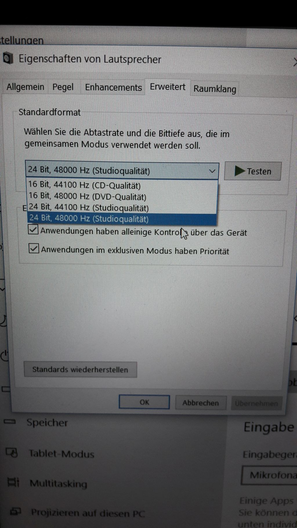

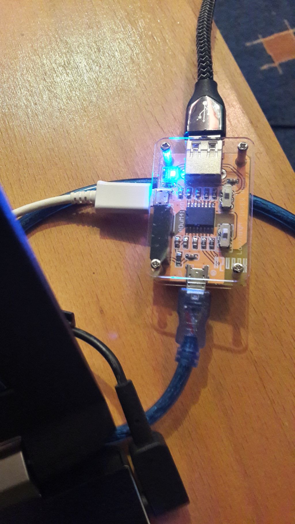

Adum4160 win setup and sound check
Hi
Waiting for the other board i start with the topic USB isolator
i bought a ADUM4160 about 18 Euro at amazon
DollaTek USB Isolator 1500V Isolator ADUM4160 USB-zu-USB-Isolatormodul Audio-Rauschunterdrucker Industrieller Isolatorschutz: Amazon.de: Elektro-Grossgerate
the Sound check with the CM6631A board and my Topping D50 DAC is successfully. as i read the max audio format with this adum is 24Bit/96kHz...fine i can l live with that.:)
the adum is directly connected after the laptop and powered with a different USB port as external power supply...therefore you have to set the switch.
pic 1
first i start with topping D50 and i take 1 setting and reboot to have win recognize the adum+D50.
i tried a month ago a ifi audio i usb3.0 nano (220 euro) but had no big approvements ! this adum is really good and i can really recommend this box
sound gets sorted, darker, bass controlled, more "right" sound
CM6631A board
first.......... every connect/disconnect force a notable pop in my chain -speakers:(
the max audio format after i tried several time with win setting is 24/48kHz...its not possible to get more:confused:... pic 2
any comments or hint to solve that is very wellcome ;):D
nevertheless the sound improvement is really good:)....the difference is the same as at the D50...the small DAC get more air and 1 step deeper sound stage
so the low cost DAC grow from 35euro +18euro(adum)....;)
chris

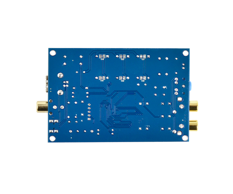

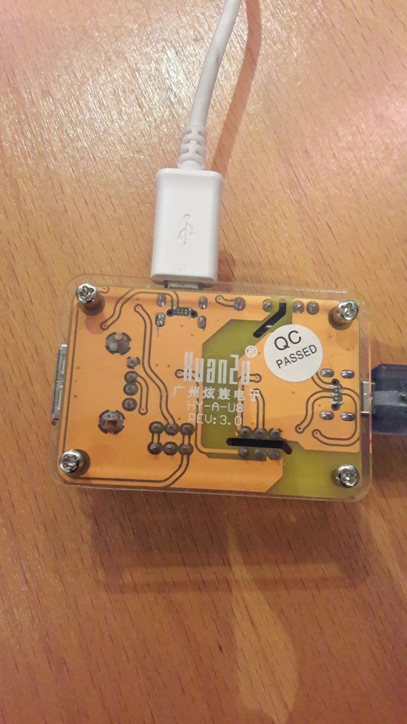

Do the clocks on that board have any local decoupling?
I didn’t see anything, but thought maybe there was something on the underside of the board.
Hi phase
you are the first here:up:.....thank you:D
no.... under the pcb there is nothing to see..:(...see pic
yesterday i retry several timse but without adum4160 the cm6631A board is able to set to 24or32bit/192khz and if i switch the adum in the chain tidal is requesting an error and its just "allowed" to set to 24b/48k:confused:
but sound check is still with adum better.
yesterday evening i tried 10 times with settings 24 or 32 bit /192k without adum and play cm6631A directly...its better then 24/48k. 32/192k sound a little bit strange in my opinion..24/192k is more darker the 24/48k but with adum4160 its better sound stage, clear highs, the character of an instrument get very clear.....more holographic sound.
e.g. natural instruments...very good recording...deep soundstage
bueno vista social club /title "dos gardenias" + "pueblo nuevo"
chris
Disabled Account
Joined 2002
BTW you are right in using a better regulator as AM1117 is not very good. You could keep the AM1117 for powering the XO's and a separate better 3.6V version for the ES9023 together with a 130 kOhm for Vref. Please use the output filter caps as you assumed wrongly that they are not needed. Beware of assuming things. Which kind of output cap for the regulator (and what value) depends on which regulator you will use. Never assume and change and then use the ears to decide as it does not work like this when decoupling regulators. This method works when coupling analog stuff.
As far as I can tell there is only one regulator on the PCB powering all things. Using a separate regulator for the ES9023 will be a significant update.
Disabled Account
Joined 2002
Thanks. Please note that the XO power supply pins are opposite to eachother in a diagonal. You probably can use SMD caps straight from the + pin to the GND plane if you scratch away a bit of the blue coating. I would use 0.1 µF 0603 (if that is correct, please check size).
The 1117 is famous for noise which is (depending on manufacturer) around a whopping 100 µV. I would replace it anyway also when it only feeds the XO's.

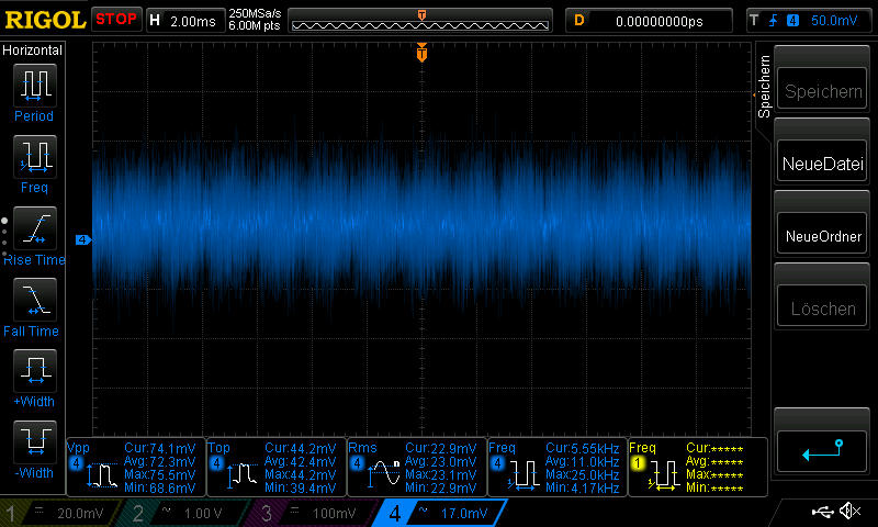

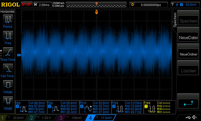

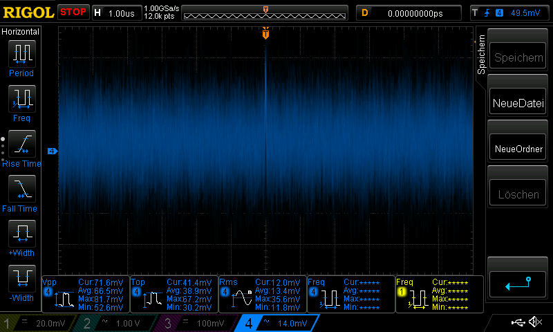

...try to look at the dac noise...

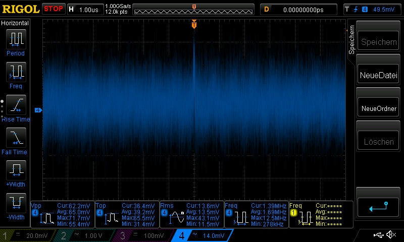

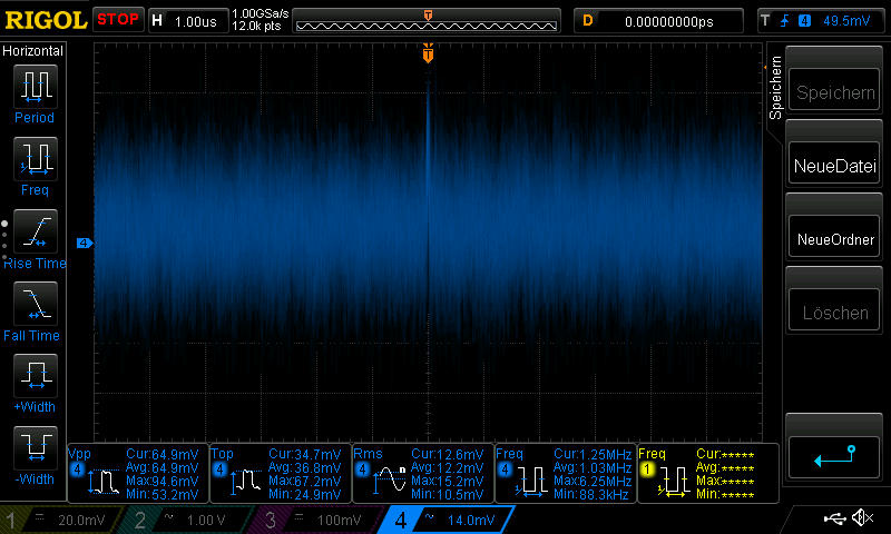

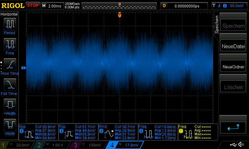

Hi
i use my scope and a differential probe and set the measurement point at the amps input rca ( its a amp board..easier to measure, its the same amp as i use for listening now).
no music amp baord is muted. dac on, amp on
pic 1 win setting 24bit/48khz , no adum4160
pic 2 win setting 24bit/48khz , with adum4160
so the difference is here but not as big...
but with win setting 24/192k..its better ?!?
pic 3 win setting 24bit/192khz , no adum4160
are these measurements ok?
chris

Disabled Account
Joined 2002
This particular board exists in various versions. Does yours have the beads in the power supply lines? You definitely have power supply issues so a good first would be replacing the 1117 and give the ES9023 a separate reg.
Please use the datasheet values 4.7 nF for output filtering.
