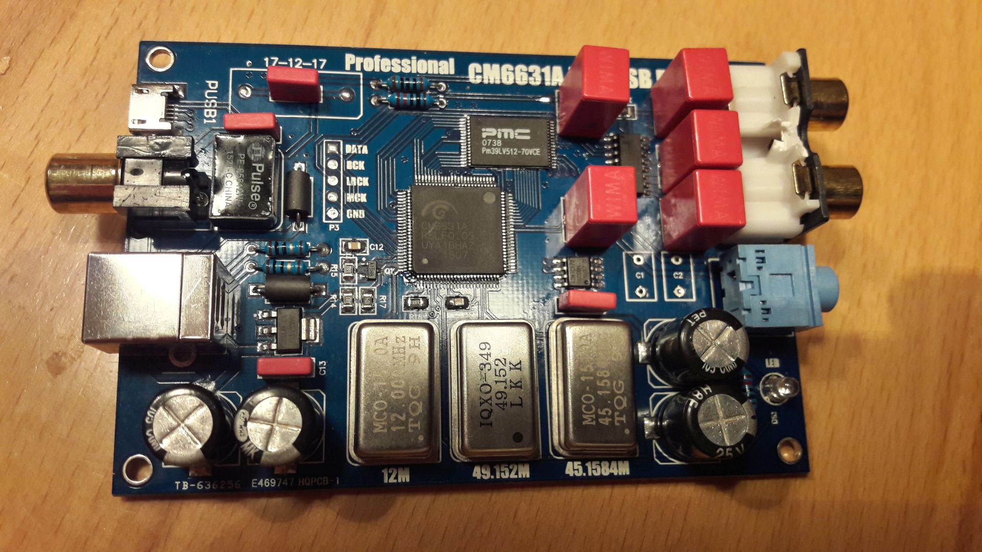

This particular board exists in various versions. Does yours have the beads in the power supply lines? You definitely have power supply issues so a good first would be replacing the 1117 and give the ES9023 a separate reg.
Please use the datasheet values 4.7 nF for output filtering.

The beads are the ferrite cylindric shaped parts as shown on the CM6631 + ES9023 boards that are sold now. So newer boards have these. They filter out high frequency signals as they form a higher impedance for those frequencies. Lower frequencies like DC (😉) are not hampered.
Thanks. Please note that the XO power supply pins are opposite to eachother in a diagonal. You probably can use SMD caps straight from the + pin to the GND plane if you scratch away a bit of the blue coating. I would use 0.1 µF 0603 (if that is correct, please check size).
The 1117 is famous for noise which is (depending on manufacturer) around a whopping 100 µV. I would replace it anyway also when it only feeds the XO's.

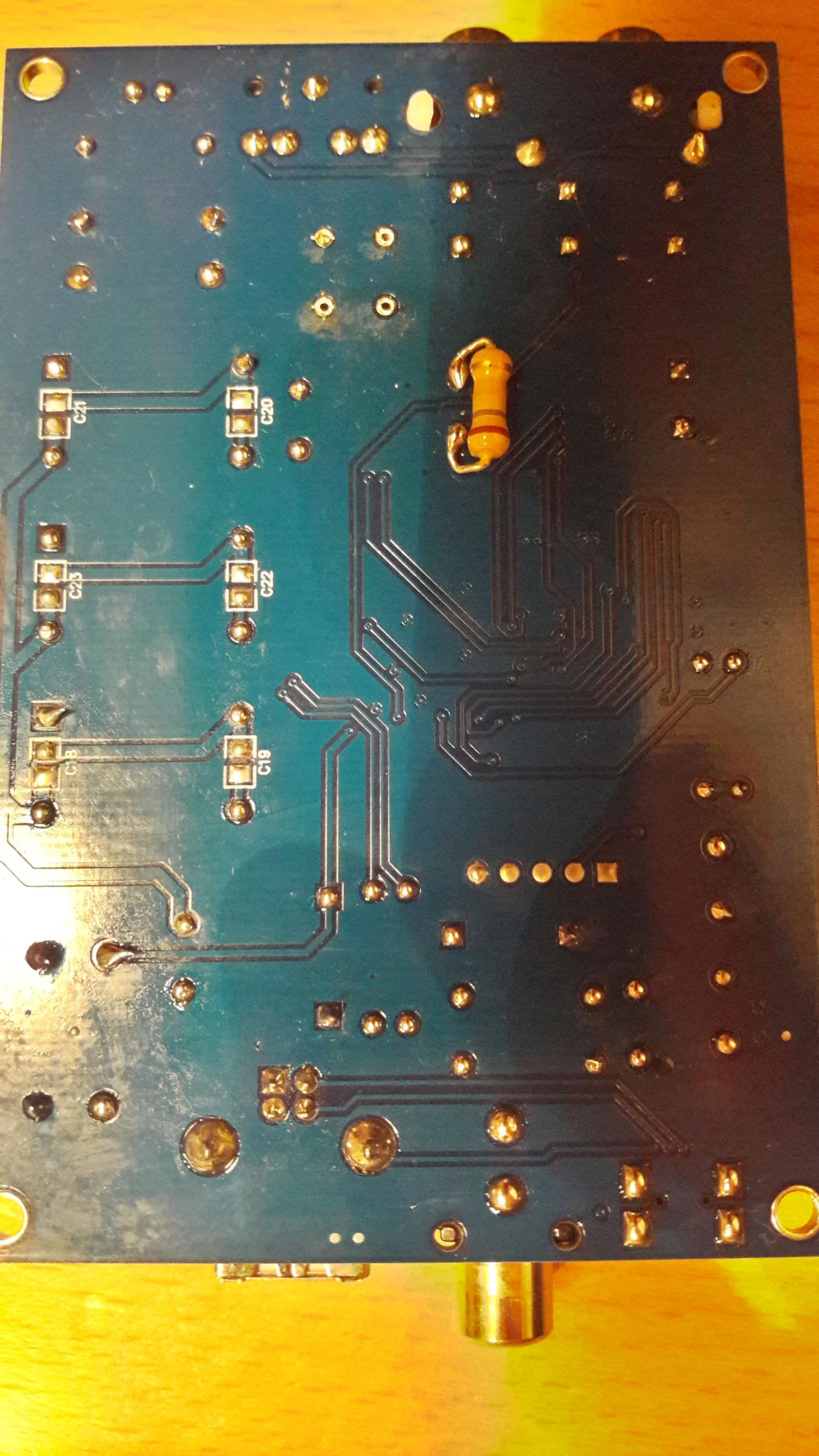

I noticed some pads in that view of the underside, and they didn’t make any sense to me.
Same here 🙂 However on the pics chermann attached we can see it is C18, C21 and C23 that are pads for decoupling caps. 0.1 µF X7R are just fine for this.

the caps i refer at the very first post and is in the pic 1 in the red circle these 2 wima 220/100V ("5") marked caps where soldered ...and i put is wrongly out.

Check if Wima FKP 4.7 nF exists in 5 mm pitch and order those. Your board has the beads so no worries. It still is noisy so we have to improve it I think. I don;t have too much time these days but I would advise to first check and make a list of what you will need in total and then order it. There is no need for hurrying.
You will also need better quality tin/lead solder and some isopropyl alcohol for cleaning the PCB. I see a through hole resistor is used by you but please use SMD parts in this DAC.
I just checked and it is partnumber FKP2C014701D00HF00 for the Wima caps.

just to clarify...my measurements i did directly on the AMS1117 chip...so not after the ferrite beads or at the es9023
It does not matter right now as the 1117 already is junk and since there is only one regulator feeding everything it is no surprise you see noise as it also feeds the 3 x noisy XO's that pollute the supply line. Remeasure when a better reg is used. Now you can spend some time finding a suitable low noise reg and think of a layout how to implement it (together with decoupling caps) neat and tidy with shortest possible connections on the PCB. Gotta go now, sorry.
At first glance the pads looked as if they connected the output to ground.
I couldn’t imagine having nothing for decoupling on clocks!

so i interpret. exactly where is written C18, C21 and C23 there should be decoupling caps:
JP wrote 0,1µF X7R ceramic is good.
you wrote 0,01µF X7R+ 1nF C0G ceramic

I checked the traces and the caps C18, C21 and C23: it is as you described..

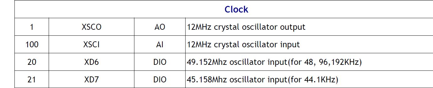

what about C19,C22, C20?...i checked this the traces go to the CM6631A chip...see attachment

Hi I think placing the caps on C18, C21 and C23 is a one chance only affair. Chinese PCB material is not suitable for reworking a few times. It is up to you. I just saw your list of parts and please get accustomed to using SMD parts. SMD beads are way easier to use on traces (just cut the PCB trace and solder the bead over the gap). You need beads that are ultra low impedance for DC and higher impedance for high frequencies. You can look up the part list of Subbu V3 for a suitable version. In fact you can adapt this ES9023 design with most V3 values/design choices.
Again I think you need better soldering tin and/or soldering tool. In german speaking countries Fluitin 1532 (in 0.5 or 0.7 mm) is available which is excellent. Cleaning the board is essential after reworking.
* C19,C20 and C22 are pads for caps to GND from the output of the XO's. I would not put caps there.

When I first saw all those solder pads I knew they couldn’t all be used as this would hamper the signals.
When working with boards like that, I will often budget for a second board to modify once the values and configuration have been established. I hope the smd beads enable the desired noise reduction, maybe a series of the smd beads will offer better performance than a single bead.
