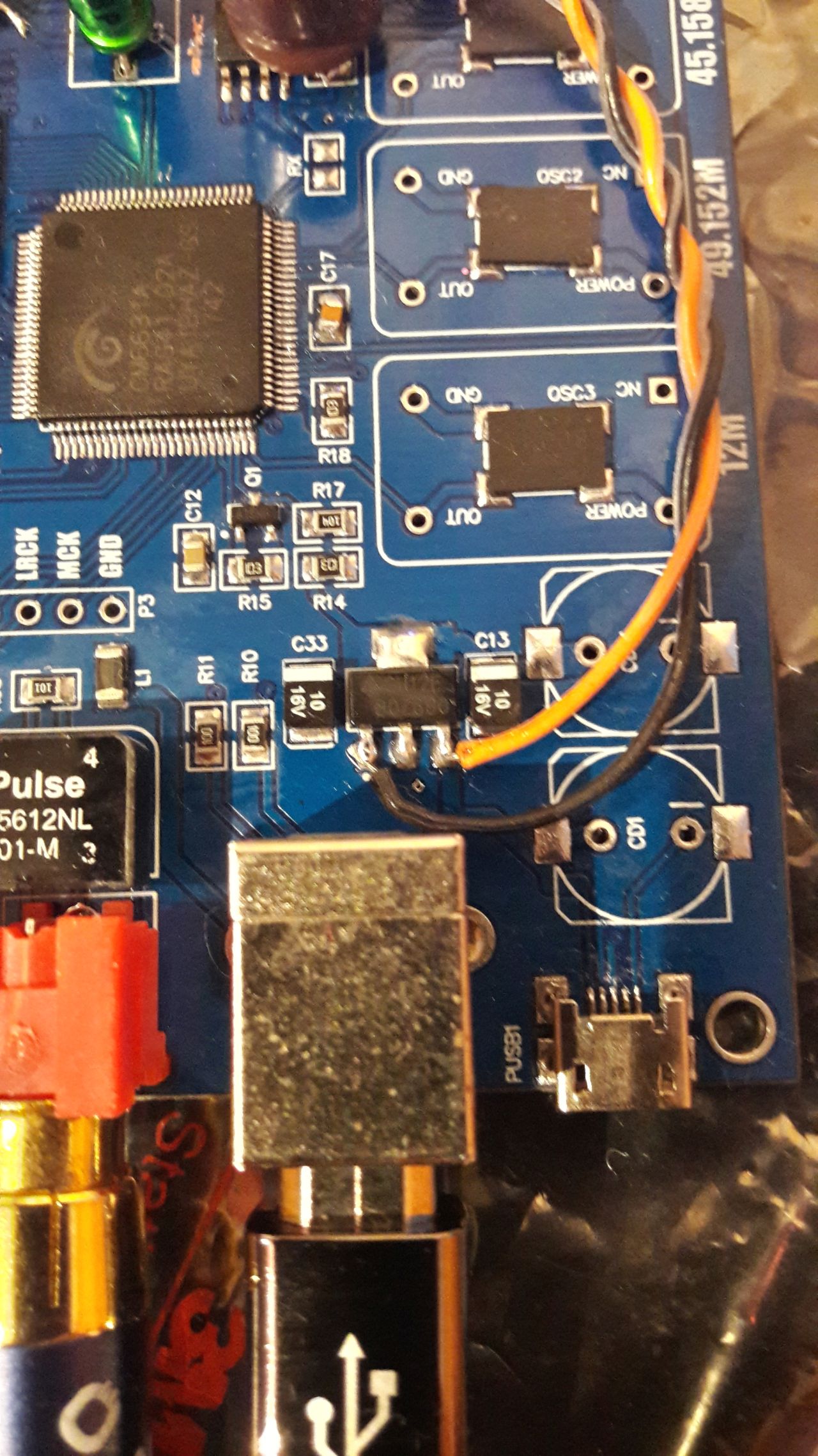

buttom side board2
one pic of the buttom side of the pcb.
as i wrote its better to use a "bigger" smd 130KR resistor, 0603 is too small
for the XO decoupling its better to use 0805 smd size i guess

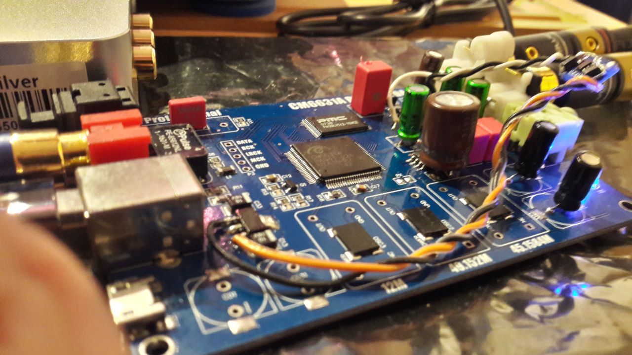

Good morning
Hi FF
next step....
my plan is to use the micro USB port (right beside the usb - b) as "separate power supply" for the ES9023! i plan to cut these traces and solder there the input of the mic5205 and use a power pack which i use for powering my Topping D50. in future linear power supply with fine clear 5V
board 2 is running in....
btw... at board 2 the C17 cap was missing - i use it from my damaged board...470nF
chris

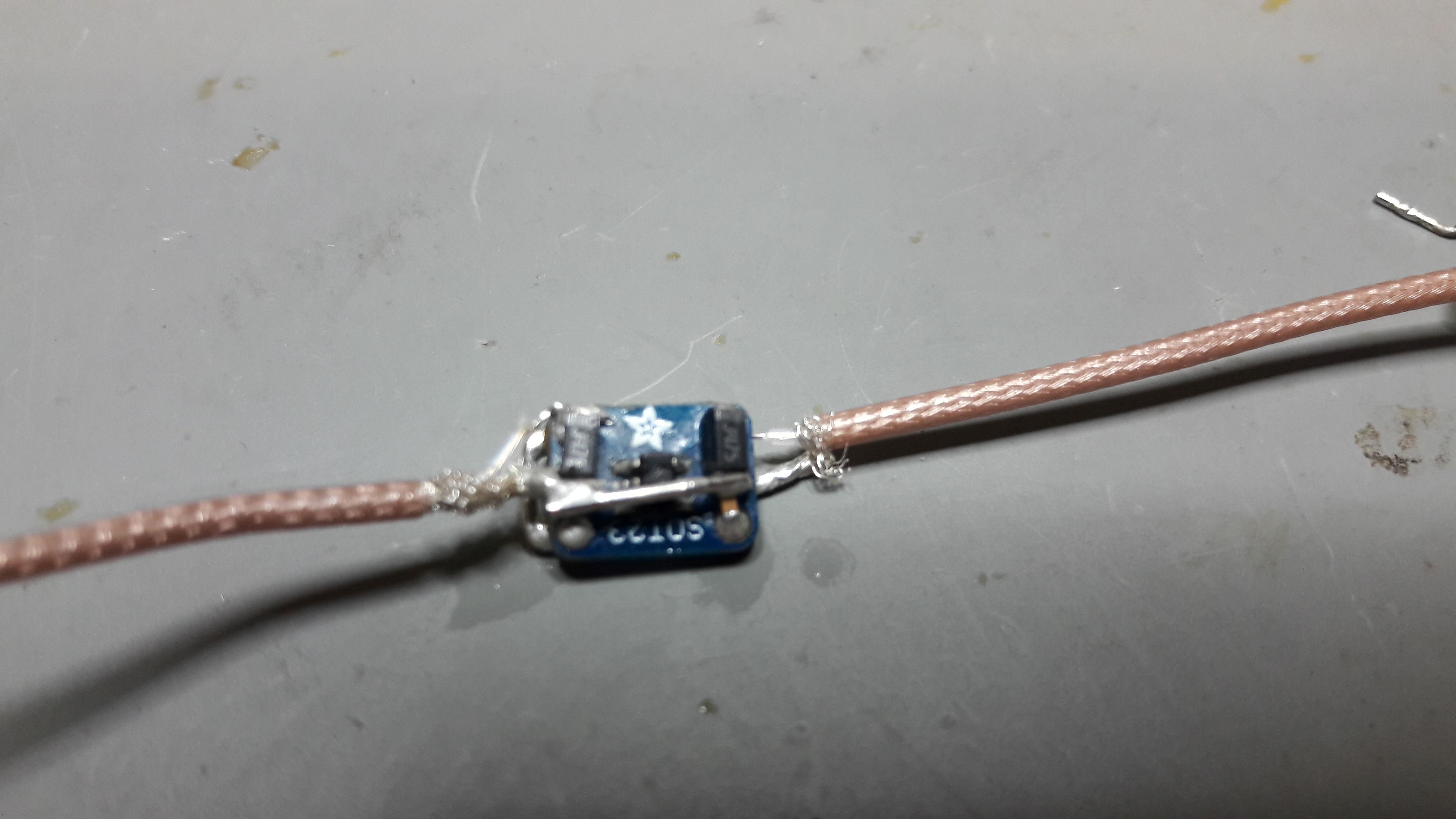

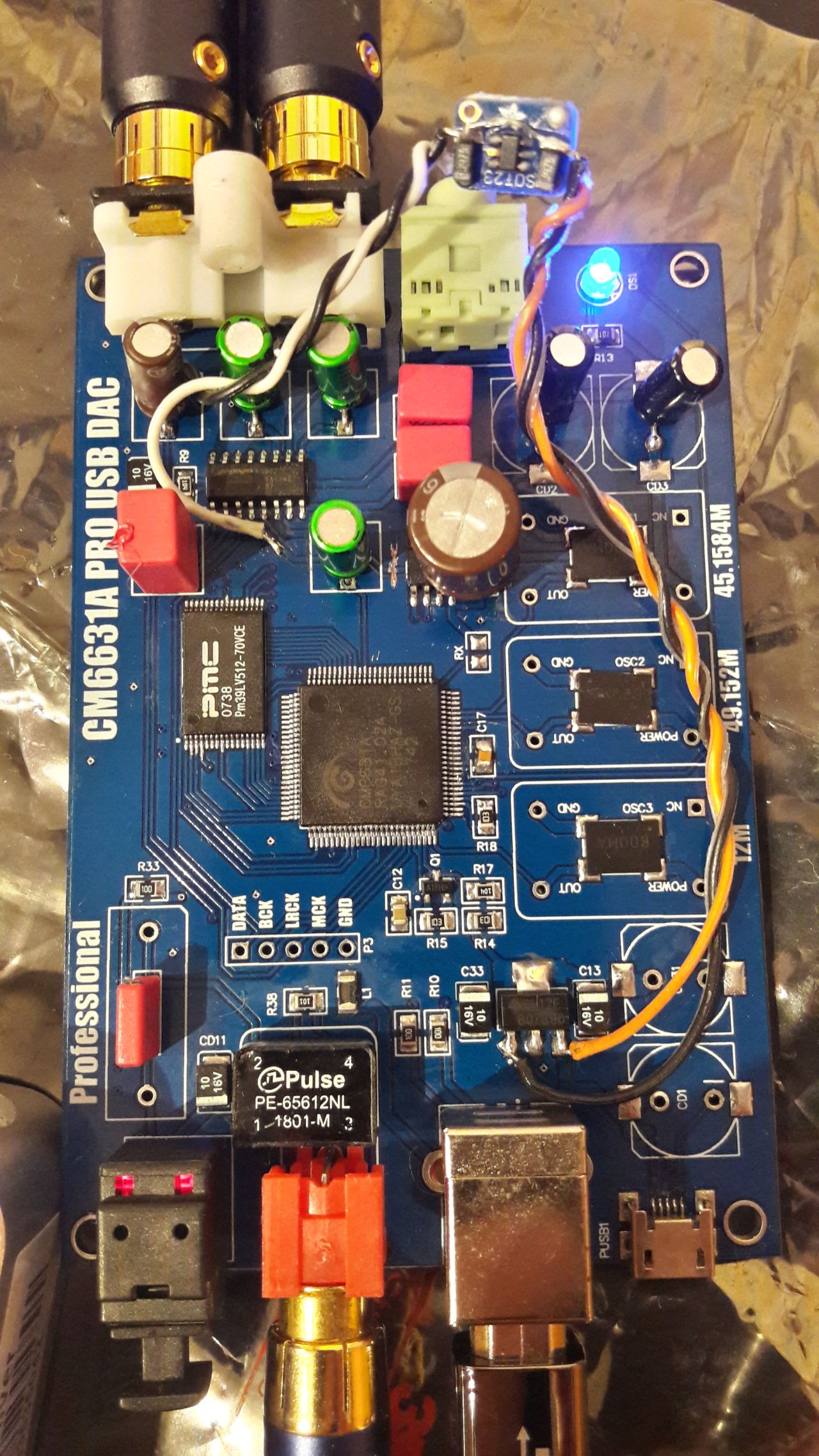

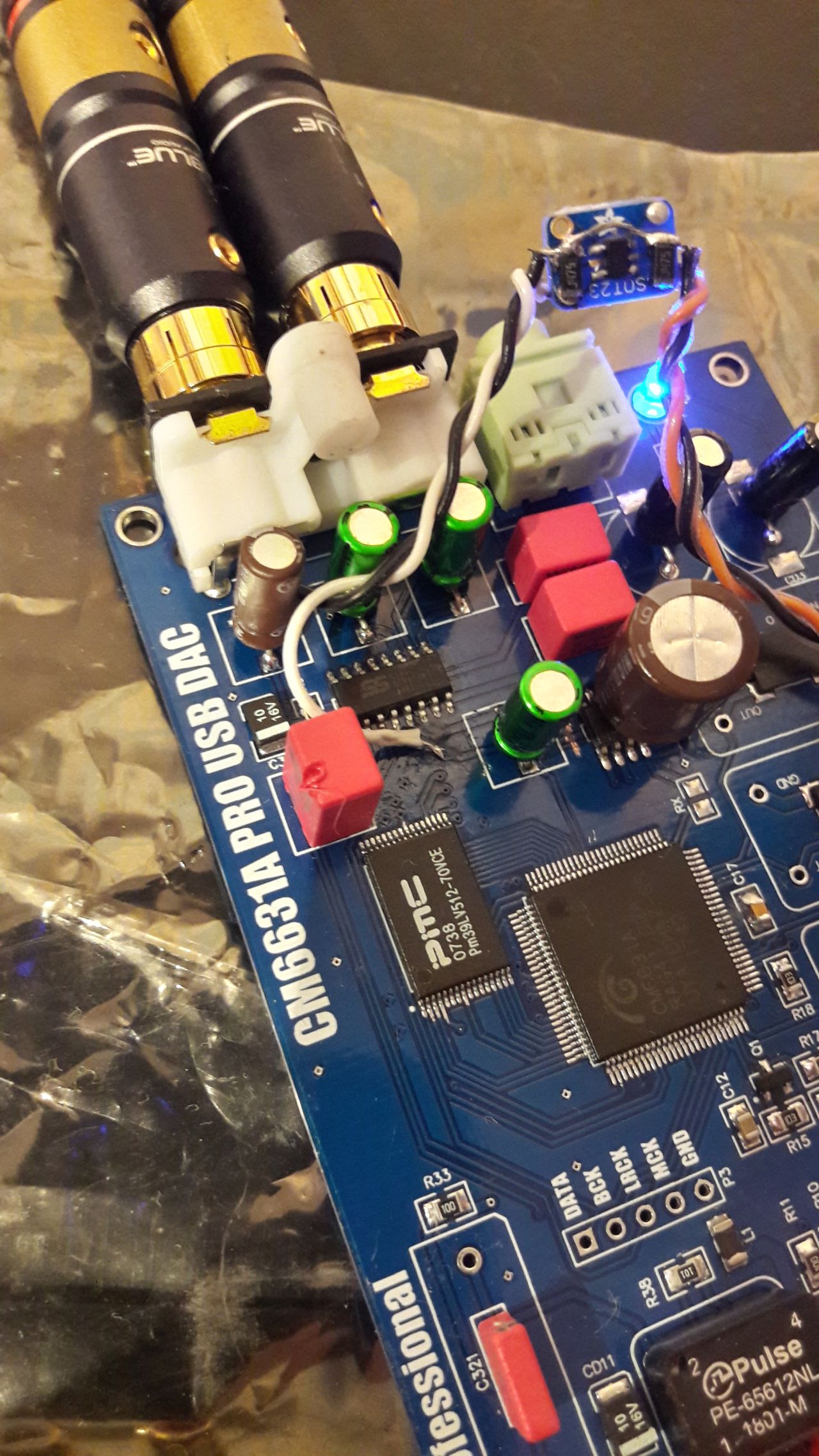

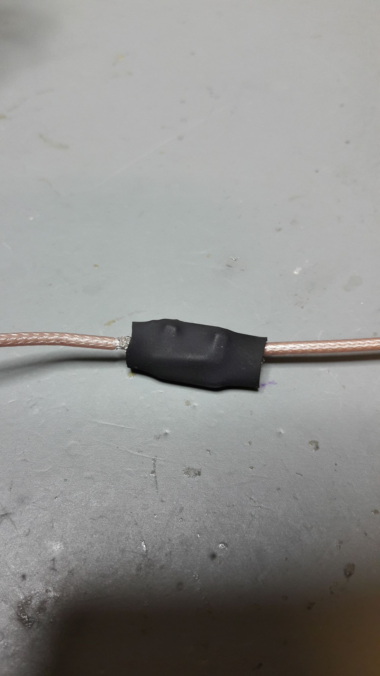

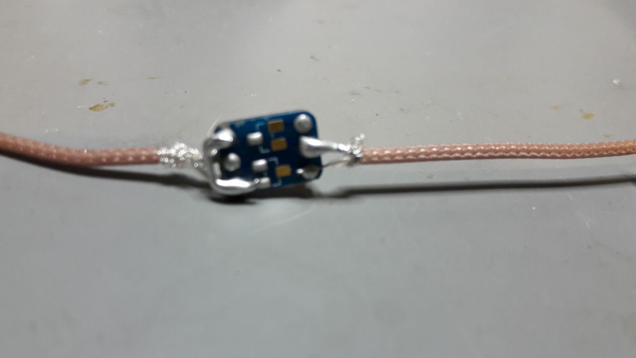

3,6V for board 1
Hi
3 °C and rain....so do some modifications
enclosed my "high end" version of the MIC5205 3,6V for my first board.
i use a coax cable to compare later with the board 2.
chris
Hi
chris

1 brother gets ill - so no judgment
2 i had several tries to get the regulator work because of some failures myself . first time the black isolation over the pcb press something from the coax...then i made a mistake with soldering on the mic5205 power in...nevertheless i got it work after some tries....but now i have the same strange behavior: after playing a while i got some noise which getting louder and louder an then it ends with some scratches and pops. i go back to 3,3V so i check everything is fine. i played 30minutes without failure...
i replaced the MIC5205 input 4,7M tantal and after 2 hours it plays fine...i read something......but then ....this whitenoise and end with pop/scratch come again....
it seams like a temp problem...i have to build a new mic regulator
sound wise i can say the quick change on the same board between 3,3V and 3,6 is easy to follow up that the 3,6 is the better solution
chris

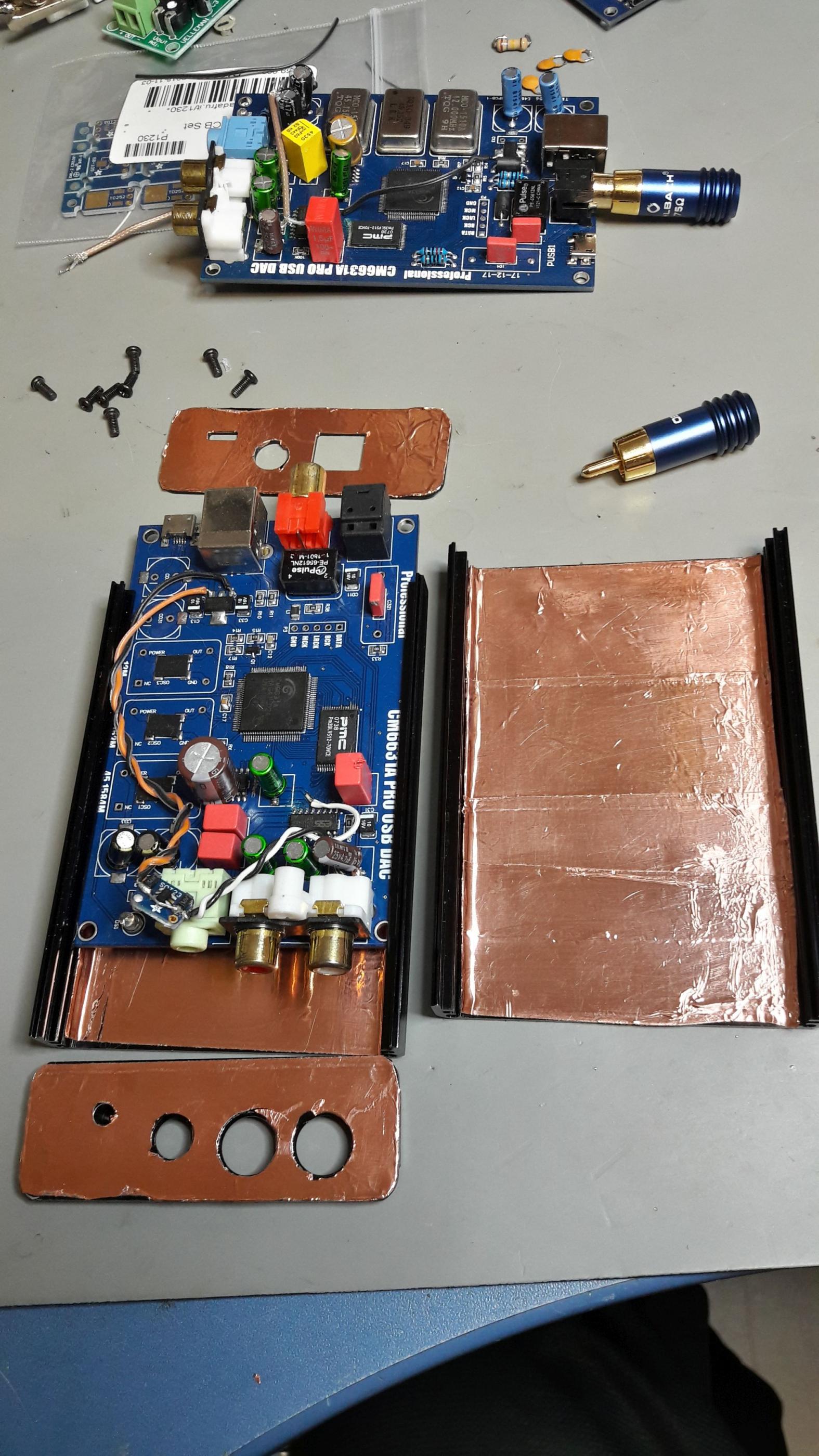

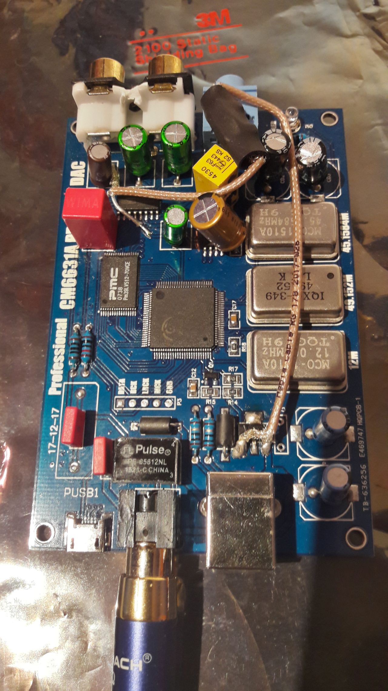

Hi again
i did the last few days some compare listening sessions.
one failure i uncovered - do not low down the level of the Topping D50. i thought that i read about -4db less as the max level. this is not good...play always at full volume leveel 0.0dB.
2nd sometime the D50 is not always really on and play strange- what does this mean? the D50 has sometimes "connection" errors- he is connected but make during playing some strange streaming noises, its sound like small pop/brakes..loose the streaming packages??? i had this several times.....so i restart the D50 until i got the first seconds no interrupt.
SQ:
judgement by my brother is still not finished...he lives in a different area so next meeting is end of May....
i am still happy with my modifications- both DAC near but the "colors" of the mod ES9023 are real and give me bigger, real instruments and voices...the details of the D50 are not enough to cover the hole impression of the sound stage..its too focused on one point and the instruments and voisces are too closed together.....yes i know this is a strange statement but...believe it or not
pic --> board 2 in the housing of board 1 with copper foil finished now....
problem is that the toslink of board 2 is not existing at board 1 so you have to put away the blind plug. 2nd problem is that the micro usb is on the other side (left<->right). so for my planned separate power supply over micro usb i have to think about...
chris

at board 1 for the update of 3,6 i found that my small board must have some problems with the components.Why? maybe too long soldered, much heat, bending,.........--> i re solder the power back to 3,3V and no problems....so i have to build a new board
chris
