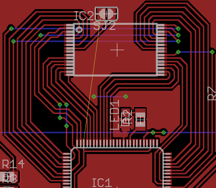

5th element's example seems to manage to keep all the traces on the same layer somehow, but maybe that's just the way it seems from the point of view of his picture.
Usually I try to keep digital lines on the same plane but if there is no issue with using multiple layers then I'll just do that.

There's probably no issue using vias and switching layers for this flash interface. I don't know what PCB layout tool you are using most can use design rules to ensure consistent trace/space for controlled impedance and also can ensure lengths are matched if you want to go to that extreme.
This layout guide is for a much faster flash memory, but it might be of some use:
https://www.cypress.com/file/276451/download

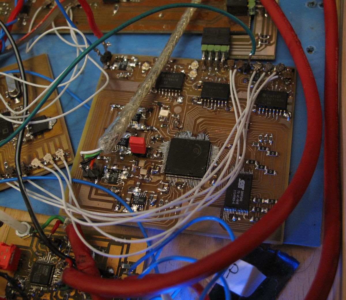

With regards to the traces to/from the flash memory. I use a bunch of zero ohm 1206/805 resistors to bridge across other traces as this helps to keep everything on the top side.

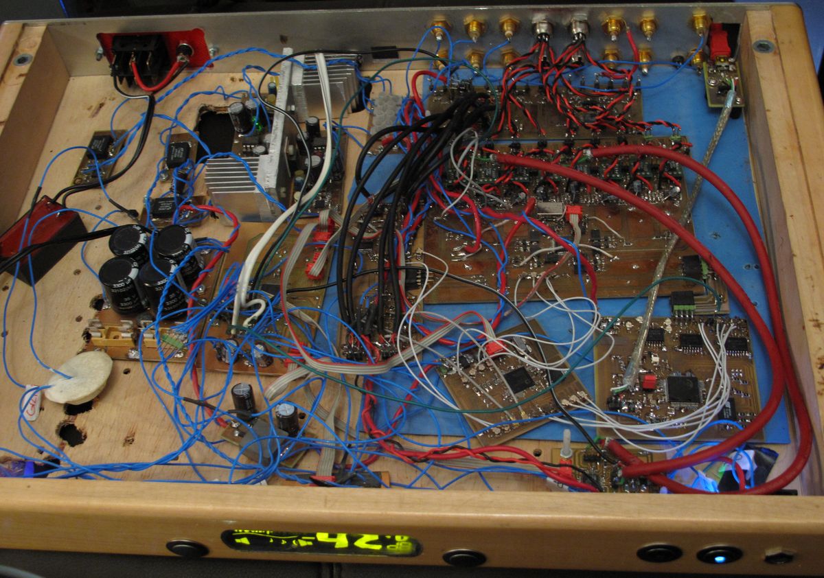

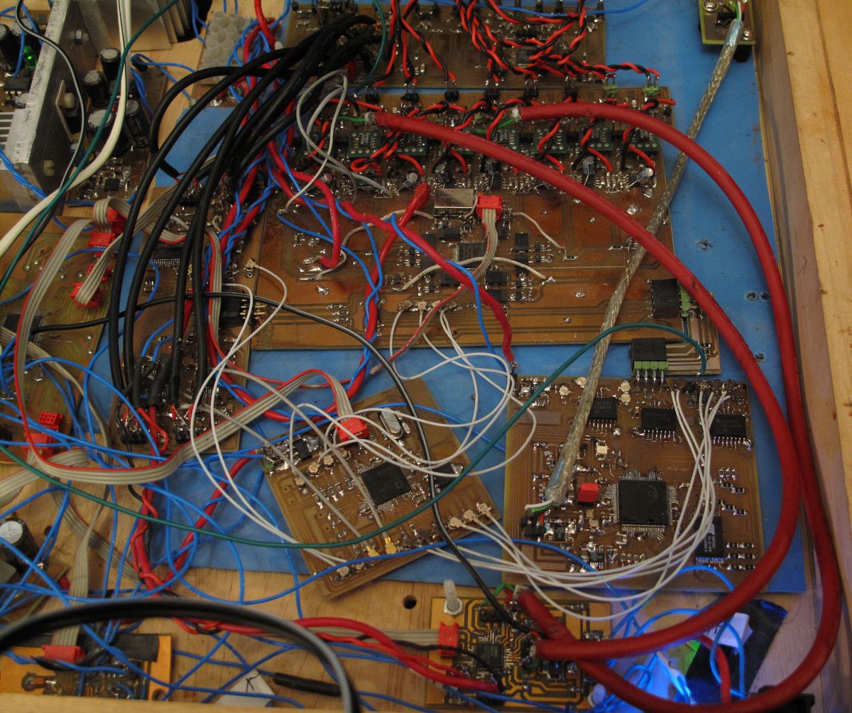

So as soon as I got this working I came down with the man flu hence the delay in posting an update.😀
Pics are attached below.
The first thing I built was basically a proof of concept to check that it would work and wasn't really designed to be hooked up to a DAC/ADC. This update was designed for sound.
8 out, 2 in with isolation on the I2S streams. It's a shame that you can't get single chip USB2 480MB/s isolators...that would make isolation so simple.
Anyway I now have this working with multi-channel audio + a DSP. Multi-channel works great as does ASIO, so no issues there.
Now all that's left is to build the ADC. I've got an AK5578 waiting for stereo use. Lets see if it's actually any good.

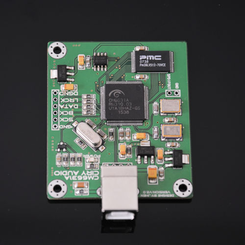

Hi Guys!
I have this cm6631 board from ebay. I like to change i2S BCK frequency, because it is 128*fs at 44,1 khz. I like to set it 64xfs all sampling frequency and SCK is 128xfs. Do you help me in it?
I download configuration tool, and i generate firmware new setting, but didnt update firmware. In firmware upgrade send firmware "upgrade error", i try many times. The original firmware is 0208. I have this firmware, I upgrade this firmware again.
