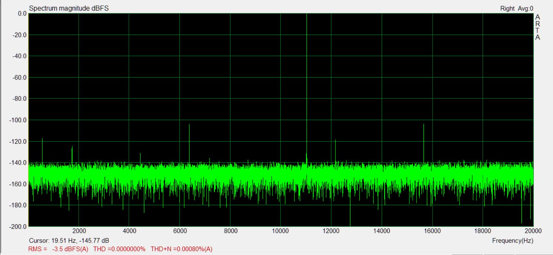

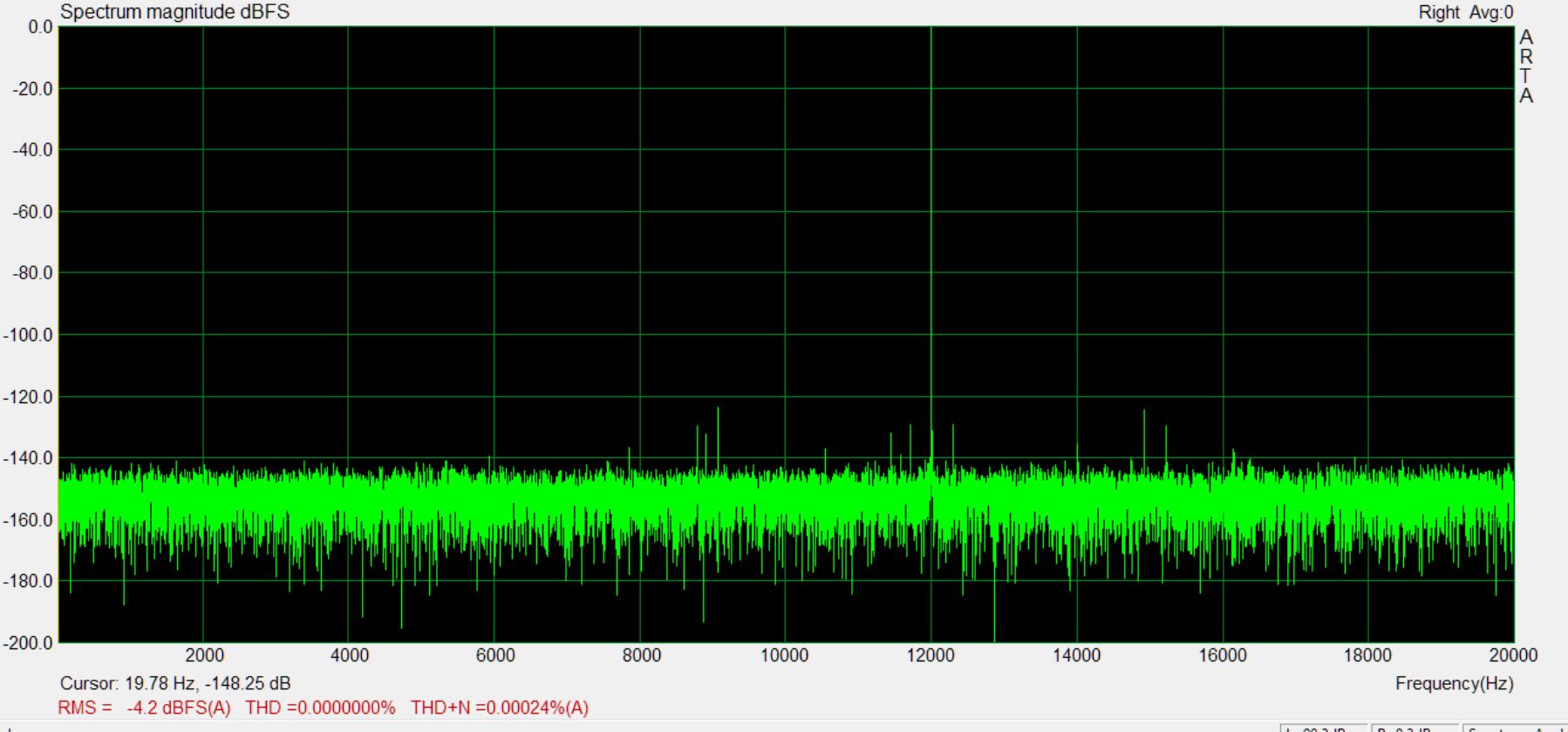

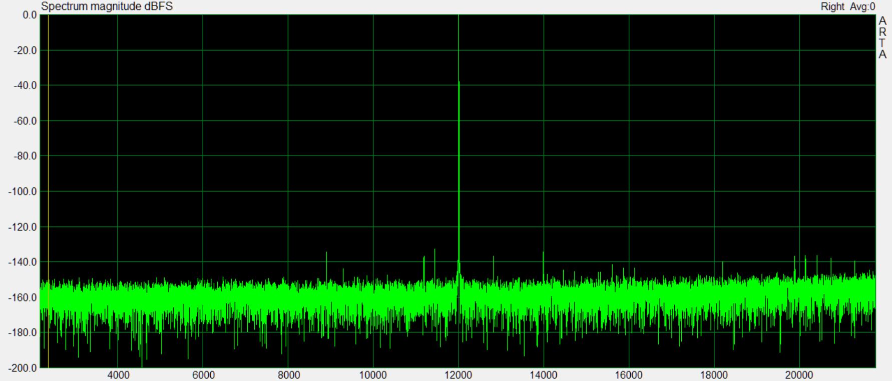

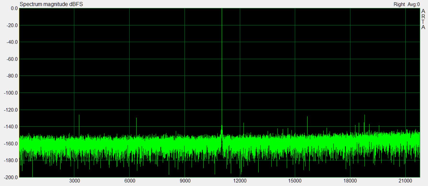

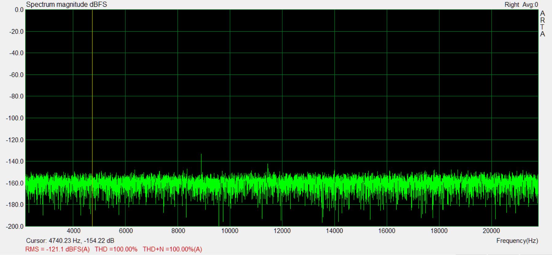

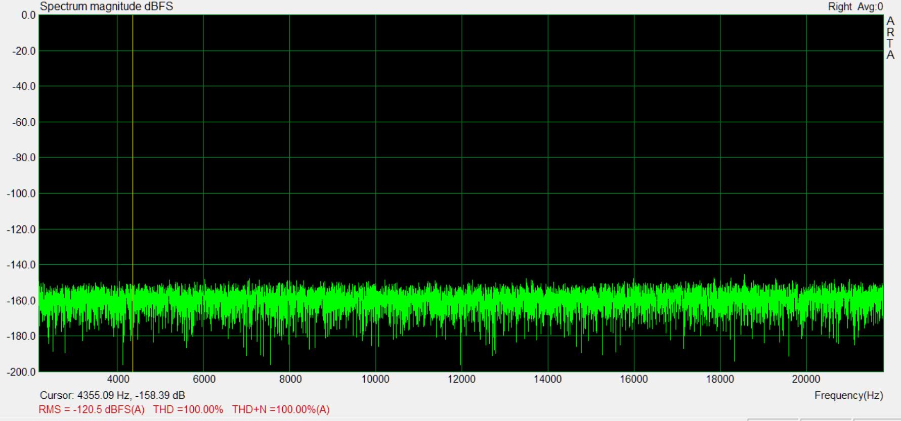

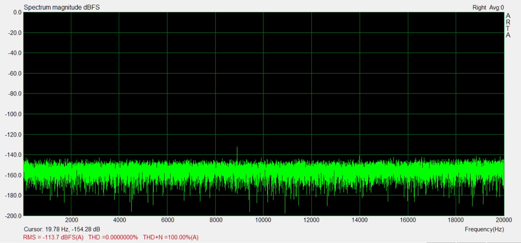

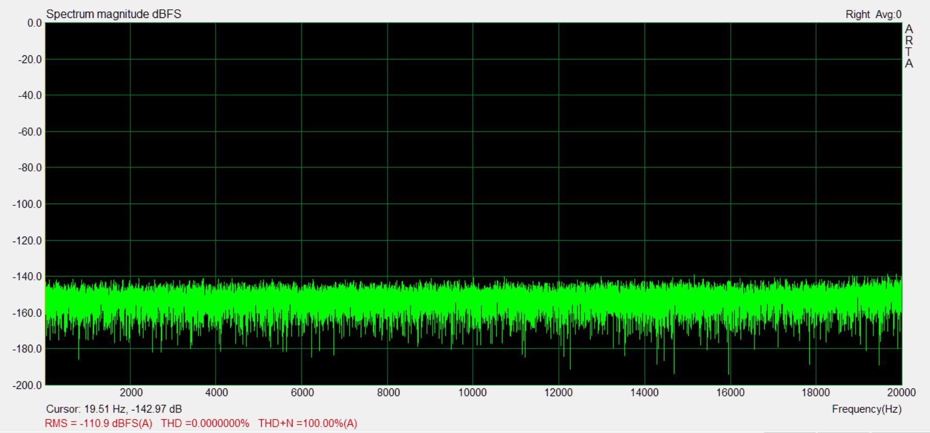

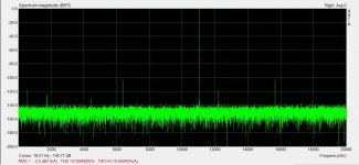

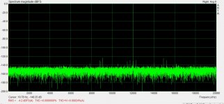

So I've been working with the 6632A some more, along with the AK4499. With this combination I had been seeing a significantly elevated noise floor on the AK4499. I had assumed this was due to the implementation of the 4499 itself, but it seems like that was leading me up the garden path.
After trying a different input device it became clear that the issue was with the 6632A itself, seemingly, adding in a lot of random jitter to clocks input on XD6 and XD7. Not good. But puzzling.
As the 6632A is operating asynchronously and the data and clocks output are clocked to the oscillators it is possible to connect the oscillator outputs directly to the MCLK inputs of the DAC. This bypassas any effect the 6632A is having on the master clock jitter and with 22/24 clocks runs the DAC at 512/256/128xfs on the master clock.
Attached are pictures from ARTA of the measured results.
The first two are jitter at 44kHz. The first from the 6632, the second directly from the oscillator.
The second two are jitter at 48Khz, again the first from the 6632 and the second directly from the oscillator.
As you can see the magnitude of the spikes drops significantly as does the noise floor.
The last 4 pictures are for noise. The A weighted noise figure can be read in the bottom left. First two are 44kHz, second two are 48kHz.
Now these are the two cheapest 22/24 oscillators I could find in the SMD case style I wanted, so absolutely nothing special, yet when the DAC is directly driven by them the jitter performance is actually very good.
I also have 45/49 NZ2520SDA parts but as those operate at a much higher frequency they can't directly drive the DAC across all sample frequencies.
Directly driving the DAC from the oscillator is obviously going to give better performance, any form of buffering will degrade the overall phase noise, but this is ridiculous.
With the NDK parts going through the 6632A the noise floor characteristics remain the same as the cheap 22/24 parts going through the 6632A. So whatever is going on the 6632A is dominating things. The periodic jitter performance improves when running the NDK parts through the 6632A but the apparent random does not.
It's as if the 6632A is adding in a bunch of noise right across the board, increasing the magnitude of the noise floor and the periodic jitter spikes from the oscillator its fed. It's not adding in much by the way of it's own periodic spikes (good to see in one sense) but adding a lot of noise to everything else.
Interestingly the ADC (AK5578) doesn't seem to care about this.
The 6632A is obviously capable of more as measurements of ASUS devices will attest to.
Measurement's report ASUS Essence STU test and graphs - Reference Audio Analyzer
Measurement's report ASUS Xonar U7 Front test and graphs - Reference Audio Analyzer
You can scroll for a bunch of other measurements too.
The ASUS devices aren't expensive and use very basic implementations. Mine's far more elaborate with several low noise regulators and such. I've also tried another PCB and that didn't alter a thing.
With regards to distortion that's very low and measures to the limits of the ADC. I can get ~0.00008% etc with the right combination of levels and sampling frequencies. So no problem there.
I've tried altering all sorts of settings from the SDK, enabling and disabling different PLLs. Changing the feedback settings from off, to on, to MCU controlled. Pure PLL was horrendous, the noise floor jumped up to -92dBA, which seems malfunction levels of wrong.
I've also disabled all the i2c writes/reads in the SDK as I'm not using that functionality. I figured maybe the 8051 kept retrying the i2c commands when it didn't get the response back from the chips it was trying to control and that was generating internal noise. This didn't do anything.
I've tried different USB ports. Different computers. Different USB cables too. Nothing changes.
So something is going on inside the 6632A that shouldn't be.
So we've got implementation, both software and hardware. Or the 6632A is a counterfeit/reject.
I would be surprised if the hardware implementation is what's causing the problem as I've tried a different PCB layout and it didn't do anything at all. I've also tried adding in extra bulk decoupling. As you'd expect this gives a measurable improvement across the decouplers next to the IC pins with regards to transient spikes/dips, but it doesn't change anything.
The software, and device configuration, could easily have something within it that's causing a problem although I am not sure what.
And then there's the counterfeit/reject hypothesis. I did get my 6632A from Aliexpress. I highly doubt there's a big enough market for a counterfeit operation to make financial sense but I could see someone reselling operational, but substandard, rejects.
Currently I am thinking about adding in a low jitter clock distribution device to handle the oscillators and master-clock routing/division to the various devices, using the 6632A to control it. This should solve the problem and give better jitter performance than a properly functioning 6632A anyway. I'm fine with going this route as a one off, but I want to be able to use the 6632A in other things I build without a separate clock routing device.
Anyone any ideas?
P.S. Yes I know you can buy from the authorised distributor, Symmetry, but postage was prohibitively expensive. They wanted several times the cost of the device just to ship it. TI can ship global priority for a few dollars, why can't you? 😡
