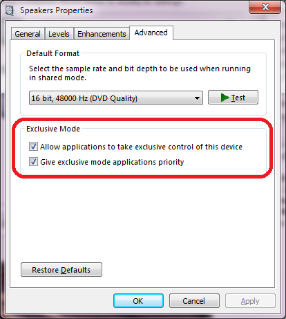

I have developed a simple dotnet application using NAudio library to play DC samples at different amplitudes.
When I play the samples the I2S signals are totally different than what I expected according to the data I have generated.
Amplitude and sample rate are not what I have generated.
I have just connected the oscilloscope at the output of the USB to I2S interface.
I have generated a 24 bit/192kHz DC sample at half the max amplitude (4194304), so only the MSB should be switched on (binary data attached).
When I play the sample by the Windows app the sample rate is 48kHz and several bits are on.
I've tried direct sound and WASAPI with no success.
It looks like Windows resamples arbitrarily the data I have generated.
Any idea?

Windows interfaceThe pain is that I don't know if the issue comes from Windows or form the USB interface.
The easiest way to use board Amanero (aliexpress). Most likely better WaveIO and I2SoverUSB v.II, but it is necessary to make a external powered.I contacted the manufacturer about using it in a design and they said it's old and no longer supported.
As far I can google it, Naudio support both WASAPI Exclusive Mode and ASIO. It is a way to bypass system mixer. You need to use wrappers for these interfaces:
NAudio Output Devices
WASAPI Shared mode is not enough, as the first application that opens a pipe has a decision on the sampling rate, it is usually system sounds, still goes through mixer. To use exclusive mode, it has to be enabled in Windows Sound Control Panel.
