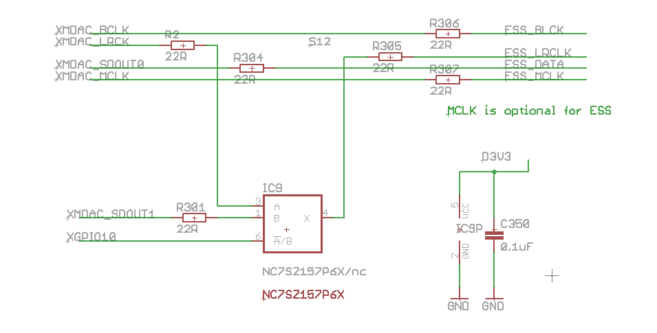

The 6631A is the one i want to replace with the 6632A so i can have DSD support

What i want is only one I2S master output to connect the es9018k2m dac for stereo

More pins needed
For DSD with ESS, you need 2 additional pins (data-1 and GPIO10) from the CM chip compared to PCM. Not sure if the board you're trying to use exposes these pins in an easy to connect way.
Schematic attached,

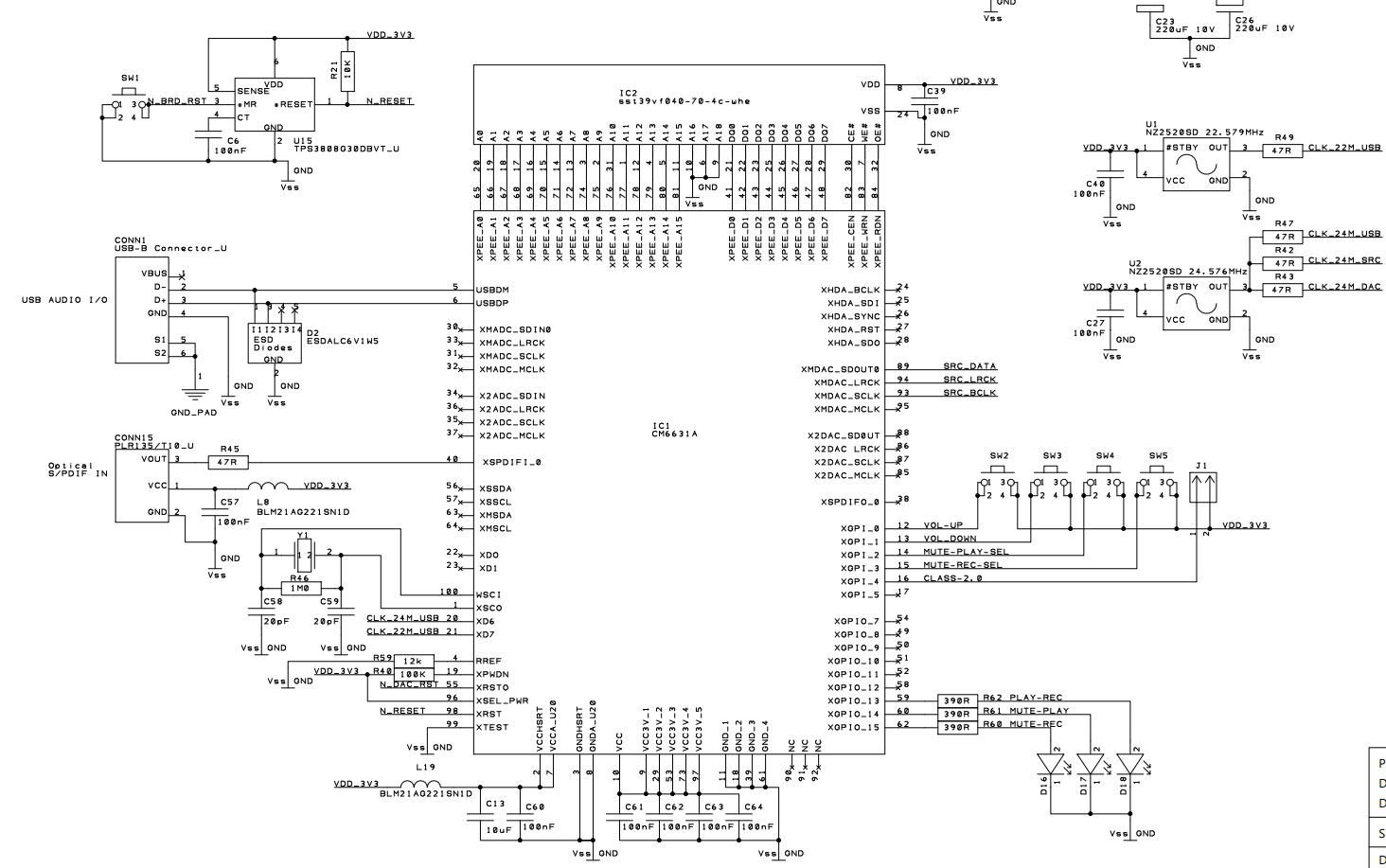

CM6631A schematics using S/PDIF input
Now a first draft version of schematics around the CM6631A device using optical S/PDIF input, USB audio interface and I2S digital audio output to sample rate converter. Any comments are wellcome!
Thanks for the comment!
As read from the CM6631A datasheet "RDMA#C supports S/PDIF input (192KHz is supported only with Crystal and PLL clock source)" My guess is that the firmware created by the Firmware Configuration Tool does not support this clock mode? Or is it an undocumented feature?
Don't know the answer myself. Maybe someone can chime in if they do. I was only commenting on the TOSLINK input but no SPDIF (coaxial), since TOSLINK is limited to 96kHz maximum sample rate with many devices due to problems with excessive jitter above that sample rate.
Hi, Now a first draft version of schematics around the CM6631A device using optical S/PDIF input, USB audio interface and I2S digital audio output to sample rate converter. Any comments are wellcome! View attachment 730169
No need for the reset IC, this was needed for 6631, but the 6631A has internal reset delay. Connect the reset button directly to the chip without capacitors. If the reset button has long wires, maybe add 10k pull-up. If the reset has (too much) external delay, it will cause the 'your USB device can perform better when connected to a USB 2.0 port' message. For better SPDIF performance, consider to use coax with pulse transformer instead of optical like suggested by others here. Pls note it looks like SPDIF-in to I2S out only works when the CM6631A is connected to a computer with USB and driver running. For the USB, you don't really need the ESD protection for home audio. Without the ESD part, the USB trace layout will be cleaner. It's USB 2.0 so must be matched impedance traces on PCB. Hopefully helpful.
Thanks for info regarding reset. Was not aware of the internal power up reset feature 🙂
The optical S/PDIF interface was selected by two reasons. Avoid risks for ground loop currents (but of course a pulse transformer solve this) and that the source in my case is optical. Jitter is minimized by a separate src to get the best possible working conditions for the dac. But due to limitations regarding 192kHz I'm considering to add an AKM4113 to get dual (opto + coax) and up to 192kHz. This device can be hw controlled and be connected to the CM6631A I2S input. A new version of the schematics next week.

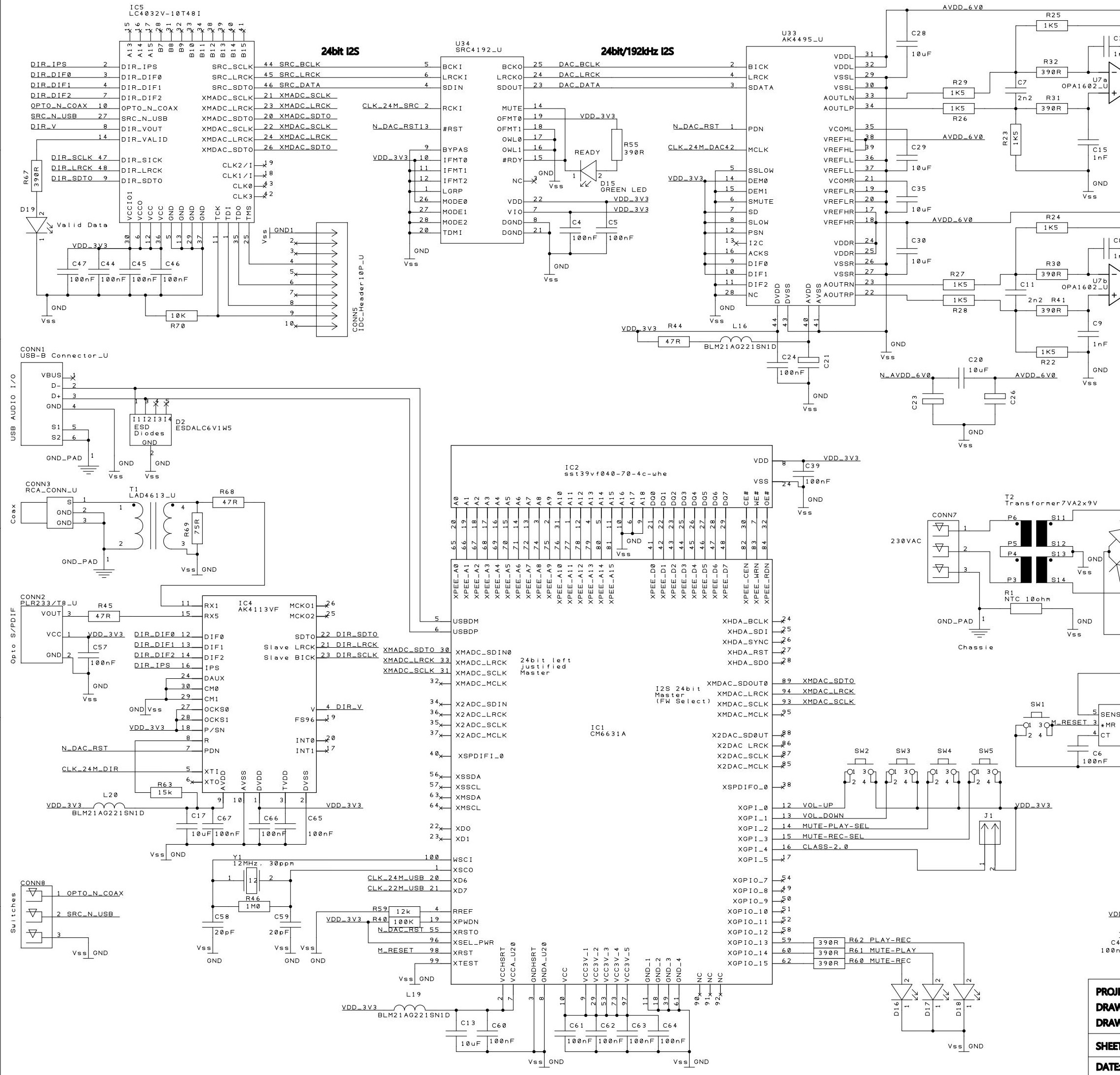

It took some more time to come up with a new version. The reason is that I had to add a CPLD mainly due to the need of a direct/drc switch and that the firmware of the CM6631A using the XMADC input interface uses 24bit left justified data and is master (my conclusion after reading documentation back and forth a few times). The design would have been more clear if it was a I2S slave interface. But as I dont want to go into firmware changes, I could not see another solution. Just hope it works.. Comment are more than wellcome 🙂
By the way, I'll keep the ESD diodes on the USB lines for extra protection. Impedance matching = yes I will do.
