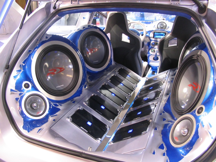

I guess you need to decide if you in the 'subtle and classy' category or the 'all out' kind of approach...
Simple and classy. SQ over SP.I guess you need to decide if you in the 'subtle and classy' category or the 'all out' kind of approach...
