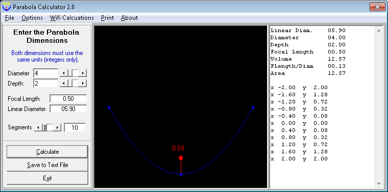

What does a parabolic waveguide do?

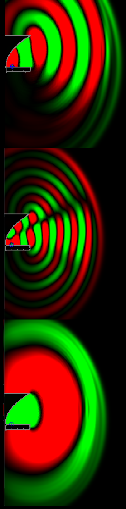

Using the ripple simulation applet from Falstad:
Ripple Tank Simulation

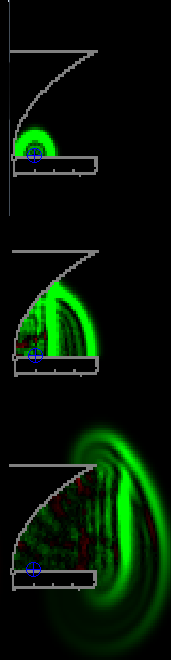

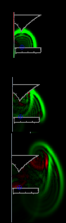

I see a number of effects that would guide the designer to use small platters relative to the wavelength.
Firstly the wavefront radiates spherically until it contacts the waveguide. It then reflects and converts to a straight / cylindrical? wavefront. Two wavefronts exit the waveguide which is a distortion which might be measured as group delay ?
Secondly the wavefront reaches the platter edge and creates a diffractive wave. this seems stronger at the top in the lateral directions where the guide is more open at the base?
Thirdly the waveguide has an acoustic structure that forms a low pass filter with a cut off near where the opening is close to one (or is it half?) a wavelength.
The directivity of the driver would mean that the waveguide would only be called on to redirect the wave off the driver axis at the higher end of its range so presumably the actual dimensions of the parabola and platter are key characteristics determined by the driver diameter and the crossover frequency?
Note: The app can generate a parabola and it is close to the display edge so I only generated half the guide.
