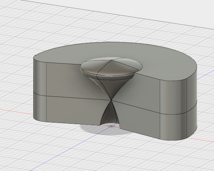

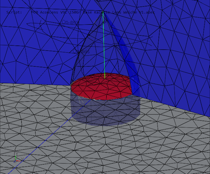

I made an ABEC model of one of these Beolab lenses
Here's the real thing
Here's the frequency response. Gnarly, mostly due to a vertical resonance inside of the lens and massive diffraction off the exit of the lens.
Here's the horizontal and vertical wavefronts. Note the diffraction at the exit of the waveguide.
I can only guess on why the performance is so terrible, but here are a few thoughts:
1) It clearly needs some kind of treatment at the edges. Those sharp edges are no bueno.
2) I have a hunch that the height is really critical. If you look at the wavefronts, as frequencies get shorter (higher) the wavefronts are really asymmetrical, which is bad.
3) A few years ago, I made a SAW lens that worked really well, and I recessed the tweeter. That seems to help a lot:

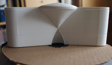

Hi Patrick,
As most people here are probably not registered at the German DIY Hifi Forum (needed to see images), I could post results of the simulations and the measurements here, if there is interest...?
It's this acoustic lens here:
3D-CAD model
Printed model

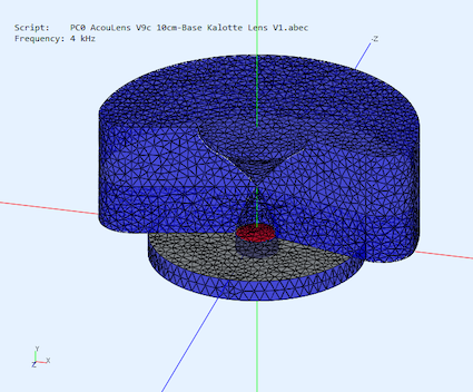

OK - here we go. I'm basically summarizing images given in post #49 in the thread to be found on the German forum and give some explanations and notes.
This is the ABEC model of the acoustic lens on a 10cm diameter base plane used for simulations:
Note that this acoustic lens model has been printed and used for comparative measurements.

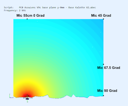

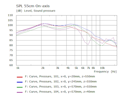

Simulation of the SPL at different mic postions at 55cm distance:
The mic positions used for the simulation above:
Red curve is 90deg, Blue is 67.5deg, Green is 45deg and purple is 0deg (i.e. on axis or directing to the ceiling).

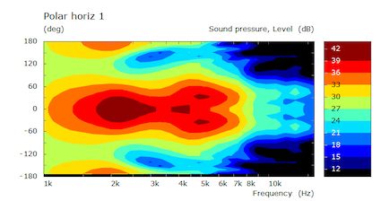

The horizontal directivity given as a polar, 360deg:

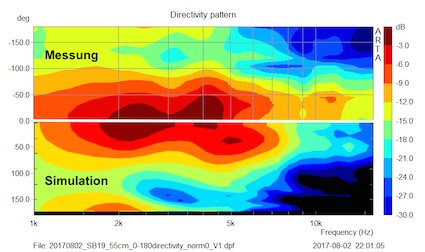

Now it starts to get really interesting - comparison of simulation and measurement of the model:
Measurement upper half of the image, simulation lower half.
For sake of completeness the horizontal directivity normalized to 0deg:

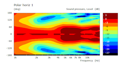

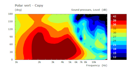

I was quite satisifed with the horizontal polar response - but what happens with the vertical response?
The simulation, 0-180deg:
And the corresponding measurement:
From my point of view, simulation and measurement comply pretty well. However, at that time I was not completely satisfied with the vertical directivity: Too much radiation to the ceiling. I did some attempts to minimize potential ceiling reflections later on.

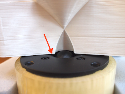

Finally an important difference between simulation and measurement: Within the simulation I assumed a 'perfect' fit of the 3/4''-dome to the 'entrance' of the acoustic lens:
In reality, the SB19-tweeter has it's own geometry on the tweeter front, i.e. the dome is shifted slightly back and the front plate opens a bit - resulting in a non ideal, real-world coupling of the tweeter to the acoustic lens:
This might have contributed to the observed differences between simulations and measurements, beside the probably non-ideal behavior of the tweeter dome ar high frequencies.

My sim from yesterday seemed to indicate that there's a lot of diffraction off the edges of a Beolab lens.
This would make sense because:
1) The top of the lens is symmetrical, and sound hates symmetry
2) The top of the loudspeaker enclosure has a sharp edge, and high frequencies hate sharp edges
On the upside, there IS an effort to reduce diffraction on the horizontal axis.
The Grimani speakers add a circular baffle and use a lens that at least twice as large.

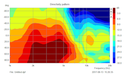

So I did the same. I increased the diameter of the lens from seven to ten inches, and I reduced the height of the phase plug. I also added a baffle to the whole thing.
Here's the predicted polars
Here's what the wavefronts look like
Here's some things I notice:
The upper part of the lens, the "hat", succesfully flattens the wavefronts, but only over a limited bandwidth. Up to about 4khz. Above that, the height of the lens is too short to "flatten" the wavefronts. (4000hz is 8.5cm long, and the lens is about 7cm in height.)
So I'm only speculating here, but the data seems to indicate that the beamwidth is well behaved on the horizontal axis,but on the vertical axis, things are trickier. Christoph's posts seem to confirm this.

To illustrate how the lens works, I made a 3D model of two speakers:
1) The first speaker is a conventional speaker, with a square conical waveguide with a coverage angle of 90° x 90°. It measures 27.5cm in diameter. Based on those dimensions, it should control directivity down to about 1227Hz and it should "load" the tweeter to about 675Hz. It's a typical audio waveguide.
2) The second speaker is a crude duplicate of what's in the Beolab 60. The cabinet is 30cm wide and 30cm deep. The tweeter sits atop the cabinet in a SAW lens that's 12.5cm wide. The "hat" at the top of the lens is 17.5cm in diameter. This isn't an exact clone of the Beolab 60, I don't have one sitting here. But it's close.
At 10khz, here's what the wavelengths look like. The wave is barely larger than the throat of the waveguide. That's why phase plugs and smooth throats are so important above 5khz; these wavelengths are TINY.
For the most part, horns don't raise the efficiency of a driver. They simply focus it's output into a narrower beam. That's how we get crazy efficiency in a horn; we're taking the sound that might normally radiate into a very wide angle and we're bending it into a narrow beam. In these pics, at 5khz, you can see that the bending is happening. The flat surface at the top of the speaker with a SAW lens is restricting the radiation into a narrower angle. The waveguide in the conventional speaker is doing the same. Where things get tricky with the SAW lens is that we need some type of device to "flatten out" the wavefront. Basically we have to turn the spherical wave into a planar wave. B&O could've skipped the lens entirely and could have simply used a ribbon, which produces a flat wavefront by default. But a dome tweeter has more output. Plus, I like difficult challenges, and using a ribbon would be easy!
Here's my most successful acoustic lens. That cone shaped device at the top isn't there for looks, it serves an actual purpose, it bends the wavefront 90 degrees.
The important takeaway from these sims, is that it's not just the lens that does all the work, it's the entire device. The hat at the top, it serves a function. The cone serves a function. The baffle behind the tweeter is there for a reason, and the roundover is there for a reason too. The big flat surface at the top of the speaker is there for a reason too, it allows the tweeter to play lower in frequency.
At 2500Hz, the wavelengths are getting fairly long. At this point, the conventional waveguide is still constraining their radiation. In the SAW lens, the sound is beginning to radiate to the back. In the pic, it shows that the sound has "wrapped around" entirely, but it doesn't do this in the real world. In the real world, you'll get diffraction off the edges of the baffles, which is the reason that the Beolab 5 has those rounded edges on the baffle.
I don't agree with this. I think the device is actually quite simple. I am also a big fan of it; I'd argue that it's probably the best device I've ever come across for bending an audio wavefront. There are a zillion different ways to redirect sound at an angle, but the SAW lens performs shockingly well. It works so well, that sometimes it can even outperform a conventional waveguide. It's not the "end all / be all" solution but it's quite elegant.
