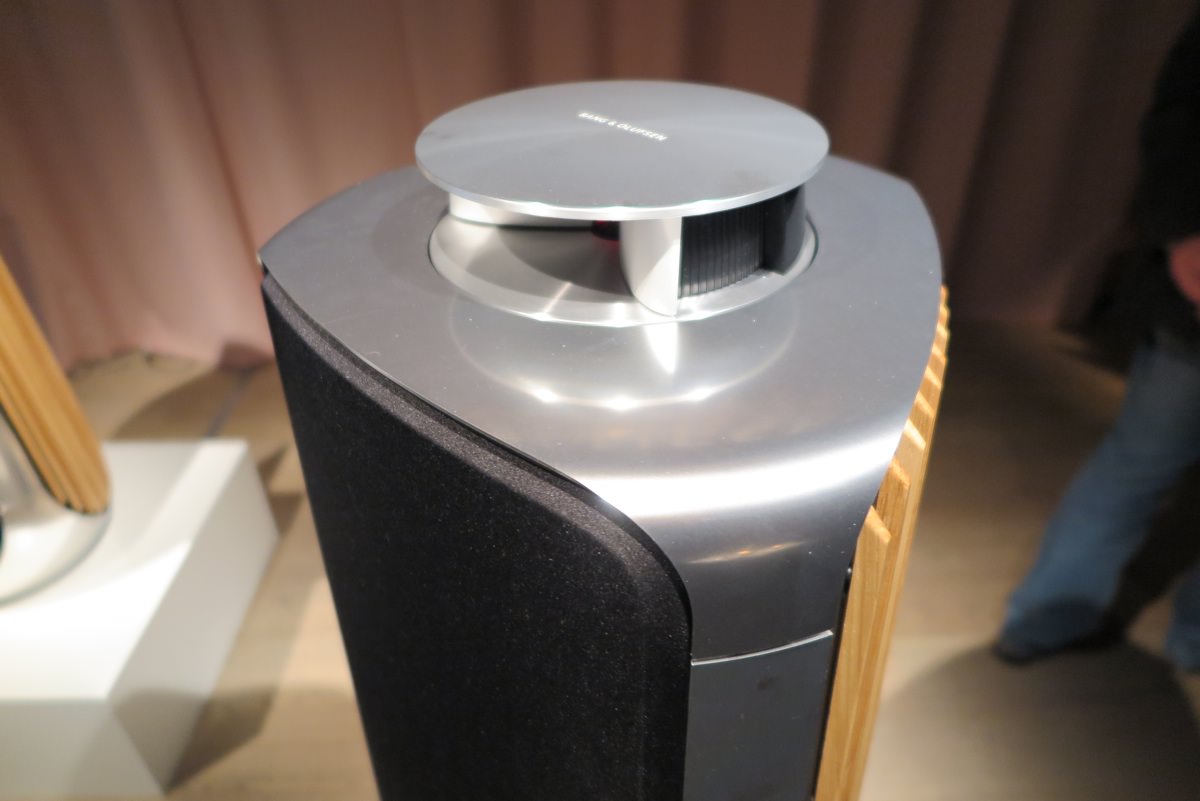

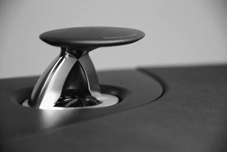

Here's a B&O lens. The "hat" and the diffraction slot form an arc. It was designed by Manny La Carruba for Sausalito Audio Works and licensed to B&O
Here's one of my lenses. Basically a mish-mash of one of Don Keele's biradial horns and a SAW lens. The diffraction slot is a segment of an arc and it connects to a cone. So it's halfway between the B&O desing and the Grimani Systems design. IIRC, I designed this long before I saw the Grimani speaker. (It's a fairly obvious extension of the SAW lens.)
Here's a Grimani Systems lens. The "hat" and the diffraction slot form a cone. It was designed by Manny La Carruba for Grimani Systems. (Pictured.)
Here are the wavefronts of a Beolab/SAW lens, one of my lenses, and a Grimani lens. In that order.
Note that the sim says 4000hz but it's actually 16khz I scaled everything up 4x; that's why it's 16khz but it says 4khz.

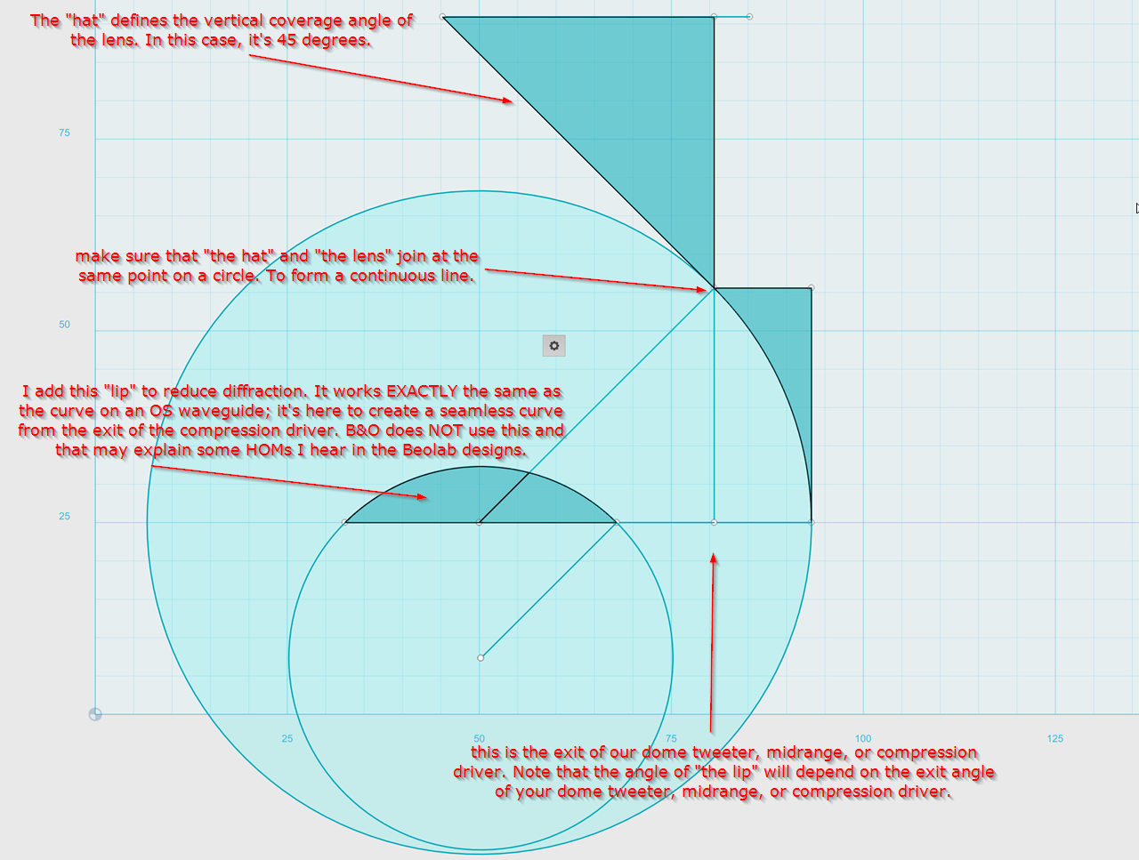

Patrik, on your lens what determines the radius of the larger circle? I noticed the Hat hangs out over the bottom bump too.
edit:
looks like the radius depends on the exit angle, makes a right triangle, how cool

The radius of the large circle is dictated by two things:
1) how big is your tweeter? Smaller works better. B&O uses 3/4". Sausalito Audio Works uses a BMS compression driver with a 1" exit. You can compare them to each other by examining my measurements; I have used both compression drivers and domes in my lenses. Either works, it mostly depends on how much SPL you need.
2) The other factor is the vertical beamwidth. This is because the 'hat' meets the large circle at a point that's tangent on the circle.

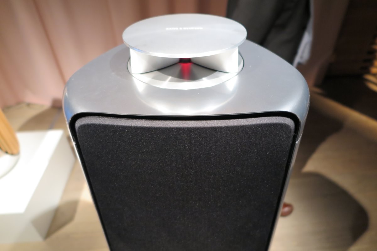

Here's a cutaway of a Beolab 5. Note how the SAW lenses are a small fraction of the size of the lens in the Beolab 50.
