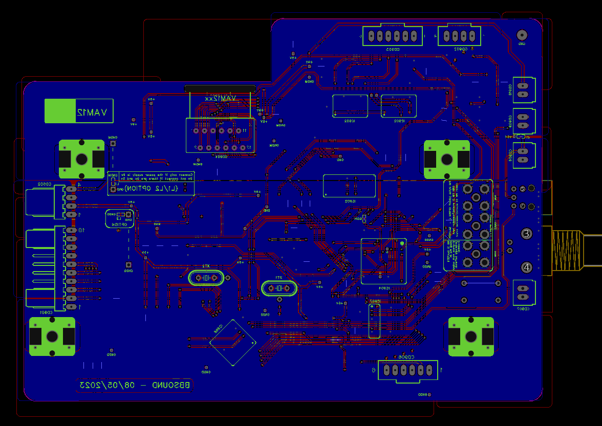

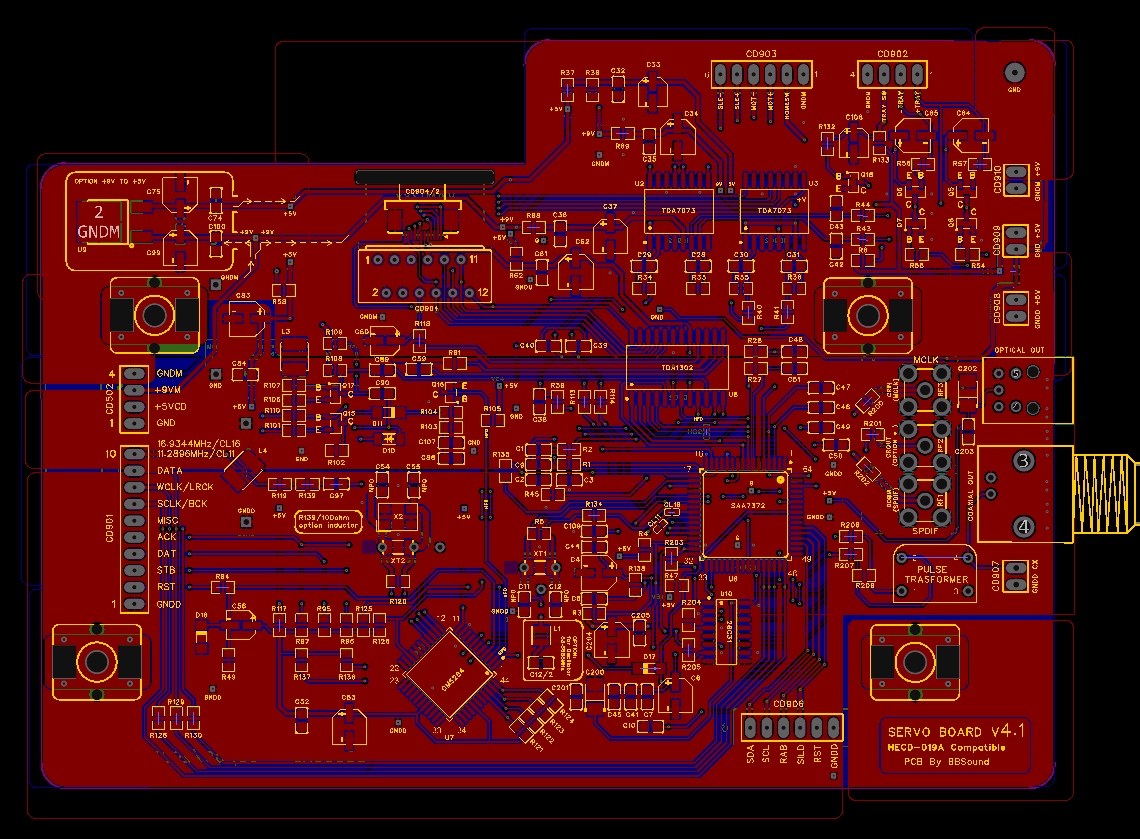

Clone SERVO CD HECD-019A for PHILIPS CDM12.1
Dear Sergio, I am working on an Audionet ART G2, based on Marantz CD63 or CD6000. As far as I can see the communication pins which are labeled AuxBack, AUX1 Data and AUX3STB on HECD-019A are labeled DSA ACK, DSA DATA and DSA STRB on the Audionet connector. Would your board support this kind of communication?

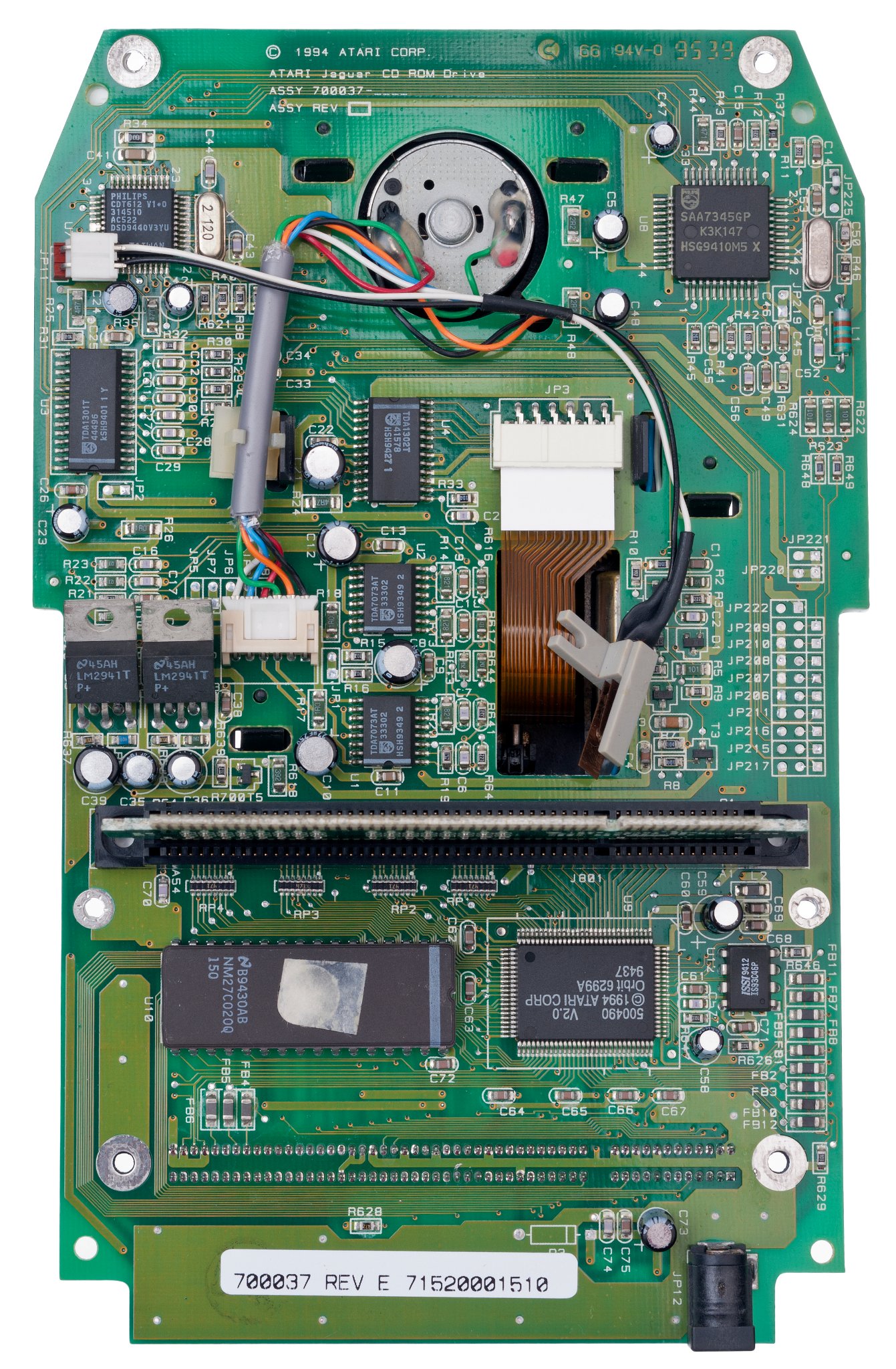

  • Atari_Jaguar_CDROM_Schematics.pdf

Servo controller HECD-019A:

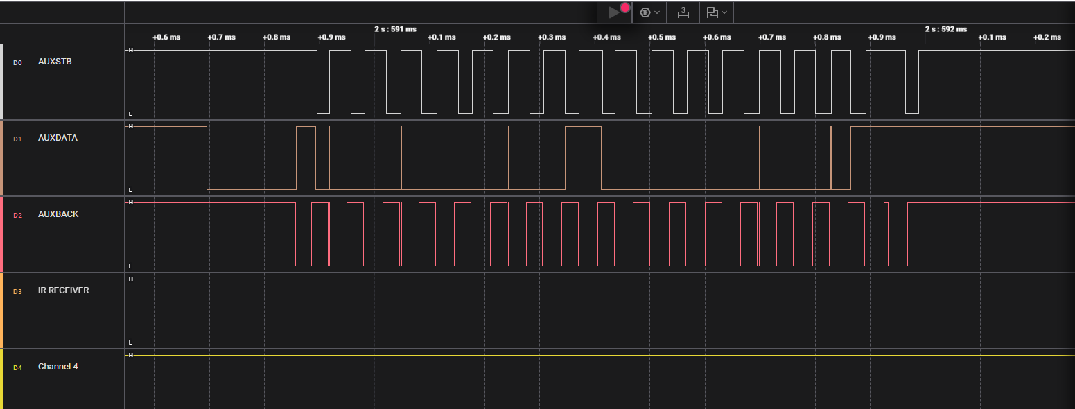

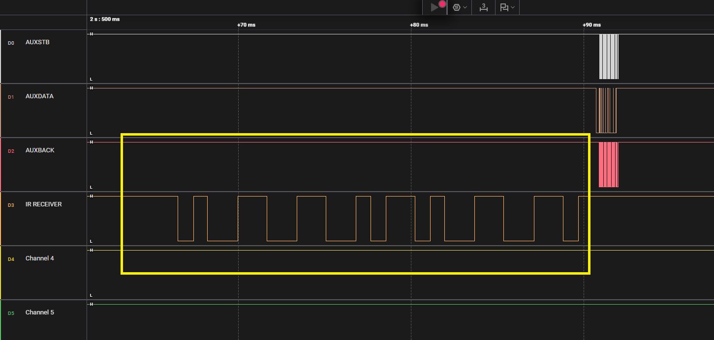

Using a logic analyzer this is what sends the firmware to the 87C58 connected to the AUXSTB AUXDATA, AUXACK pins, highlighted in yellow the IR code sent by the remote control.
We can finally clarify what is actually sent on the AUXDATA line, what code represents the IR command and how to replicate it correctly.
In the first image you can see a classic Philips DSA type parallel transmission sequence:
AUXSTB (D0): acts as a clock or strobe: each transition signals a new bit or a new byte.
AUXDATA (D1): contains the serial data bits to be transmitted.
AUXBACK (D2): is probably an acknowledge line (ACK) or a response from the module.
IR RECEIVER (D3): confirms the reception of the signal from the remote control.
The output code is not pure RC5 or NEC. The internal microcontroller converts the received RC5 command (e.g. 0x35) into a sequence of parallel data transmitted as a DSA command.
Example: "Play" command
When the remote control sends the RC5 code 0x35:
The microcontroller transmits on the AUXDATA line the sequence that, according to the DSA datasheet, is:
Play = 0x01h + Parameter (e.g. 0Ah for track 10)
→ So: 01 0A
In your signal it seems at least 2 bytes are sent, and they are probably:
First byte (opcode): 0x01 = Play title
Second byte (param): 0x0A = track 10 (default if the firmware does not change value)
So the IR code 0x35 is only used to:
Activate the "Play" function in the microcontroller firmware.
The firmware then generates the complete DSA codes (opcode + parameter) on the AUXDATA and AUXSTB lines.
So what code do you need to send "Play" manually?
If you want to simulate directly via Arduino (without using the remote control), you need to send:
AUXDATA = 0x01; // command "Play title"
AUXDATA = 0x0A; // parameter: track 10
With AUXSTB changing from H to L at each byte.
Conclusion:
The IR code 0x35 is not the real DSA command, but a trigger for the microcontroller that then generates the real DSA command.
If you want to control the mechanics directly, you should bypass the microcontroller and generate the AUXSTB + AUXDATA signals via Arduino or other micro.
So, given your experience, the question is: is it possible to send commands directly to the SAA7372/SAA7327 CD decoder digital servo processor bypassing the various P87C58 OM5284?
I have successfully extracted the contents of the .sal file from the Logic 2 software. The binary files correspond to the various digital channels analyzed, while the meta.json file contains the project metadata (channel names, sampling, duration, etc.).
I will now analyze:
the meta.json file to understand which signal each channel corresponds to (e.g. AUXSTB, AUXDATA, AUXBACK, IR RECEIVER, etc.),
the binary segments to identify the command sent for each button (Play, Pause, Stop).
Proceed with the analysis of the meta.json file.
I have analyzed the meta.json file of your Logic 2 project, and now we have the complete correspondence between digital channels and signal names:
Channel NameDescription
D0 AUXSTB Command strobe signal
D1 AUXDATA Serial data sent to the CD controller
D2 AUXBACK Response/ack from the controller
D3 IR RECEIVER IR receiver output
D4 Channel 4 Free or unlabeled
D5 Channel 5 Free or unlabeled
Now that we have the channels clear, I can:
decode the sequence sent on AUXDATA during a command like "Play",
compare it to what is expected in the datasheet (e.g. command 01h + parameter xx for "Play Title"),
deduce the complete code sent via AUX.
Now I would like to try to analyze the first command transmitted (e.g. the one related to the first "Play") to determine the real data packet sent (opcode + parameter).
Attached is the log using the Logic 2 software so just download the software from the site to view the file content.
Were sent 4 commands, Play - Pause - Play - Stop.
