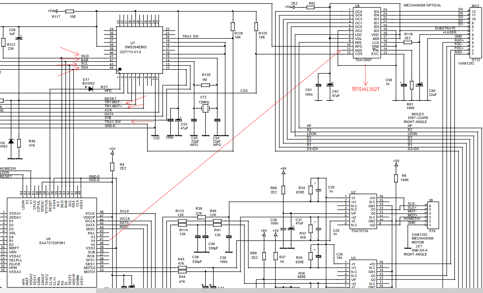

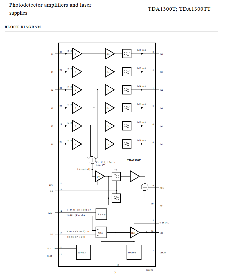

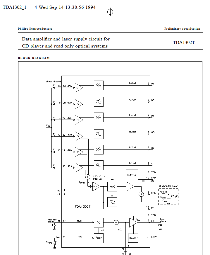

for example, it would seem to recommend the TDA1302, but what would be the differences between the TDA1300 and the TDA1302. For me none according to the datasheets.
that red line between pin41 SAA7372 and pin11 TDA1300, I don't understand what it means, a connection between the two pins?

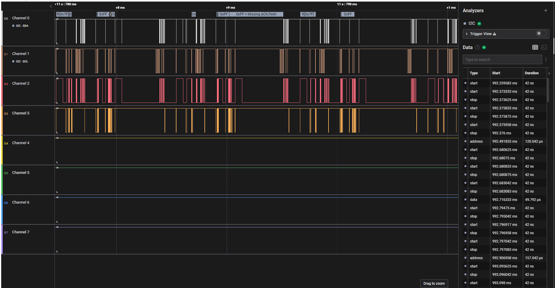

reading with logic analyzerif you have a logic analyzer or something similar, you can view if the error and subsequently eject of the disc is on disc reading or protocol mismatching
CH1 - SDA
CH2 - SCL
CH3 - RAB
CH4 - SILD

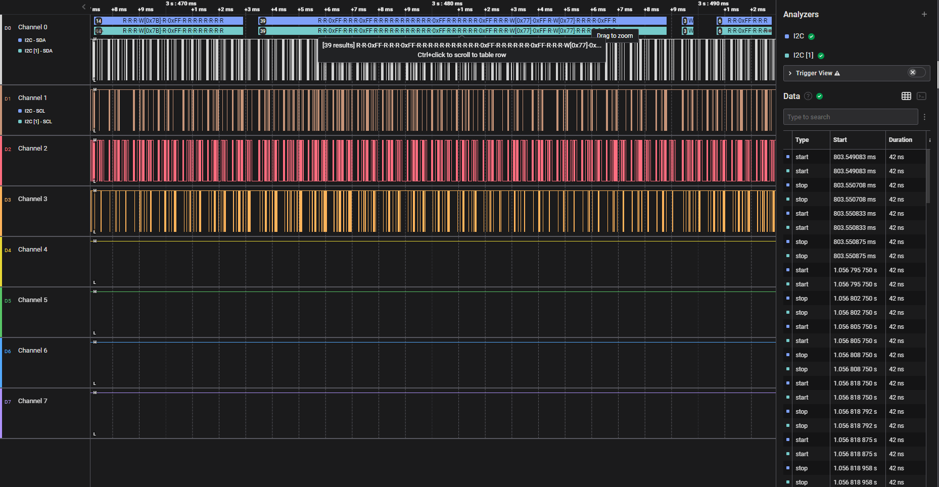

The first macro event that i could see is the missing ack/nack at 9ms of the time line. It seems that there are a series of the same sequences repeated....and instead with the hecd servo board, there are differences? (with the same disc inserted)
result with HECD
if you want to analyze the file just download the software at the attached link, it's free.
https://www.saleae.com/downloads/
what‘s the frequency of the XTAL you use for SERVO? 8.4672MHz, cause the OM5284 using this by default! Would you send me your schematics to check it?

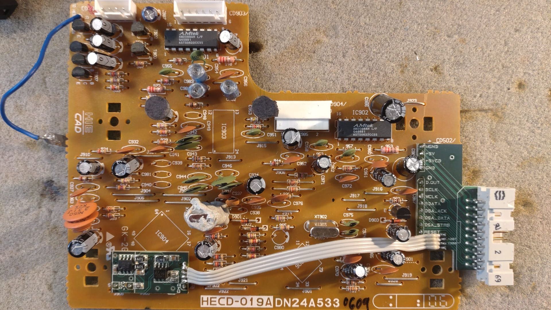

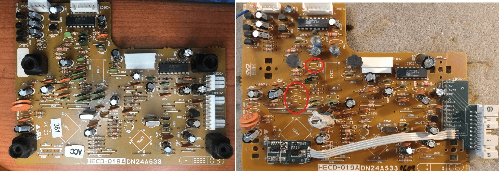

PCB with assembled components

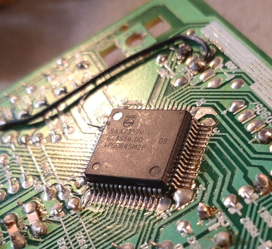

the wiring diagram I used for the PCB is the one you sent me.I just tested it and I made a big discovery! The board using SAA7372 uses I2C communication to be fully compatible with SAA7327! This is something I've always wanted to test, tried it today, it's the same! In other words, OM5284 can replace your P87C58! But there is a difference in wiring because the OM5284 uses SILD and RAB, just like the circuit of the CDT-713 I attached! Like datasheet, the SAA7327 is just adding some new registers to the SAA7372! The software is compatible!
Circuit of the CDT-713.
