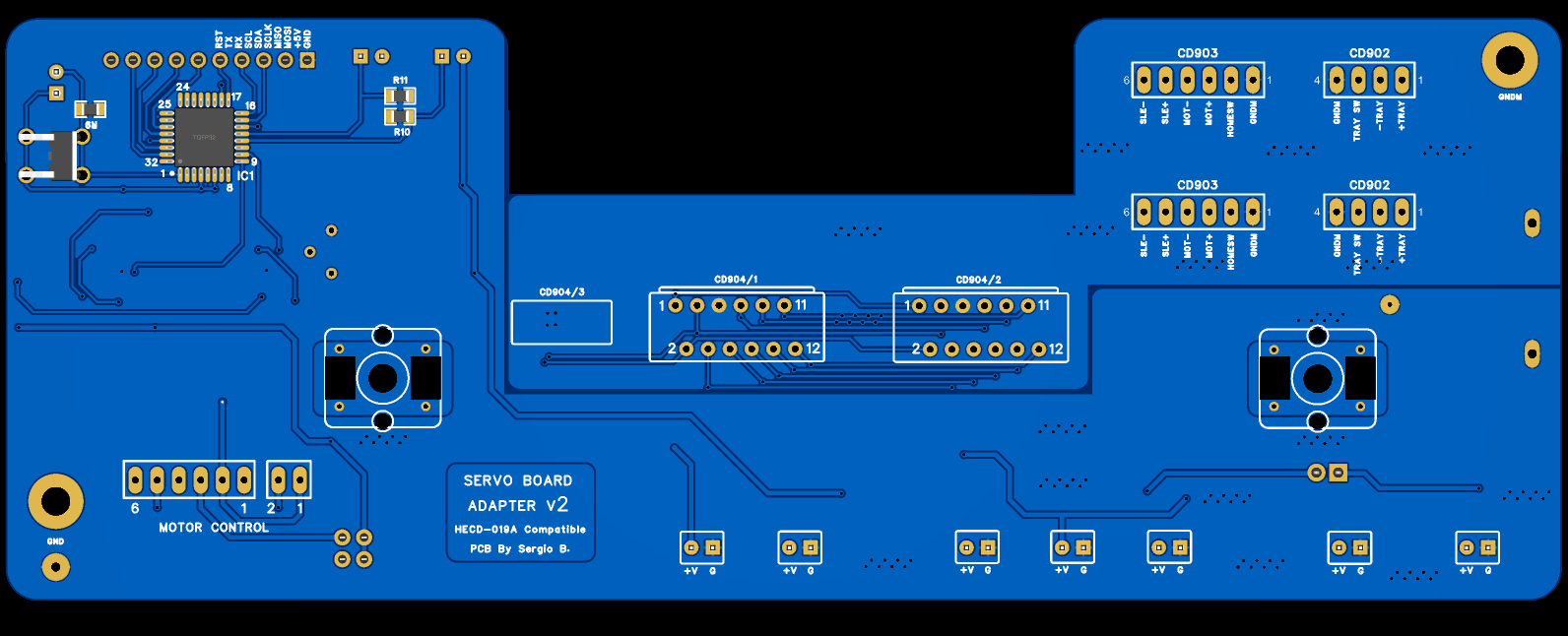

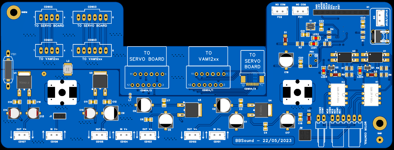

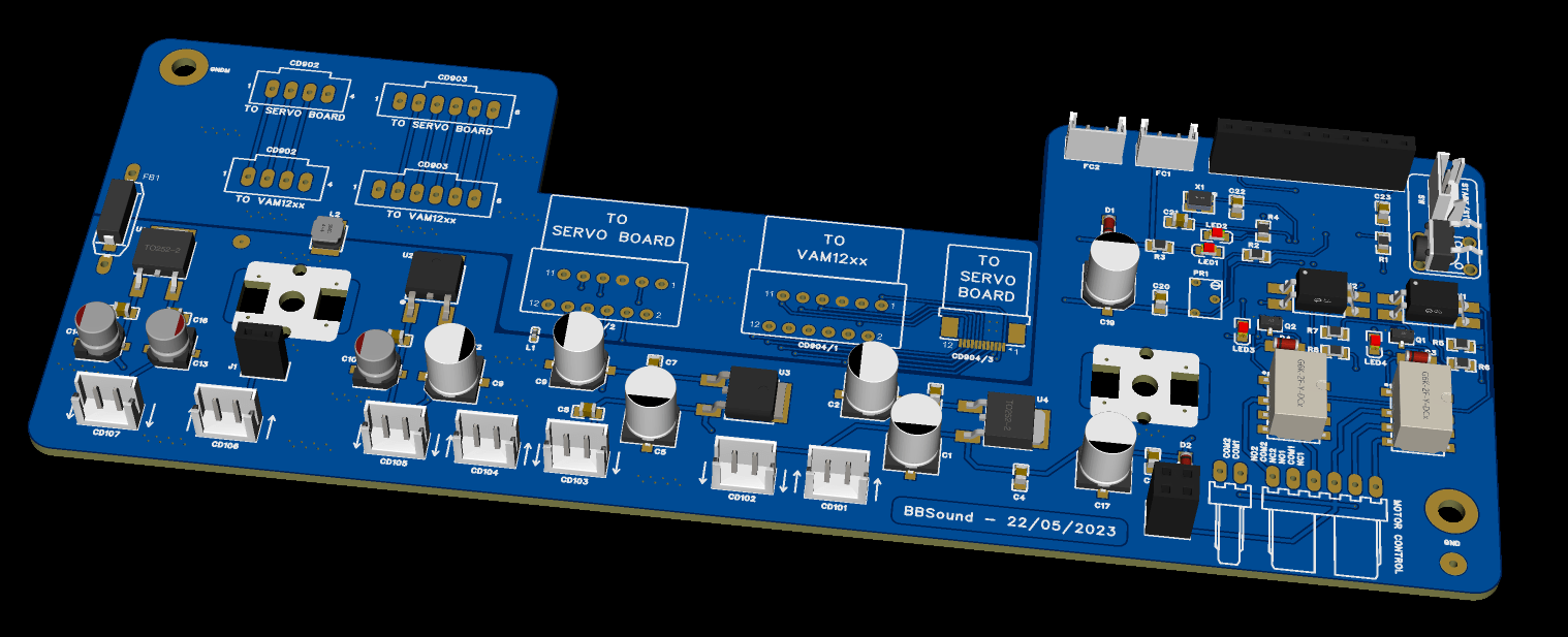

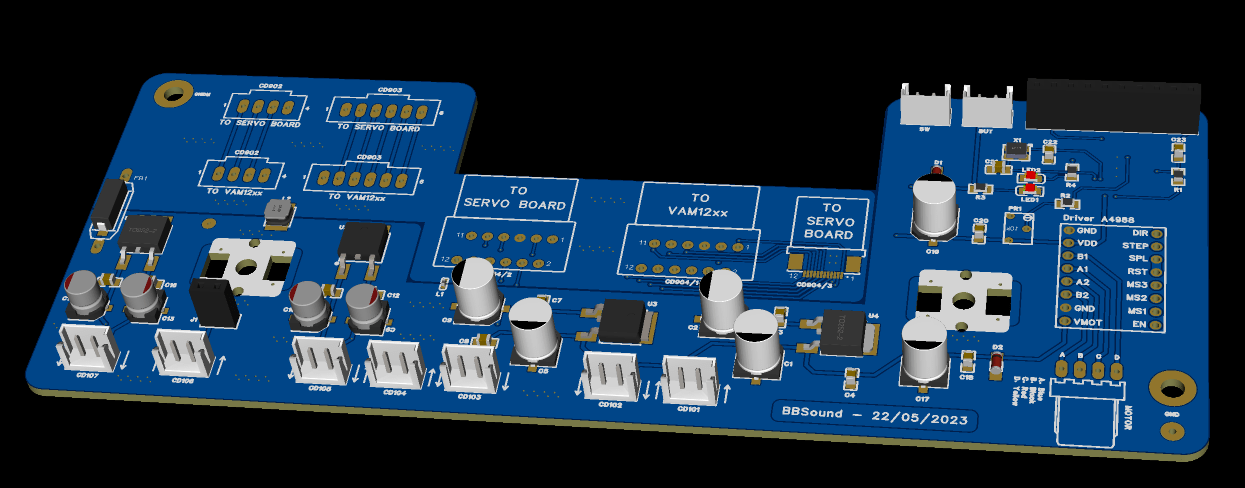

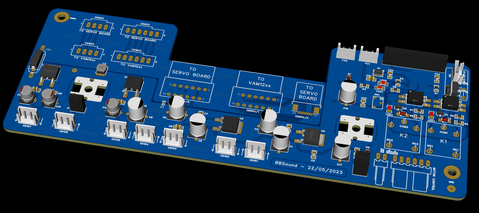

In this last month, a few ideas have come to my mind. Redesign the mechanics. For example, the mechanical drawer stepper motor controlled by the adapter board elaborated by HEC-019, developed with built-in arduino atmega328 and 3 variants. One for A4988 motor operator, one with 2 SRA-12VDC-CL relays, one with 2 G6K-2F-Y DC12 micro relays. You will say if I'm crazy but the idea was born with the logic of using your project at will. All three have built-in DC voltage regulation circuits: one 12V, two 5V, and one 3.3V.This is the CDM12 I made back then, without DSA control. Control I2C directly with the MCU. The output uses DIT 4192 as a digital output.
Logically, the board in question will then be connected to the Servo Board HEC-019.
Bottom Layer with Atmega328
Top Layer with A4988
Top Layer with Relè SRA-12VDC-CL
Top Layer with Micro Relè G6K-2F-Y DC12

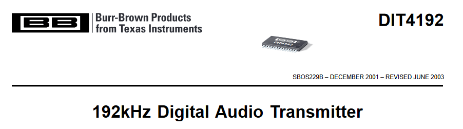

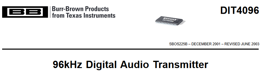

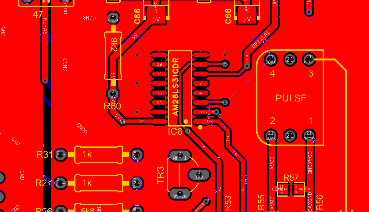

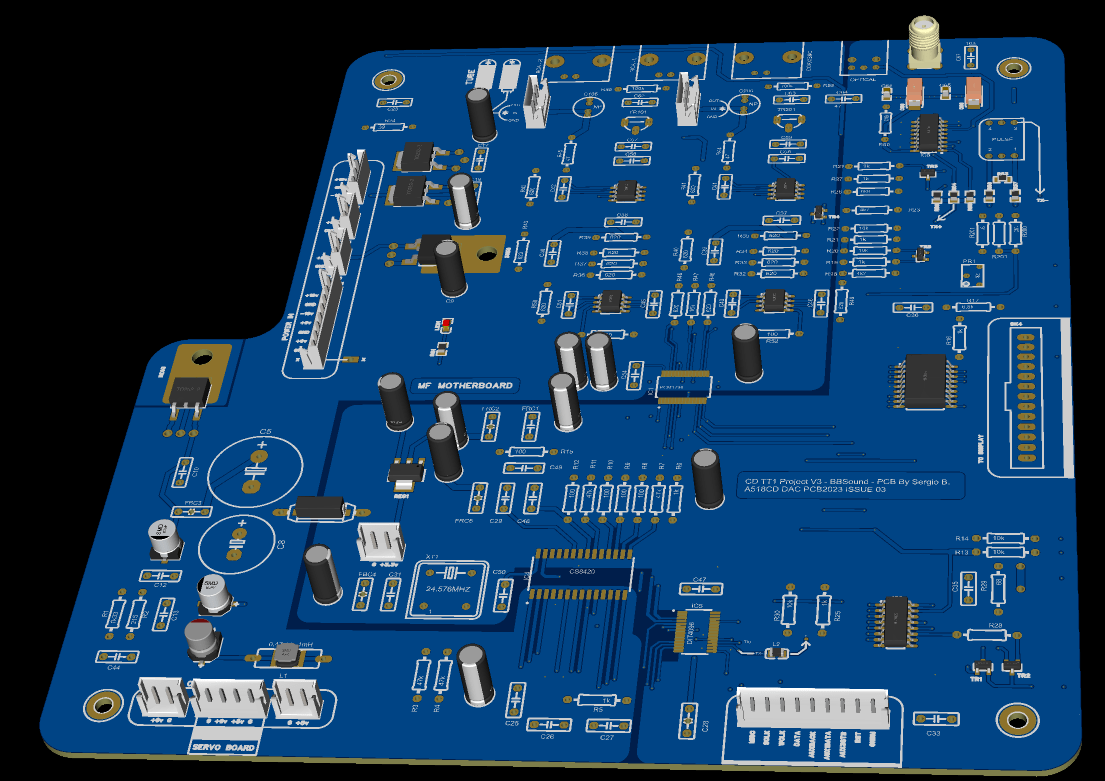

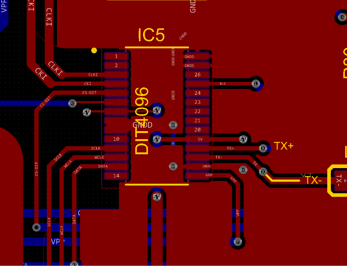

in my project i use DIT 4096. downstream from the motherboard a AM26LS31CD with the possibility of the by-pass.

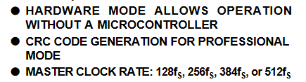

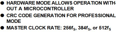

from the datasheet the differences between the DIT4192 (192kHz) and DIT4096 (96kHz)
the connection pins are practically identical

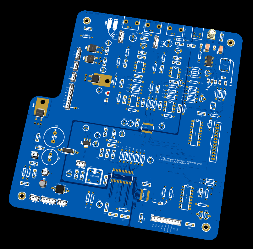

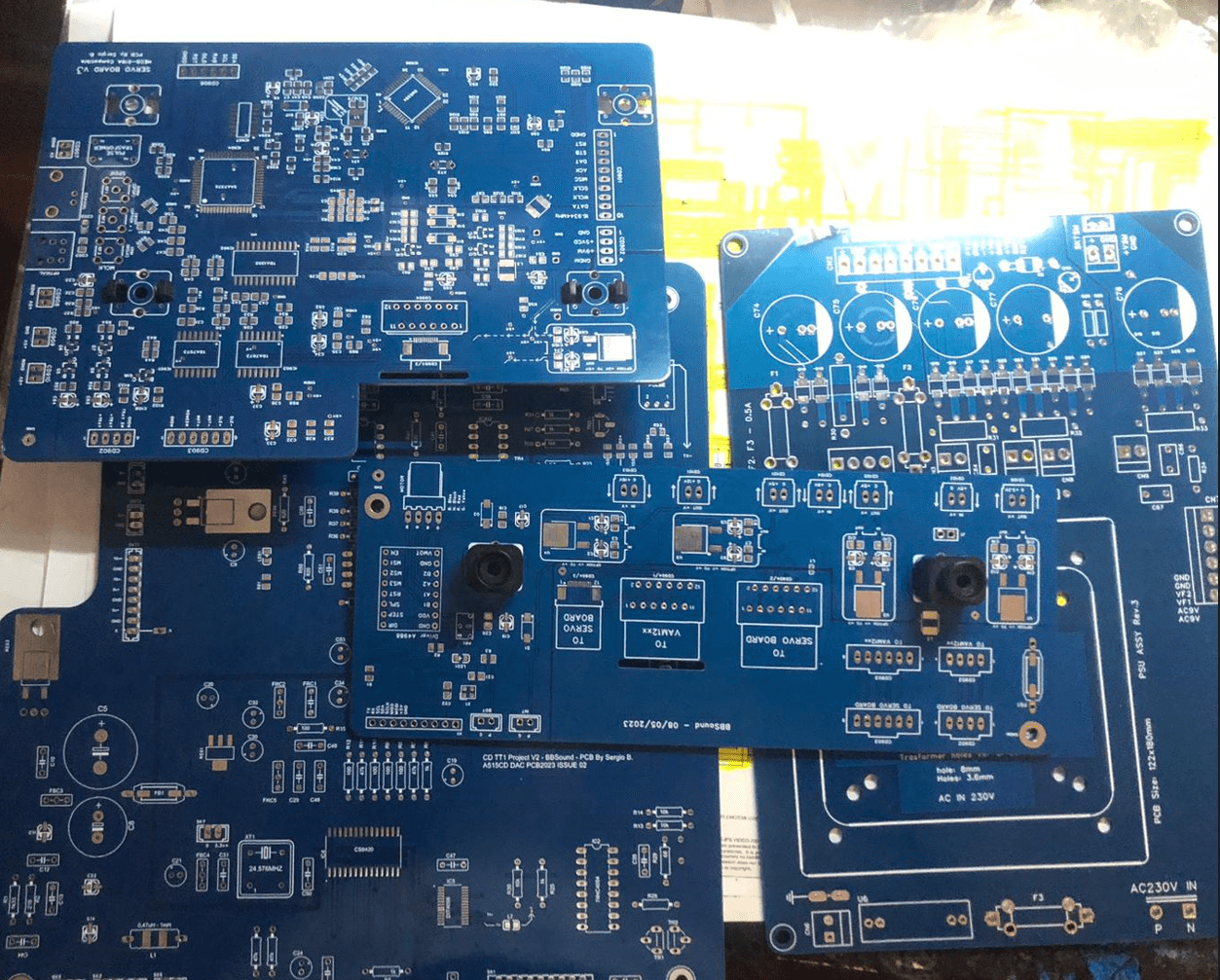

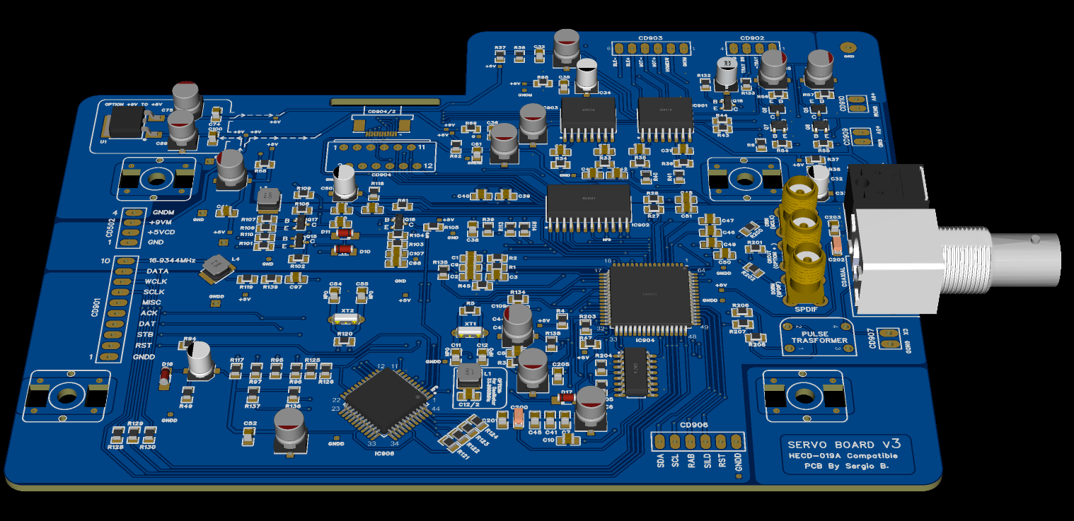

hello cac liuI just tested it and I made a big discovery! The board using SAA7372 uses I2C communication to be fully compatible with SAA7327! This is something I've always wanted to test, tried it today, it's the same! In other words, OM5284 can replace your P87C58! But there is a difference in wiring because the OM5284 uses SILD and RAB, just like the circuit of the CDT-713 I attached! Like datasheet, the SAA7327 is just adding some new registers to the SAA7372! The software is compatible!

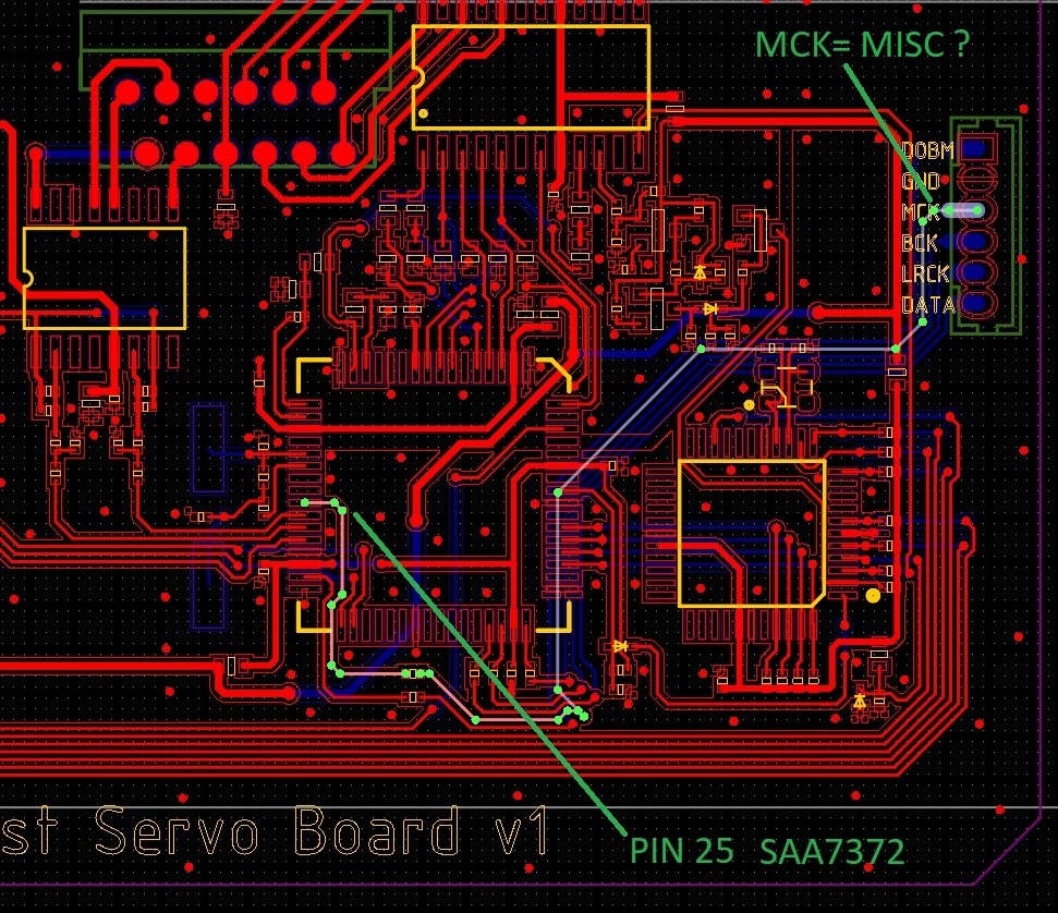

can you send me the gerber file or from where did you get the board i want to compare with mine. I'm having problems, I can't get it to work.
thanks for the file!Here it is!

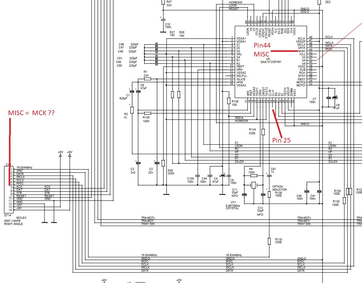

I checked your gerber project and compared it with the CD7 schematic (DSA 1disc)-3.PDF you sent and I find an error. Pin 25 of SAA7372 on the schematic is not connected, in your Gerber file it is connected to pin 25 of SAA7372 at MCK output connector. What would MCK be, is it the MISC output, file "CD7 (DSA 1disc)-3.PDF"? Why is it connected to Pin 25 of SAA7372? Do you have a different outline of your project?
Indeed Pin 44 SAA7372 MISC in your gerber file is not connected.
My cd8 do not using MCLK, it got PLL on DAC board, and it's very clear for the clock, CL16 for 16.9344M, CL11 for 11.2896M.
OK thanks.
All very clear.
the schematics is not my board's schematics, it is a VCD's schematics. VCD using the MISC for other things.
Do you have the schematic you used to make your project?
