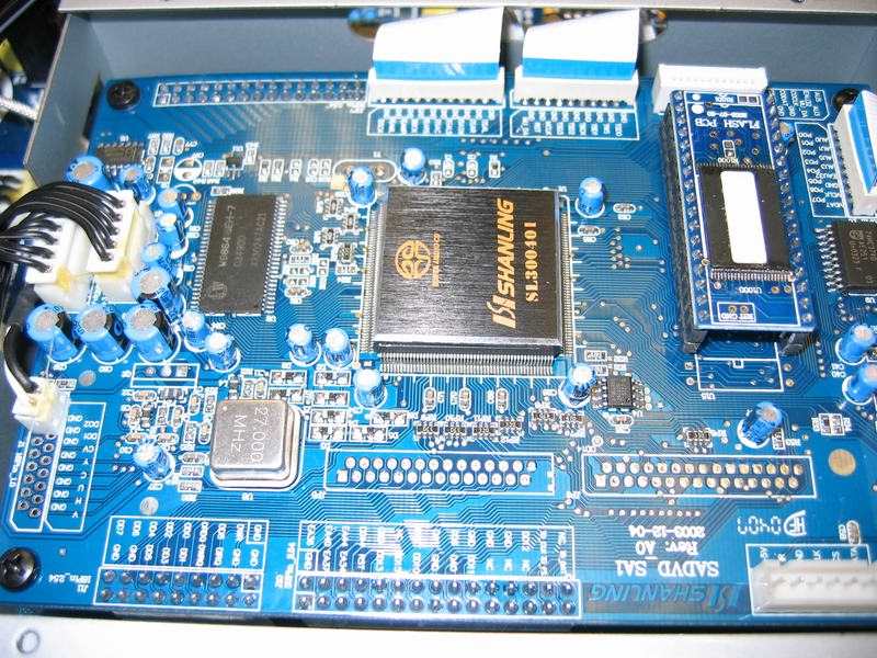

driver board
I'm going to have to go in there,and clean up the entire PS all around those driver boards, simply to get the best as is possible from the compromised design of the unit. I've no idea who's is better though: I find it not good to unessessarily pick on Shanling, who knows how the rest of these units (SACD Players in general) are designed and executed. Luckily, I have about 30 values/voltages of SP series OS-CON's lying about....
Here's a photo of the upper-most driver board, it is directly under the centerally located drive mechanism. Both stacked boards are in their own separate steel box, along with the drive mechanism. The SACD chip is located onthe lower board, along with the 33 mhz clock. As you can see, the 27mhz clock is on this particular board. Under the shanling heat sink, is a DVD video chip of some sort. You can see the lable on the bottom right corner, if you can read upside down. 😀

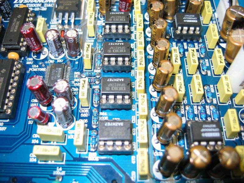

SS ouput boards, before the tube output section
Here's a fairly clean image of the stock form of the SS/DAC output boards. Overall. it's very nicely done. As ususal these days the darned traces are VERY fragile. So constant part swaps are a big no-no. Find the right replacement part, change it out once, and leave it alone. I was very scared when I pulled the xo's. I was very lucky in that the boards (drive/xo boards) remained undamaged.
They are directly beside the drive mech's steel box. In the image of the drive mech boards, you can see the ribbon cables coming off the top of the image. Those two ribbon cables are connected directly to the O/P-(pre-SS)driver/DAC board, which the connection points are just out of sight on the left of the supplied image.
The digital volume control (TI/BB's latest digital volume chip) is to the right in this image, and there is decent 'look' to the board. If you follow the tech manual for the PCM1738..you will find that this is likely to be an exact duplicate of the suggested 'design' for utilizing the PCM1738, as suggested by TI/BB- as far as I/V and output section goes. Actually, it is....identical.
Nicely done, but overall..not very inventive. It works, and it would be harder to create a better layout, unless you wanted to use borbley's discrete amps instead. But.. you might as well design your own SACD/CD player at that point. There is enough room to put items above and below the boards, so modding is almost a 'dream'. The boards are all on metal brass stand offs. All boards.
I always find it amazing or ..depressing when I open up a high priced item and find the exact copy of the implementation instructions (tech manual copied layout) for a given chip or series of chips. I feel a monkey can do that, these days, with all the board layout software. Hell, I could do a better job!!! Doesn't anyone actually think about these things anymore? Where did all the real audio designers go???? Or were there never actually any, and I'm only coming to realize that now?
Edit: I will clarify that I do know there are some exceptional 'real' designers out there. These days, most/many companies seem to rely on spec type jobs, with little or no true inventivness.
It is all the other aspects of making/creating/running a company that makes such efforts exceptional. Any moneky can design these days. Keeping a company viable, or actually getting a product to a market, in an effective fashion ---now THAT'S the real challenge.

KBK said:
Nicely done, but overall..not very inventive. It works, and it would be harder to create a better layout...
I always get horrified about the way manufacturers (including "high-end") use op-amps.
There's a lot to improve on the PSU layout of the op-amps there.
Welcome to reality.
Did you think you had something original in your hands?😱
No, most gear is datasheet or appnote implementation, most of the times with a horrible PCB layout.
I've opened too many gear over the years and nothing shocks me anymore.
Original is getting the pre-outs from the outputs of the power amp (speaker-level), attenuated and buffered with a single transistor. 😱
This is how Yamaha makes it on some AV receivers.
So why are you shocked?:clown:
Way back in '87 or so.........
When I worked on my first CDP (a "Maggot Box" CDB-472), I was horrified at how poorly the PCB was laid out. Especially wrt ground. Ground was ground, except when it was easier to run the bypass cap to some other rail that had its own supply. The noise, hum, ripple, and plain ol' **** on the rails was easily seen on the most rudimentary of test equipment.
My initial thought was that I would fire the junior engineer that did it if he worked for me. Then it hit me.............no engineer did it..........an autorouter did it.
Sure, with skill, they could have manually routed the critical analogue ground returns. Draw your own conclusion(s).

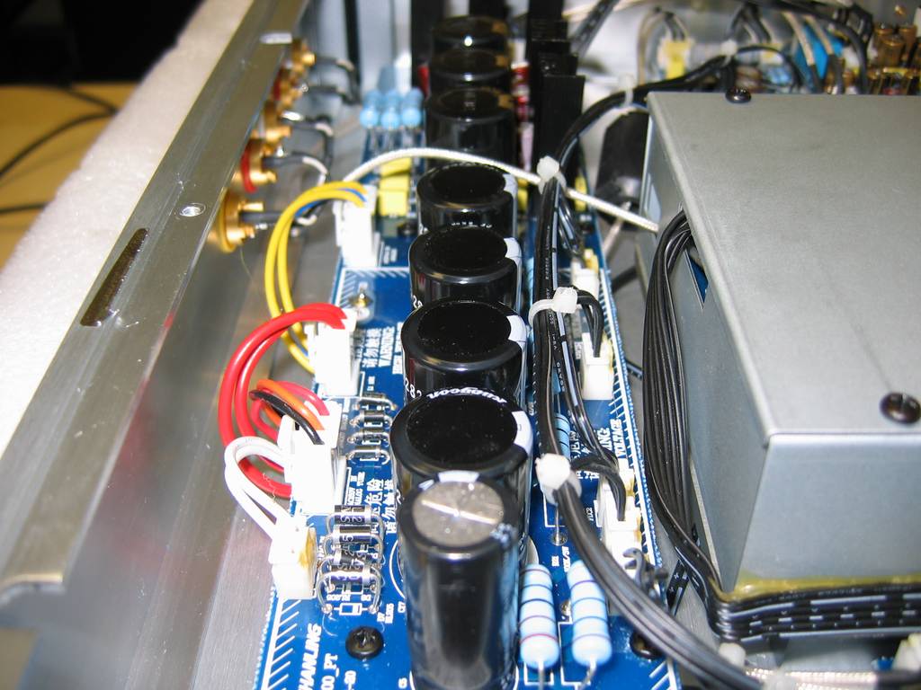

One way to get to the best out of this shanling chassis is that it needs hard wired custom wiring harnesses. That's a long and thankless job, but it will benifit tremendously. When I do that, I test fit the cables for access if repair is needed. I find the extra length is negligible in effect, and actually aids in layout at times.
I love audio shows. It's nice to find platforms of interest to fool around with. One quick way to actualize experiments, is to find a suitable platform pre-made by someone else. 😉
