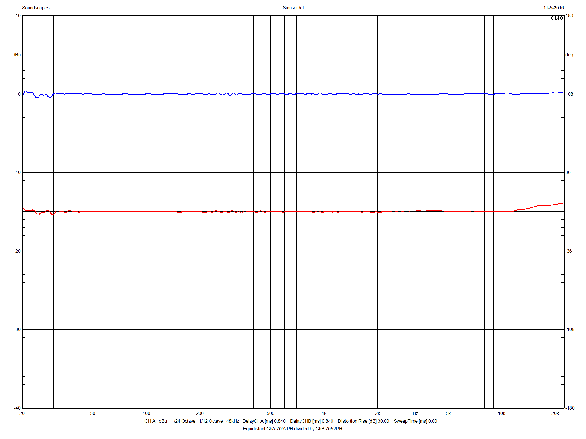

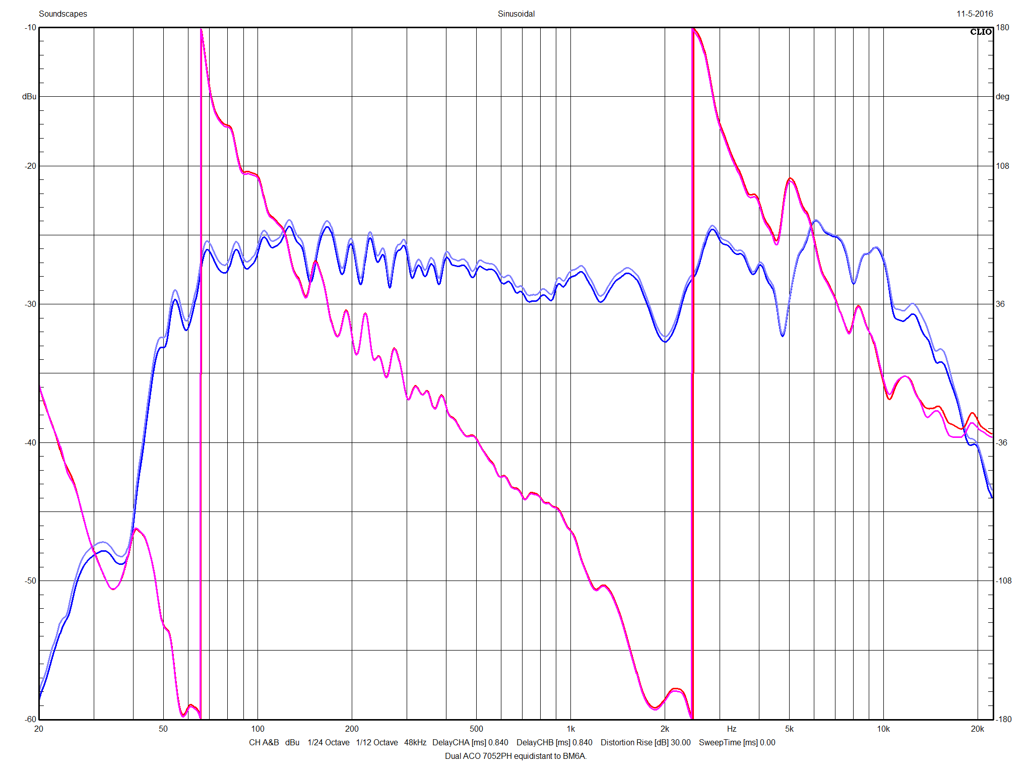

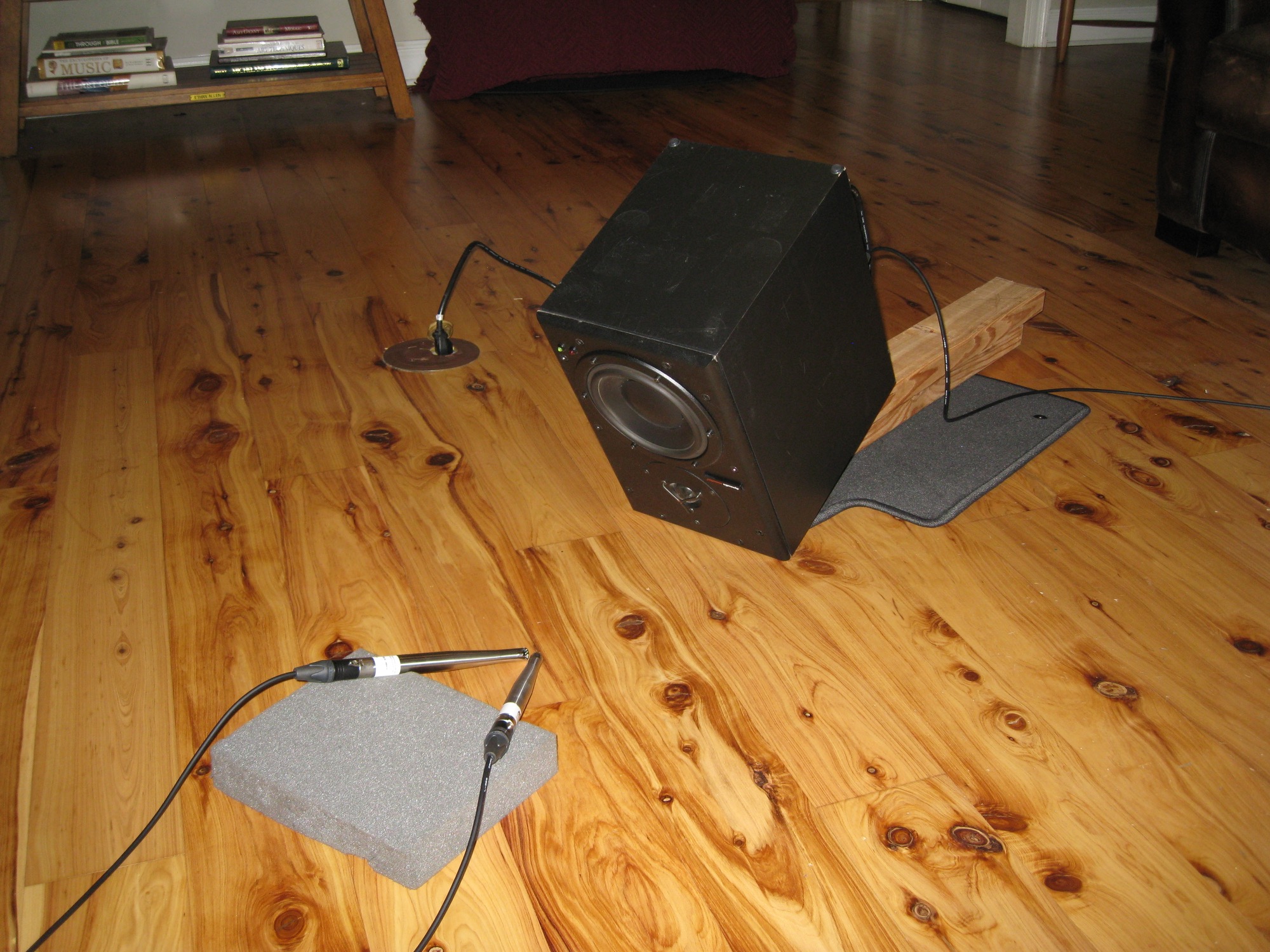

Is Clio pocket or Clio FW able to do two port differential measurements? In testing headphones for noise reduction I use an external microphone as a reference and look at the gain/loss and phase between the internal and external microphone. For that matter is it possible with Arta?
Hi Demian:
Each of the measurement systems you mentioned can do it, but I’d avoid CLIO Pocket unless its limited feature set covers the bases for you. What you’d do in CLIO Pocket is make a reference measurement in the LogChirp module without the headphones, then save that to a file. Then you’d mount the headphones and remeasure. After you make the second measurement with the headphones you’d go into Options, choose Math, then divide by the saved file. You’d have to manually repeat that divide by file operation after each subsequent measurement.
Although ARTA has a far greater feature set than CLIO Pocket, I would avoid it unless you are the only guy making the measurements. That is mainly because it doesn’t come with a calibrated audio interface. The second requirement (in my opinion) for an audio measurement system that will be operated by nontechnical staff is a scripting or macro language to automate repetitive measurements. ARTA includes that and calls it AutoIT. It is quite limited in capability compared to CLIO FW’s QC option and it won’t check for errors as you code like CLIO, but it’s good enough for many situations. Once again, ARTA is king of the hill in bang for the buck. 🙂
CLIO FW can skin this cat in several ways. It can do what CLIO Pocket does with the convenience of automatically dividing by the reference file every time you perform a sweep. You simply click a button to disable or enable any of the dozens of math functions available. Nevertheless, I’d recommend using the Sinusoidal module with the same math procedure so you can take advantage of its extremely high S/N and user definable sweep ranges and types.
You could also use the FFT module in dual channel mode to perform differential measurements with a standard stimulus or with any other external stimuli such as music, etc. The hassle with this approach is it requires (2) matched measurement microphones equidistant from the acoustic source (loudspeaker). The equidistant requirement is so that both microphones are at the same point in the loudspeaker’s radiation pattern, not because of delay issues which can easily be compensated for in the software. I would also recommend that the loudspeaker have a fabric dome tweeter for the least possible HF variation in the near field.
Although I didn’t bother using the FFT module method, this is the reference setup I used to verify matching between a pair of ACO 7052PH microphones I randomly pulled from my current inventory:
Measurement shows less than 0.5dB sensitivity difference and virtually identical phase response. Sensitivity can be matched by adjusting the per channel mic sensitivities in the options dialog, just as in other measurement software.
Dividing the channel A mic by the channel B mic proved the very close match of the microphones. The difference below 30Hz is due to the fact that the loudspeaker has no acoustic output down there and the slight variation above 10kHz is because of the non-coincident location of the two mic capsules at such short wavelengths.

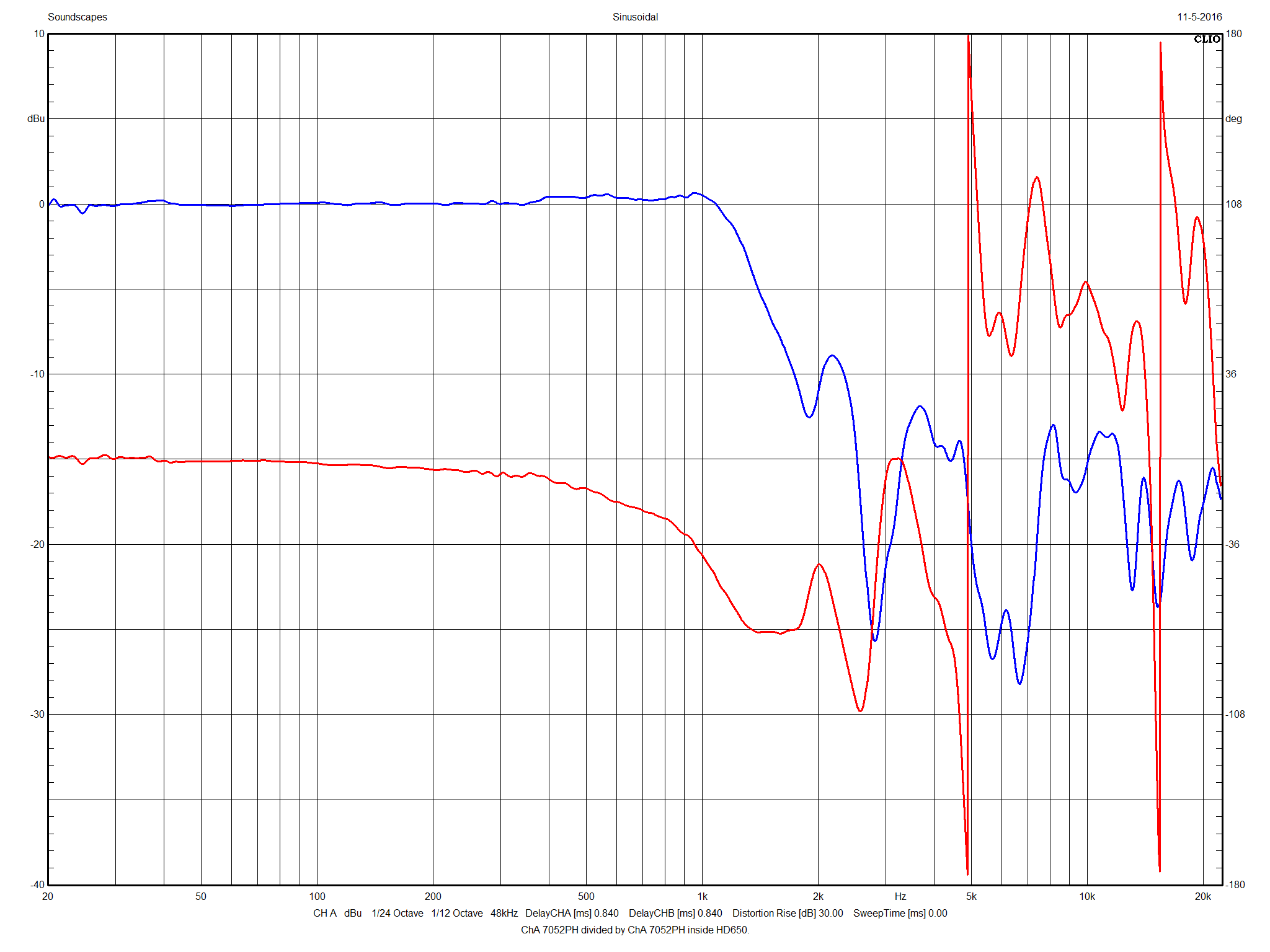

Now for the best solution using CLIO FW. I saved the measurement from channel A’s 7052PH mic and then placed this same mic inside a set of Sennheiser HD650 open back headphones using a stolen hairband from my wife to hold it together. I also tore up the living room doing these measurements this morning while she was out and I got everything back in place (including the hairband!) before she returned. She’s none the wiser and doesn't read this forum - disaster avoided! Audio can be dangerous.
Using the divide by file math function in the Sinusoidal module with a slow continuous sweep I measured the following. I matched the distance between the mic/headphone/loudspeaker to the mic/loudspeaker distance using the phase trace.

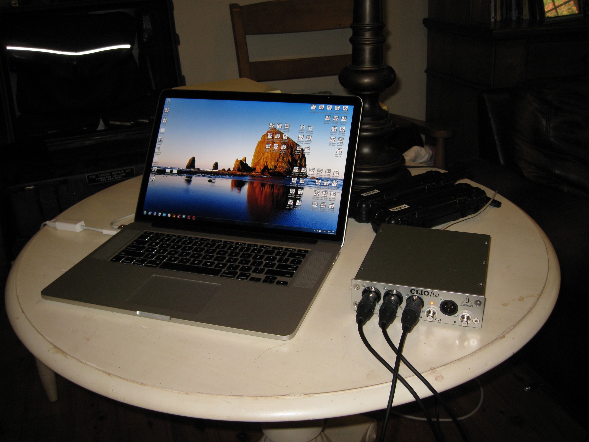

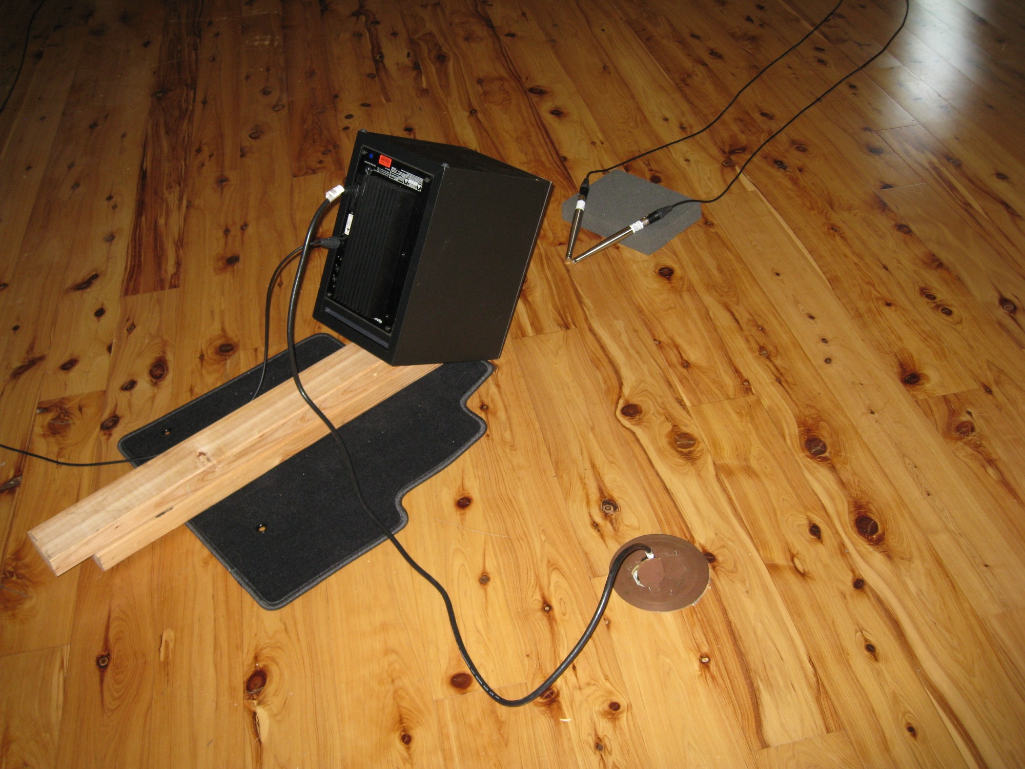

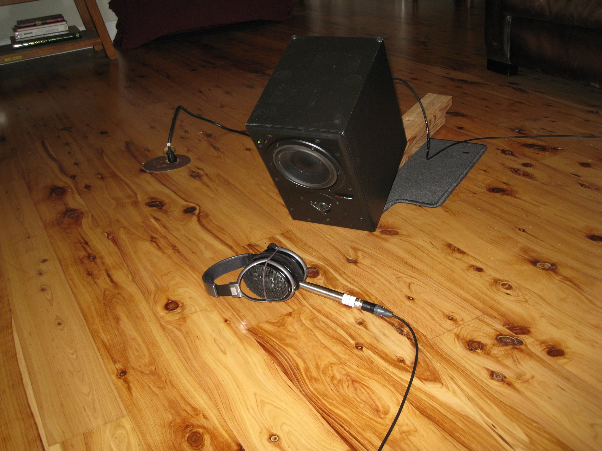

Closed headphones are not a lot better. That,s pretty similar to what I do. I have a headphone fixture with a Panasonic mike and an external mike. I set them about 3" apart for clearance for the headphone and get a reference sweep. I tweak the setup to get a straight line. Since its all passive above 2 KHz I just focus on the 5K and below to get a measurement of the isolation and ANC performance. Praxis makes this easy and a single shot gets the plot.
I see you are using ground plane measurements in the pictures. Tymphany suggested that to me some time ago. I have got excellent results using windowed measurements down to 20 Hz. It helps to have access to a warehouse with a concrete floor and 50' ceilings. I don't see discussions about this on DIY and it really works.

...Since its all passive above 2 KHz I just focus on the 5K and below to get a measurement of the isolation and ANC performance...
I didn't know that, but it makes sense that the smaller wavelengths at higher frequencies would be hard to properly cancel. The fact that above 2.8kHz or so our hearing sensitivity decreases should help reduce the need as well.
Reflections are the enemy. Windowing is one of the greatest inventions that ever happened to FFT based measurement, but the further you can get the first reflection away from the initial arrival, the further away you can place the window, thus achieve the best low frequency resolution. I love ground plane measurements because they help you delay that first reflection significantly - sometimes to the point that you don't need windowing. A second advantage is that it improves S/N by 6dB due to the coherent superposition of the direct sound and reflected sound from the floor near the mic capsule. Also having the loudspeaker that close swamps the room reflections out to a significant degree, not as much as a true near-field measurement, but pretty close. I made these measurements at the center of my living room floor. The room is 10' x 20' x 24' (H x W x L).
