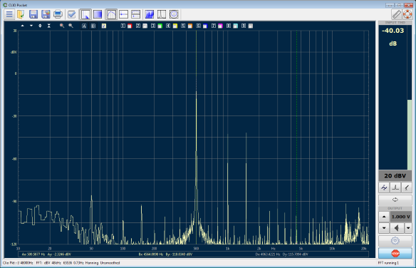

Further test done with a arbitrary waveform generator feeding CLIO Pocket. The test confirms THD-%/dB meter uses only 2nd harmonic.
From left to right
First figure: fundamental (500 Hz) and second harmonic
Second figure: fundamental, second & fourth harmonic
Third figure: fundamental, second & third harmonic
Value shown by the THD-dB meter barely unchanged.
From left to right
It does measure distortion.

I just realized that the CLIO Pocket THD-% or THD-dB meter seems to take only second harmonic in to account...
Hello Everyone:
Sorry I just saw this discussion, but I'd like to set the record straight about CLIO Pocket's THD measurements. They are spot on. You just have to hit the bucket correctly - the same as with any other FFT based distortion measurement.
The bucket I'm referring to is actually called a FFT bin. A FFT measurement is made up of hundreds of these bins that "catch" the magnitude and phase data from the FFT transform. Then it's just connect-the-dots from bin to bin to draw the trace on your screen.
If you choose a frequency that doesn't hit the center of a bin, that fundamental or harmonic will miss the bin (or be sliced by the windowing into a smaller, thus under-represented sample) and you'll get an understated THD measurement.
