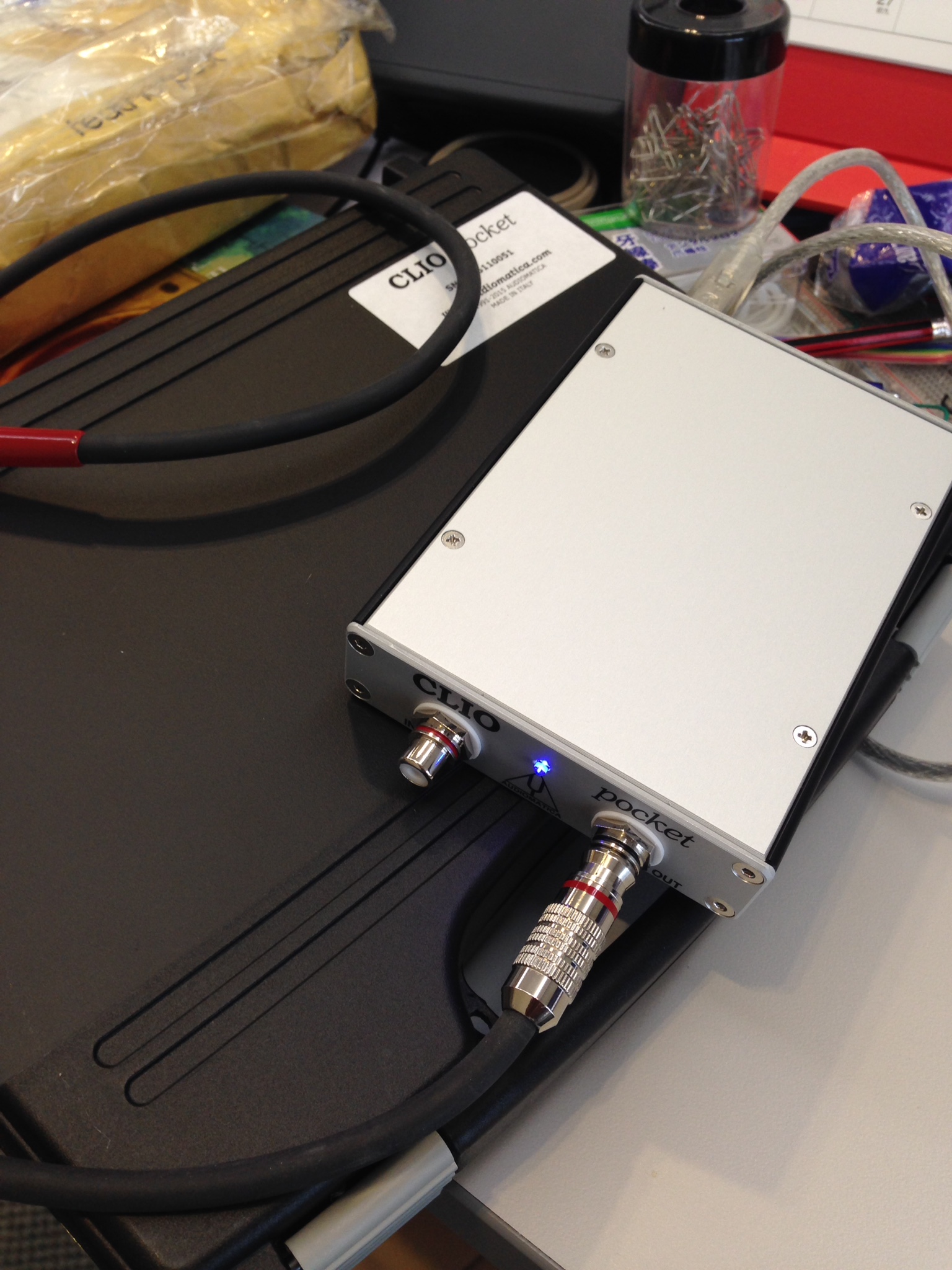

CLIO Pocket
Why don't you send the Clio to be upgraded?
Clio 11/12 is portable as well, even more portable than the Pocket as there is no need for separate accessories.
One advantage for the smaller Pocket is MacOS compatability.

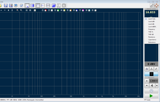

I can't even save files on my clio pocket. When I do save the measured data, it doesn't show up when I try to open the file I just saved back up. Its like I never saved it at all. Anyone have an explanation for this issue?
I have to say its sad this system is so crippled with lack of instructions and documentation. It's one of the worst user interfaces I've ever witnessed. They seriously need to fix this. I find myself using my omni mic system even though its not remotely as accurate. Im tempted to just buy a high end measurement mic and use 3rd party software.
I do not observe such issues. Measurements will be shown and could be stored and loaded ...
The only thing I observed is, from time to time the measurement graph is not visible. Specially after changing options, e.g. smoothing...
But after pressing the "Frequencity Graph" buttom again all will be shown.
This issue was not present in the past, e.g. 2 years ago.
I assume that's based on one of the last MS Win updates ...
BR Dirk

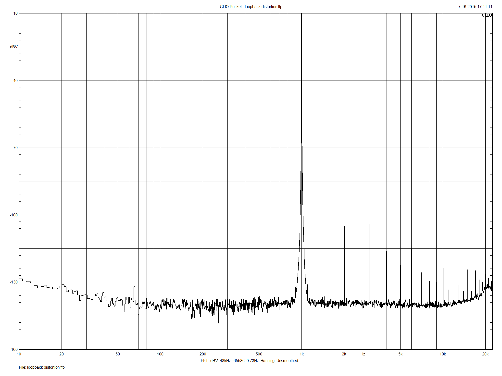

I have a Clio Pocket but I have too say I'm struggling a bit between all the options of measurement. Does anyone know if I can measure THD and 2nd and 3th order distortion of an amplifier with Clio Pocket? I'm a bit scared to connect the input to the binding spot of the amplifier. many thanks.
One thing when measuring amps, the Ground has to be connected only on one side or.... you might risks funny smell and magic smoke. The D-class and bridged amps have to be measured with floating inputs in differential mode. Actually that would be the preferred method for all amps.
The differential dual channel mode will not work with Clio Pocket, since it has only one input - my mistake. The regular Clio with two inputs has this ability. I was under impression that Pocket comes with two inputs. False hopes.
Anyway, the way I connect cables in single channel measuring power amplifiers, is that the Input side ground cable is floating and only connected at Clio side in case of potential difference imbalance between Input GND and Output GND.
The Dual Channel differential mode is described in manual for regular Clio, and in ARTA manual.
