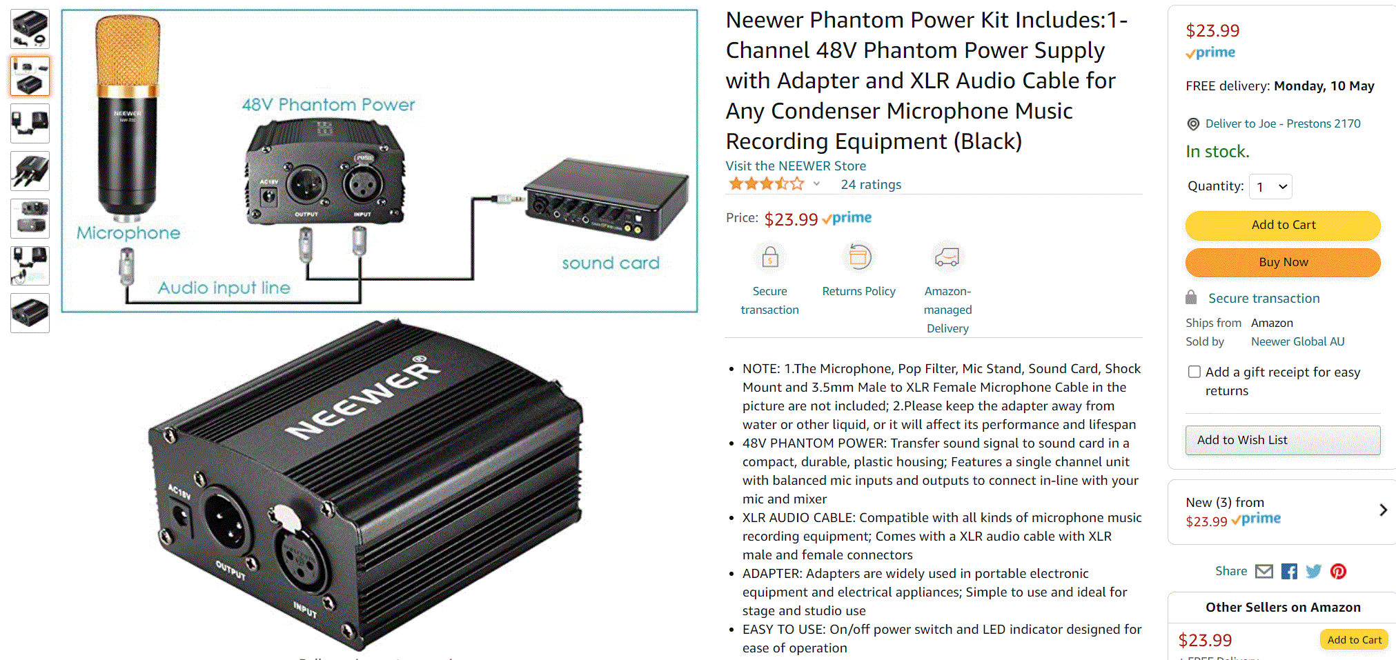

I want to be able to run 20 Metres of balanced cable. Then just before the input to the Clio Pocket convert it to unbalanced (and that will include Phanthom). Small size to match the small size/portability of the Pocket.
BTW, I have designed and built microphone preamps that have been used in iconic recordings, so I do know how to do this. But I just wondered if anybody here has been wanting to do this and what solution they used. Never hurts to ask and keep an open mind.
But I suspect I have to build it myself. Then I would consider posting it here in the interest of DIY. Converting to unbalanced and keep it small, if the ideal transformer (flat to 40KHz would be nice) could be found and three 9V Batteries for the Phantom, that would keep the components count down. But if doing it actively does the opposite. I will think about it, but comments welcome.
Got one these (below) and should be here on Monday. Cheap as chips, will be interested in what quality of parts inside and see what I can do with, already have an XLR to RCA Adaptor.
