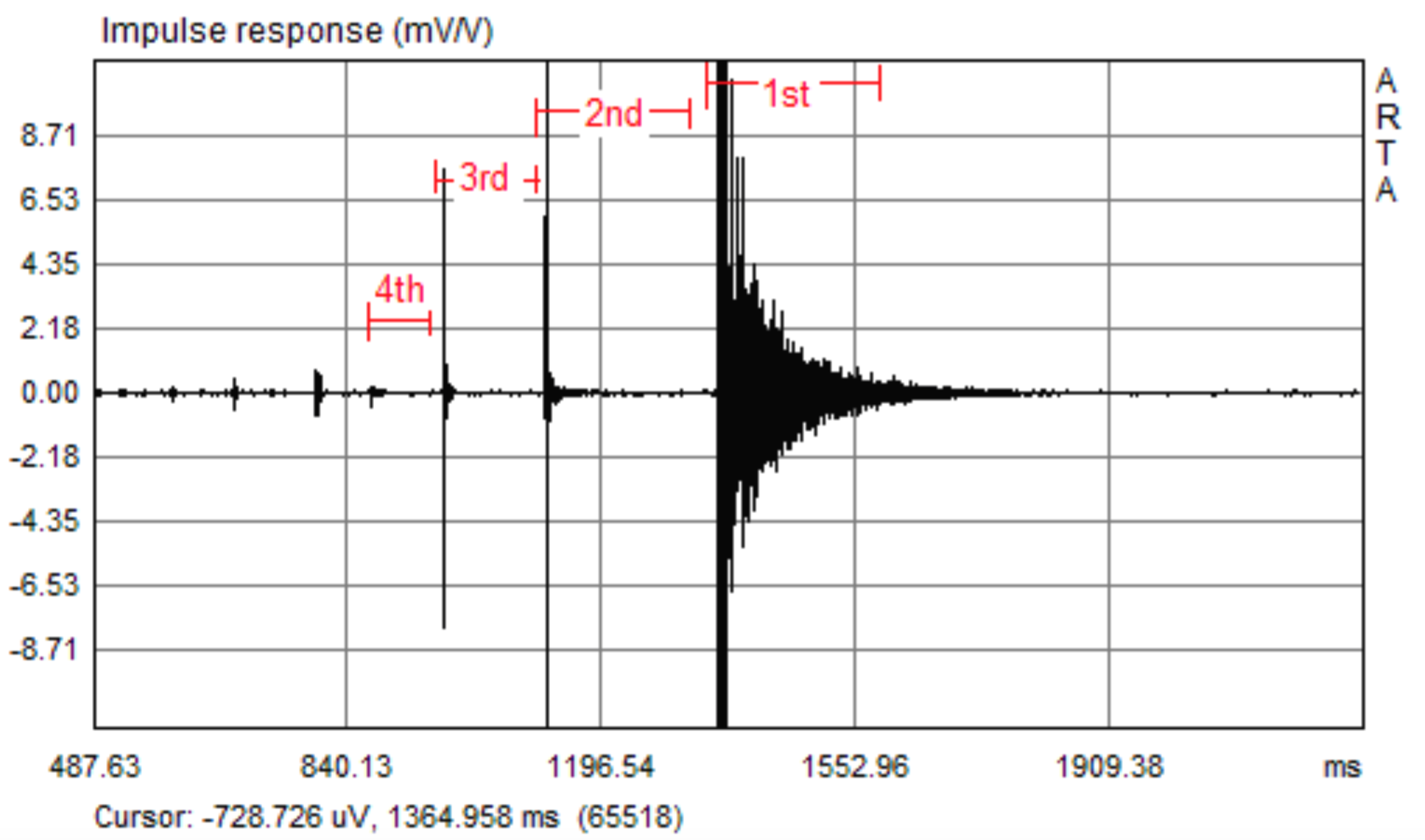

CLIO Pocket and the Farina Method
I'm going to forward your suggestion to Audiomatica today, but I have a feeling in accord with previous posts in this thread that this may be a bit beyond their target for this product. Nevertheless, IMO, if this feature is easy to implement it would not encroach on CLIO FW at all.
And you are so right - the Farina method of isolating the distortion components from a log swept sine is much more informative because with a single measurement you can get full bandwidth distortion plots for each of the harmonics until they become buried in the noise floor.
There are some compromises involved with the Farina approach such as the lack of isolation of one type of distortion from another (anything that lands at the same time as a harmonic is considered a harmonic), fairly high noise sensitivity that makes it unusable in some measurement situations (mainly acoustic), and the fact that acoustic reflections that land at the same time as the harmonics are also incorrectly counted as distortion products. For these reasons, each measurement platform I'm aware of that includes the Farina method also includes a more robust method (examples: Audio Precision and ARTA).
BUT, the Farina method does something cool in that you instantly can see distortion related problems in your log sweep measurements simply by looking at the impulse response or better yet, an ETC of same due to its much higher sensitivity. Ivo Mateljan, the brilliant ARTA designer included this illustration in his manual using an IR:
I recently wrote a paper that pretty thoroughly gives the background to the Farina method without really trying to and without using fancy math! It's also a full introduction to CLIO FW's distortion measurement facilities: Making Good Measurements - Learning to Recognize and Avoid Distortion.

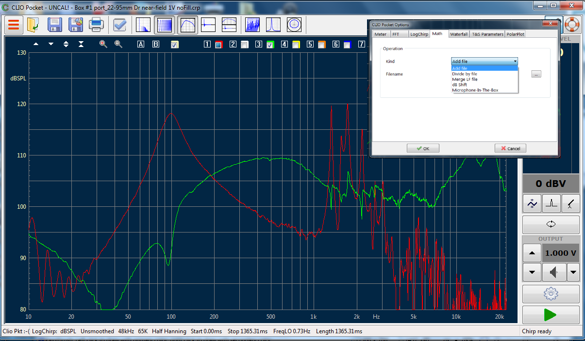

I would love to ask, you'd have to do manual measurement of near-field?
This measurement is only what has appeared here
Thank you for tutorial. Ihollan, Kaiser7 windowing is no better that FlatTop?

Thank you for answer, your video tutorial is very good and easy to understand. Yes, Kaiser 7 I use in Arta, for me best window when I need max resolution in spectrum, distortion mesurement. and I agree that there are many possibilities in the area windowing.
Thus, in my opinion, the idea of Clio Pocket is very good. Good hardware, absolute compatible with software with very good parameters, standard sound card included 250-300E, this does not offer. Easy calibration for absolute SPL is super. and so on.
As to measuring distortion with Sweep. Is it speed, fairly accurate and complex. Is clear, that spectrum or stepped sine is better.
To reflection, would help assist averaging and measurement in near field, of course with long sequence.
My question about near field measurement I thought that the only measurement I found out Clio Manual is what I sent. If you notice, the information below 40 Hz is weak. I think I now why. Measurement techniques know MIB measurement can not always be used. My question is whether it is possible to make solid near field measurements from 10 Hz, like in tutorial D’Appolito.You can write in short, the ideal setting some to be the result than in the manual. Alternatively, if you have a moment as well as some video. Thank you very much for your time.

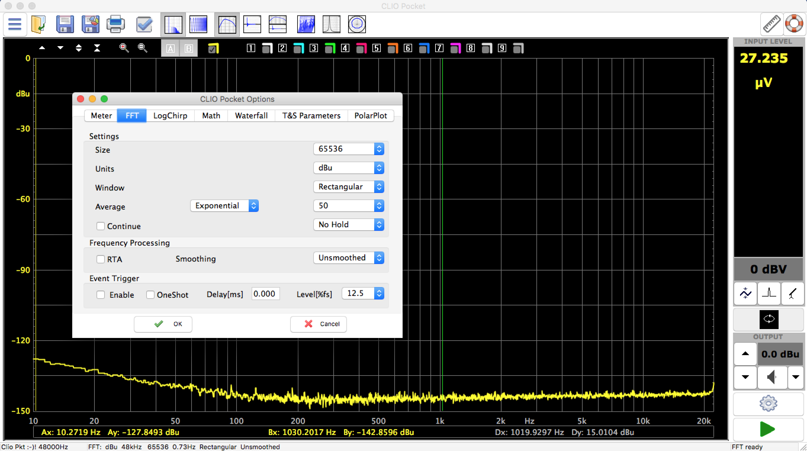

Now... on the other end things - noise - not just any measurement system will do. The intrinsic noise of the audio measurement interface is the hard limit one comes up against. The lower the noise floor, the better. Ultimately we want our measurements to have the highest signal and least noise.
I would love for someone to post a measured noise floor that is less than the following regardless of cost. I was amazed when I first saw this:

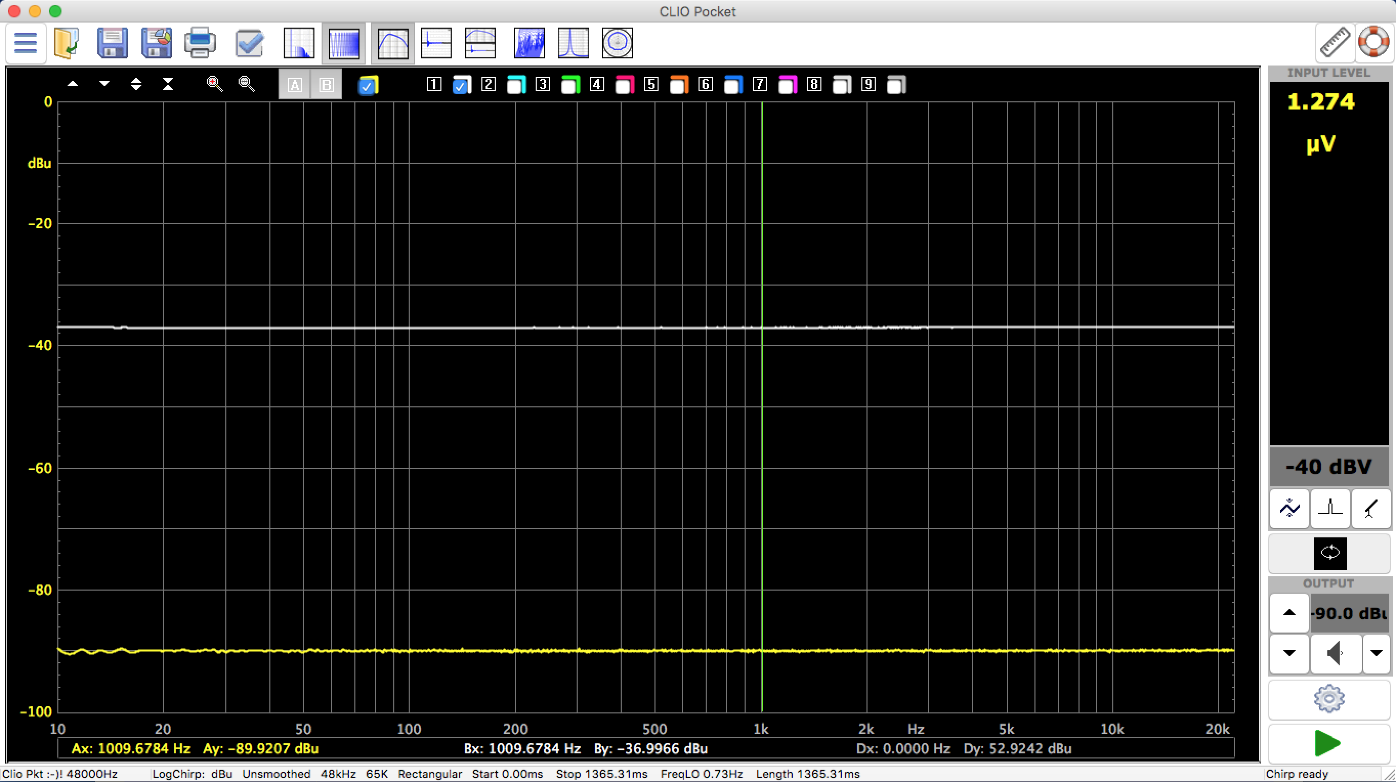

Secondly, CLIO FW and CLIO Pocket have (9) mic input sensitivity ranges with maximum input levels from +40dBV (100V RMS) to -40dBV (10mV RMS). The minimum input level in each of those (9) ranges is 50dB less than the maximum. For example, the -40dBV sensitivity setting will give you good measurement S/N from -40dBV to -90dBV. Here is a demonstration using the maximum and minimum measurement levels made at the -40dBV gain sensitivity:
Using the measurement you referred to for illustration, both the red trace and the green trace fell apart 30dB under their peak readings. If the gain sensitivity had been adjusted correctly, the full 50dB of dynamic range would have been available and both of those traces would have had clean data down to at least 15Hz.
So... What you saw was not a short-coming in CLIO Pocket, it was simply non-optimized gain structure.
