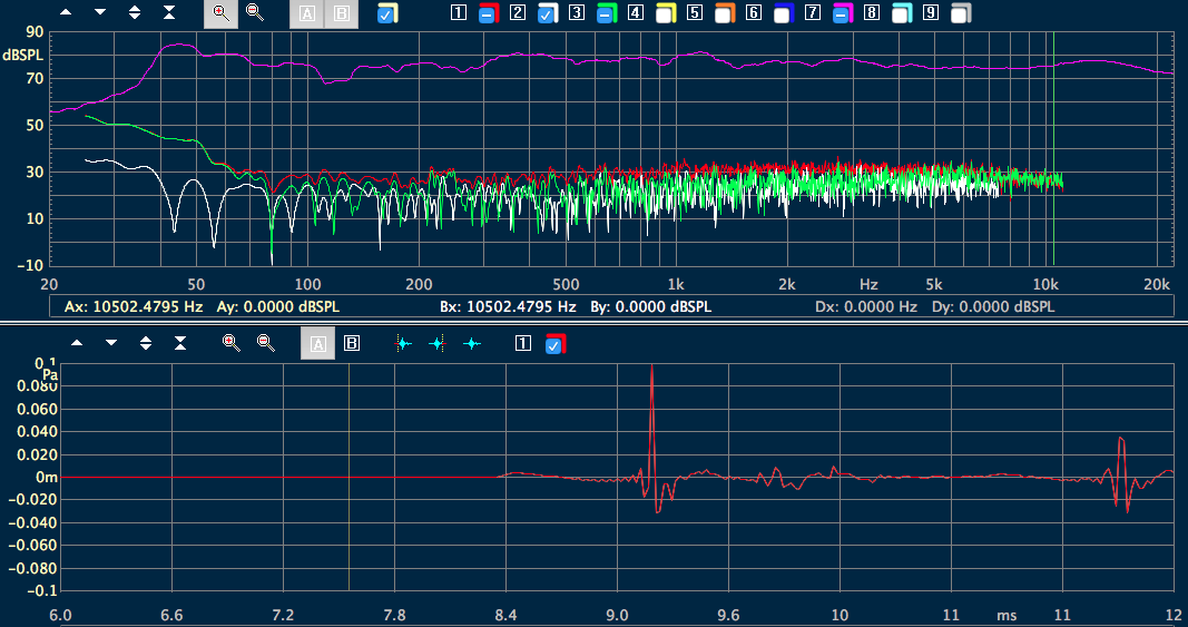

Small demonstration of added value in V2
I measured the SPL curves of the left and right TD2001 (340Hz Tractrix) and they always seemed very similar....(red/white curves)
However, when I measured the THD there was this very weird graph in one of the drivers with bumps in the THD curve (yellow) whereas the other driver was flat and low enough as expected (Green).
So, slight panic if the berylium would be cracked due to the enormous output signal of the CLIO when a calibration is completed (still being set back to 1V instead of my pre-calibration setting of 0.025V for my highly sensitive system...and yes, I went nearly deaf when that happened 😀😱😉 )
Had to open the TD2001 driver to check and luckily the berylium was ok, so the only thing I could think of was the correct alignment of it in the gap, cleaning the gap and tightening the mounting screws since I felt 2 out of 3 were not too tight.
Additionally, replacing the foam in the back chamber with modern stuf since the original was falling apart.
Connected a signal generator while positioning the diaphragm and put everything back in place.
The measurement is purple line (bump due to measuring a bit too close) and the THD is the brown one...so, better than even the other driver now.
Without the THD measurement I would have never discovered this! 😉
And if somebody wonders if the THD bumps were audible....nope.
But then again, it might be audible that they are gone now 😉
