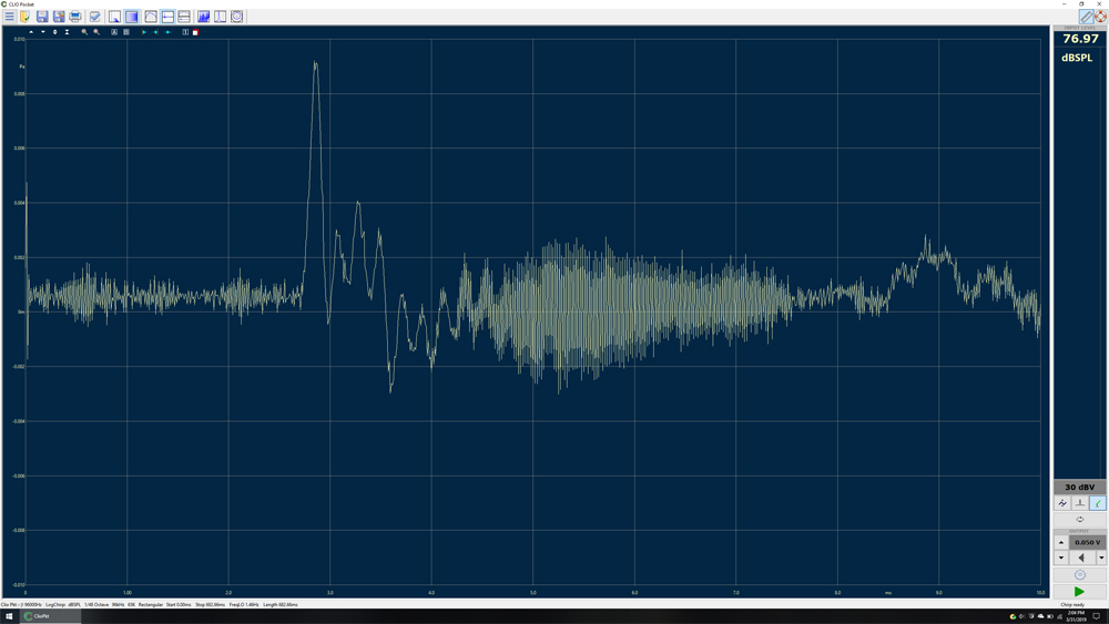

Very strange signal, never had this. Would expect this is caused by some oscillation in the active driving amp (or CLIO HW? Recalibrate and try again to be sure?)
