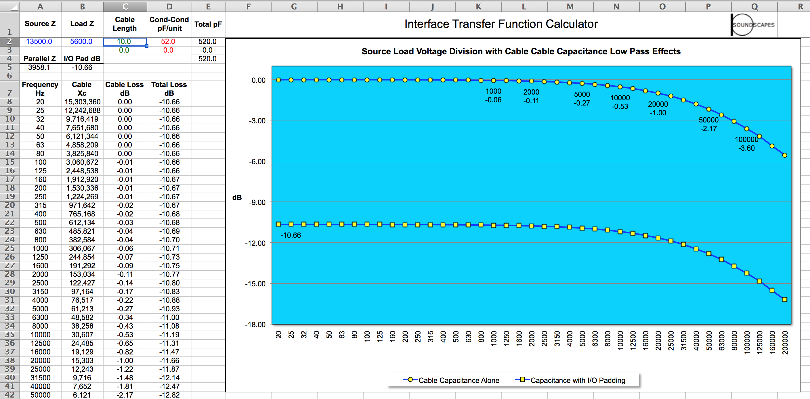

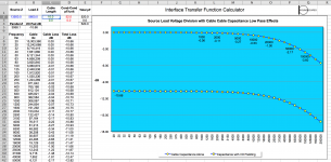

I have found a subwoofer cable that seems to fit: 52 pF/m and 72 ohm/km. In 10 meter length it should work with very small or insignificant losses?
Use my spreadsheet to find out. 🙂 The length isn't bad, but the high capacitance per meter is a problem. Still, you're only down 1dB at 20kHz. Use cable intended for video applications when you need that kind of length. I've filled in the spreadsheet under the assumption you are talking about CLIO Pocket and its included MIC-02 with that cable. Read my paper linked to in a nearby previous post for background and the link to the Excel spreadsheet:

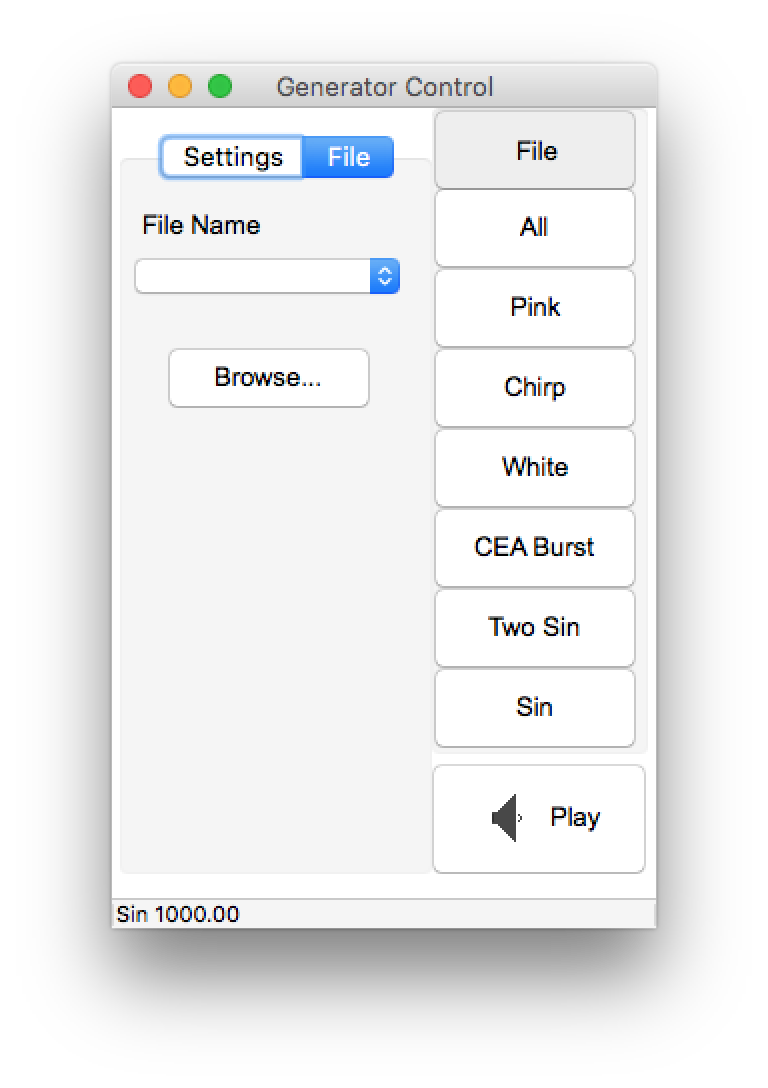

...when running clio pocket in rta mode, is it possible to play music from the same computer simultaneously?
Sure, you can play the file from CLIO Pocket or another interface. If CLIO Pocket it'll be mono of course, it'll need to be 16bit or 32bit floating, 48k or 96k and there will be a file size limit. CLIO and CLIO Pocket will simply loop the file when you hit play.
Thanks for the reply! My subwoofer cable seems fine in length up to 7.6 meter, i think i can live with that. How long cables can be runned with the clio 12 hardware? I believe the clio mics are based on some panasonic mic capsules, how can they handle the 24 v phantom power from the clio 12 hardware?

Good to hear that clio pocket can be used simultaneously with another output, i have a bad habit of monitoring the in room frequency response with rta when listen to music played from my computer 🙂
