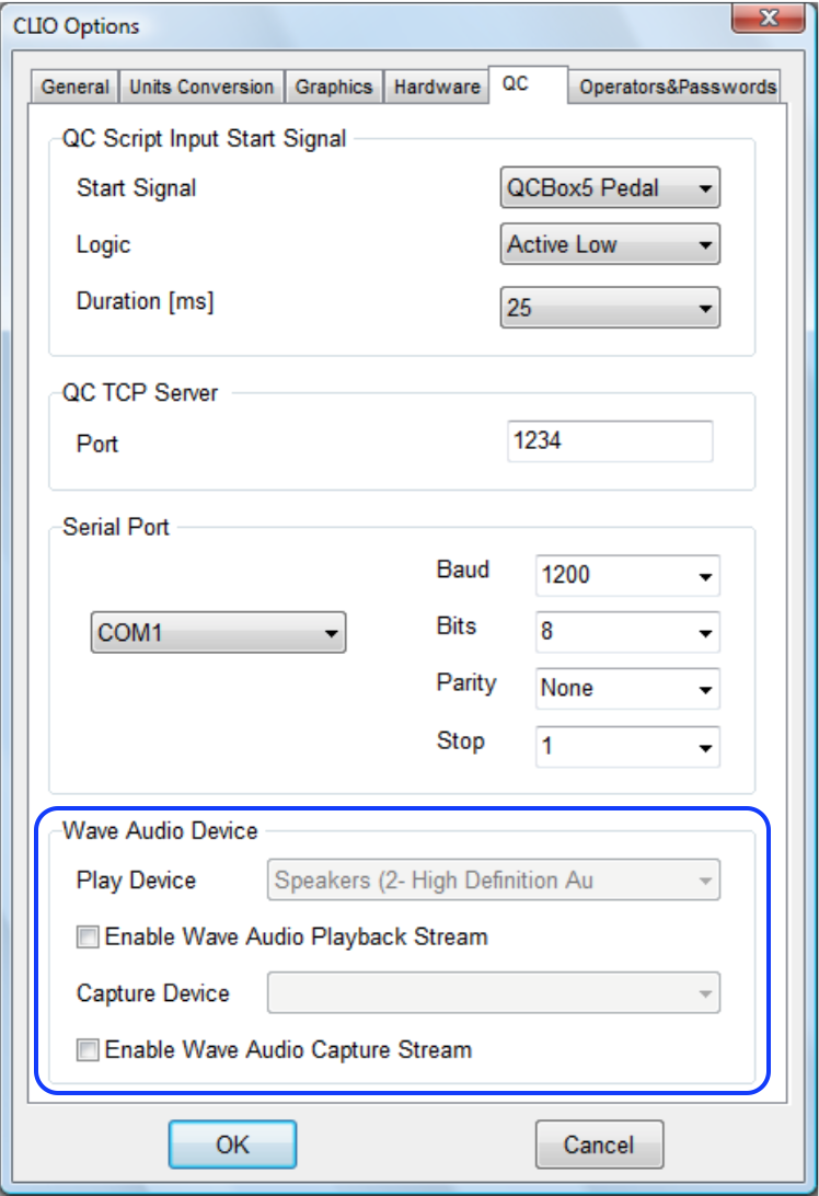

Very true Dirk, but as a side note the QC version of CLIO 11 and 12 can use any sound device connected to the computer it's running on as an output or input (but not both at the same time).
For example; if a D/A converter were connected to the computer CLIO QC was running on, CLIO could route the output of any of its measurement routines through the D/A and back into the CLIO audio interface.
The reverse is true as well; the analog output of CLIO's audio interface box can be connected to the input of an A/D that is attached to the computer and CLIO can select that A/D for its input.
With Dante Via, this means CLIO QC can also measure devices on a Dante network.
Finally, either CLIO Std or QC can use the SPDIF output on the rear panel of its audio interface box to feed devices with digital inputs (48kHz, 96kHz or 192kHz). This is a single RCA connector, but if optical TOSLINK is required, a simple and inexpensive converter box can be used for lossless conversion.
Here's a look at CLIO QC's options where other sound devices can be selected:
