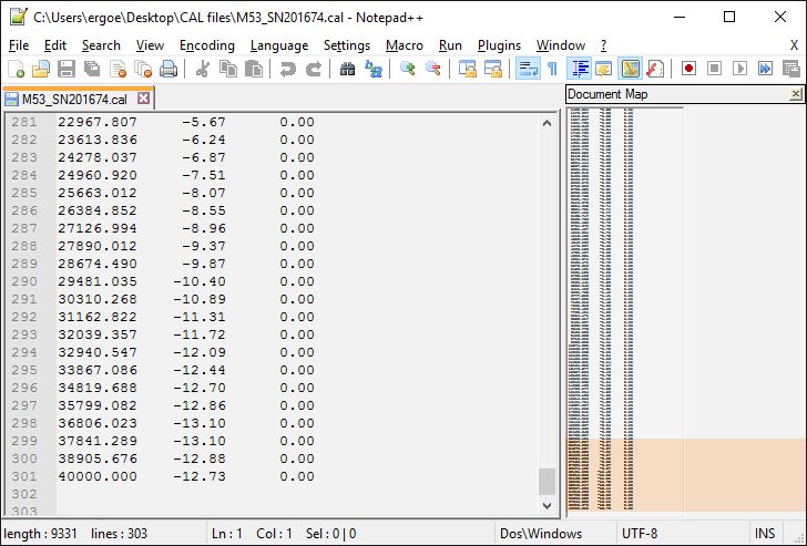

One more question on CLIO FW as we have this thread side tracked a bit already....
CLIO manual says
CORRECTING THE MICROPHONE RESPONSE
GUIDELINES TO REALIZE .CAL FILES
Note: The maximum number of correcting points allowed is 100.
The example below shows a sample text file created to store the microphone
frequency response:"
But what does it do if there are more data points? Would it start from low frequency and stop when it gets to 100 lines or? ... I'm wondering if this might mean that there will be no correction at high frequency in end at all (and thats where it is needed generally).
Good question! I don't know. Yet.
Any reasonable measurement mic is going to be flat up to at least 1kHz. Mic calibration files tend to have data above that point. Any data not included in the file is fine, CLIO simply ignores that range and doesn't modify the response.
Since mic calibration files begin with the lowest correction frequencies, my guess would be that the highest frequencies AFTER the 100th data point will be ignored, if they exist.
If you have a mic calibration file in ASCII format with more than 100 data points, please post it or send it to my email address (available in link below) and I'll test it and let you know exactly what happens.

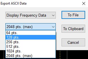

Langston:
Here is an assortment of mike cal files. Most are over 100 lines in Praxis text format (essentially the common format it seems). First is the frequency, second is level and 3rd is phase. These were created by Kim Giridin comparing to a B&K 4135.
I hope to have the time to set up to do the same here (I have a recent calibration B&K 4135 and an extended response driver). Above 30 KHz it really doesn't work to calibrate in free field. Just too many things to screw it up.
Is there a script/tool for creating microphone cal files in Clio? Does Clio have phase as a component of the calibration?

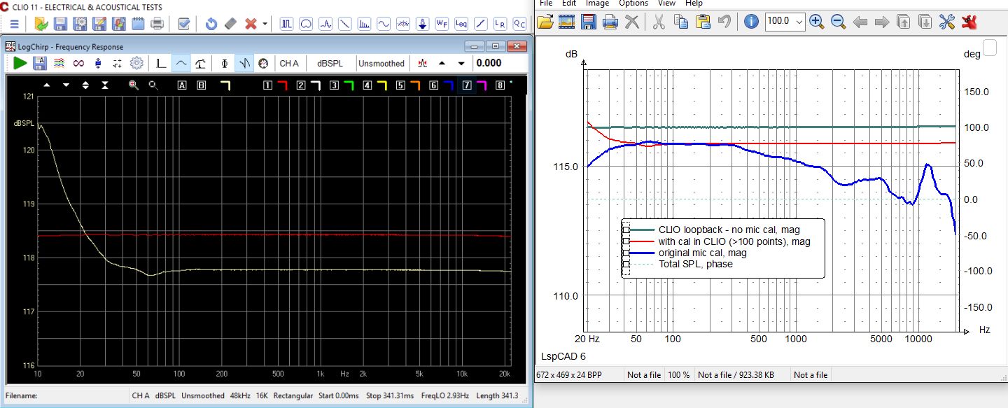

Unfortunately it seems to be exactly the behaviour that it reads 100 lines and just flattens after that. I tried to load this LinearX cal file that has 300 lines...
So everyone - be aware with this. No warnings or indication is given that the cal does not load all of the values! Also it quite puzzles me where the 100 limit comes from. Even CLIO itself exports 64/128/256 etc.

I made a 100 point file of the same M53 cal file with Liberty Praxis that is the only tool I know where one can set 100 point export.
Now when I try to reload 100 point file CLIO seems to still apply the same cal with low freq. correction only. I've restarted it multiple time etc. etc. I can only remove the cal or get same as the first broken sample. So seems to me there is another bug that does not update the cal file copy. (I'm running the latest ver of CLIO FW)
Thinking about it, the best would be if CLIO would allow plotting the mic cal file on screen after import like ARTA and REW allow to do. Then one can really check and see for sure that the program did import it correctly. This sort of issue can really brake measurement accuracy behaving like it does today.

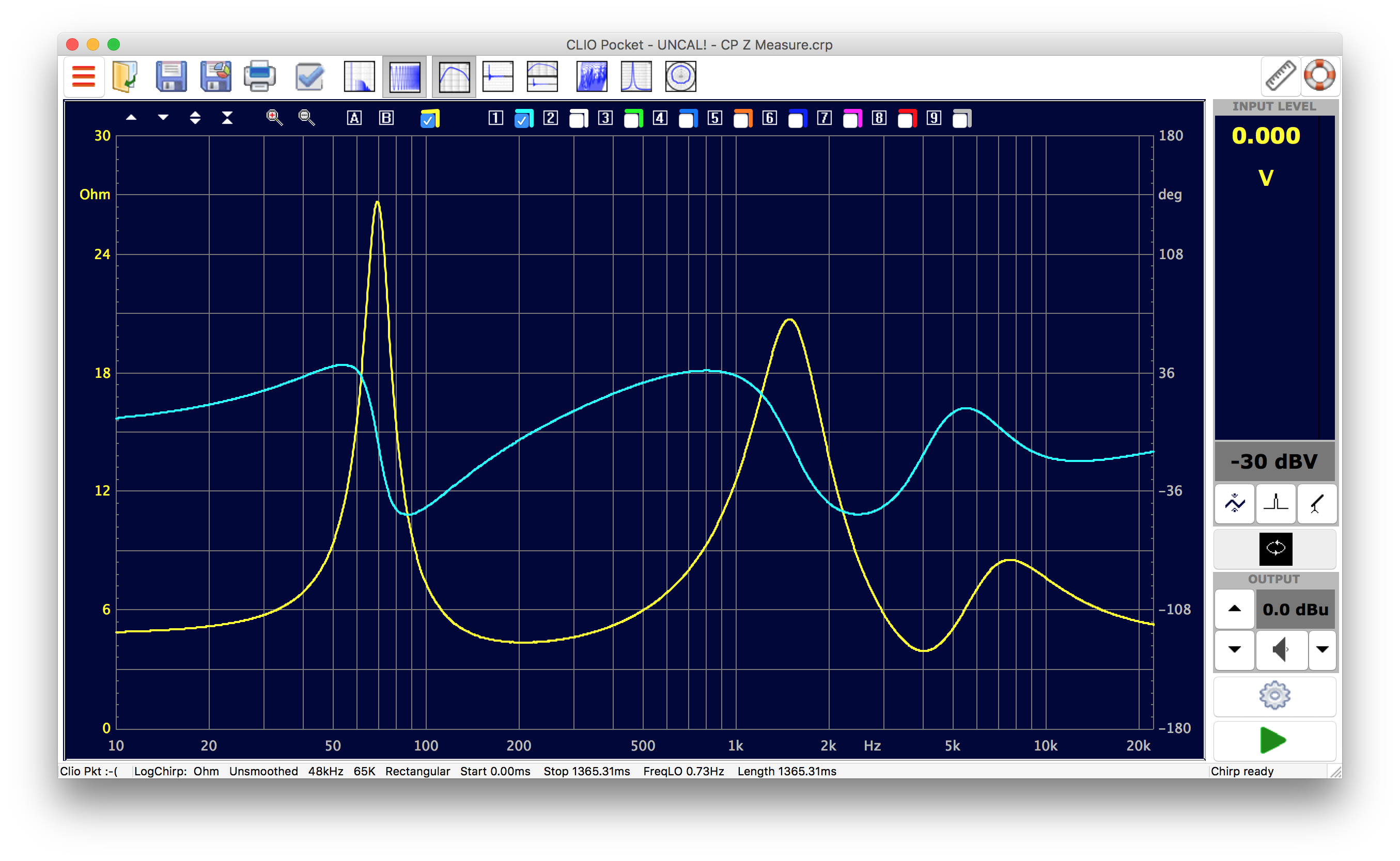

Does CLIO pocket have the option to edit the names per curve (now it's numbered)?
Not at present, but I'll shoot that request to Audiomatica.
What I do is make notes for each measurement in the CLIO Pocket Options tab called "Notes & Print" and save each individual measurement, obviously to a file name that is also descriptive. You can then recall multiple measurements for comparison giving each a different color as you recall them.
A note about colors, it's totally subjective, but I think CLIO Pocket looks best with a dark navy blue background and bright yellow as the primary measurement trace. The comparison trace or overlay colors are also something I spent some time on. I prefer a screen line width of 2 except when I want the fastest possible redraw rate for the real time FFT module, then choose a width of 1.

After measuring several curves I saved the file but after re-opening none of the files were available anymore. Am I doing something wrong here?
Hello! I'm not quite sure what you mean exactly, but CLIO Pocket will not save multiple traces with a single file save procedure like CLIO 12 will. With CLIO Pocket you need to save each measurement you make to a separate file.
Then you can recall (1) measurement and click on one colored buttons numbered 1-9 to store that trace as an overlay. Then open a second measurement file and store its trace to a different overlay number. You can compare up to (10) measurements in this fashion (the active measurement trace and 9 overlays) and use cursors to measure the differences between each trace.
You can also perform basic math functions on a measurement using another saved measurement as a reference.
Let me know if I missed something!
