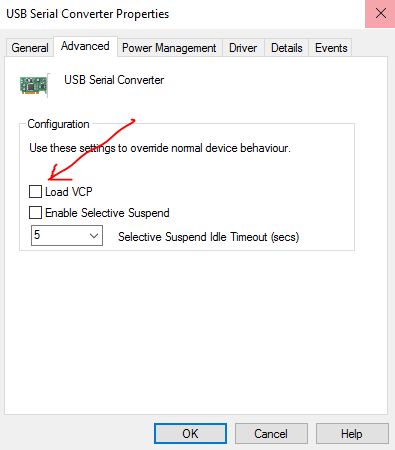

I know this is foremost a CLIO Pocket thread but I'll add this bit of CLIO QCBOX model 5 knowledge here as well.
I spent many hours trying to figure out why the CLIO software refused to 'talk to' the QCBOX over the USB even though drivers showed all ok. This was the case on 2 PC-s one with Win10 and other with Win7. An old netbook with WinXP worked.
After support e-mail exchange with CLIO Italy they sent me a solution. The solution is to remove the 'Load VCP' ticker that is 'on' by default. This is not in the setup instructions available on their page. Maybe this will save some hours of frustration for somebody some day.
