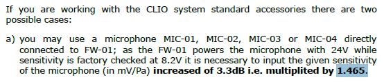

The microphone subject is a bit vague.
I am not using the standard microphone, and not sure if I still need to multiply the given sensitivity with 1.465 or just leave it as it is.
For the ones supplied by Audiomatica, you have to multiply your value with 1.465.

well that 20 volt seems to be mic-supply from old devices. Current Clio manual for v12 sais it operates with 8.2 volt as well. That means on the new devices that mvPA goes straight 1:1 i assume.
But the 94/114 is only for the meter-calibration? I thought it might be 17.5mV for 94 OR 114dB ... in that case depending on the setting evaluating input signal 20dB different??
Anyhow. Seems like i should try with an amp again...
Yes, selection only for calibration
Sensitivity in mV/PA -> 94 (93.979400087) dB SPL = 1 PA (Sound pressure)
means 17.5 mV at 1 PA -> 94 dB SPL

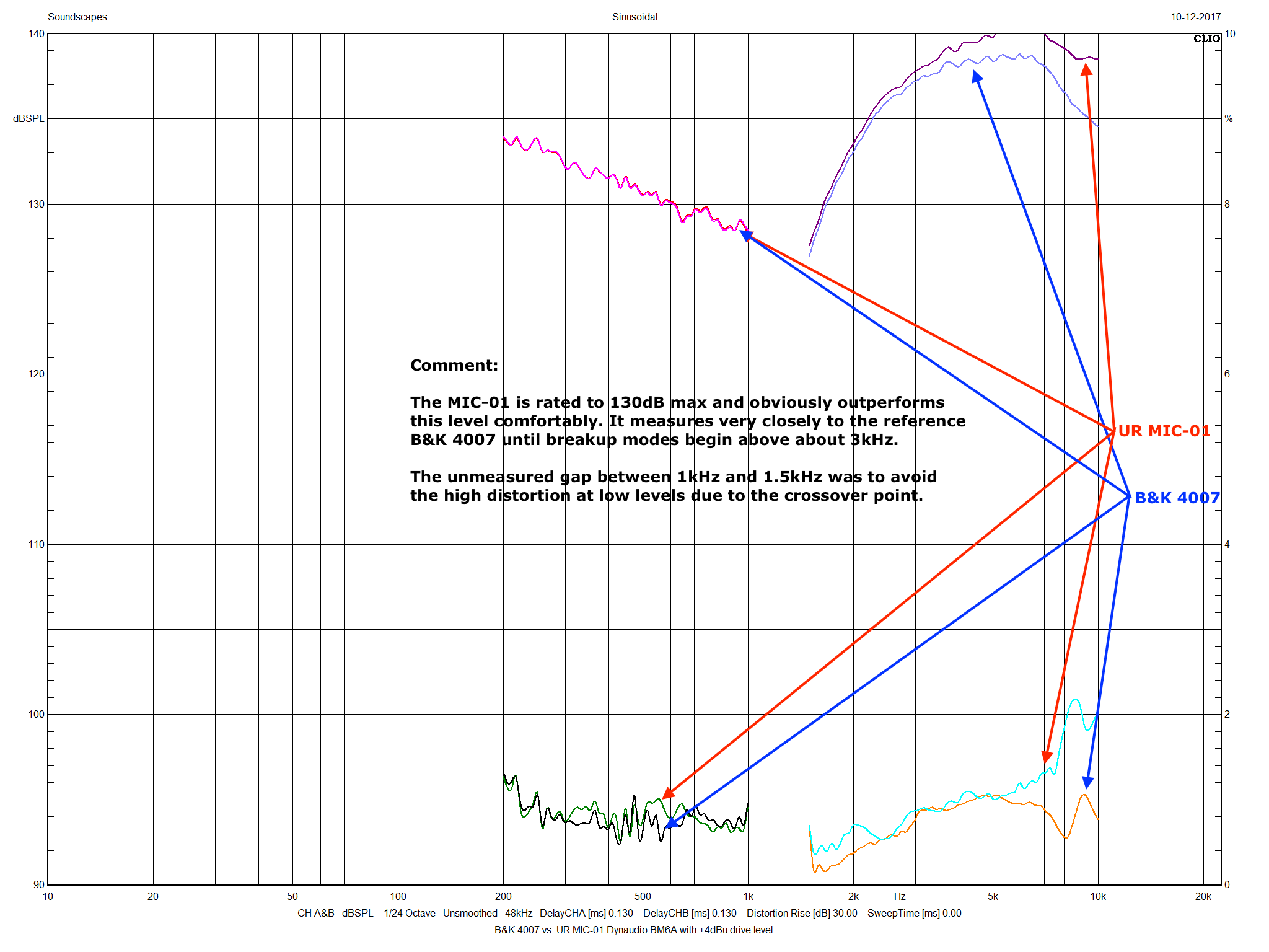

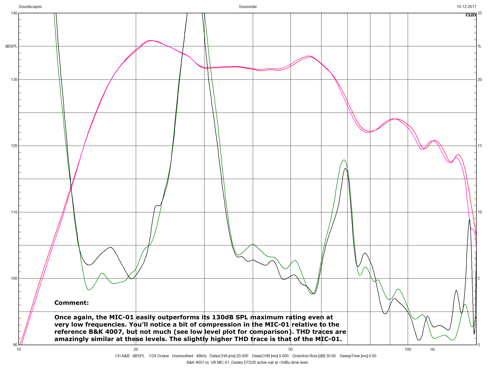

Not sure the THD levels for the at 114dB for Clio mics
A QUESTION?
All (4) CLIO mics use the same capsule, they are just different sizes and shapes for different applications.
Spec sheet stating 130dB SPL maximum
A customer recently returned the longer 10" version to me stating it was defective. He was wrong, but I sent him another one anyway. Part of the biz. Using the 24V CLIO 12 system my measurements of the returned microphone showed that it can handle significantly higher levels than 130dB. It also matched the frequency response of the spec sheet very closely.
Low Frequency
High Frequency
