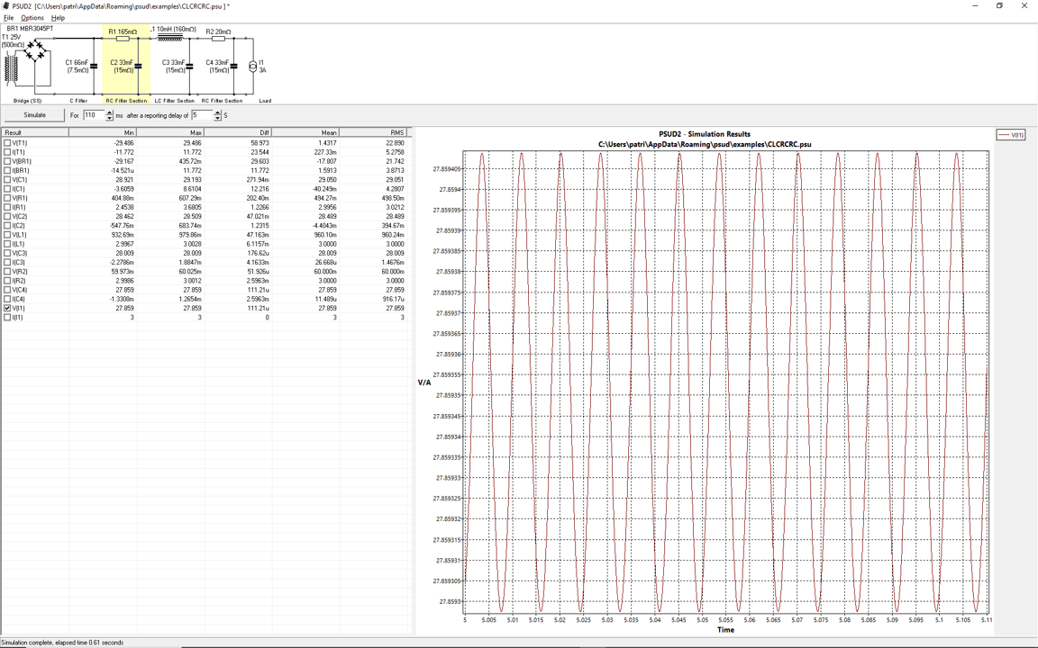

The V8 PSU is CCRCRC. I suggest doing a little model in Duncan PSU designer software to play with where the inductor should go. I have my suspicions, and I’m curious to see what the software says when you plug in your actual values.

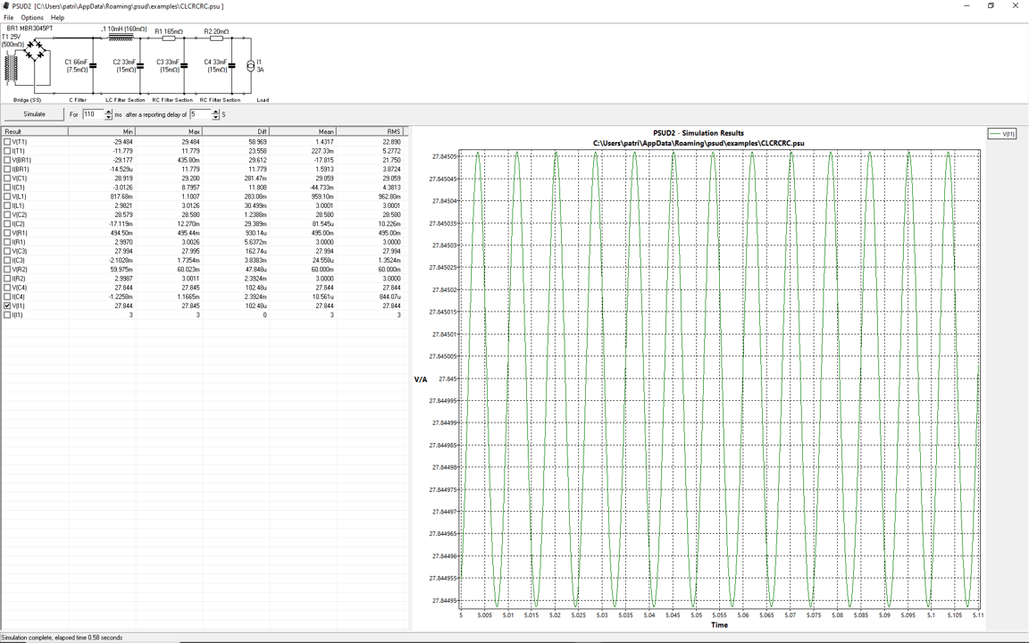

I was curious too, so I ran the sims prior to getting everything together a few weeks ago. PSUD shows directionally that the inductor is best placed as CCLCRC vs. CCRCLC, but it's not necessarily a meaningful difference.
Simmed Ripple with a 3A load - L early is 102uV ... L later is 111uV
Considering my standard CRC supply Sims (and measures pretty closely) to 130mV, I'm sure I'll be happy either way.
Note - that's with adding 33kuF in the amp chassis.
More important note - I have no idea what I'm doing, but I'm giving it a whirl! 🙂
  • I put in what I think are the proper specs for the transformer including the proper resistance and regulation.
  • I picked a bog standard bridge that should be close enough.
  • Instead of doing CC I used 66kuF with ESR halved for the two caps in parallel. I should run it with CC to see if it makes a difference.
  • Tried to enter proper specs for the Inductor including the series resistance
  • 33kuF caps for the rest
  • I tried to put the motor-run cap into the Sim and everything went absolutely haywire. I haven't figured out what I did wrong (yet).

100uV range is pretty darn low, but if lower can be expected. Awesome. Here are two screenshots from the sims mentioned above. The extra RC is the cable (lowest resistance allowed in the sim) and the 33kuF in the chassis.

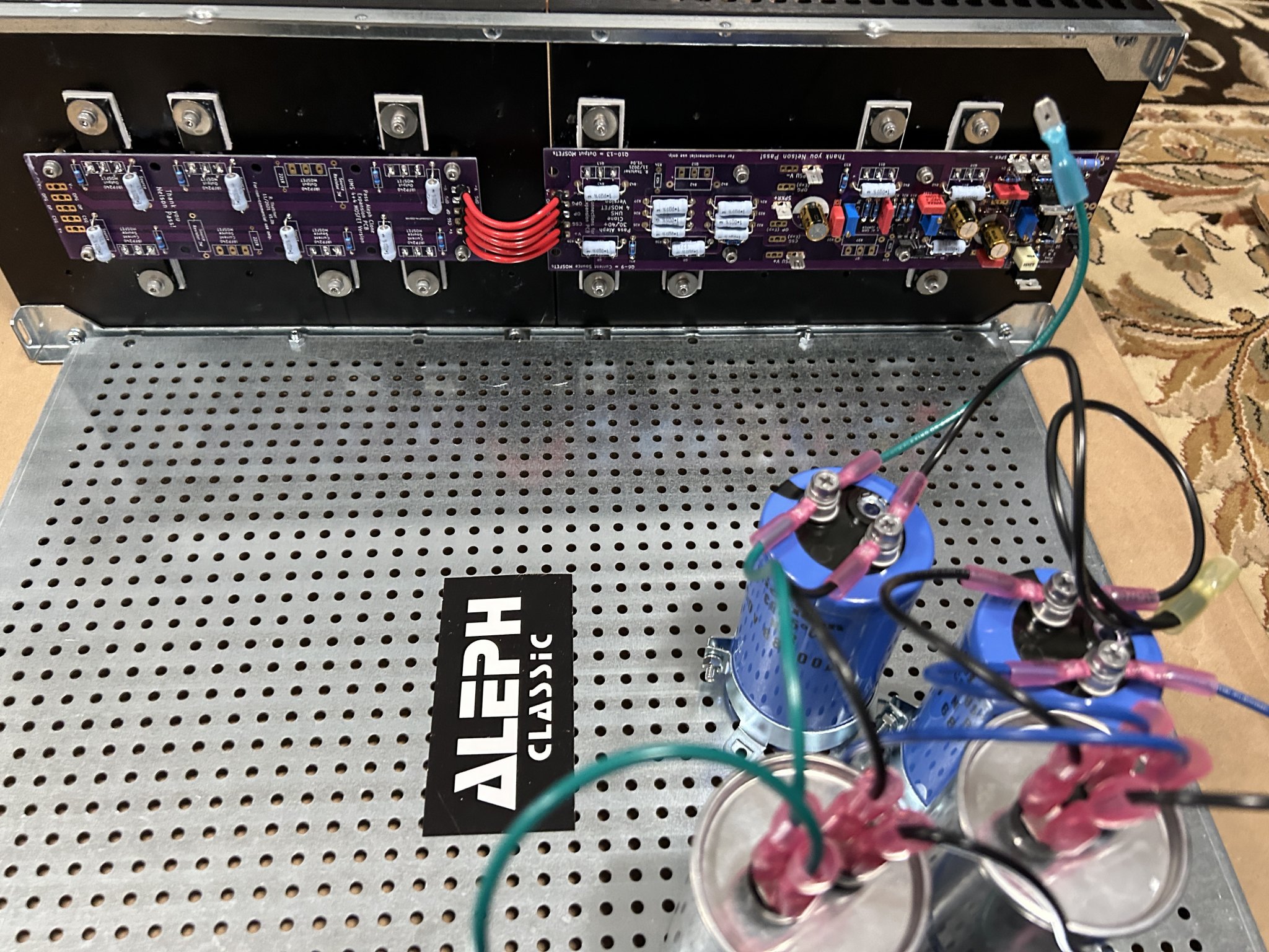

A little more progress.
Both boards were checked out with the PSU. I did a quick initial bias to ~2A and zeroed the offset. I have not done anything re: the AC gain. I'll do that when I get the inputs added etc.
Huge shout out to @rhthatcher. It's taken me a while to get started on the project, but it's a fun build. I may have music later in the week. The guide is fantastic, and the boards are a dream to work with.
Note - I will do a little more learning, and I'm sure it's 'normal', but for those out there that are fraidy cats like me and like to ramp up their voltages slowly... I had an observation that initially had me worried.
I put DMMs across a selection of the source resistors during initial power-up to make sure nothing was wonky. I was also monitoring offset and the PSU voltages. Initially, the voltage across (current through) the source resistors was too high. If I recall, it was ~500mV or more. So, I thought to myself, "Self! You're a knowledgeable and good-looking amplifier builder. That's why we power up slowly. Back down on the bias current and move on." So, I backed off the bias current. Yay team. I steadily increased the PSU voltage, and the bias current decreased ... So, I had to crank the bias back up. I don't recall any other amp I've built doing anything like that. If someone has a brief explanation, I'd be grateful.
With a standard power-up straight to full power, clearly this is a non-issue. If some other person that uses a Variac or similar to slowly ramp up PSU voltages sees this ... don't worry... it works.
The cap bank in the chassis is only temporarily wired. I wanted to test it all out and choose a layout before tidying up the wiring.
As always, ideas are appreciated.
:cheers:

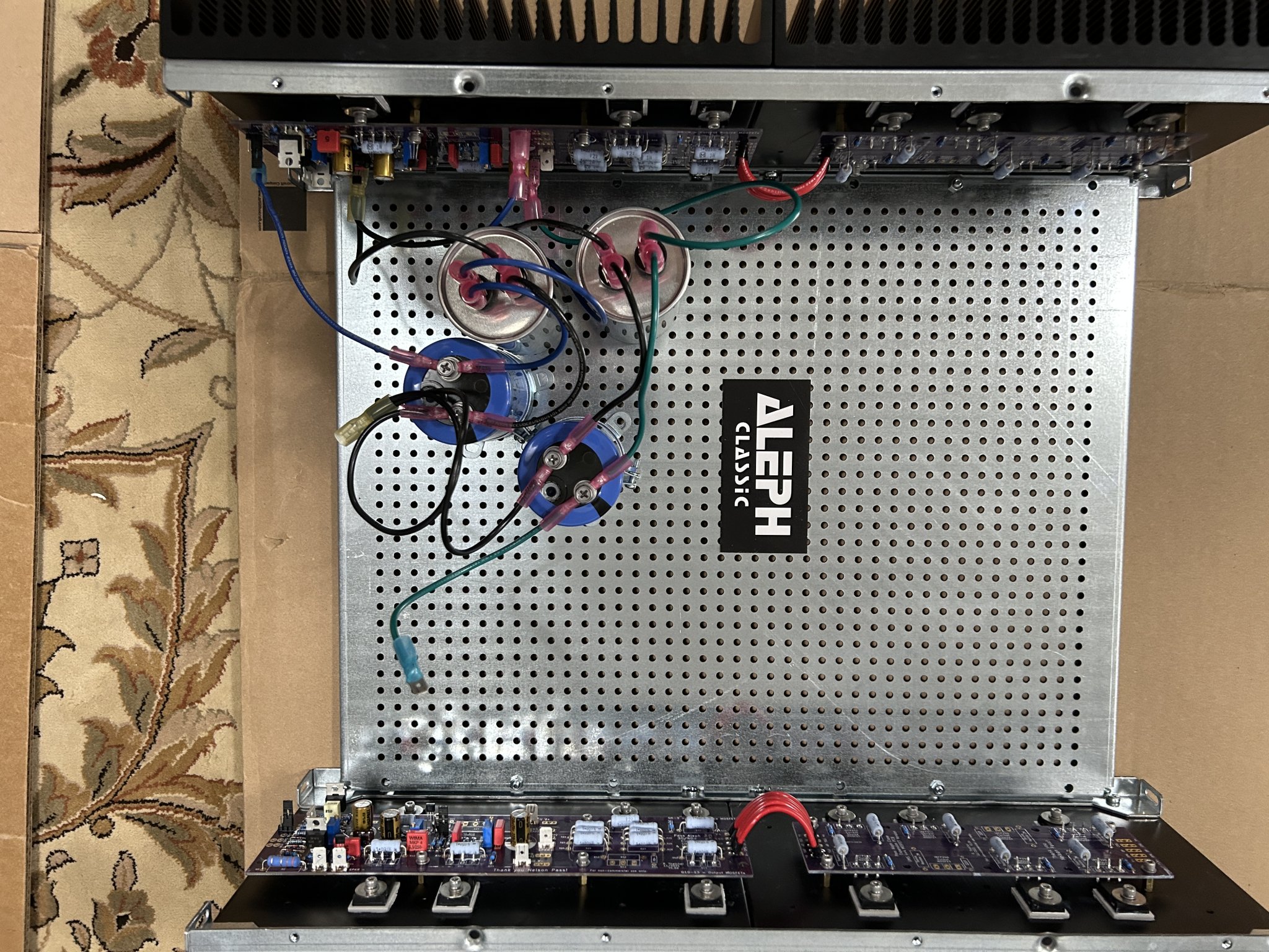

Alrighty... the madness has truly begun... mwah ha ha...
I had enough confidence in the PSU to use it to start to refine bias / offset and begin the initial AC gain settings. Initial bias/offset went off without a hitch.
I wanted to do as much of it with the lids off... just in case something needed to be taken out... so far, so good; knock wood. I'll refine with the lids on, but ... hopefully it will be minor tweaks.
