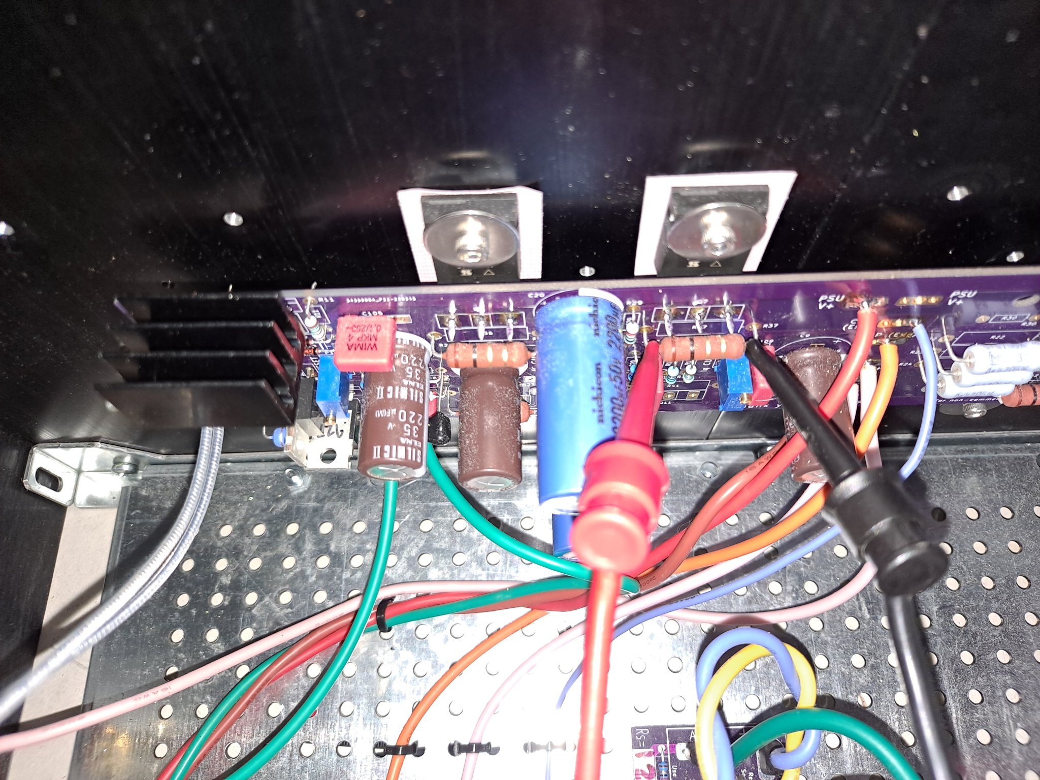

Powered up an Aleph 2 Mono block today.
How hot do Q1 Q2 and Q3 get on the Aleph 2? I can keep my finger on them for about 3 seconds. DC offset and Bias are behaving
Not the heatsinks but the actual IRF9610's
Q3 is at 80 degrees celcius, Q1 and Q2 are at 60 degrees. That is with the top off and the amp not heated up. All the voltages elsewhere look good so I suspect they are biased too high.
Okay that is what I thought. It sounds nice so I wasn't too concerned. I put one on the current source. Thank you Zen Mod.
This is the heatsink that I used just mounted sideways:
https://www.mouser.com/ProductDetail/CUI-Devices/HSE-B254-04H?qs=5aG0NVq1C4zzobMA9RjE5g==
I think the other ones being between 60C-65C are fine like you say.
