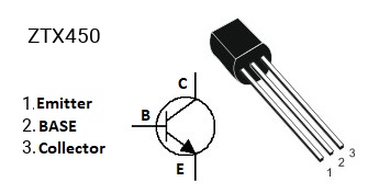

Interesting Dennis. Instructions for the boards stated: "NOTE: Pinout is reverse on 2N4401, and it will be installed opposite to the shape on the PCBs." Maybe there was an update to the board layout. Guess I should have confirmed pinout on the data sheet. 😏
I'm actually not familiar with these boards or the instructions. In any case, I hope turning around the 2n4401 transistors will resolve you problem (and you can change R19 back to its standard value) Good luck.
I think I’ll update the docs with pinout pix. A picture is worth 1000 words, as they say.

Dennis nailed it. No need for more BJTs. Swapped them around and everything is as it should be. Many thanks Dennis for the keen eye.
Feel free to use this if you like. I saved this a while ago. My dyslexia hits hard when dealing with different pinouts.
All build docs updated with ZTX450 and 2N4401 pinouts. Thanks for the feedback.
I also updated a handful of BOM parts that I knew were obsolete or out of stock. As soon as I PDF and publish the docs that will happen to a few other parts.

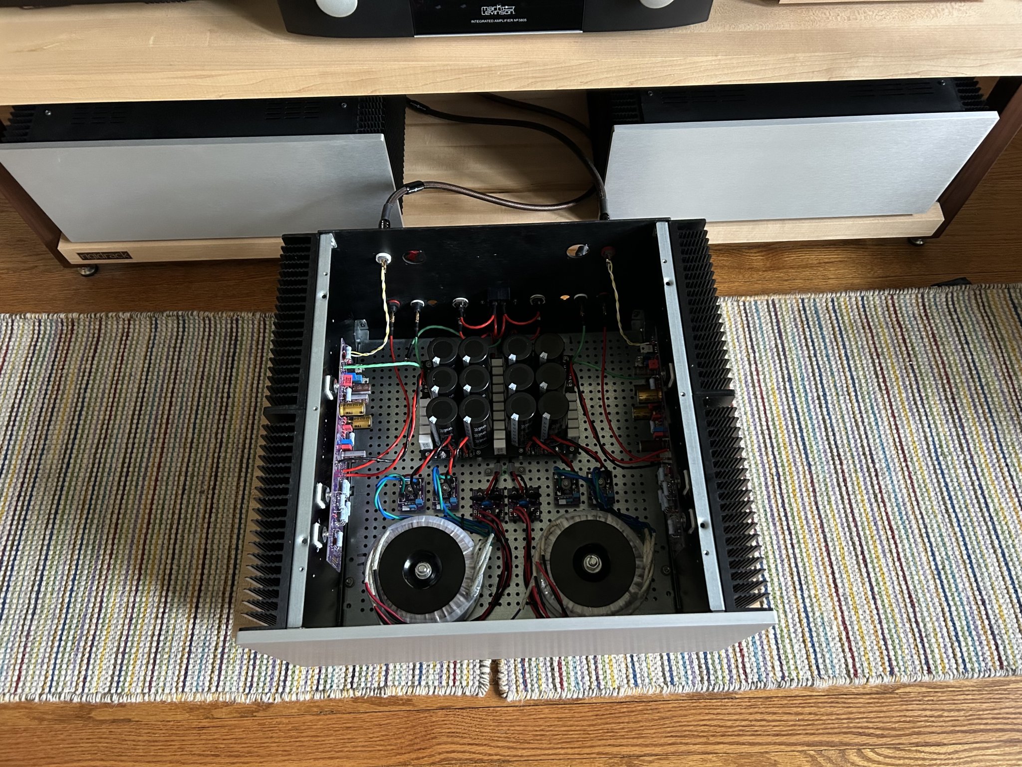

After a week of listening I made a few updates, including Randy's W12 PS board. The CRCRC PS significantly lowered the noise floor of the amp. The quality of the board is excellent. Highly recommended!

Great job! Please tell us what it sounds like compared to the Mark Levinson integrated amplifier.

Also, what are the two other amps you have sitting back there? Looks like a couple more builds!
The other two amps are an Aleph J and F5. I also have an F4 and F6, and have built the BA3 and M2X, but repurposed the chassis for other builds. Since I sold my CJ preamp the F4 doesn't get used much as the ML doesn't have enough gain to drive the F4 to my preferred listening levels. I do use the F4 occasionally with my Bottlehead S.E.X., but I have kind of moved away from listening to the Bottlehead.
The ML sounds very different than the FW amps. It is very polite and pleasant sounding, and easily drives my 4 ohm speakers. It sounds more effortless than the FW amps, which it should given the power rating. But the FW amps are significantly more transparent and detailed, and have a sweeter top end. Of all the amps the Aleph 30 has the most drive and force (at normal listening levels), including the ML, though not necessarily the tightest grip on the low end. The ML beats all the FW amps there. At the risk of offending, the Aleph 30 reminds me of my Naim 200DR amp, albeit much more transparent and sweet sounding.

Thank you for the comprehensive review! FWIW, build yourself either the Aleph 60 or Aleph 2 if you want something with more current drive capability into 4 ohm loads. The Aleph series as a whole has a more ripe midbass but that gets tighter and tighter with larger models at the expense of heat and size.
