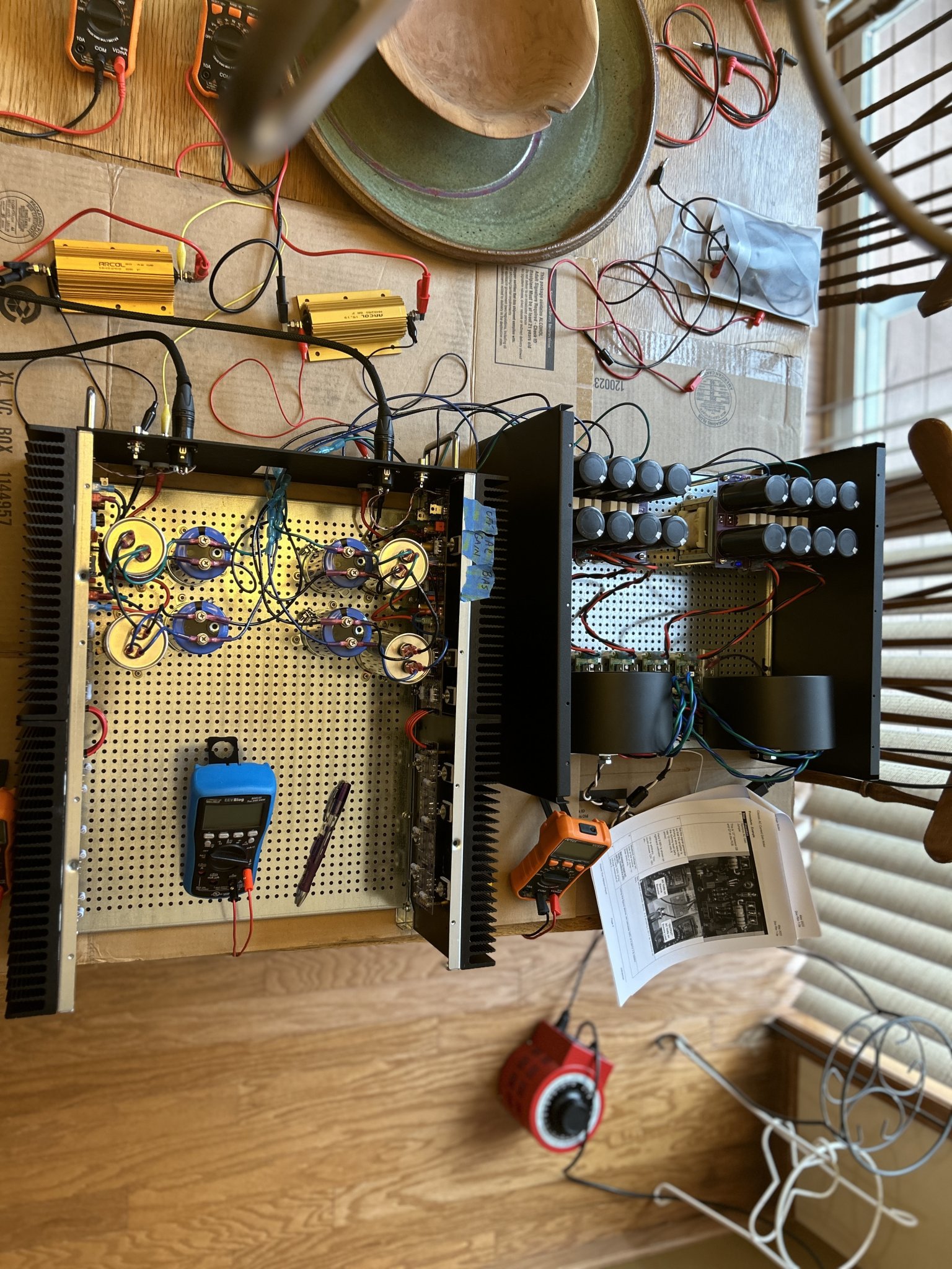

LOL! Well if ZM and Randy struggled with it, then maybe I'll get it in a century or two...

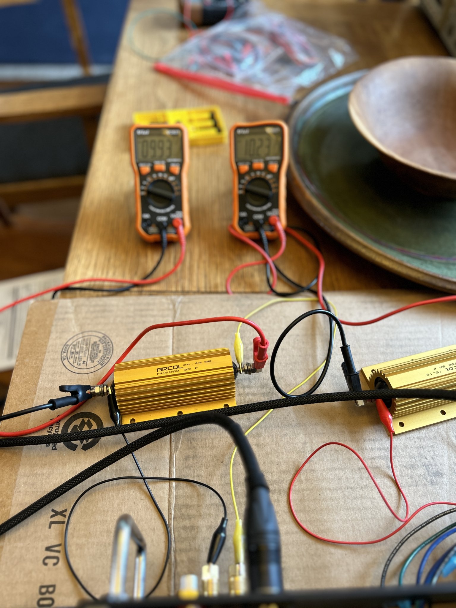

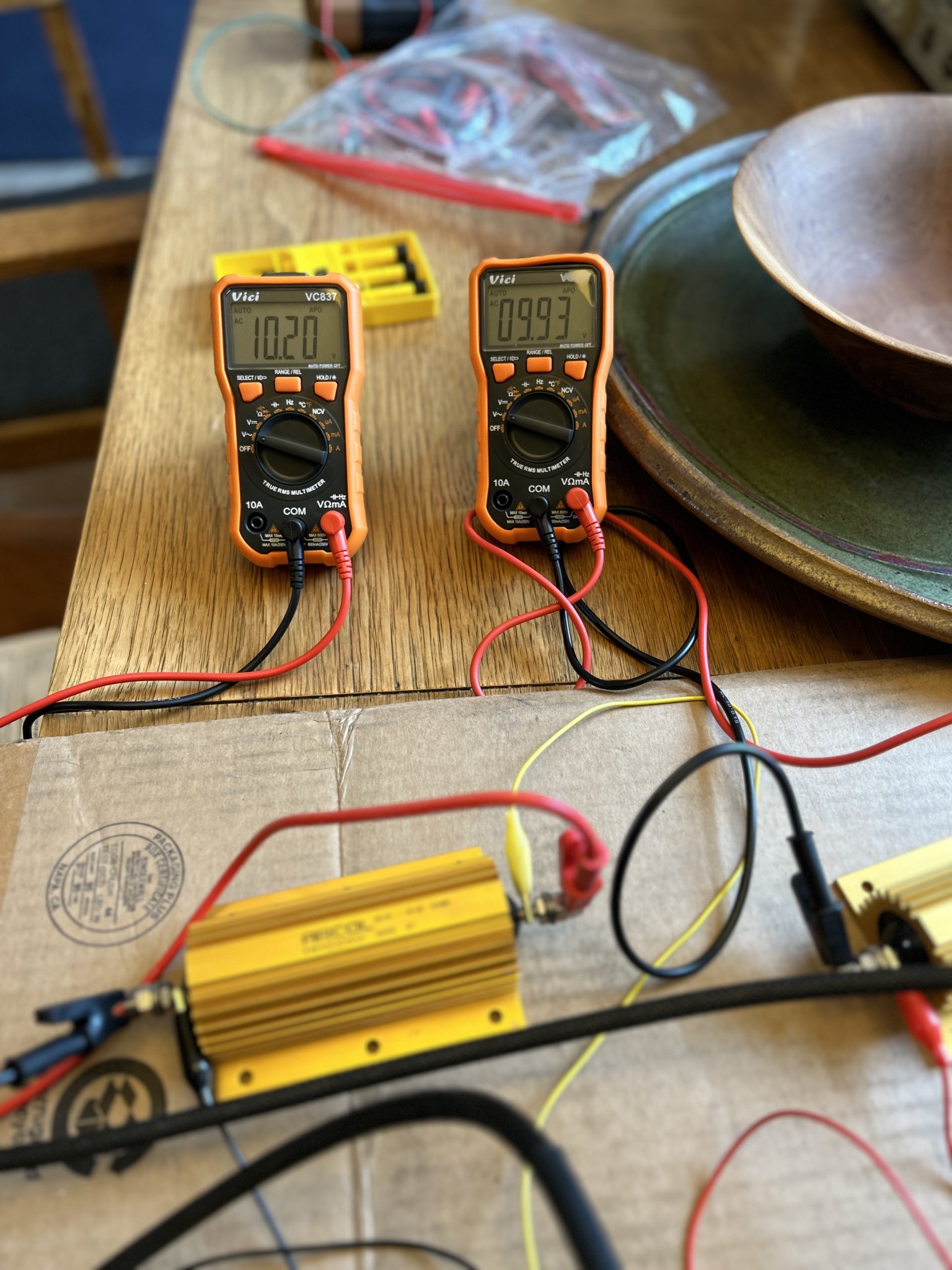

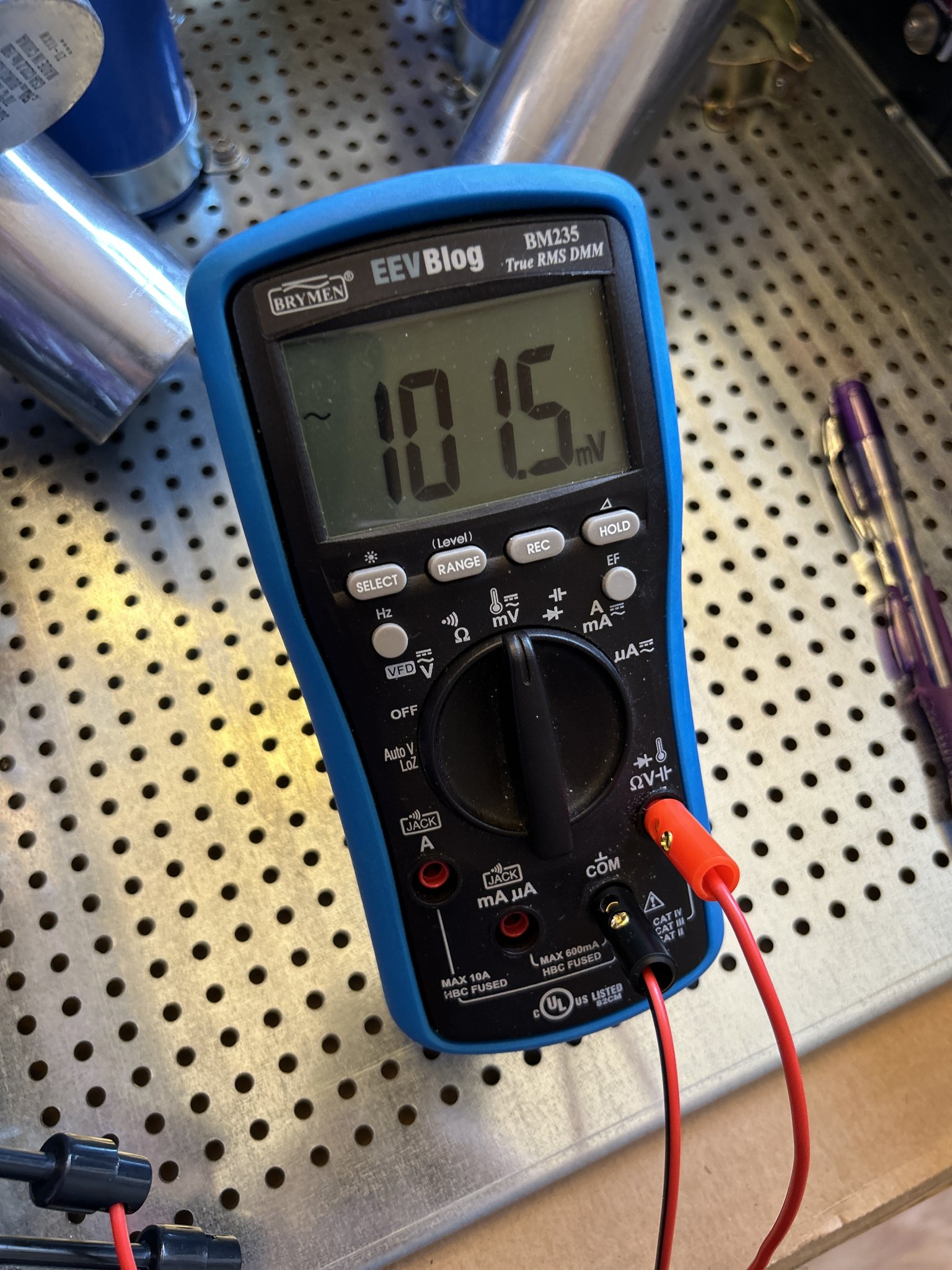

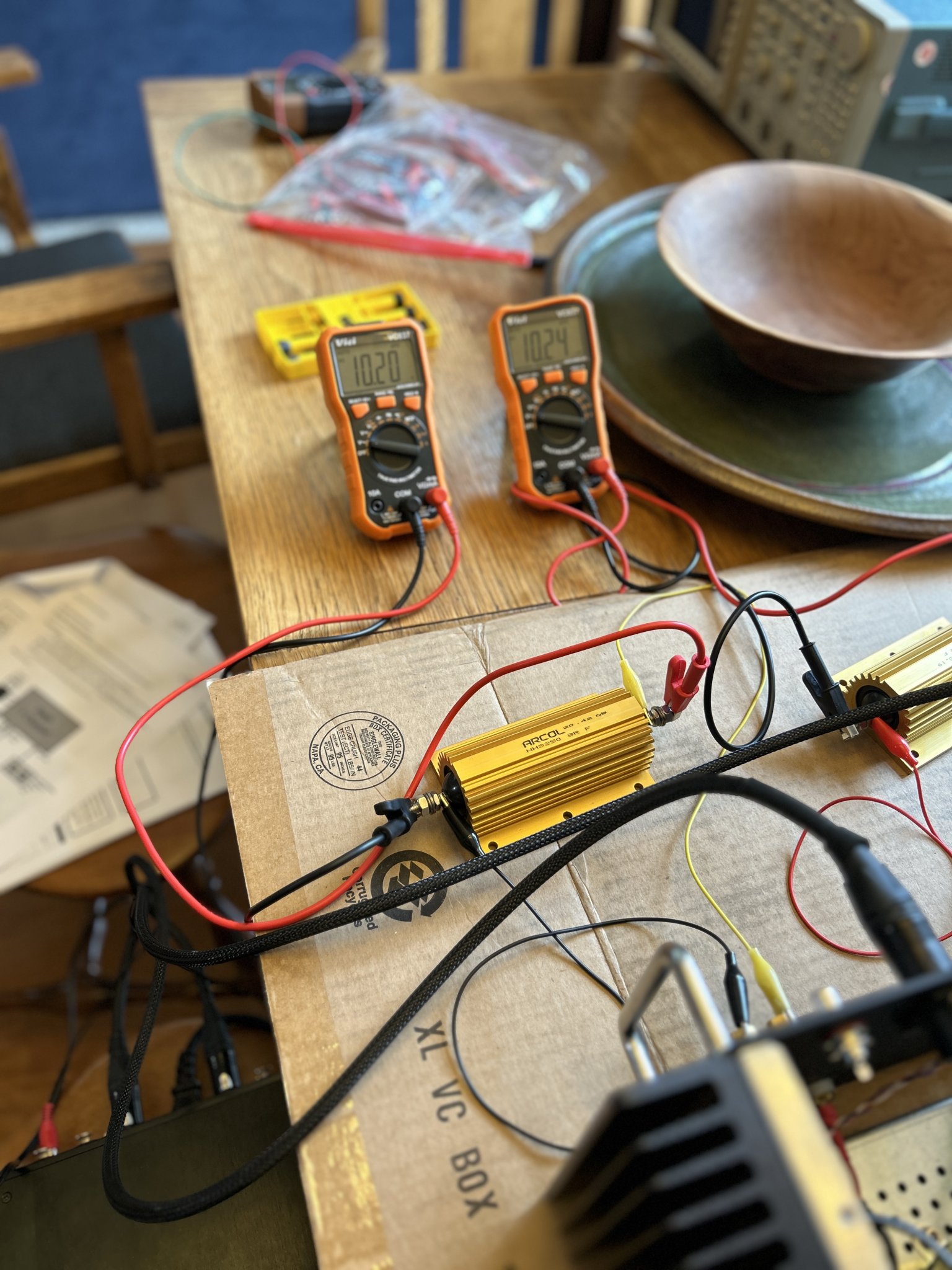

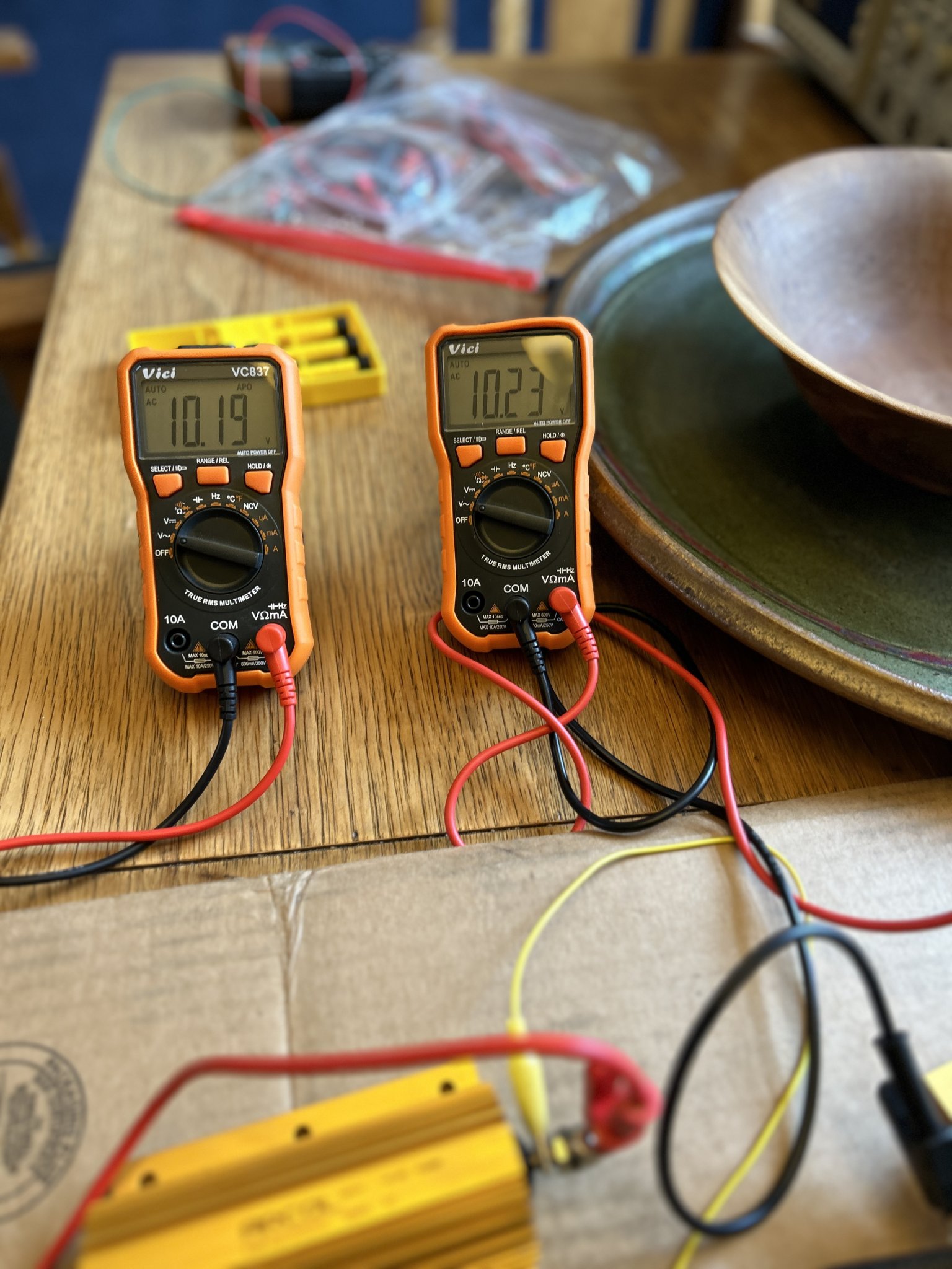

I jacked it up to 10V and the pots didn't even need to be turned. I guess from 4V to 10... same same. Yay!
Note, I left the input signal the same vs. attempting to get a phone volume and a stepped relay attenuator to give the same voltage at the output each time.
Either way... she's ready to mount up and get some tops and bottoms on. Initial bias set to ~2A per channel. Offset is essentially zip, zero, nada, and there ya go. You've all been so kind... here's some pics (named accordingly for each step) of my working disaster area (wife's words not mine)...
She wants the table back for supper... gotta run and hide.
Seriously, you guys are awesome! I anticipate tunes this weekend.

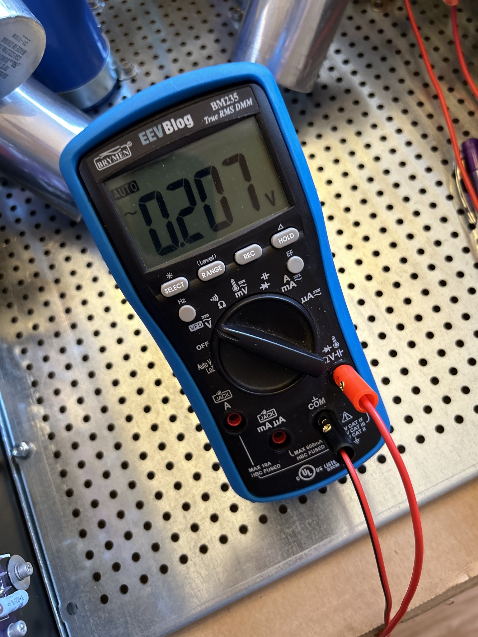

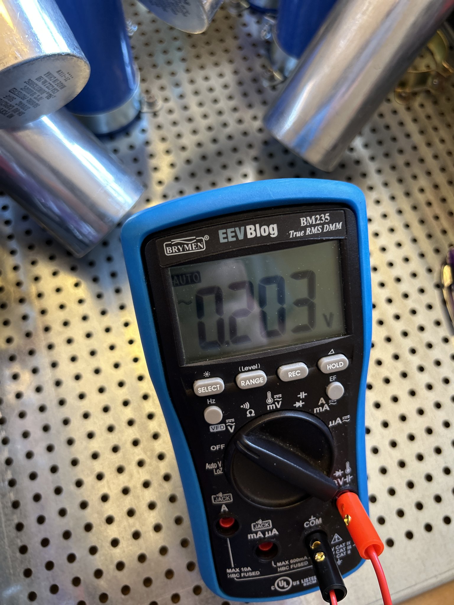

For added fun, one can use an oscilloscope to see how the output waveform clips as a function of the AC gain setting.
At 2Vp-p 100Hz input, my Aleph 20 with an AC gain setting in the 80%+ range gave 20Vp-p at output into 8R. My scope is analog and the whole dB/RMS thing still confuses me so I'll call it 10X voltage gain. If the input was dialed up to 3Vp-p, it would asymmetrically clip the output at the top of the waveform but not the bottom. I'm calling this even-order harmonic distortion.
After adjusting the AC gain to 50% using 2Vp-p in, the output waveform looked clean by eye up to 4Vp-p input and would clip symmetrically at 5Vp-p input. I'm calling that odd-order harmonic distortion. I left the amp this way and it sounds more detailed to me now than before.
^ Thanks for the fun suggestions! I am trying to learn a bit more about the scope. I'll see if I can make that happen.
I would just like to make one small addendum to ZM's method in post #900 (which I used as well):
I suggest that you use as an input signal a 400 Hz sine, or even lower frequency.
At 1 kHz or above, meters might not be accurate in their AC volts measurements.
(... or use two identical meters; since we are doing a relative measurement in this set-up procedure, absolute accuracy doesn't matter if the deviation is the same for both meters)
Regards, Claas

Hi Claas!
Thank you! Much appreciated and noted. I used 100 Hz for the previous methods, and it worked seemingly well. I'll use that again. I haven't done the method ZM described in #900 yet, since I have things torn down for final assembly. What I'll likely do is 'triple check' using that method for fun to see how the different methods agree. I also didn't follow Randy's method exactly since I was too lazy to match the voltage at the output with and without the jumper. Since it's a 'range' of acceptable AC gain, I was more concerned with matching the L and R channels than hitting a perfect 50%.
I'm also anxious to try out @ranshdow's suggestion. I fiddled with REW for a few hours this morning... and I think I have things worked out again, but something is nagging me... So, I paused.
FWIW - I did the 'final' bias and offset with the top and bottom covers on last night. It plays beautiful music, and is rock stable. 🙂 Now, I just need to refine some proper measurements for learning and decide on how to properly get power from the PSU over to the amp.

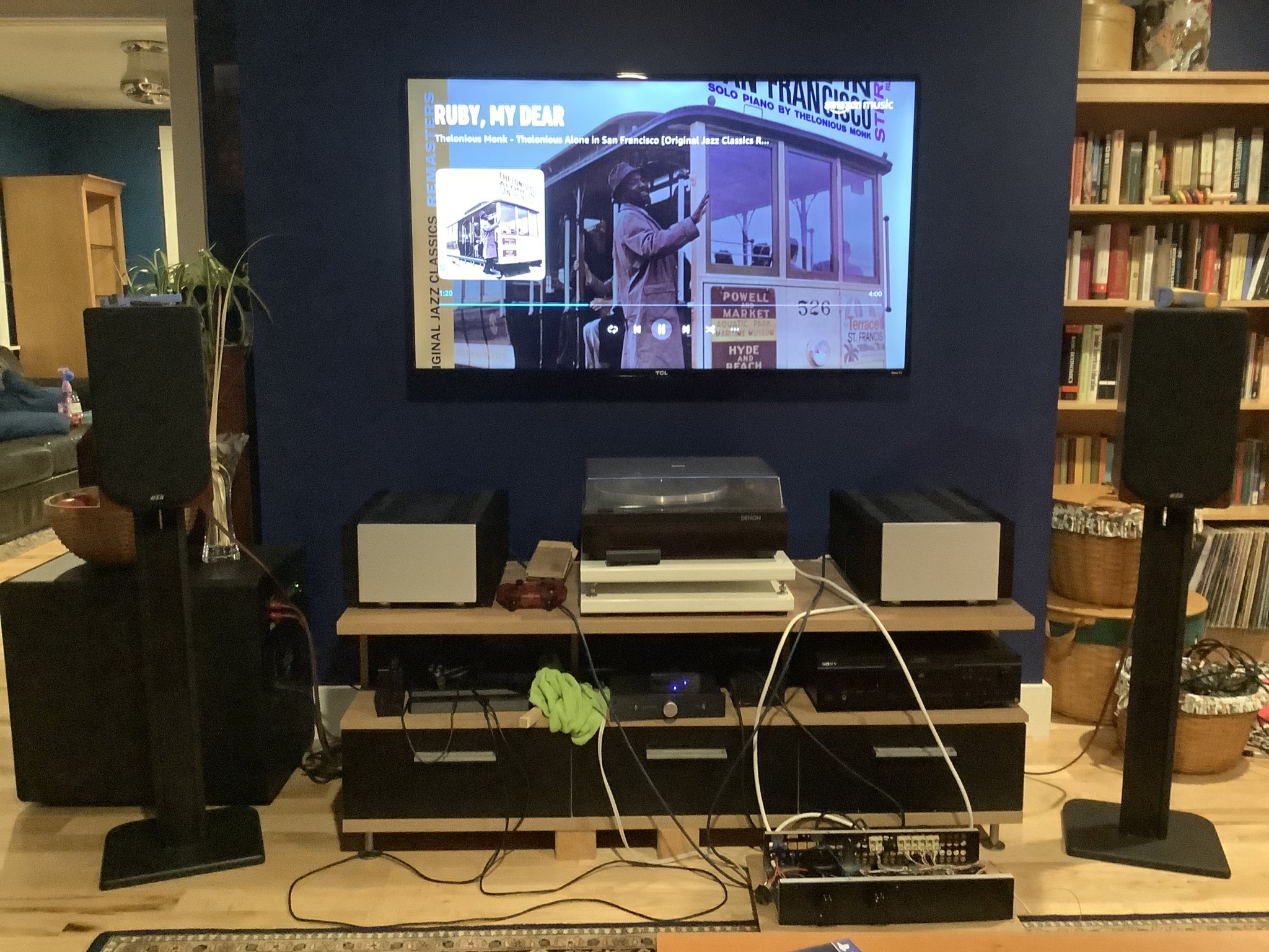

I didn’t realize you were building an A60. I built mine as monoblocks last year. Driving it with the Iron Pre… you are in for a treat.
I love your separate power supply box!
^ Thank you for the kind words. I may put it into the system tomorrow. It makes music on the test speakers, but I have a few more things left to finish up.
Fantastic set up!!! I love that back panel on the Iron Pre.

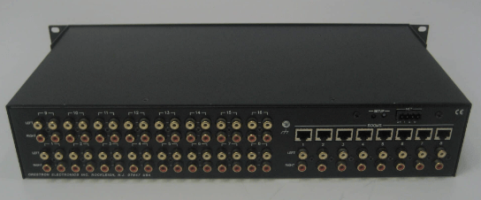

Pardon the mini thread hijack. The Iron Pre chassis used to be one of these. Crestron BiPad 8, $65 delivered. Got a lot of useful parts out of it.

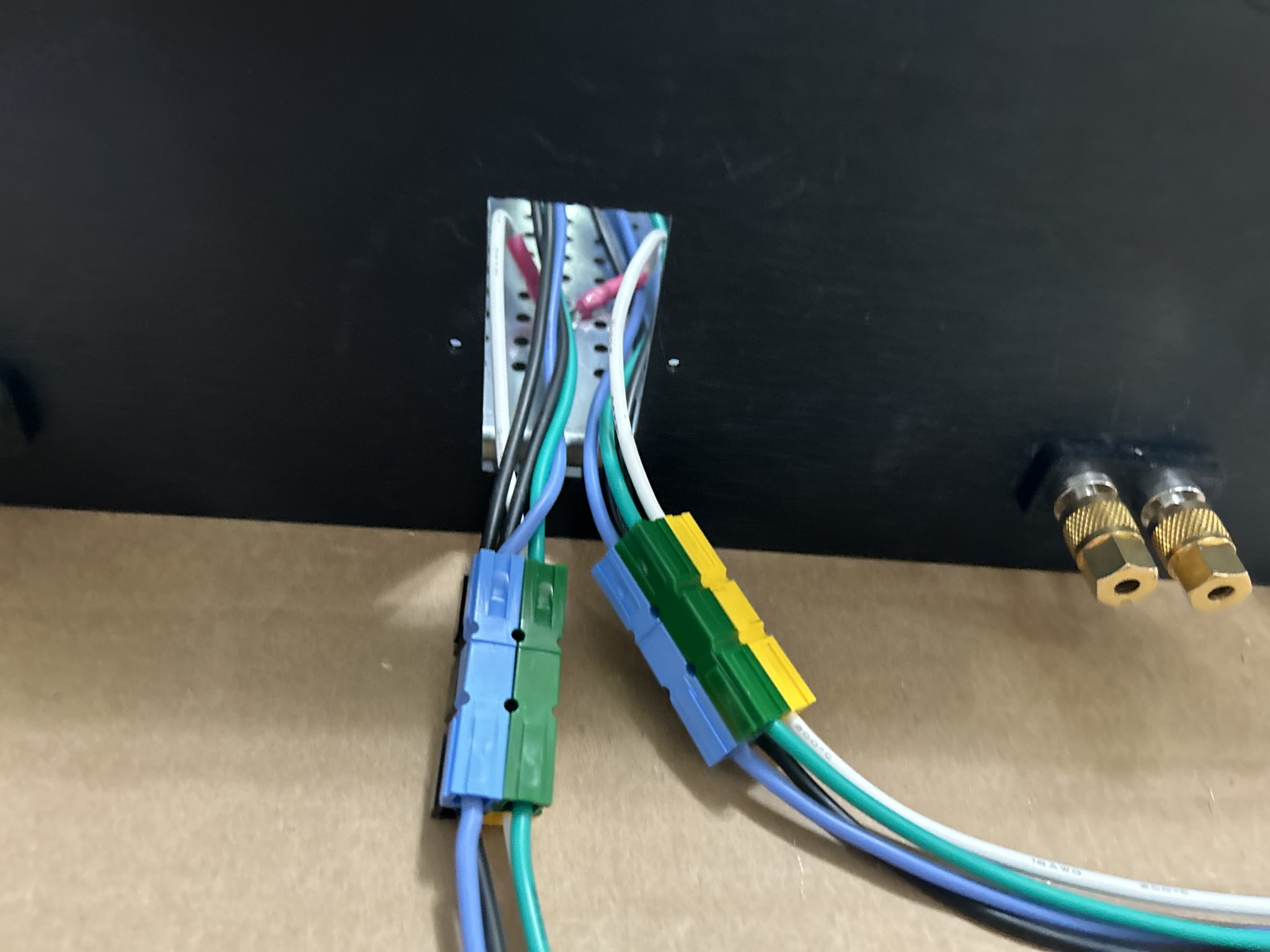

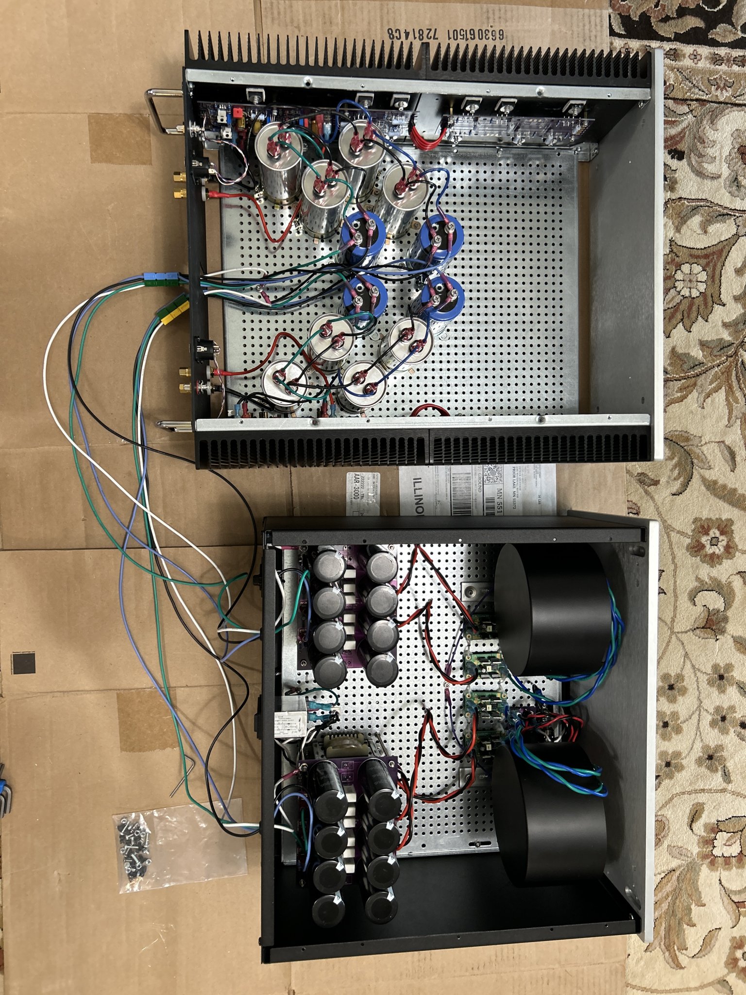

Well. I've made some progress. It was a busy week doing other things, but I managed to put some time in this morning. I had the A60 playing during the week. It was hard to disconnect it to continue the tidying work.
I have everything "close", but it's not done yet.
First, I've decided that I adore the Anderson Powerpole products. It could be a fleeting fling, but for now, I am completely smitten.
Note - I think I mentioned somewhere earlier that I had a similar crimper. I used it. Bad idea. IMHO, the only crimper that should be used is one designed for the product. A ratcheting crimper intended for insulated blade-type / rings etc, is not the correct crimper. Some of you are probably sighing to yourselves... When the correct crimper is used, it makes gorgeous connections. I can now understand why the manufacturer says to not solder them.

Pics of current status attached. I'm pretty happy.
To do ...
What would I do differently? Only one thing comes to mind for the moment. I'd have picked another color coding for my wiring. Green or Green / Yellow should be mains earth. I use it for V-. No biggie, but I think it would have been more 'standardized'. So, for now, the housing is yellow, and the wire is white.

Dual mono external CLCRC plus MASSIVE local cap bank. I can’t wait to hear your comments on the sound. That is seriously well done!

That power supply is pure awesome.
And the cap-chain in the amp chassis too.
