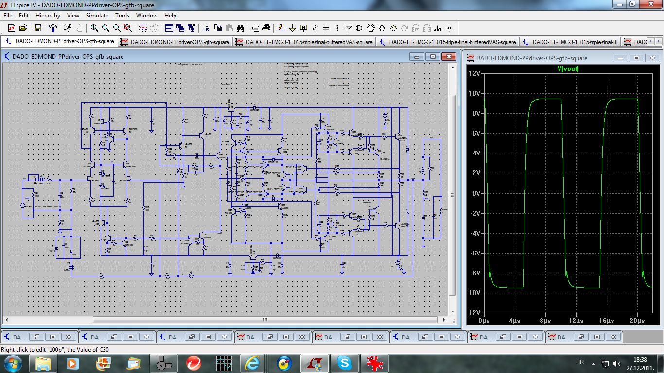

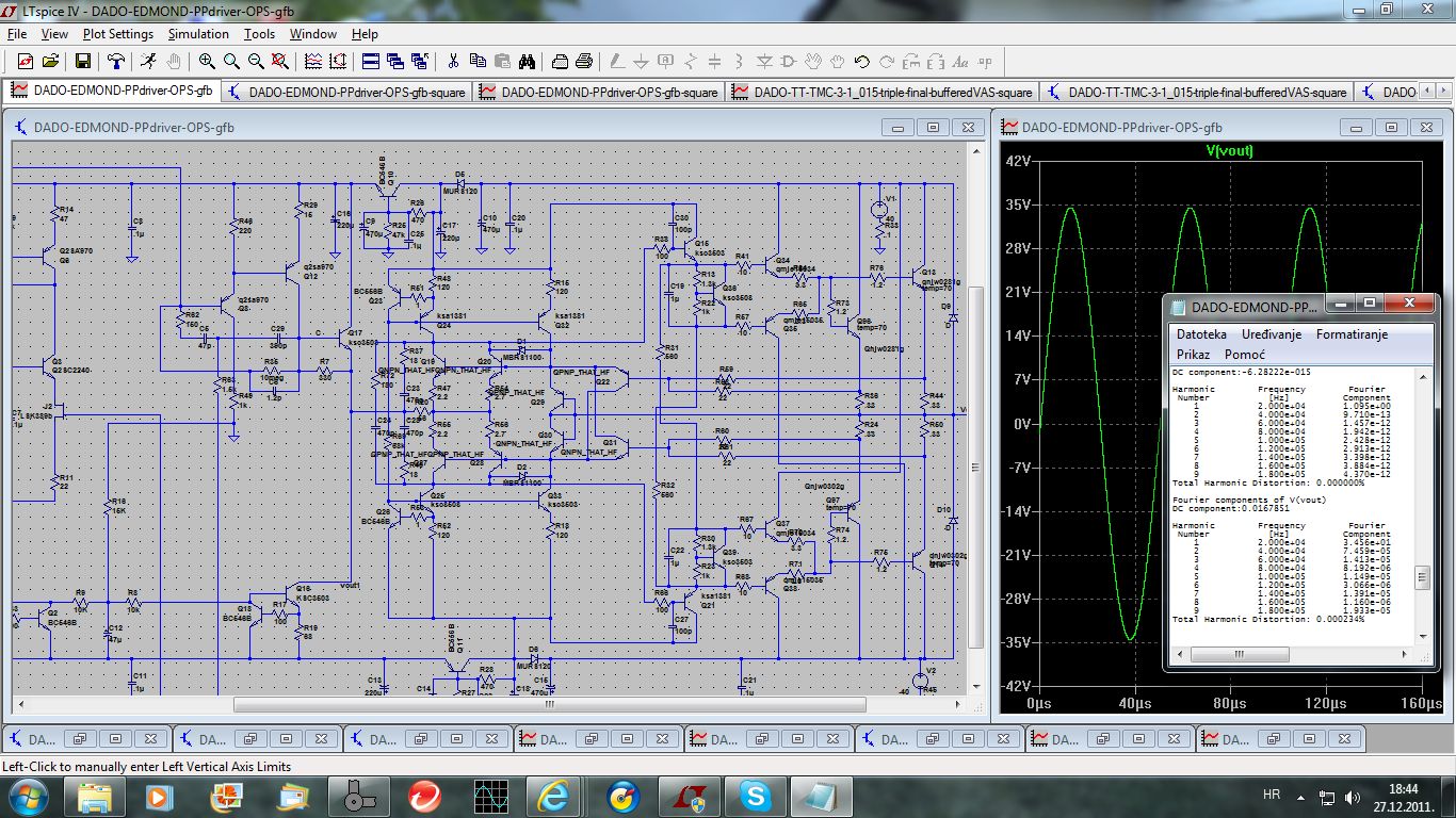

Here are the first simulations with Edmond's new AB2 PP output stage connected with my input stage I used in other simulation.
As Edmond promised this OPS can do square wave test much better, here are simulations charts.
Damir
Hi Damir,
Indeed, that looks better. But I also urge you to watch the currents through the OP devices. How large is the cross-conduction?
BTW, you are confusing me a bit. I thought you were after an OPS you could tie on your tube pre-amp. Therefore I'm busy with a high input impedance and low offset version of AB2.
E.

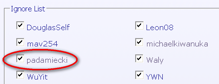

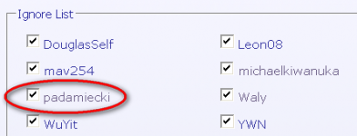

You ignoring many people?
Eight out of 197405 isn't that much. Don't make it nine. 😉

Hi Edmond,
Yes I would like to use it with tupbe pre and no global feedback, but simulating like I did shows me more about stability. I will simulate it separately too.
How large is the cross-conduction? I am not sure if this chart shows cross-conduction!!
Damir
Damir

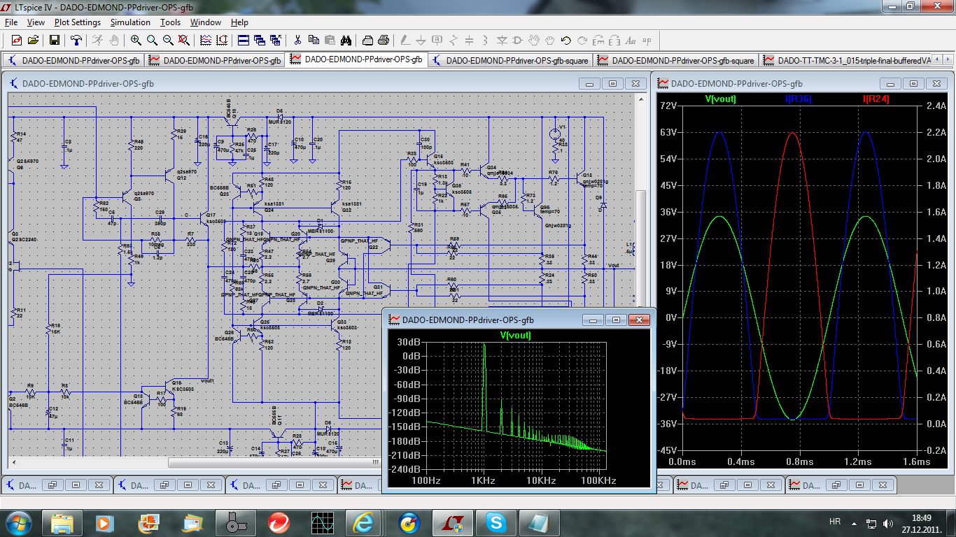

Hi Damir,
If you intend to use it with your tube pre-amp, the AB2 OPS has to be optimized for different properties: high input impedance and low offset voltage. So it makes not much sense to simulate the OPS when integrated with an IPS and VAS and applying global NFB.
Instead, you need to know the properties of the pre-amp output (impedance at DC and AC) and use these impedances in you simulation.
Damir
The cross-conduction is determined by the intercept point of the current through 'top' and 'bottom' OP devices. In this case it's about 100mA. Because it appears to be the same as the quiescent current, it's perfectly okay.
But what happens in case of square waves or a sine of say 250kHz? An ideal OPS should show the same (low) cross-conduction, though that's not always possible.
