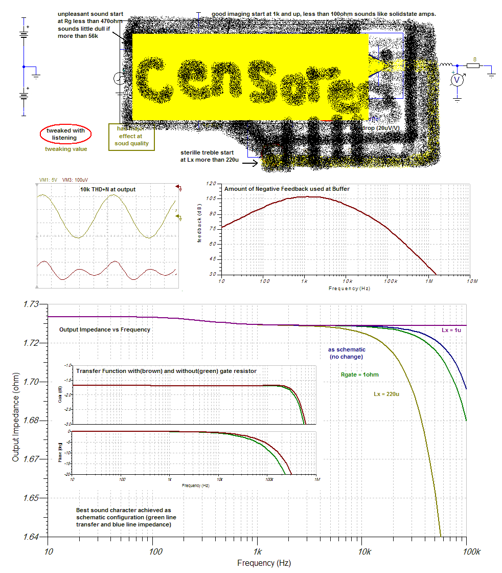

Psst.. no cimpiraibli i using ears...
if you looking for earable comparison try another one like this DOT. It is comparable with SE 805 + 300B configuration. Even better in treble(high).
But class i+siblings really are fun and interesting for engineering, marketing and visual comparison. Indeed..
