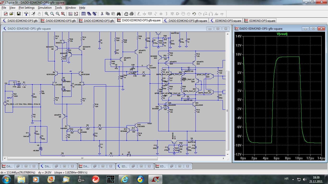

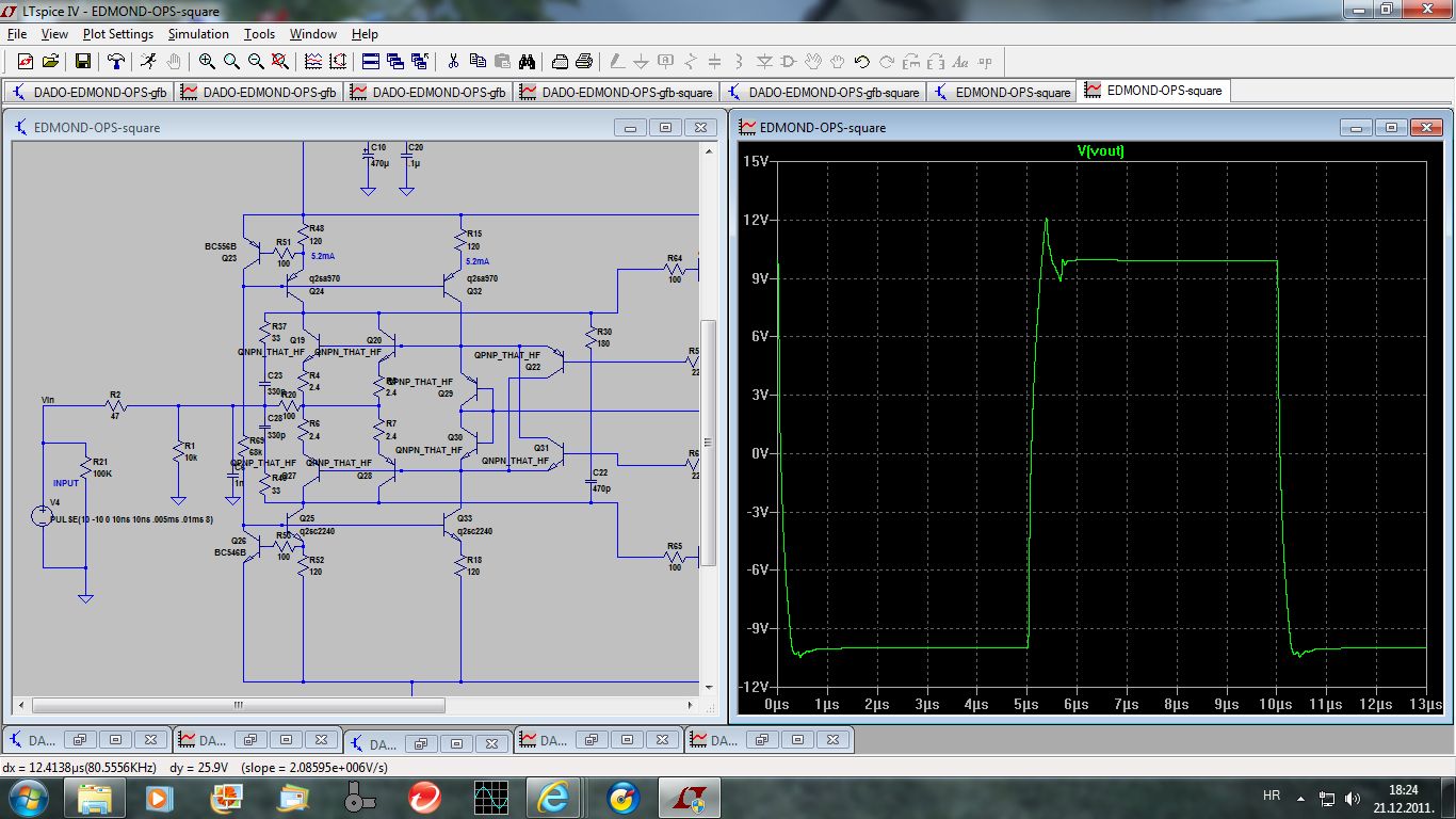

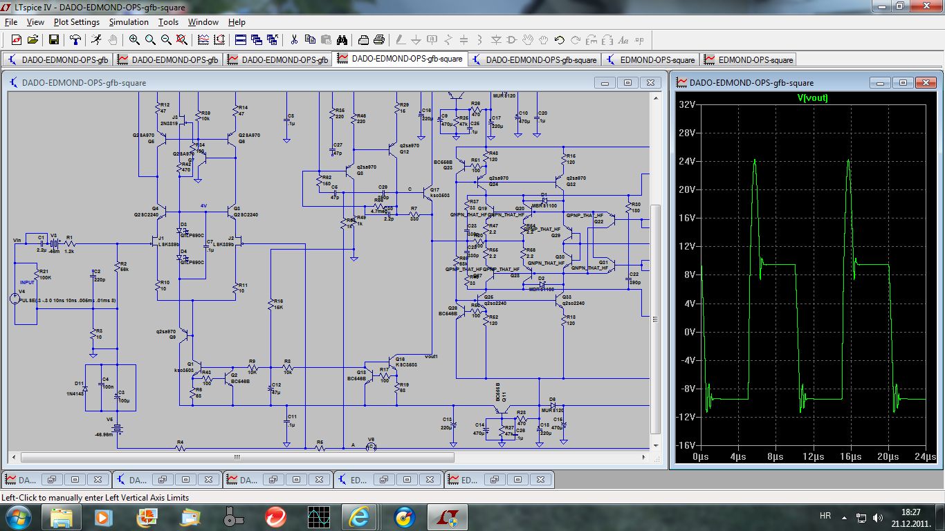

AB2 square wave simulation
Hi Edmond,
I did some simulation with square wave, and it is not very encouraging. If I test with a bit higher input signal it vent berserk.
First test is solo OPS. Slew Rate cca 80V/usec
Second is full amp with no input filter connected.
Third test with input filter connected, Slew Rate cca 30V/usec.
What do you think about it? Not very promising.
Damir

Hi Damir,
I'm not surprised at all, as you are torturing the OPS. For two reasons you got ugly results:
1. Drivers for the top respectively the bottom OP devices consist of only a single EF stage instead of a push-pull stage. Regrettably, it's a bit difficult to implement the latter, as such arrangement will compromise the headroom of the bias circuit. (Therefore, I prefer vertical MOSFETs, with a much higher Vgs than the Vbe of a BJT). Sliding bias schemes are crying for separate push-pull drivers, as a speed-up capacitor (between the emitters) is forbidden. If you still insist to use BJTs, well, it has a prise.
2. Because of the limited speed of the internal loops inside AB2 (the ULGF is 'only' 3MHz) you must filter the transients of a square wave test signal drastically, preferable by means of a 2nd order Butterworth low pass filter with a Fc of around 250kHz. In this way the slew rate, or more precisely the rise and fall time is kept to a safe value. Now, it may look as if the slew rate is limited (to 50V/us or so), but actually, we are dealing here with a finite rise and fall time. Nothing wrong with that as long as it is determined by a filter and not by deficiencies of the amplifier itself.
BTW, in case of a 1st order filter, you have to chose Fc much lower. That's why I recommend a 2nd order filter.
(hope this helps)
E.

Hi Ontoaba,
Sure, that is, if you take the time and effort to (hand) select them for tight matching of Vbe, within a few mV.
As an aside (and joke), one might argue that, given the time to select the right trannies, AB2 doesn't deserve the name 'auto bias' any longer, as setting the bias by means of a trim pot takes far less time. 😉
Damir VAS is saturated in square wave test, and it is three stages so it need more time to recover. Of course Audio amp won't eat any square waves, using filter will help.
You're right, amps won't eat any square waves. Tortured with infinite fast transients any amp will be pushed beyond its limits.
In case of this amp I don't know yet what causes it to get 'berserk'. Saturation, lack of headroom of the bias circuit, missing Baker clamps? With vert. MOSFETs I got much higher slew rates. Maybe AB2 doesn't like BJT output devices anyhow. I have to figure that out.
E.

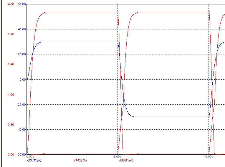

push-pull drivers
Hi Damir,
As I explained elsewhere, in order to discharge the gates or bases of the OP devices, you really need separate push-pull drivers, as you can't use the ubiquitous speedup cap. Without them, of course the OPS 'went berserk' when subjected to an unconditioned square wave.
In the meantime I've figured out how to implement such drivers* (without compromising the headroom of the bias circuit). Now, the square wave response is much better. You still need a filter (anyhow), but I could increase the cutoff frequency to 500kHz with out any troubles. Without filter, hardly any overshoot (rather 'undershoot') and more seriously, an enormous cross-conduction. Needless to say to avoid that at any time.
Below the SW response at 50 KHz and 30Vpk. Blue = Vout; Red = Ie; Max. SR = 100V/us. Notice that there is still some cross-conduction: about 1A, though during a very short period of time: less than 1us.
* at the expense of 4 additional trannies, two for the drivers and two for the bias spreaders.
E.
