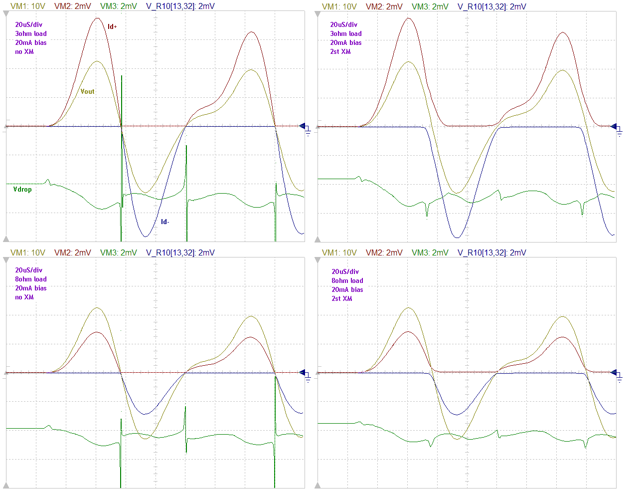

Ok, no more improvement, it is my OPS that need to be improved, because your AB2 works much better with my XM, around 1mV spikes 😱.

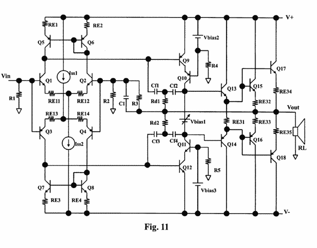

Hi Edmond
The granting of this new patent is like a joke, the author has even patented outputstage inclusive miller compensation which has and is widely used. As TMC was patented before and is public knowledge this patent should never have been granted.
Watch out guys, I might just get the nerve to go patent miller compensation or even better Negative feedback again. 😀😀😀

I might be able to help here, Pioneer do have a patent but they also used the circuit in a discreet implementation in a amp or two. Ill try post the circuit if Edmond and DAdod dont mind as its offtopic.

I don't get spikes at all, only a tiny wobble .....
If you get spikes then something is fundamentally wrong, either your schematic or your simulator.
Sorry I am not explain before, that I am using less than 50mA (just30or20) bias and lower the loop gain at HF for stability, so the spike normally appeared. There also no significant spike at 100mA or higher bias.

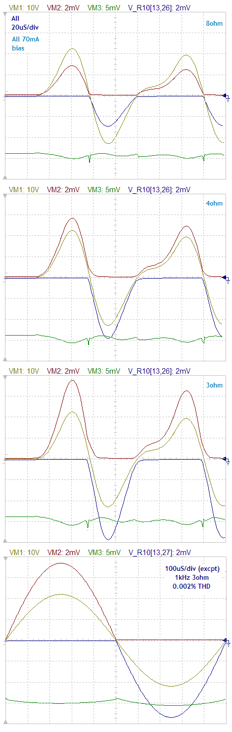

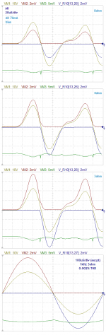

Spikes
>I am using less than 50mA (just 30 or 20) bias
Hey man, that's Class-B. No wonder you get spikes.
For two reasons that doesn't work, or at least far from optimal:
1. It's generally agreed that MOSFET OPSes should be operated in class-AB. That means a quiescent current of at least 100mA (150mA is a good compromise between low distortion and excessive heat production).
2. Auto bias circuits (Class-I, AB2, LT1166 etc) are based on the so called geometric mean concept. IOW, they try to keep the product of the P and N channel FET currents at a constant level. You can't use this technique for class-B output stages; only for class-AB. Why?
Suppose Iq = 30mA and the maximum current is 3A (100 times more). That means -for a constant product- that the trannie(s) of the other gender should draw 30mA/100 = 0.3mA. This tiny current times a typical sense resistor of say 0.33 Ohm gives 0.1mV.
A simple circuit built around a few discrete poorly matched trannies can never handle such small a voltage with sufficient accuracy. An ideal precision multiplier might handle it, but only at low frequencies. Above 100Hz or so, capacitive effects (gain roll-off etc) affect the accuracy too much and the circuit goes berserk, i.e. spikes.
Now, suppose Iq = 150mA and the maximum current is (again) 3A, i.e.20 times more. In this case the current through the other tranny is 150mA/20 = 7.5mA, being 25 more than in the previous case and it gives 2.5mV across the sense resistors. With reasonable matched trannies this voltage is manageable. But to be on the safe side (the circuit should work under a wide range of temperatures and components tolerances), I even prefer a much higher minimum current in the order of 50mA. As a result, no spikes at all and a much lower distortion. Happily, you already figured that out by yourself.
E.
edit: NB, in Kedall's class-I BJT OPS the bias current is 135mA.

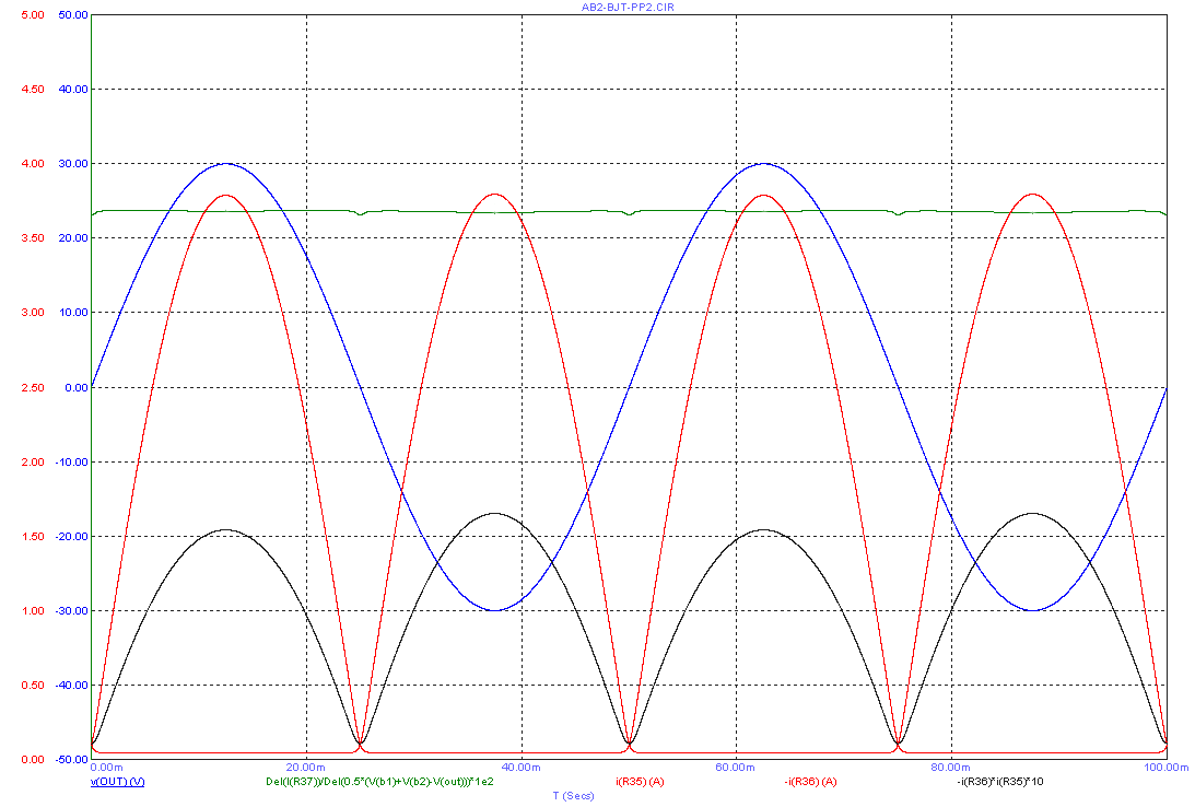

Hi Edmond
Some ten years ago I’ve analyzed a circuit that is now called “Class-I” (don’t know why – maybe ask Mr.Nakayama?).
Hi Mir,
Kendall Castor-Perry was the man who dubbed it Class-I. I'm not sure who's the first inventor, he or Nakayama, though I think it was Kendall.
This circuit (unlike the most of other nonlinear ones) yields to precise mathematical analysis without simulations or approximations. The result shows that the product (Ip*In) is not constant. The relationship is slightly more complex.
Can’t say anything about other circuits. May be your simulation software can plot the product against output current like the currents themselves in Fig.8 of your basic “AutoBias_II.html” for those and new variants.
You're right. The relation is more complex and the product isn't really constant. That's why I've said that the circuit only approximates a constant product or tries to keep it constant. Regarding the AB2 circuit as posted on this forum, this one behaves the same as depicted by fig.8 on my website. The pictures below, black curve, shows the product. As you see, far from constant. The main reason is that the minimum Ie has been considerably elevated to 40mA on purpose (for safety reason).
I’m especially interested of your ingenious cross-connection solution.
Cheers Mir
The cross-connection reduces the feed-through of switching currents (of the sense trannies) into the main signal path. As a result, less induced distortion from these trannies. However, it has hardy any effect on the Ip*In product.
PS. I think that either precondition on or relationship between Ip&In will disturb the main condition:
Ip-In=G*Vin, where resulting transconductance G is constant (except those which are the consequences of this condition).
That's a very good point. Also Damir put a (related) question about this subject. For a BJT OPS there exist the so called Barny Oliver optimum point (26mV across both emitter resistors), which provide a more-or-less constant gm over the whole range of output currents.
The schematic on page 41 however, seems to violate this rule, as the sum of voltages across R35 & R36 is much higher: 66mV. That means gm doubling, isn't it? Nope! Apparently, it's all a matter of definition. In this case we should define Vin as the mean voltage of the top and bottom driver input. Thus Vin = 0.5 * ( V(B1) + V(B2) ) and the ouput current is I(R37).
So the incremental transconductance becomes: gm = del( I(R37) / del (0.5 * ( V(B1) + V(B2) ) - V(out) )
To my own surprise, gm is almost perfectly constant. At Vout =0 there is a tiny dip of about 2.7%. No gm doubling at all. See the green curve.
In case of a MOSFET output stage, the picture is quite different. There is no optimal bias point, with or without auto bias. Gm gets reasonably flat at only a very impractical Rs of 1 Ohm or more and a bias current of at least 1A. With Rs=0.22 Ohm and Iq = 150mA my simulation shows a gm variation of about 1:3. Except class-heat, I'm afraid there's nothing we can do about it.
E.

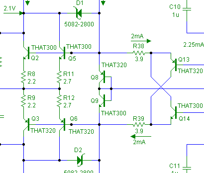

Hi Damir,
It appears to be quite simple to lower the voltage across the emitter resistors to just 26mV. I was afraid that it should compromise the temperature stability, but that wasn't the case. It's even slightly better, see table.
Simply insert two 3.9R resistors (R38 & R39) as shown below and decrease RE from 0.33 to 0.25R.
E.
Hi Damir,

What about R38 and R39, not needed??
Damir
