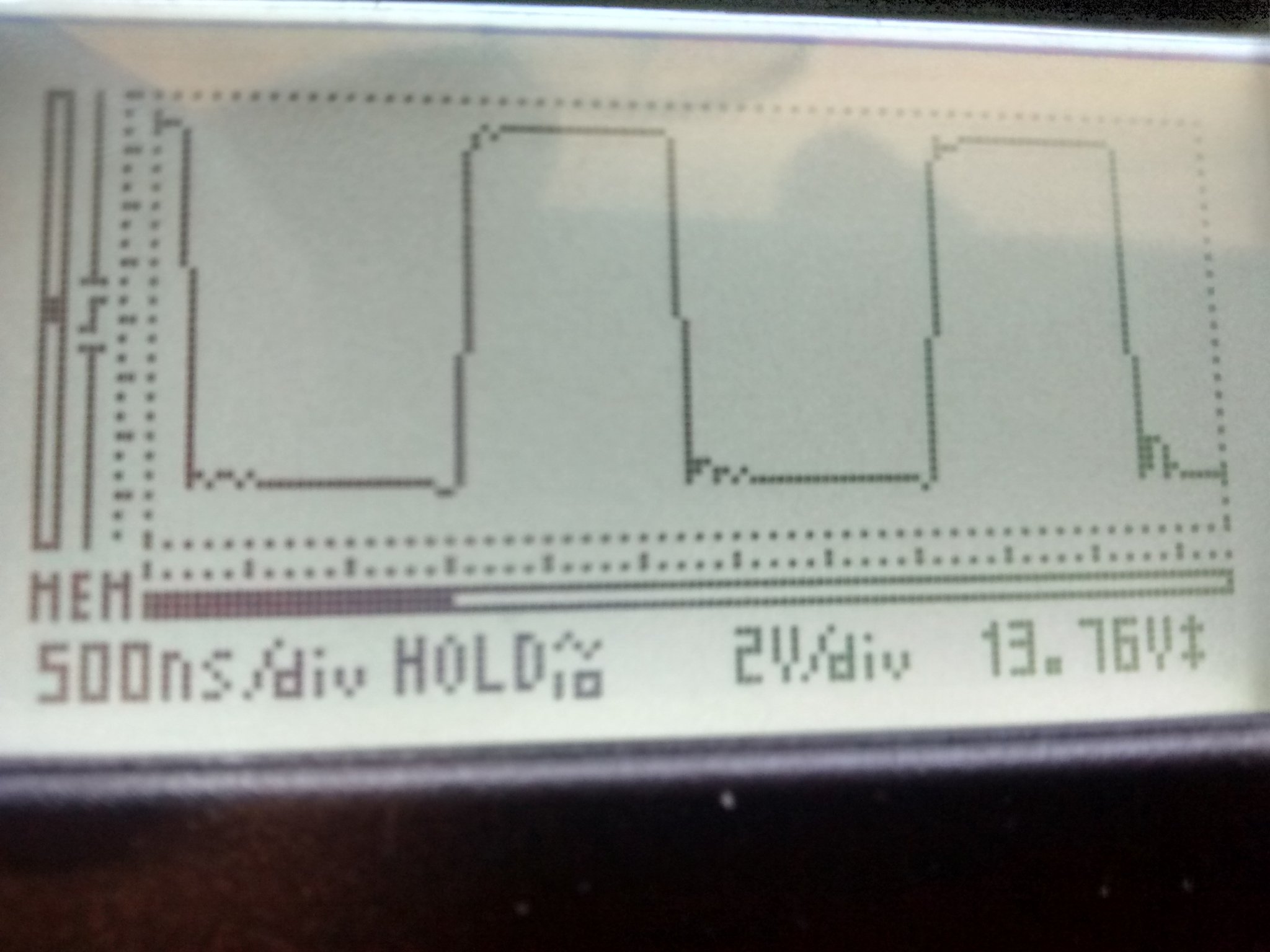

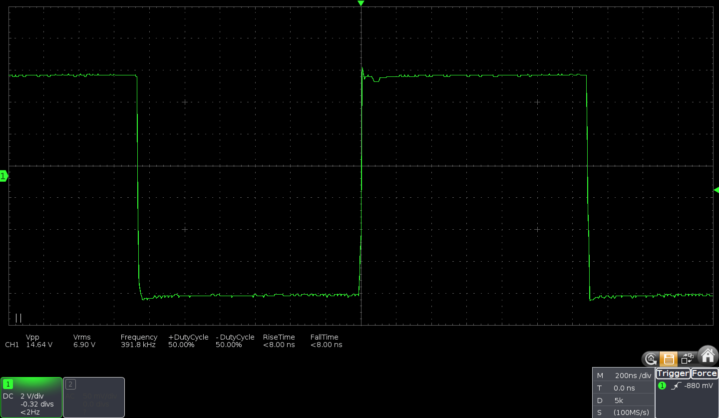

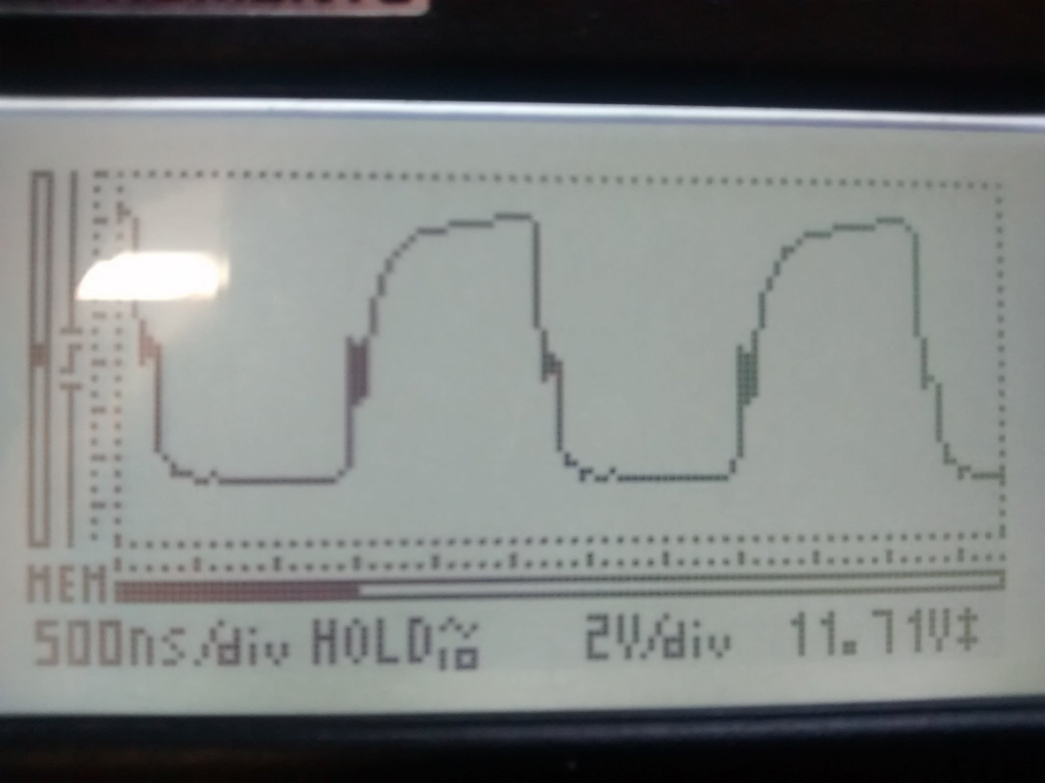

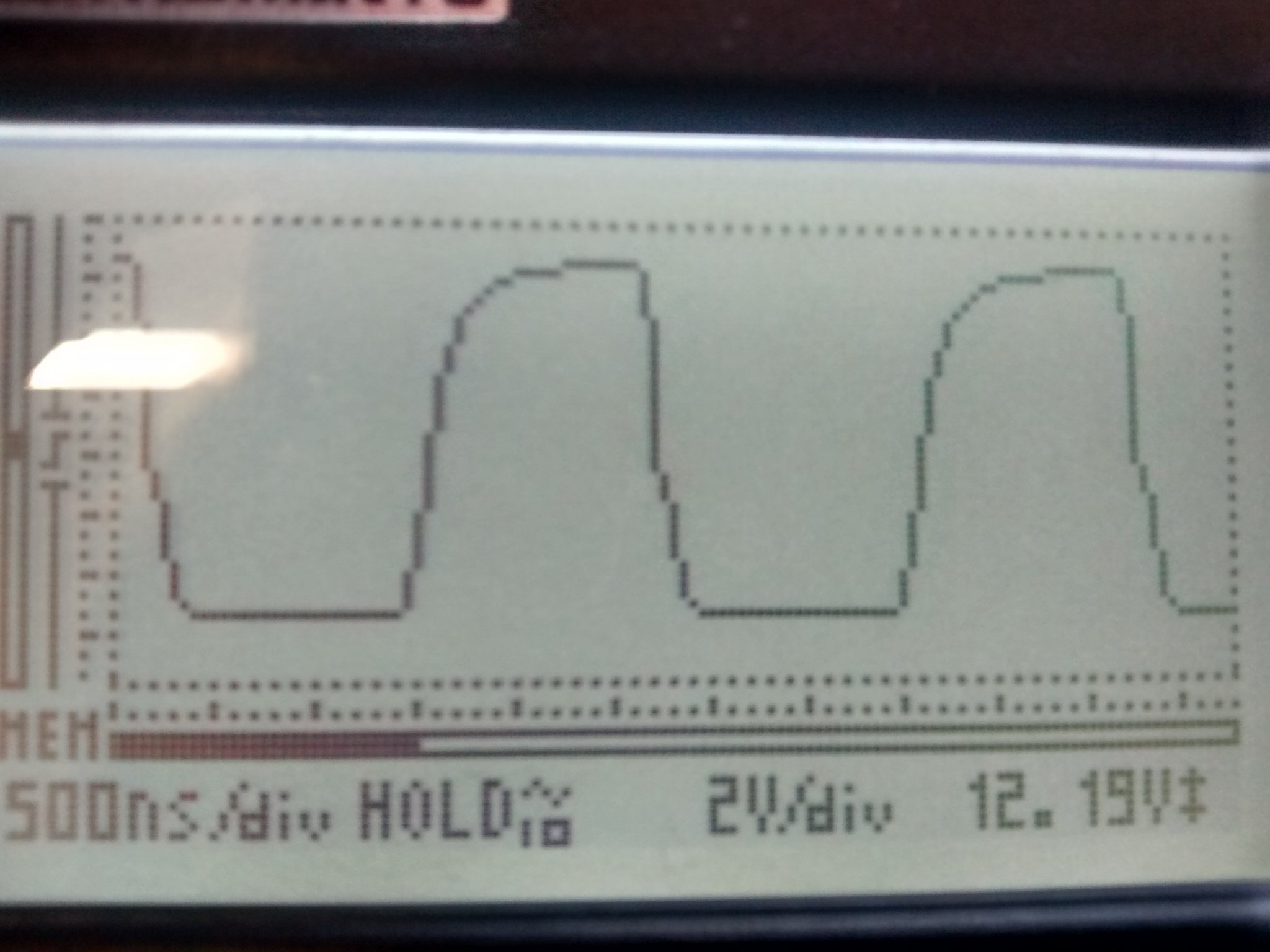

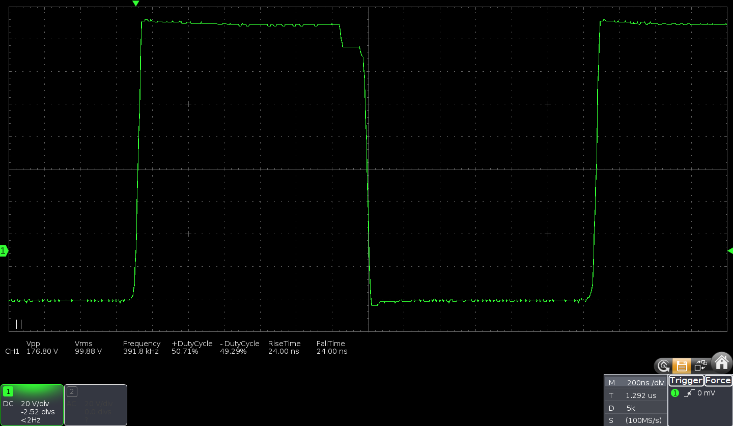

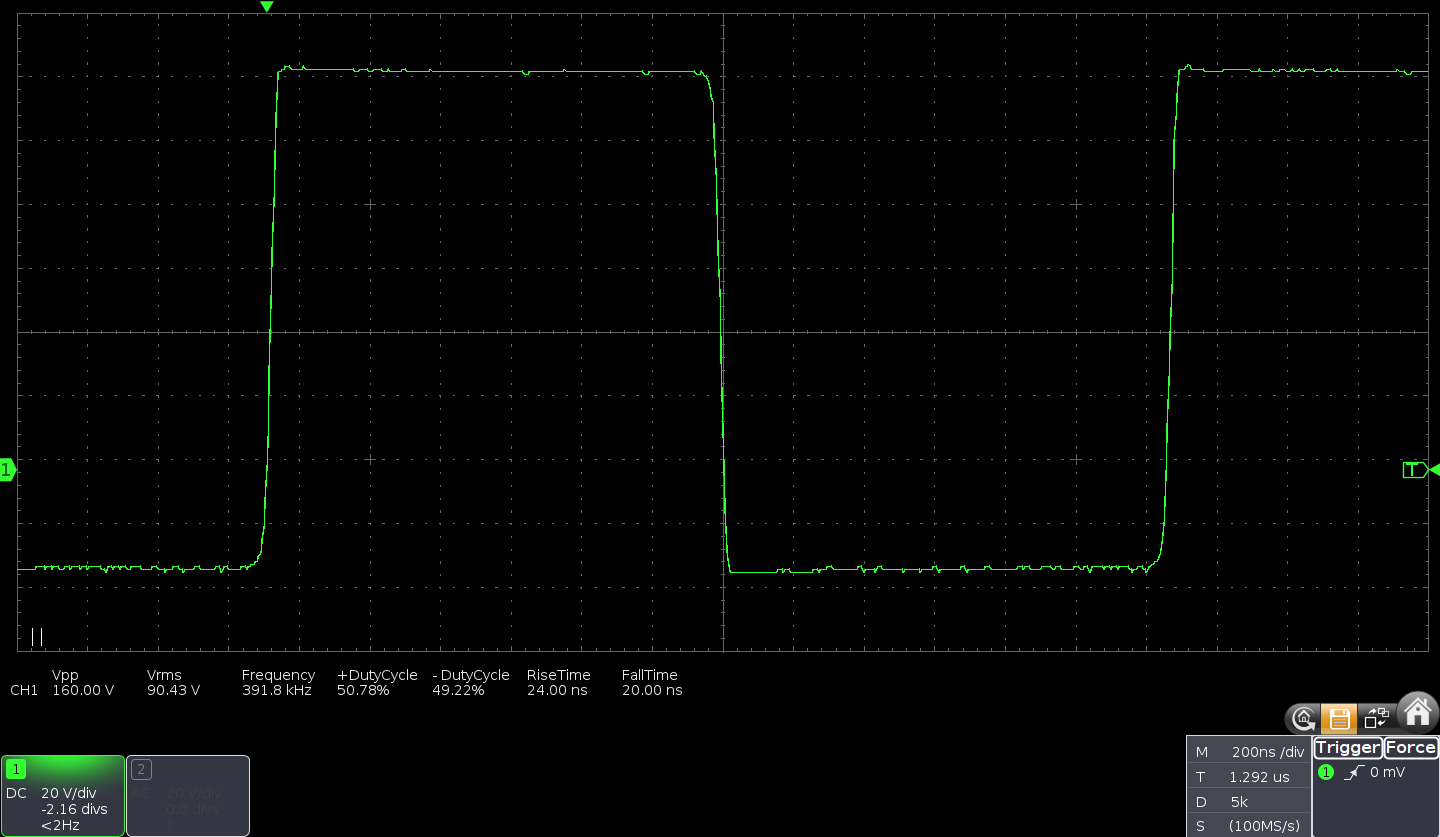

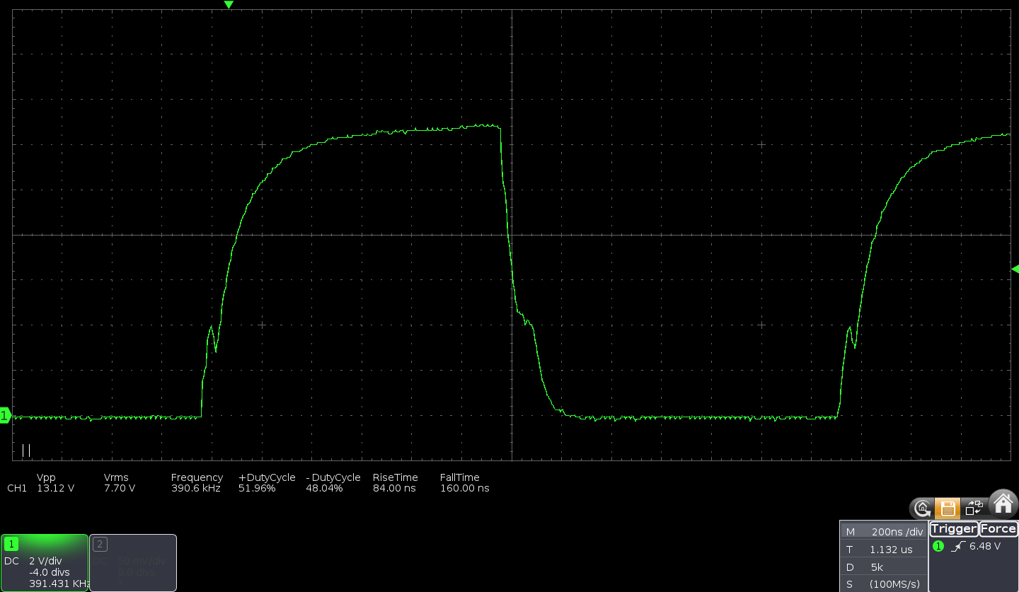

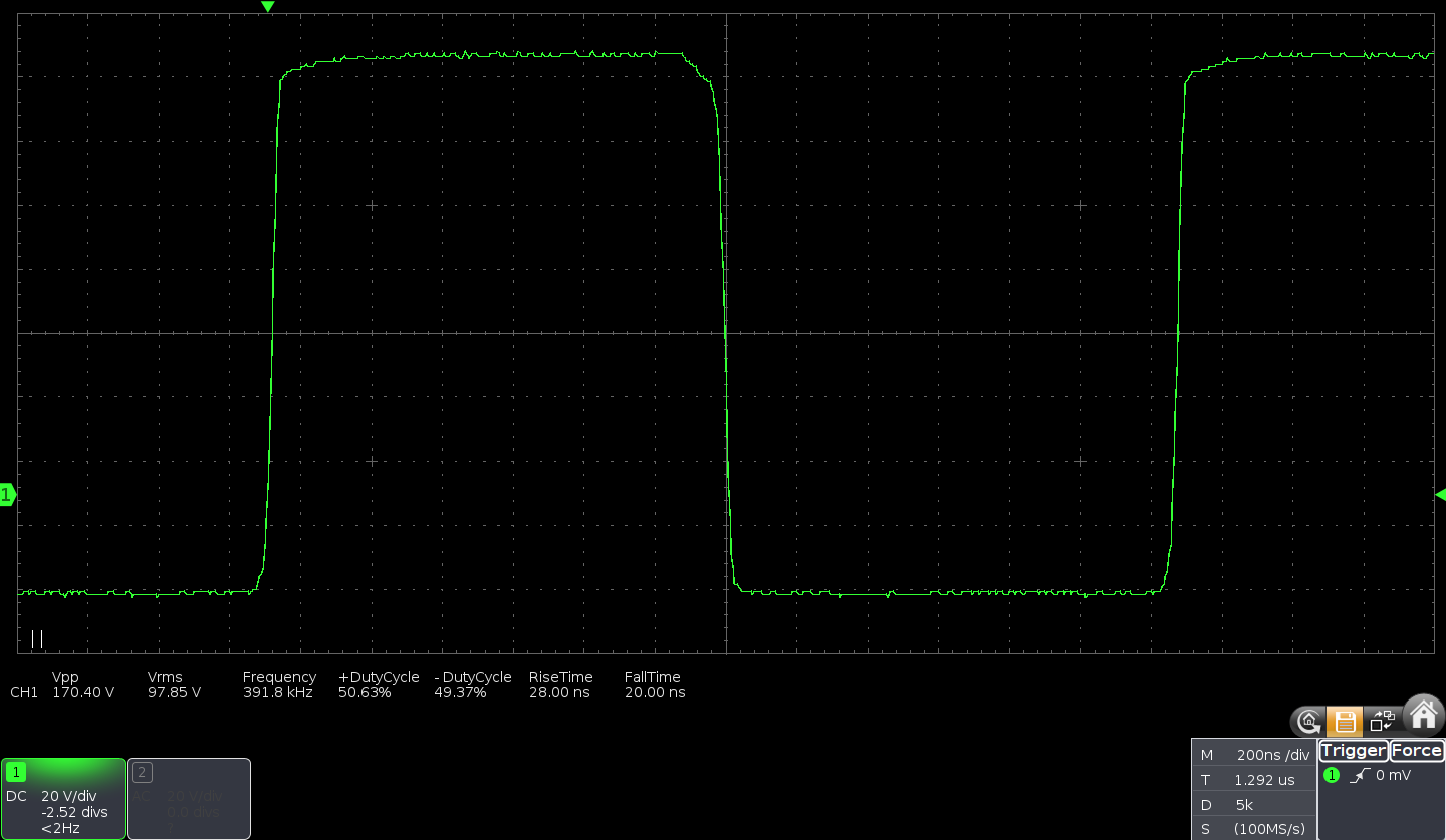

Here are the pics:
1) HO on the side with fets fitted:
2) HO on the jumpered side without fets:
3) LO on the side with fets fitted:
4) LO on the jumpered side without fets:
Scope set to AC coupling to get a decent size waveform ... (10x compensated probe).
Amp idling, no load, gain knobs at minimum.
What do make of that?

I think your blown side IRS2092 was not damaged, only the MOSFETs were. Note that I'm assuming the high-side to be w.r.t VS and the low-side to be w.r.t -80V.
The gate charging seems to be really slow even with 6.8 ohms , looks like those MOSFETs need an emitter follower buffer stage after the IC. I'm quite sure the IR2110 (SMPS) HO/LO waveforms look much better than these.
Also, how many MHz is that scope ? There's absolutely no ringing to be seen !!!

My take is:Fets read 35c and feel like that to touch ... IC reads the same as above (60-65c) and I can just hold my finger on for about 30seconds so it is hot. Centre of the IC on the side without fets at the moment reads 45c and feels like it.
MOSFETs and IC (w/o MOSFETs) = OK.
IC driving MOSFETs = hotter than usual.
There are mainly two reasons for heating of the ICs:
1) The current (source/sink) possibly exceeds the rating (as we've already seen).
2) The drive voltage used is 15V, when 12V should suffice in most applications. The switching losses are proportional to the square of this voltage, due to which the losses at 15V would be at 156% of those at 12V. (15*15 / 12*12 = 1.56.)
However, since the original design was for 15V, it may be better to leave it like that and add an emitter follower buffer instead, to solve both 1) and 2) rather neatly. But, since you had the amplifier working without all that, you could just leave it right there and see how things change in the long run, after which, any further failures would be clear indicators of the necessity for the EF buffer.
10 ohms is not a bad value at all, but there's an extra internal resistance within the MOSFET itself (often labelled Rg int.) which, for your MOSFET, has not been given by the manufacturer. This value could be upto 2-3 ohms and therefore, it maybe best to leave it at 6.8 ohms, especially because the amplifier was completely functional at that value.It could of course be because there was 10ohm gate resistors installed instead of 6.8ohm but from what I have read and from what you've said 10ohm is not an unusual value to use but I have no previous experience of Class D so that's why I am here asking advice.

Yes WRT the correct locations .. and yes agree only mosfets were damaged ... I've noticed now that one of the channel panel leds flashes if there is a fault with the mosfets. I've noticed twice now that if these lights flash at any time then even if the fets have tested correctly with DMM & transistor tester that a fault will occur when at proper running voltages. Might be some kind of undocumented fault indication.I think your blown side IRS2092 was not damaged, only the MOSFETs were. Note that I'm assuming the high-side to be w.r.t VS and the low-side to be w.r.t -80V.
Yes they do .... but that is a better scope too though.The gate charging seems to be really slow even with 6.8 ohms , looks like those MOSFETs need an emitter follower buffer stage after the IC. I'm quite sure the IR2110 (SMPS) HO/LO waveforms look much better than these.
Ummm it's not great, it's an old Velleman HPS140 .... 10Mhz, it's best used for just seeing if a wave is present, but the PK-PK voltage reading of the square wave is quite accurate (tested on my sig gen).Also, how many MHz is that scope ? There's absolutely no ringing to be seen !!!

Here's a higher res measurement of the LO from the channel with fets fitted ... I can't think on a way to measure HO with what I've got here ... 🙁
Nearly forgot here is the measurment from the LO without fets fitted for comparison:
Do you think it's having the fets fitted that is making the difference?
Of course, these MOSFETs have massive gate capacitance(s) when compared to those of several other devices, and that's what's heating up the ICs.

HO on side with fets fitted:
HO on side without fets:
The HO on the side with fets looks much better than LO when measured WRT -80V?
Oh ! that's probably dead-time. It's the rise/fall times and shape of the waveform at VS (w.r.t SPKR GND) that matters, as that's the final PWM output of the half-bridge.
That's very beautiful with fast rise/fall times, no problems seen. 👍
So your wave-forms indicate the need for faster gate charging which was why the 10ohm value didn't work. You actually needed to reduce (not increase) the gate resistor. And since that can't be done without the emitter follower buffer, I think this is where you stop.
