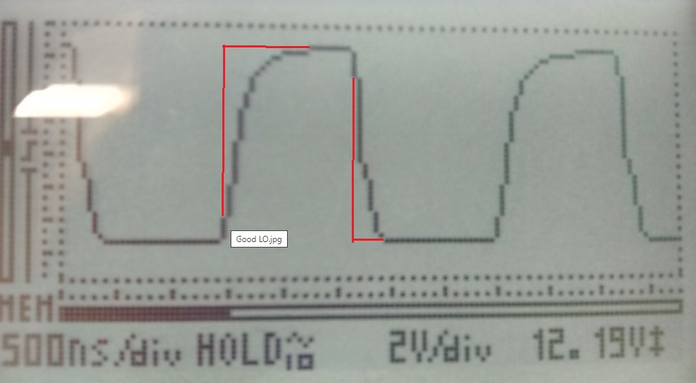

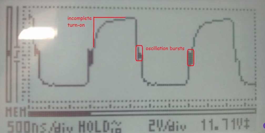

Those Gate driver waveforms (on the MOSFET fitted channel) do not inspire confidence in the unit's reliability.

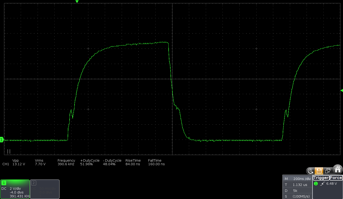

Assuming these aren't 'scope artifacts, these oscillograms from post 84 show the reliability concerns.
This is LO ... I don't have the diff probes to be able to measure HO w.r.t. VS on the better scope.
