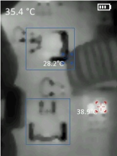

Been busy with other stuff the last few days ... the fets that replaced the IGBT's are running pretty cool here is thermal image after 40mins (8 ohm load, both volumes full clockwise, audio signal hitting the limiters). I think I already posted this but here it is again ... replacement fets outlined in blue (the tab of the top fet is the coldest area on screen @ 28.2c):

The temps look great at 8 ohm loads. But by my experience, if an amp is rated into 2 ohm loads, sooner or later it's gonna see them!
Now that it's working, seems like some testing at heavier loads might be worthwhile.

That is what the original owner killed it with 1st time around (partially shorted voice coil impedance <2ohm).The temps look great at 8 ohm loads. But by my experience, if an amp is rated into 2 ohm loads, sooner or later it's gonna see them!
I don't have two heavier loads but I could combine the 8's for a 4ohm load for 1x side.Now that it's working, seems like some testing at heavier loads might be worthwhile.

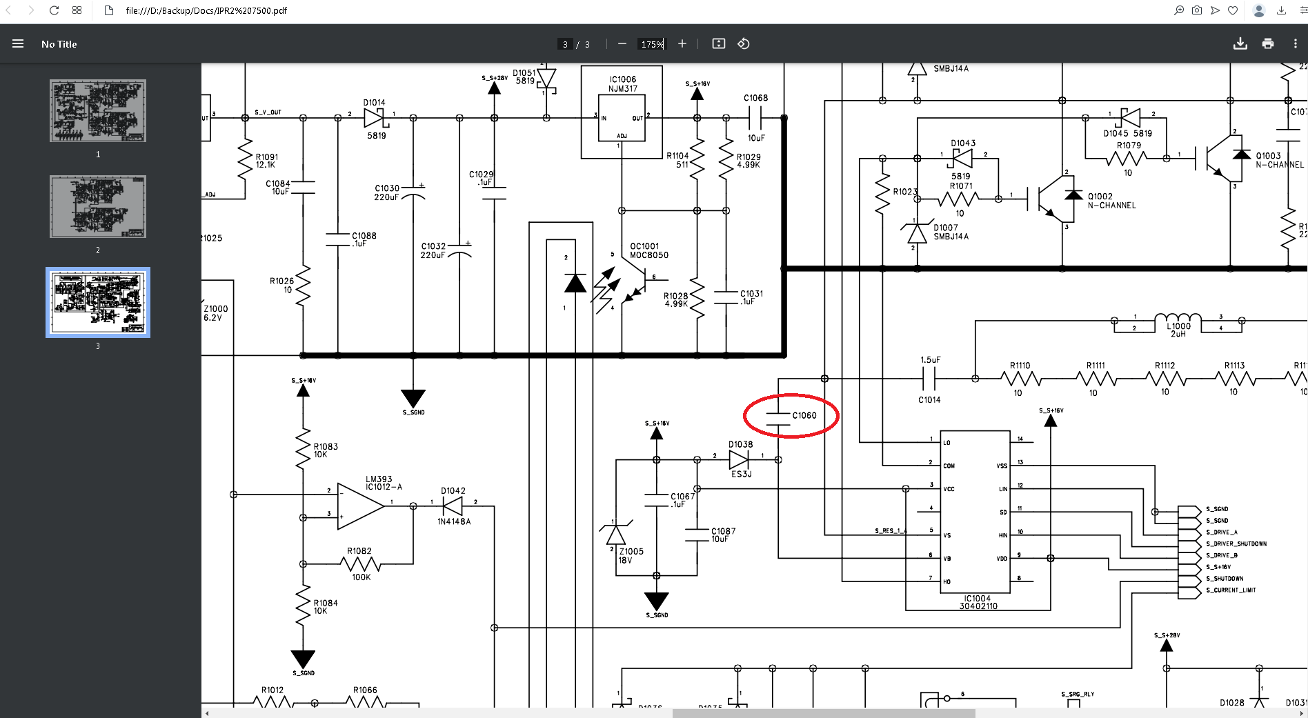

Hi guys, hope u all are doing great. I recently sent my peavey IPR2 7500 for IR2110 chip replacement and the guy lost a silver capacitor (C1060 in schematics) near the chip, in the case of IPR 1600 it shows as C66 in schematics, i was wondering if any of you knows the value or where to get a replacement 🙁
I was also wondering if fets IRFB4227pbf can be used in IPR2 7500, both models share many similar components.
I really appreciate ur inputs.
Thanks in advance for your valuable help!
Regards!
