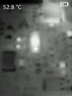

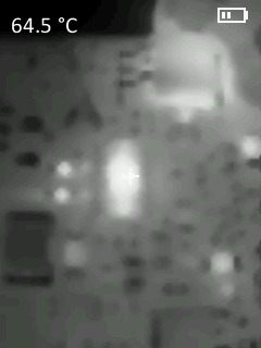

I have reset my camera and checked the emissivity ... I have set it to 0.95 as that is what I have seen recommended for IC cases.
I have the last two good fets installed on the "good" side, all 6.8ohm resistors re-installed (no VS jumper yet) and the amp is idling.
Here are shots with only the crosshair temperature showing the centre of the "good" IC, the cooler part of the IC and the pcb beside the IC:
Contact thermometer says 37.5c ... but the IC is directly in front of the fan and the long probe is being cooled by the air from the fan.
The IC is HOT to touch ... I can just keep my finger on it.
