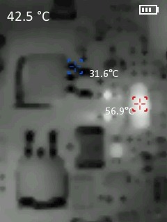

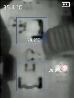

Eventually got back to finishing this, the amp seems to run pretty cool ... here's a couple of thermal images showing the power supply mosfets and the output mosfets (I ended up having to hand form the D2PAK shapes from TO-220's as that was all I could get) but judging by the results it looks as though they worked out) ... these images are after about 40mins of constant bass heavy music (amp controls fully clockwise and peaks hitting the limiters):
Power Supply (these are the fets you helped me choose instead of IGBT's)
The highest temp on the screen is 38.9c & the tab of the top mosfet is only 28.2c (these temps are pretty accurate too as I've tested the thermal imager) 🙂
Amplifier (Channel B), Channel A is actually slightly cooler as it is nearer the fan.
The hottest component is the IRS2092 on the right at 56.9c & the fets (IRFB4227) are much cooler, in fact one leg of the top fet is only 31.6c (the coolest point on the screen).

Eventually .... the amp seems to run pretty cool ... after about 40mins of constant bass heavy music...

Any amplifier that's supposed to provide 2x800W clearly needs to draw over 5A from a 240V supply and therefore it's best to be prepared for worst-case power, especially in a professional application. That change was so necessary.
By the way, what was the approximate ambient temperature at that time ? Nothing to worry, just a casual question.The highest temp on the screen is 38.9c & the tab of the top mosfet is only 28.2c.........The hottest component is the IRS2092 on the right at 56.9c & the fets (IRFB4227) are much cooler, in fact one leg of the top fet is only 31.6c (the coolest point on the screen).
IRS2092 is hot because of the low value of the gate resistors (6.8 ohms). Note that this driver is rated only for 1A, and the peak current is currently 15V / 6.8 = 2.2A. A slightly higher value (say 10-15 ohms) would reduce the die temperatures to normal levels.
However, the IR2110 in the SMPS section is rated for 2A, and would therefore do better I think. If not, adjust the gate resistors to about 7.5 to 10 ohms to keep within the recommended limits of operation.

Yeah I know what your getting at ... I'm in Scotland here so the temperature will have been between about 17-21c ... it's been warmer the last few days so probably nearer 20 or 21c. I never thought, I should have noted that at the time. I'll make sure and do that from now on. The thermal image temps are very accurate though compared against all the other various contact thermometers I have here.By the way, what was the approximate ambient temperature at that time ? Nothing to worry, just a casual question.
Gate resistor adjustment is what I've been trying to read up on the last couple of days, your confirmation of what I've been reading is well appreciated.IRS2092 is hot because of the low value of the gate resistors (6.8 ohms). Note that this driver is rated only for 1A, and the peak current is currently 15V / 6.8 = 2.2A. A slightly higher value (say 10-15 ohms) would reduce the die temperatures to normal levels.
Ok got you, I will adjust the gate resistors, I have very few SMD resistors here, is there any reason why I shouldn't use through hole resistors for testing?(I've got the required values in TH).

21*C is nice, especially since datasheets are written for 25*C. You may use 0.25W TH / SMD resistors for gate drive. If SMD, try to have 1206/1210 or bigger, avoiding 0805 and smaller.I'm in Scotland here so the temperature will have been between about 17-21c ... it's been warmer the last few days so probably nearer 20 or 21c.
