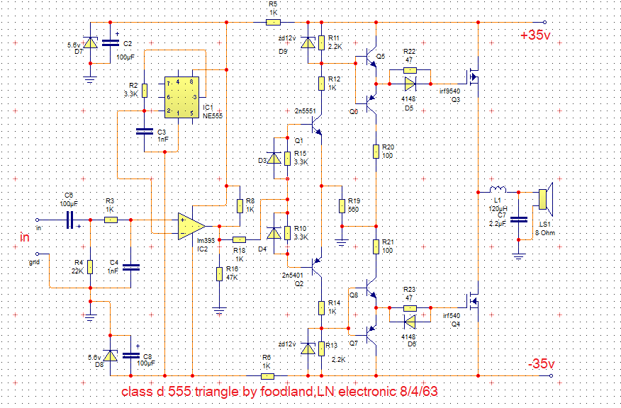

to day i write about 12v class d from low pass filter cor

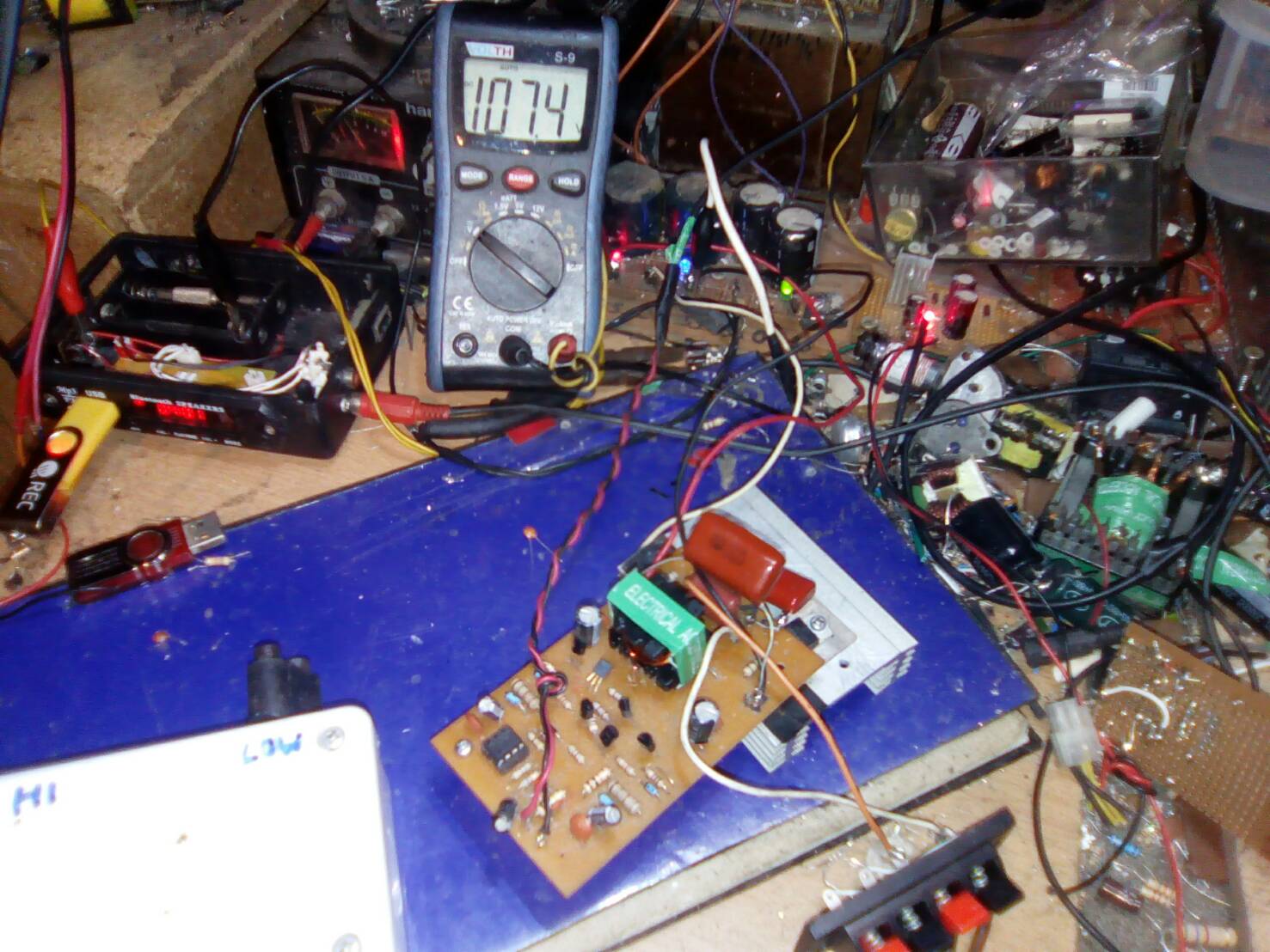

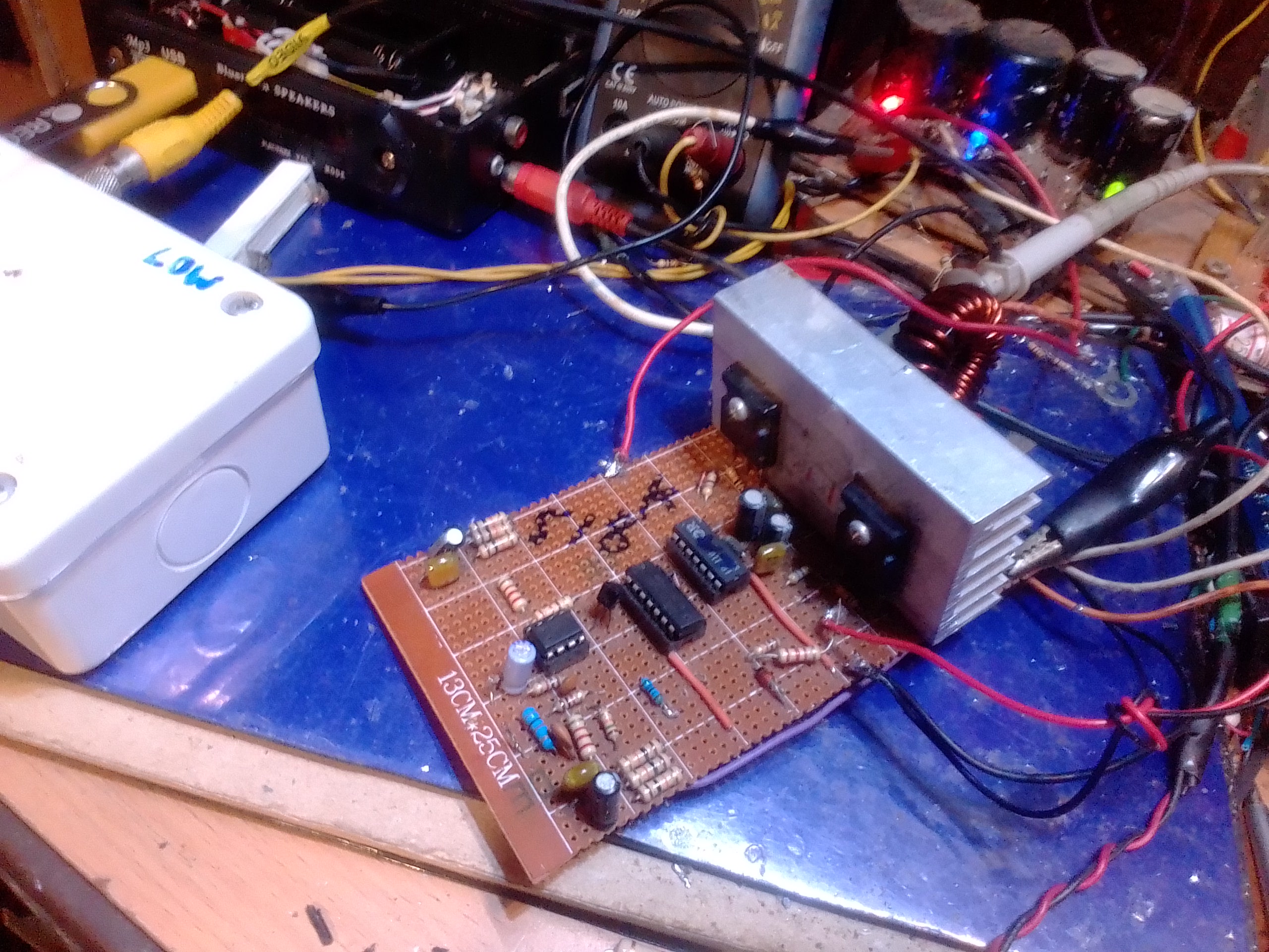

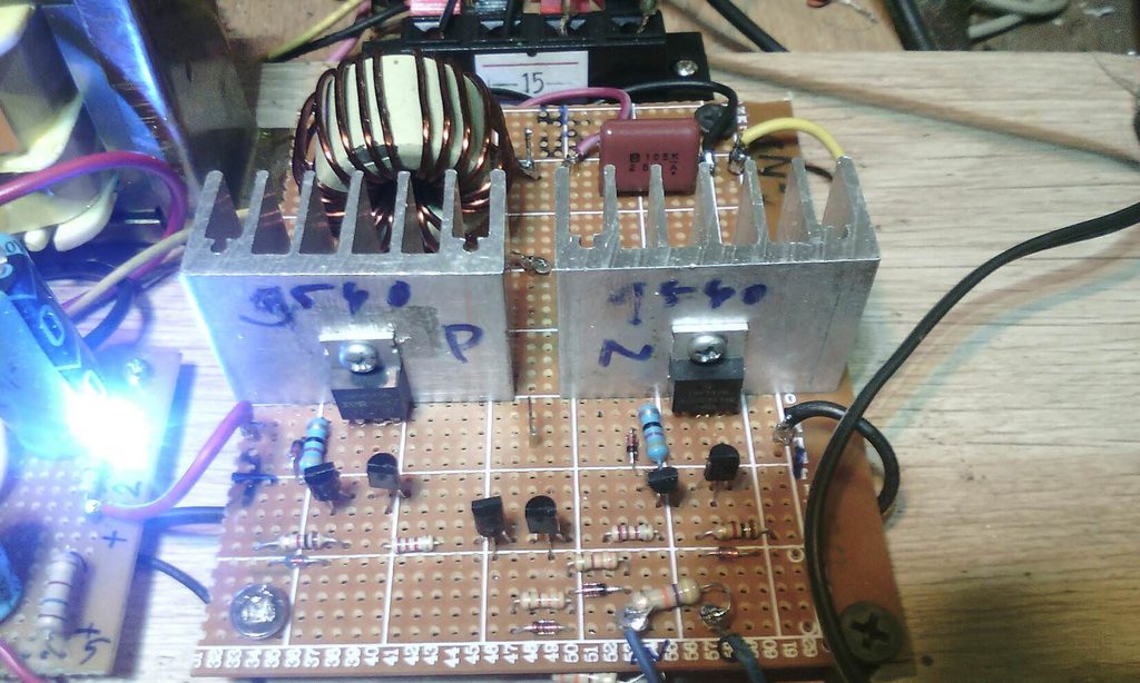

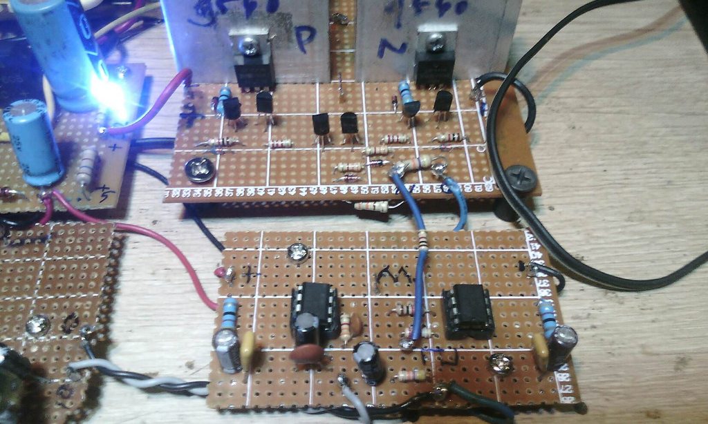

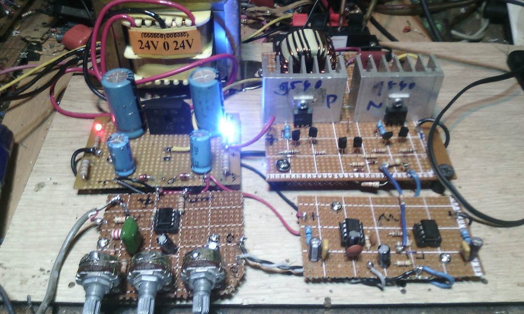

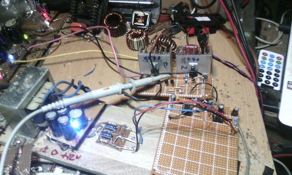

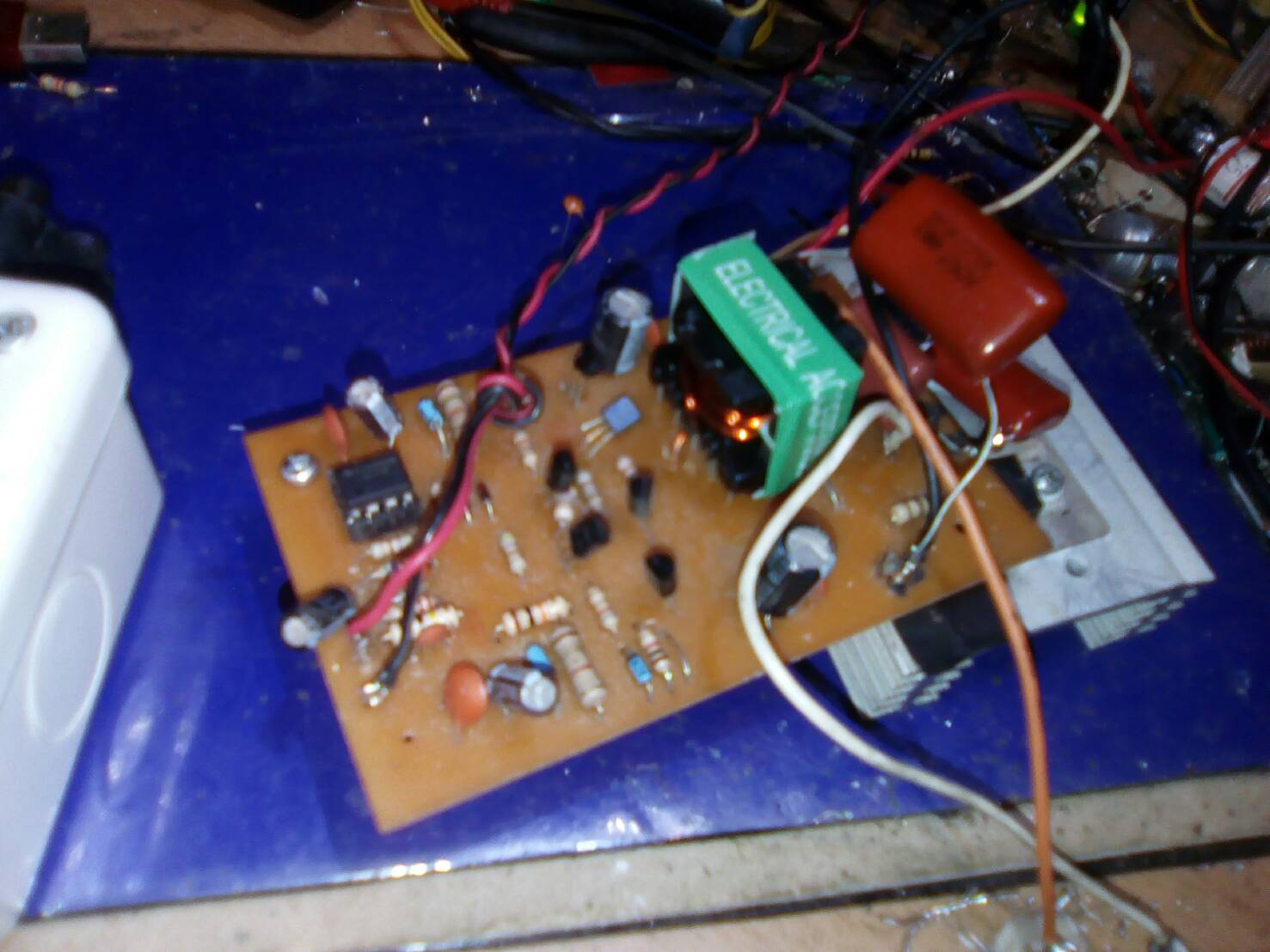

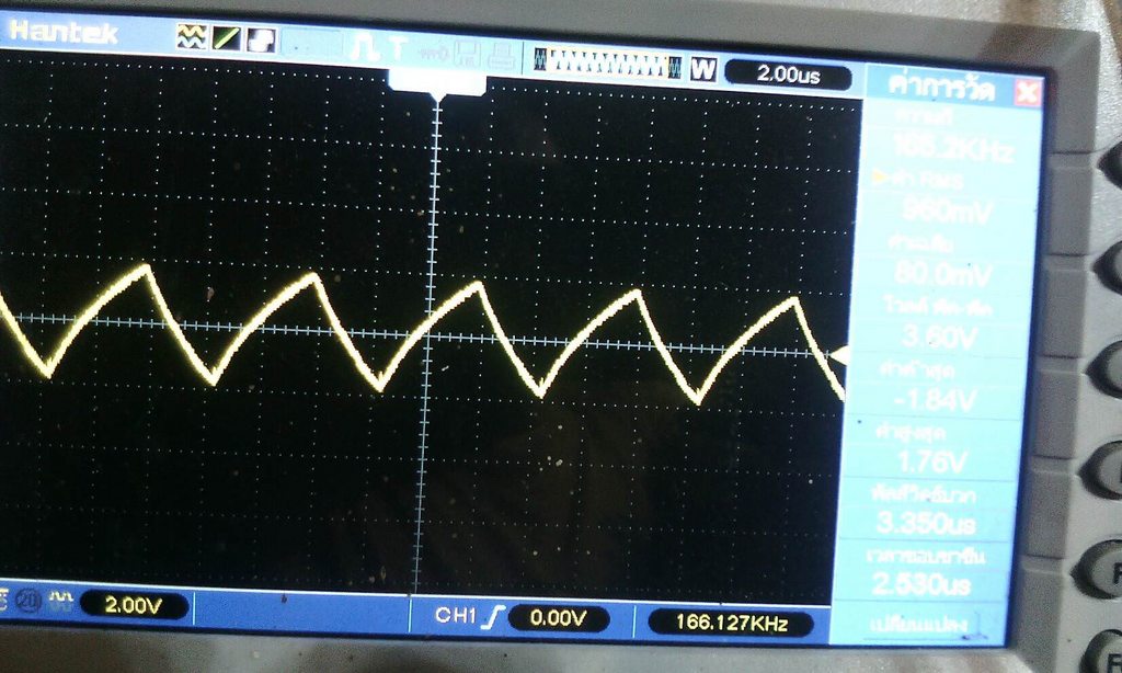

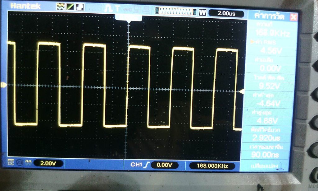

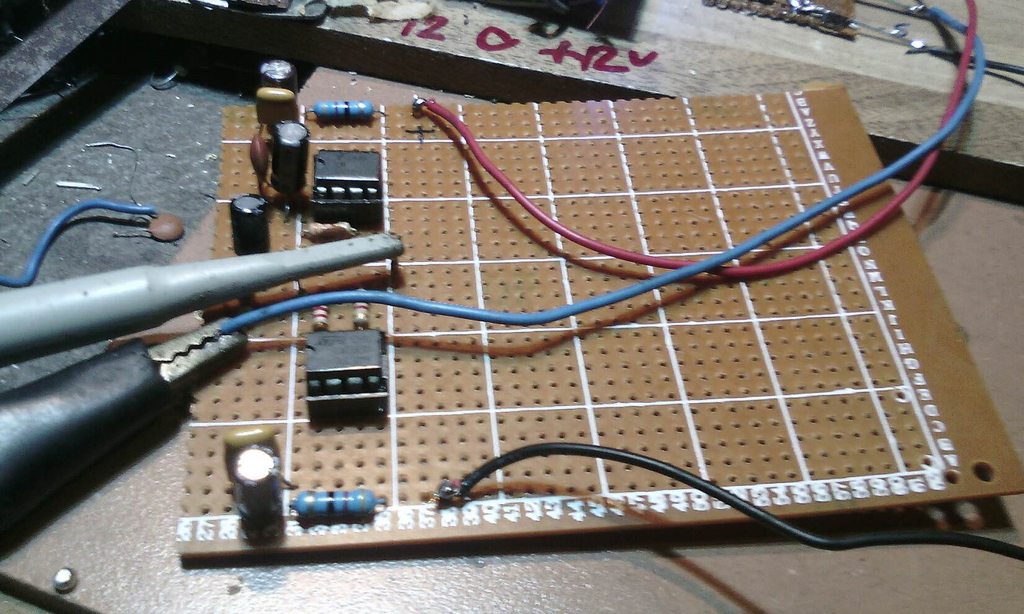

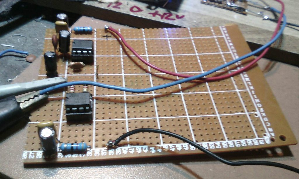

class d for education the circuit use ne555 generate triangle 130khz lm393 mod audio ,triangle to pwm ,sent to class d ampliflier

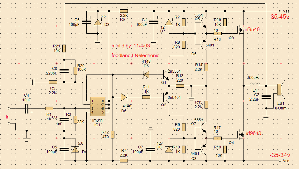

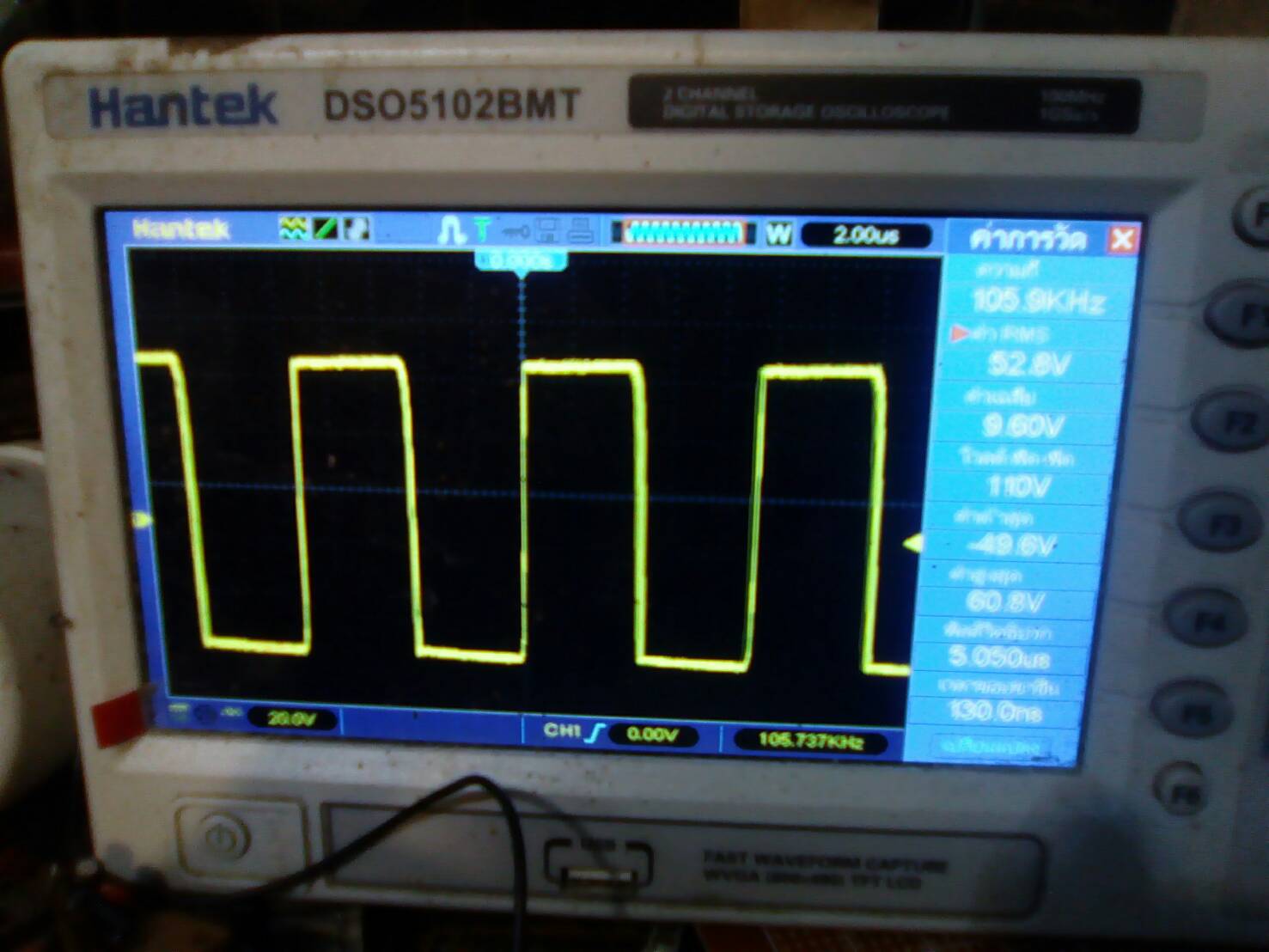

ne555 is not good, too old and one mistake create noise like engine, hows your circuit with 555? and 130khz is too slow for me, at least 200khz for class d, there are many new advance mosfet good for high switching.

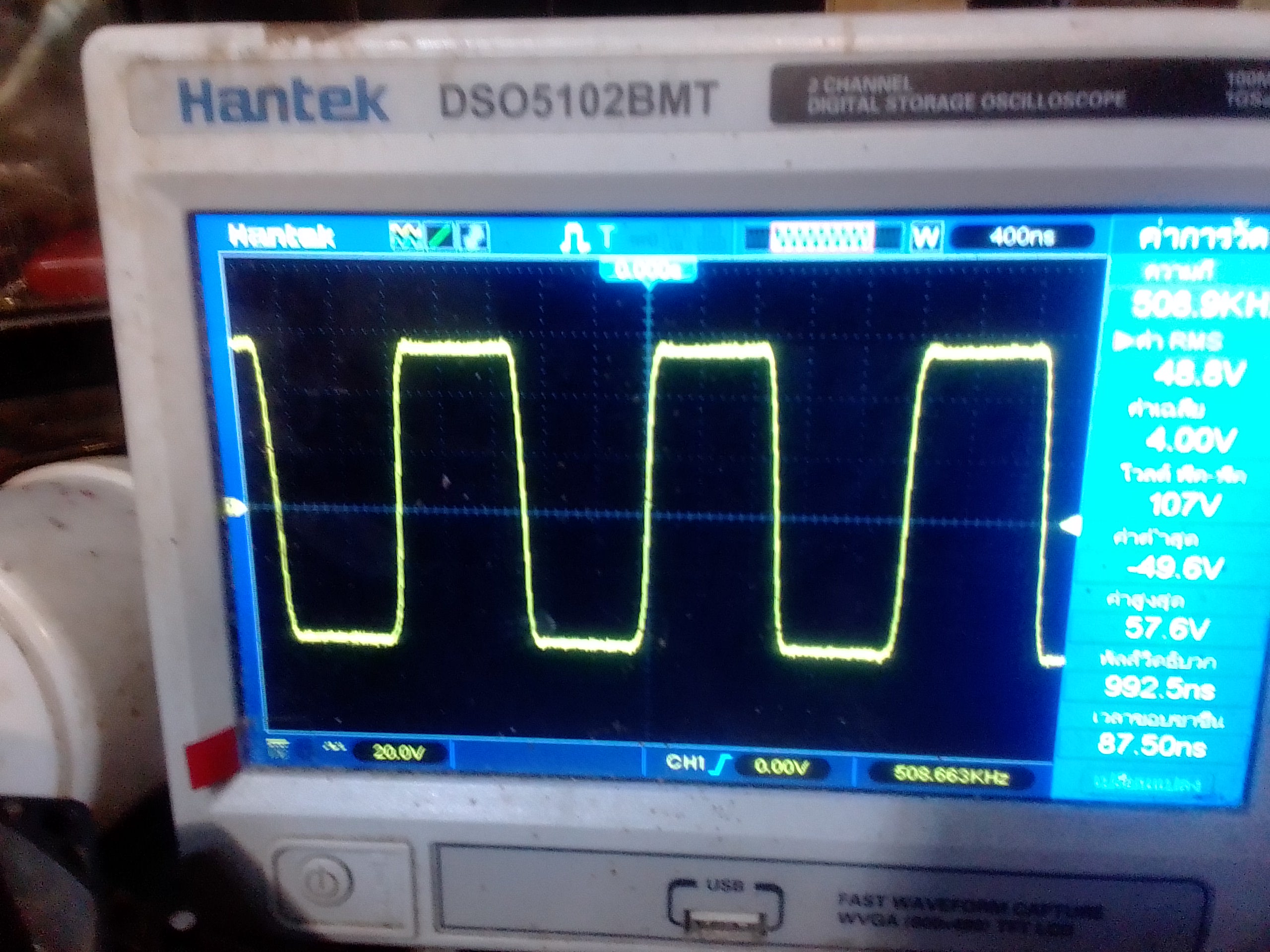

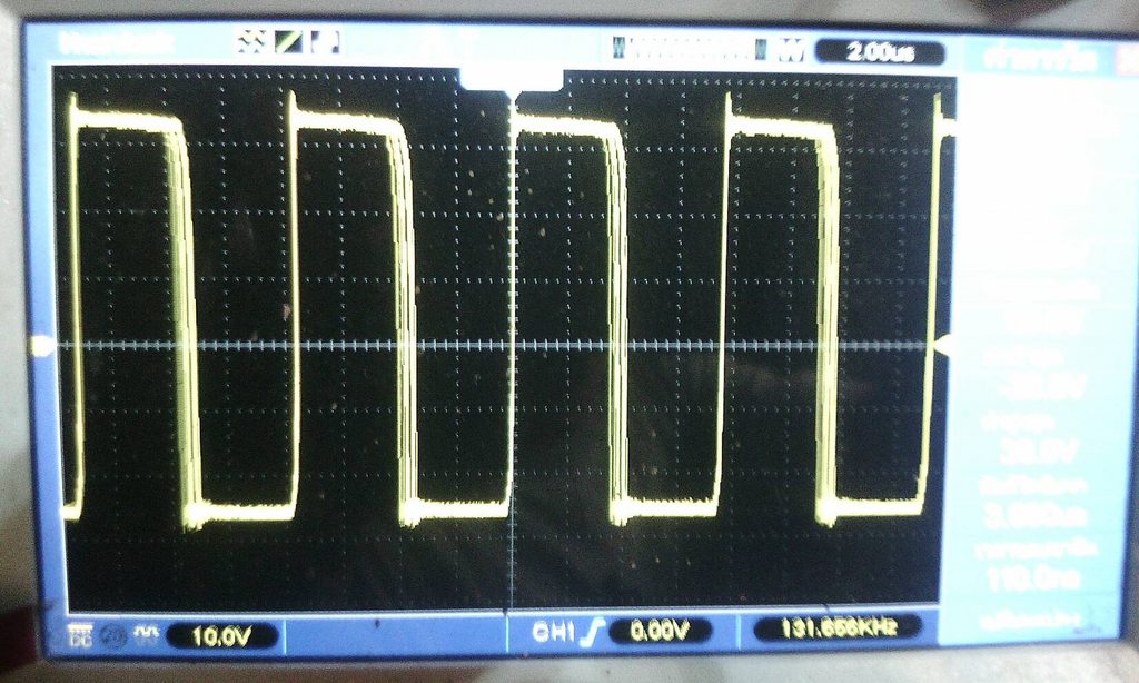

1k res for bias? are u sure, can u make test with 4 ohm load and monitor the voltage after the resistor 1k
add totem pole at each gate mosfet hi and lo with bd139 and bd140, that will reduce ir2110 stress.
there is something problem with your circuit drawing not correct lol, i hope you make exact circuit with your test

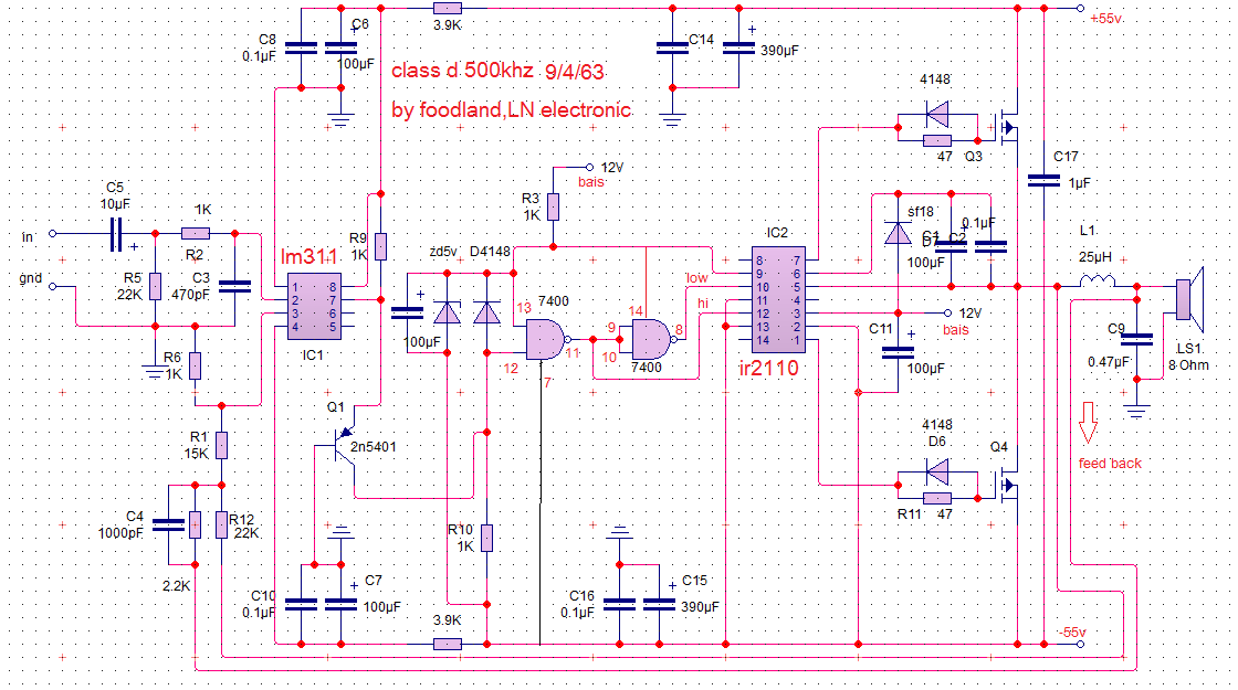

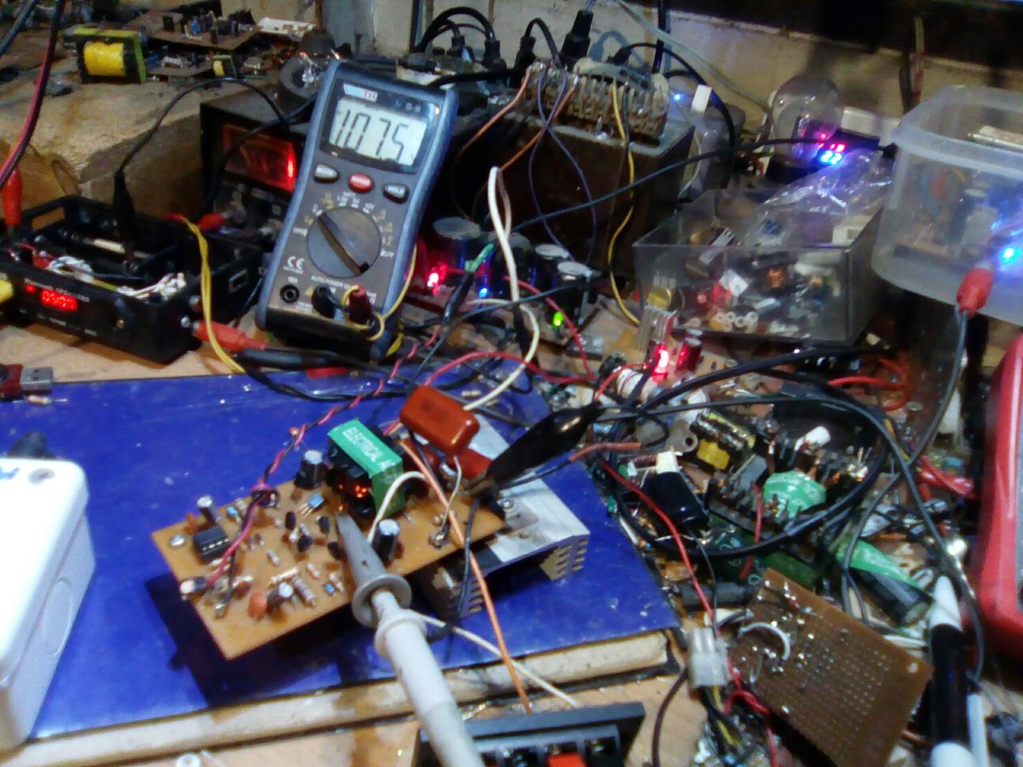

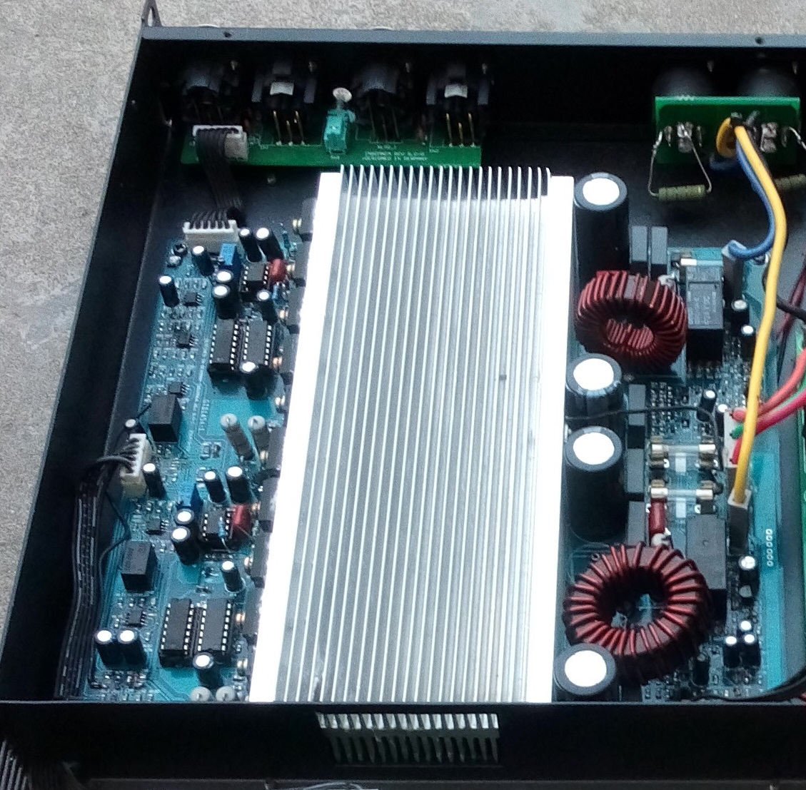

class d 500k by foodland , this circuit have ic lm311,ic nand gate 7400 and ic ir2110 L filter 25uh c105/250v

Hi Surachit
If you want stable working amp, you will need a lot updates
look D4K5 Schematic and you dont waste your time
Gerber PCB file you can have for free
LM311 is not good solution, Tl071 input design is better
IR2110 need Buffer
use IRFP4227 Mosfets
Inductor T157-2 need 38-42 turns

correct circuit i forgot zd5.6v for op amp
