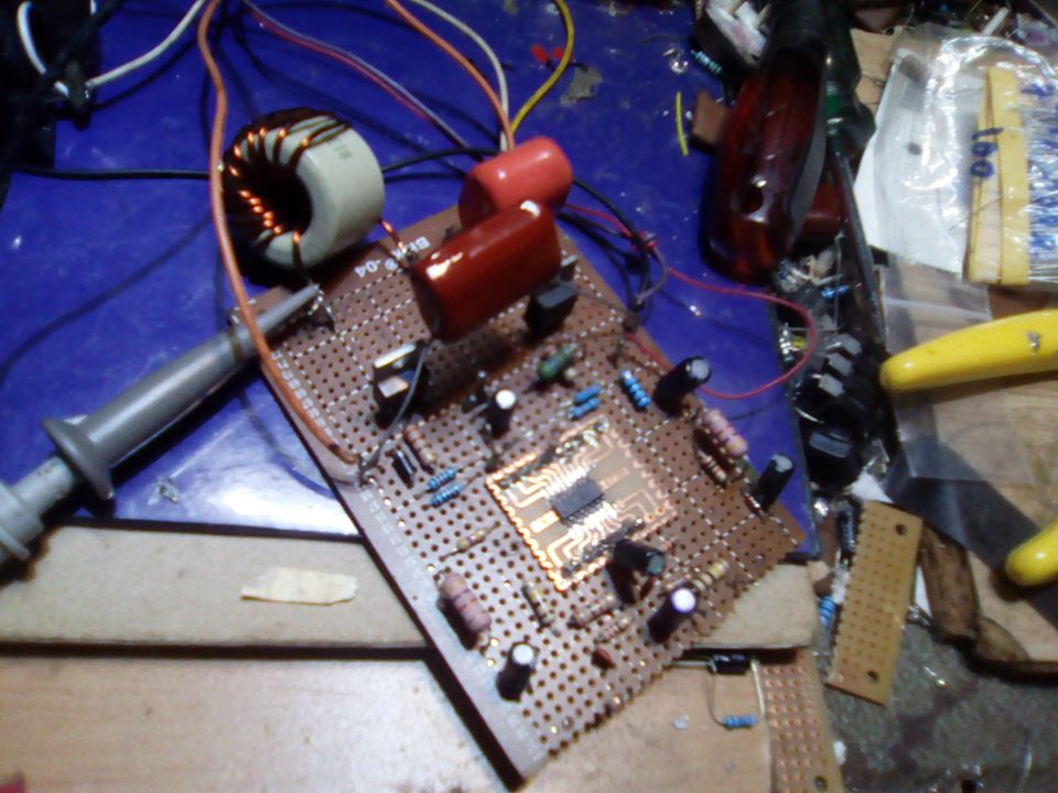

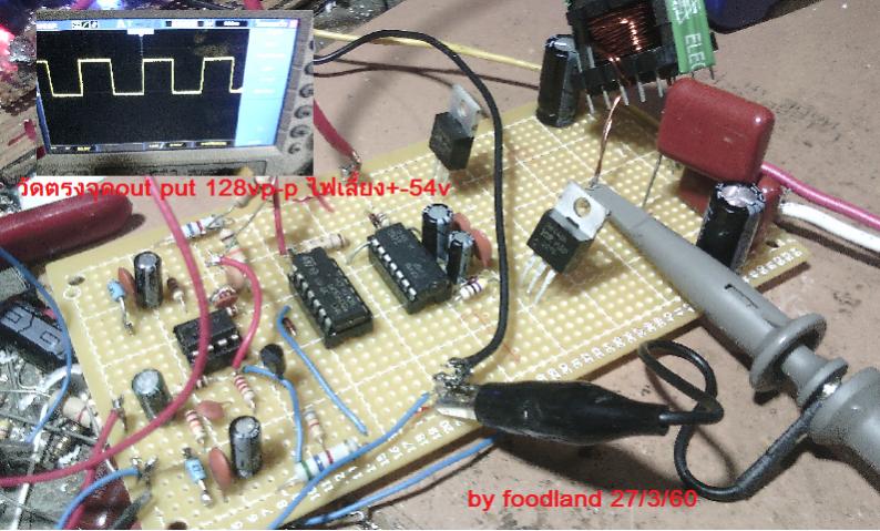

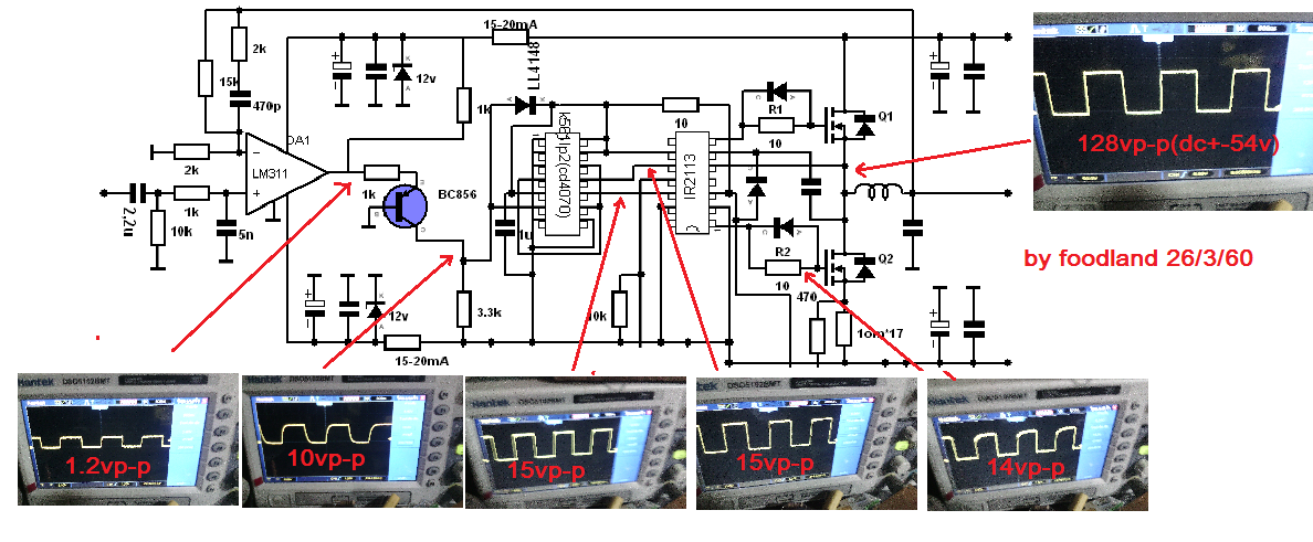

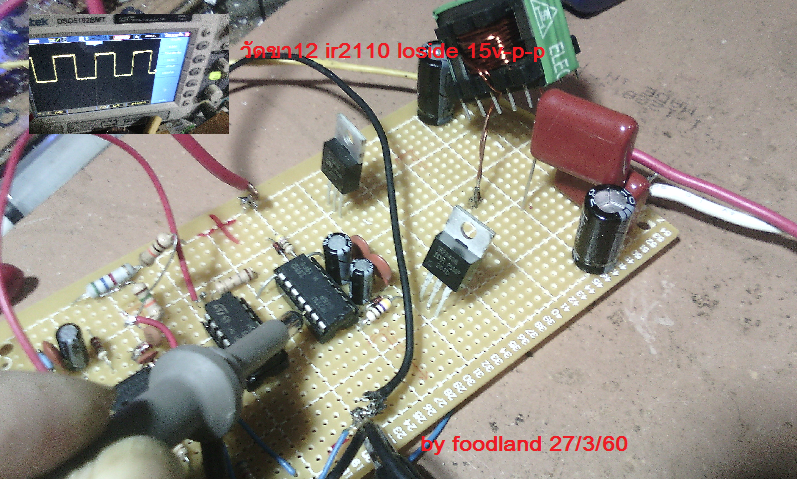

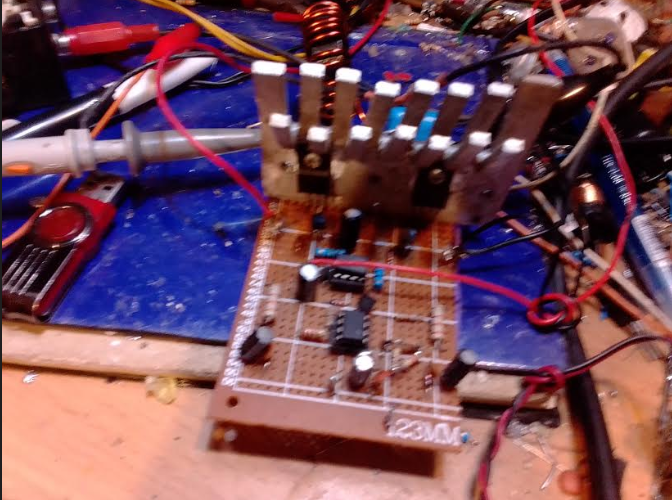

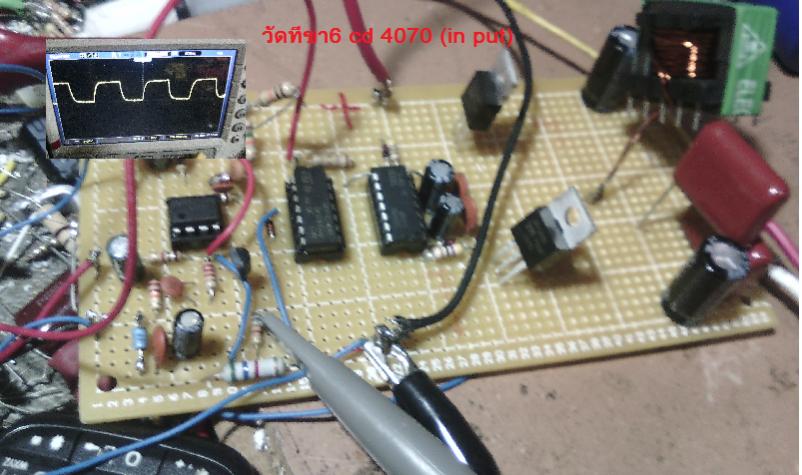

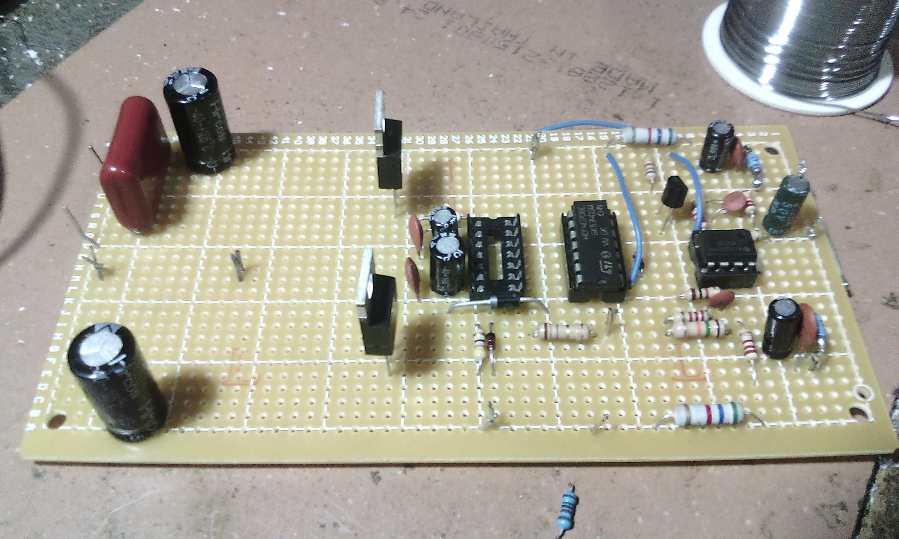

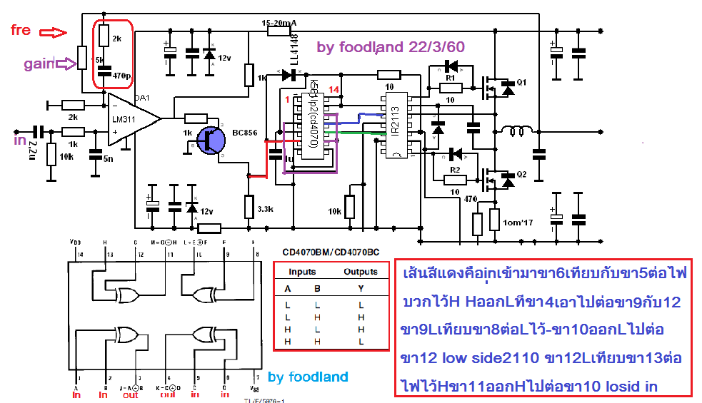

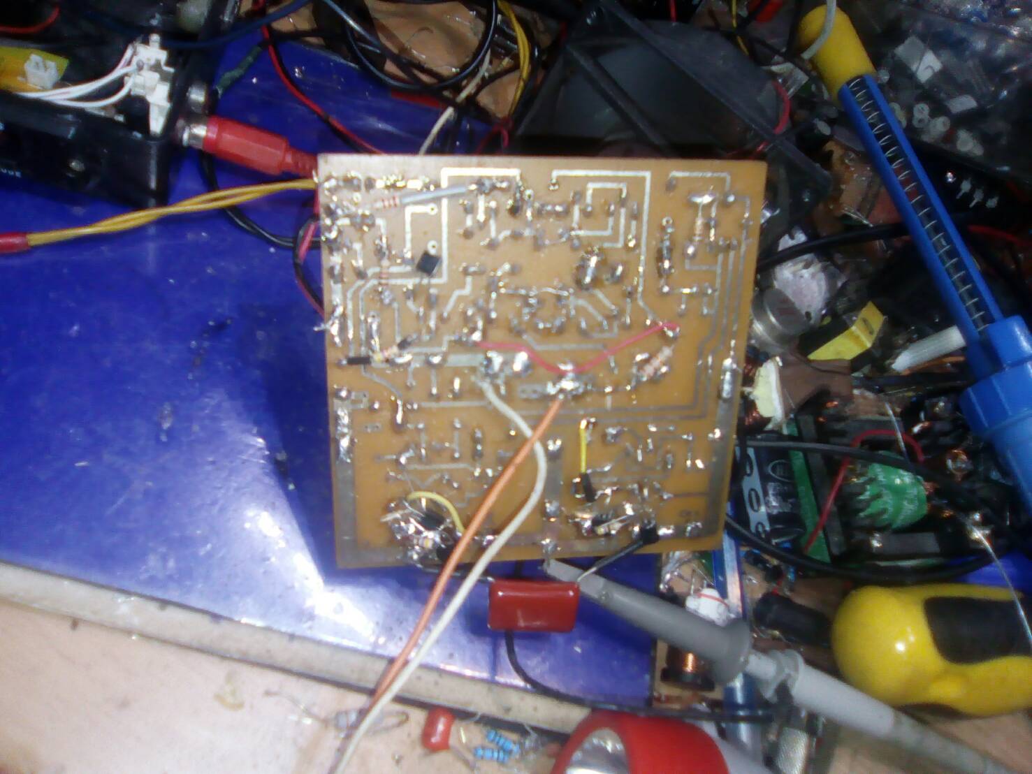

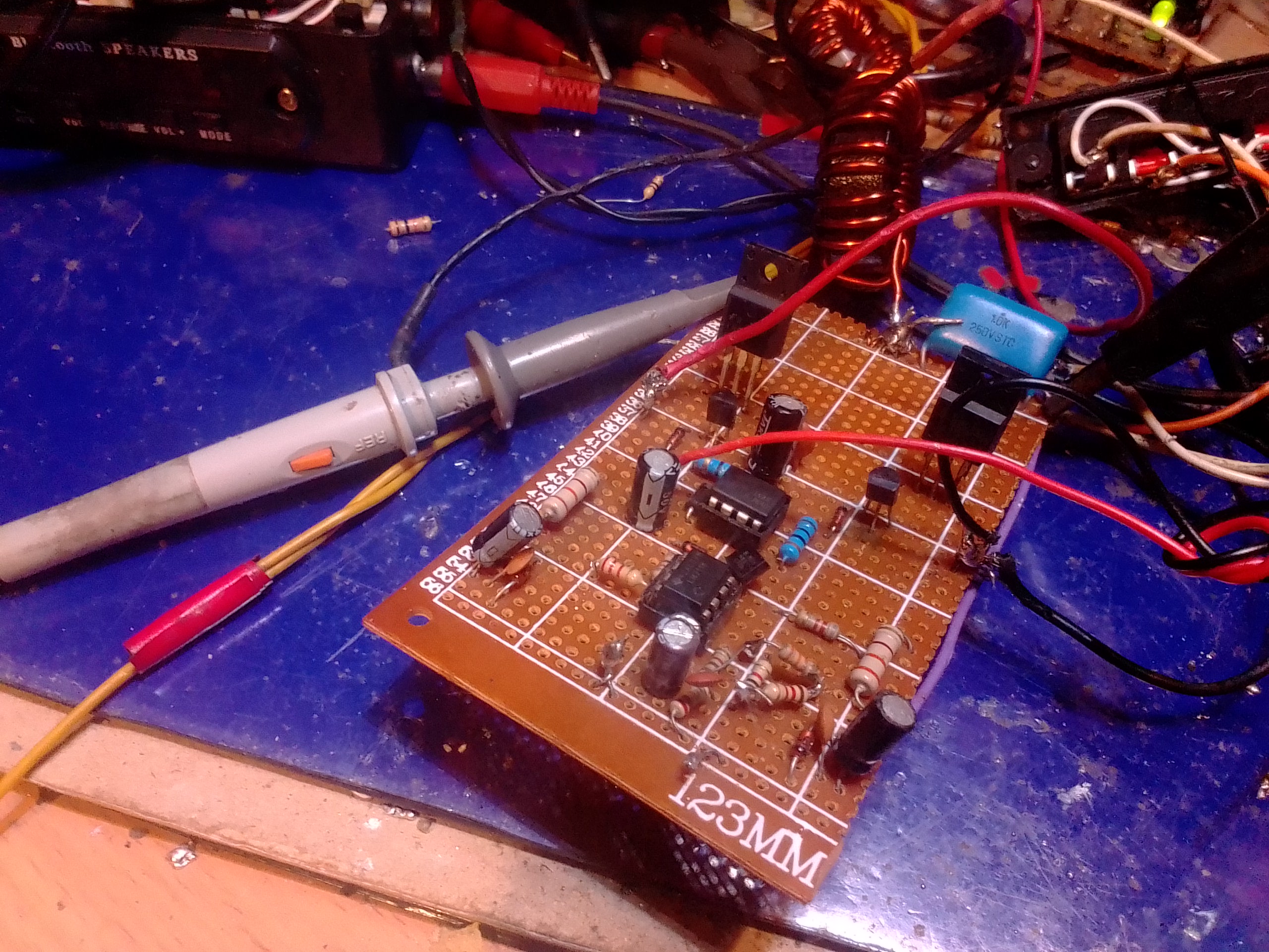

class d Earthquake PH-10000W
class cd4070+ir2110

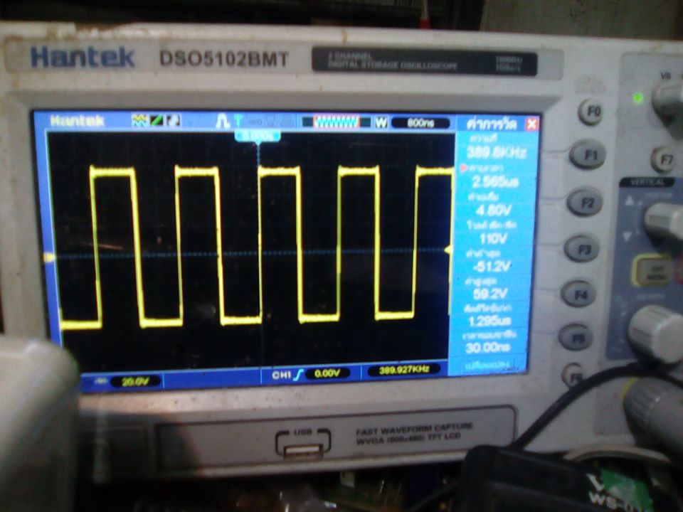

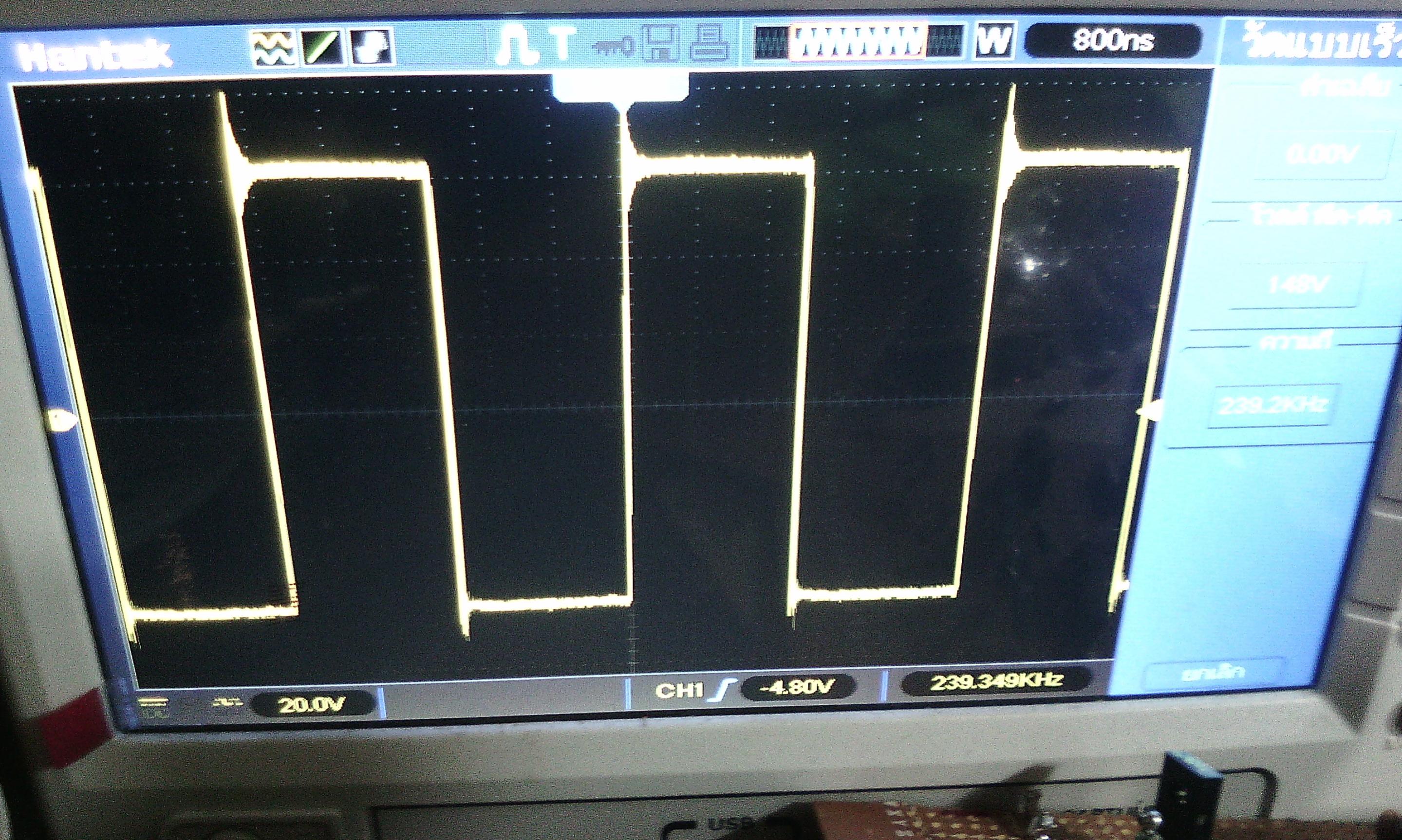

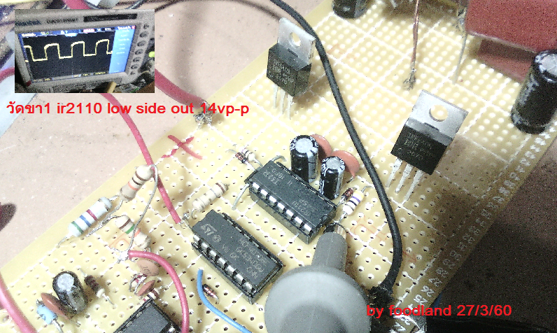

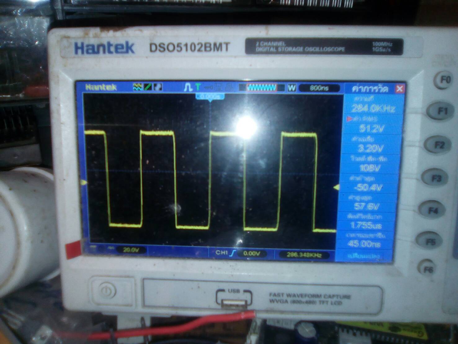

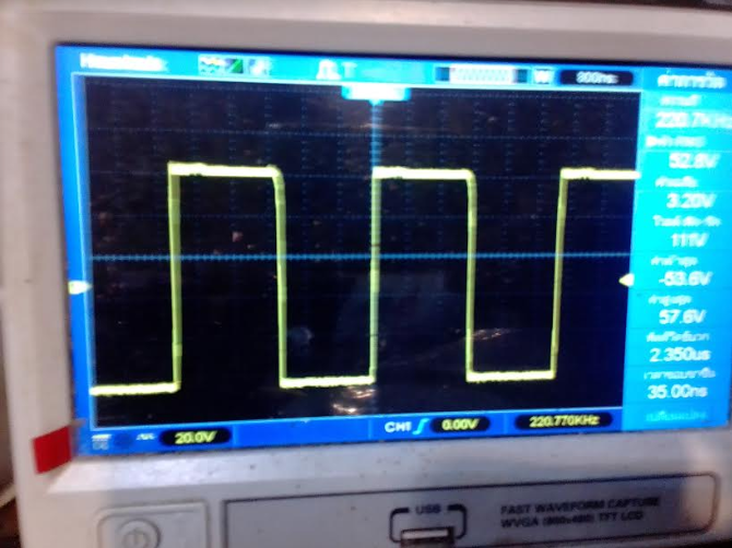

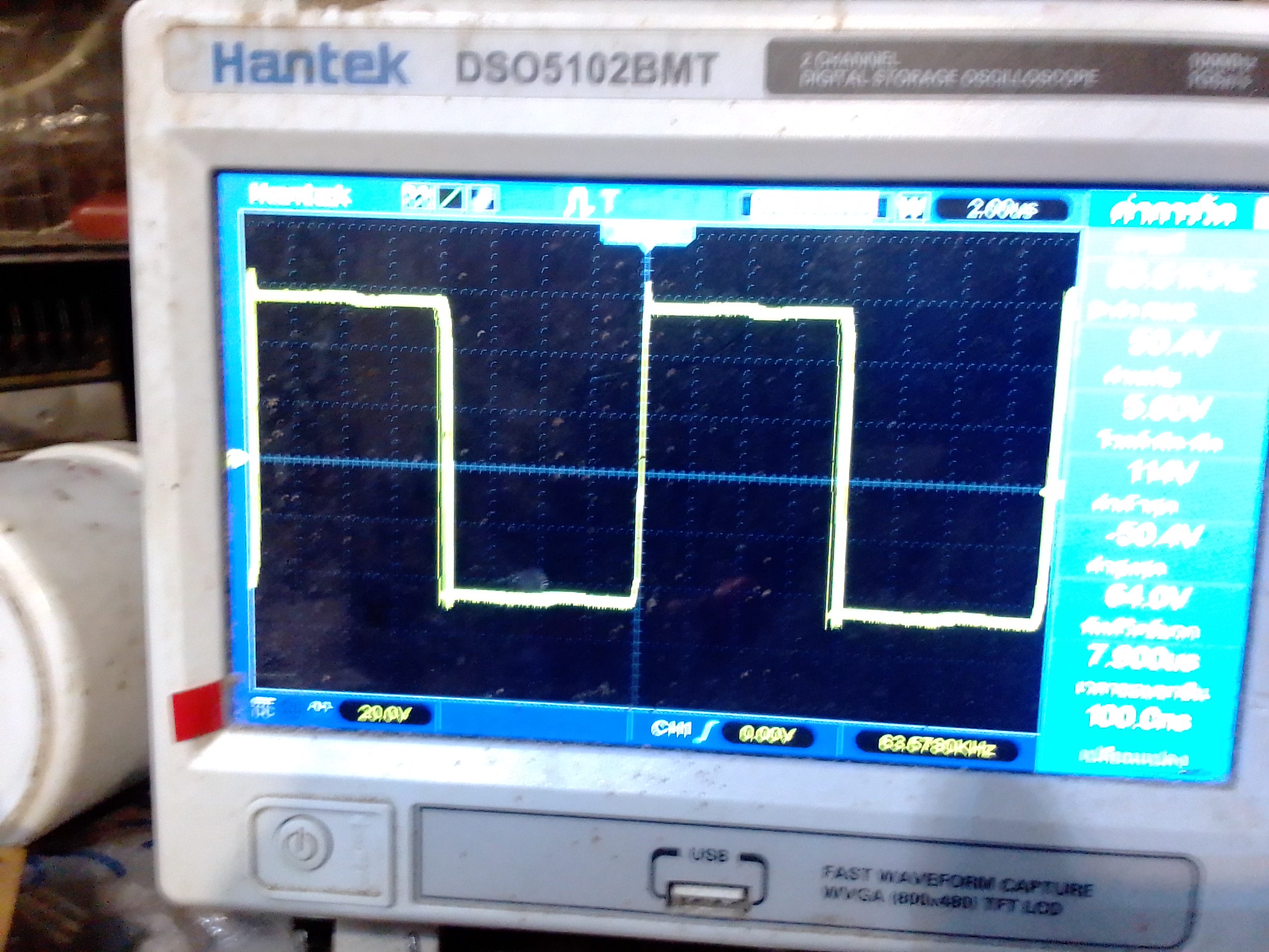

wave form class d cd4070+ir2110
my wave side ln-electronic.com/board/index.php?/topic/109-class-d-cd4070ir2110/

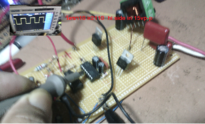

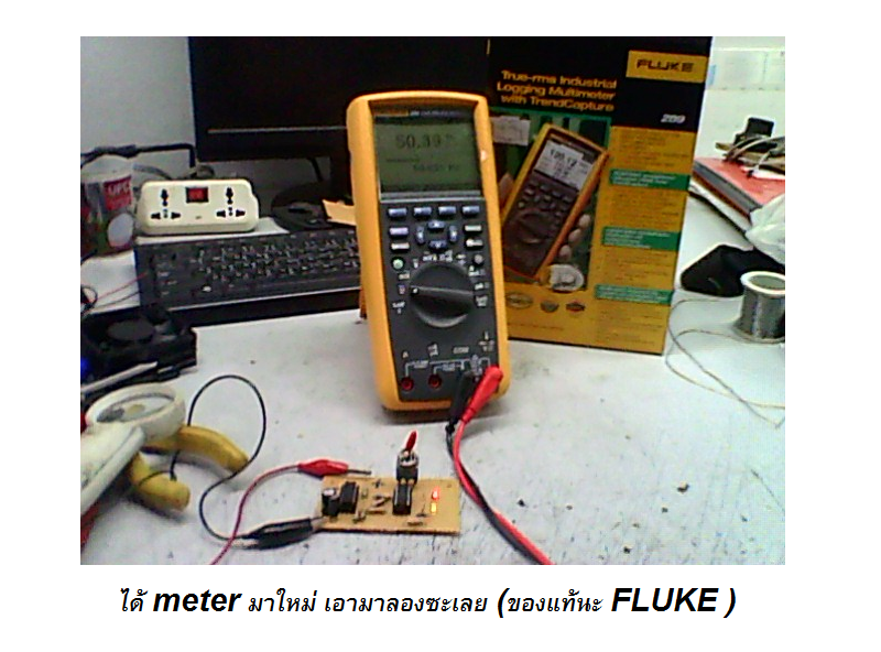

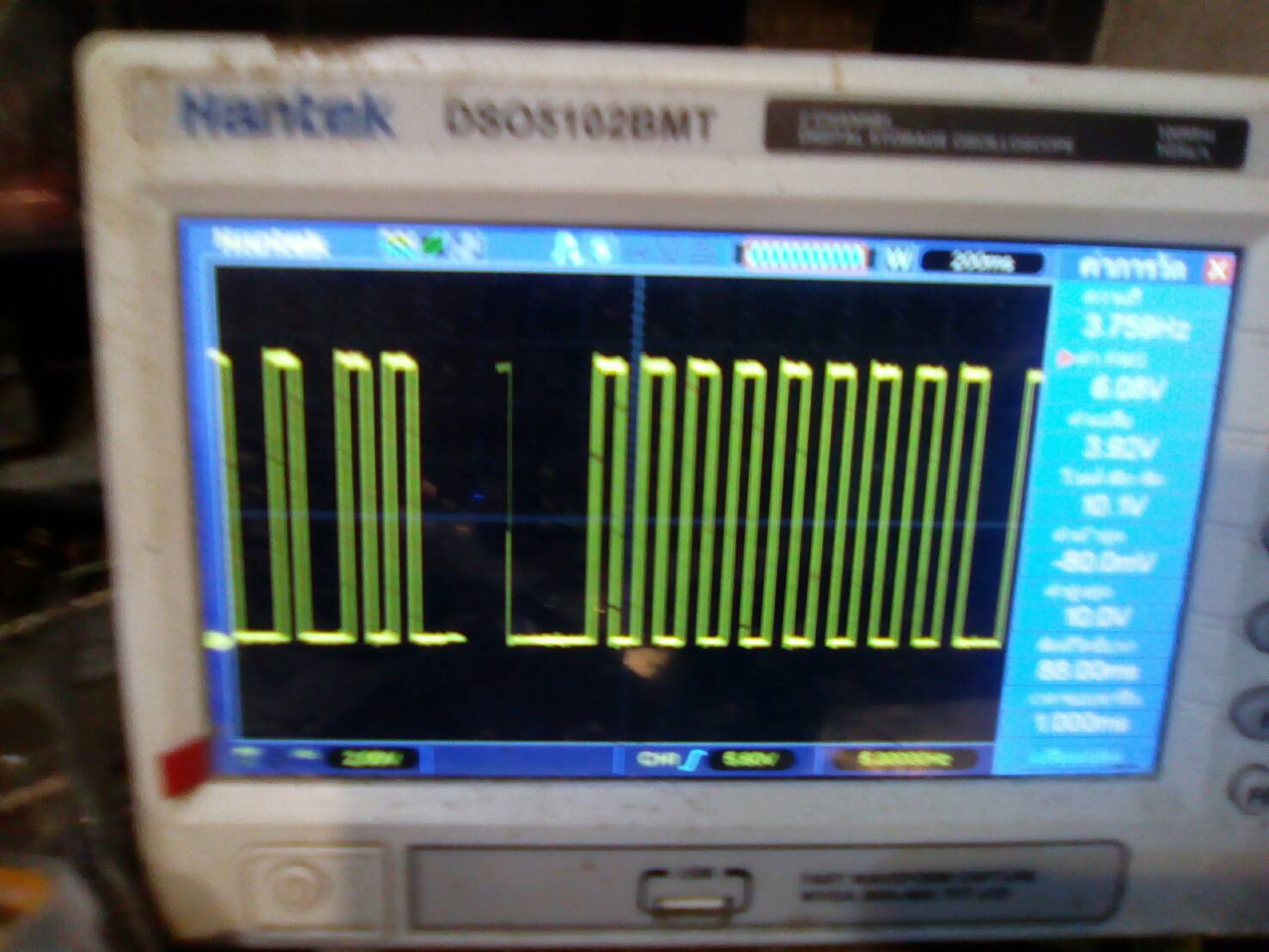

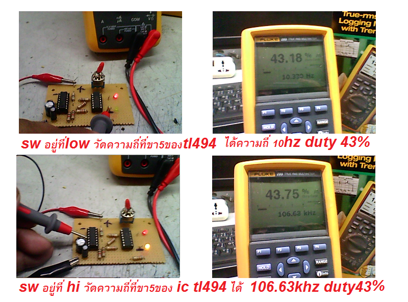

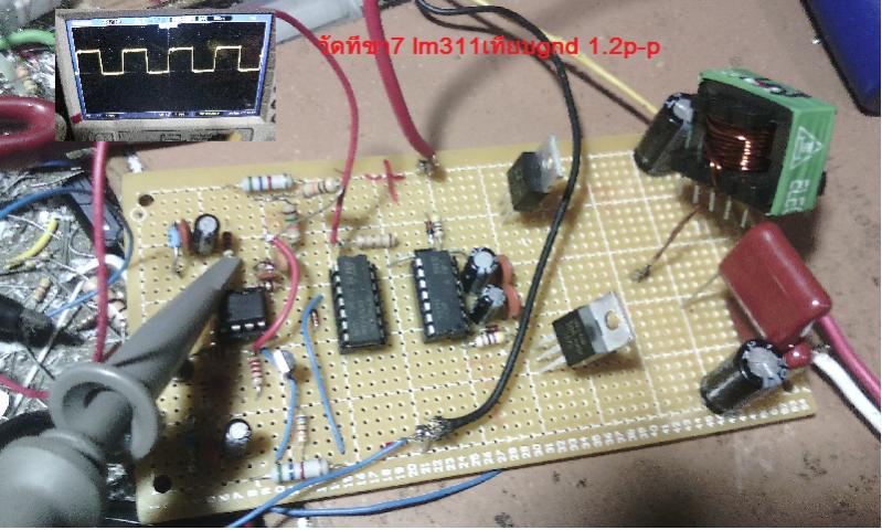

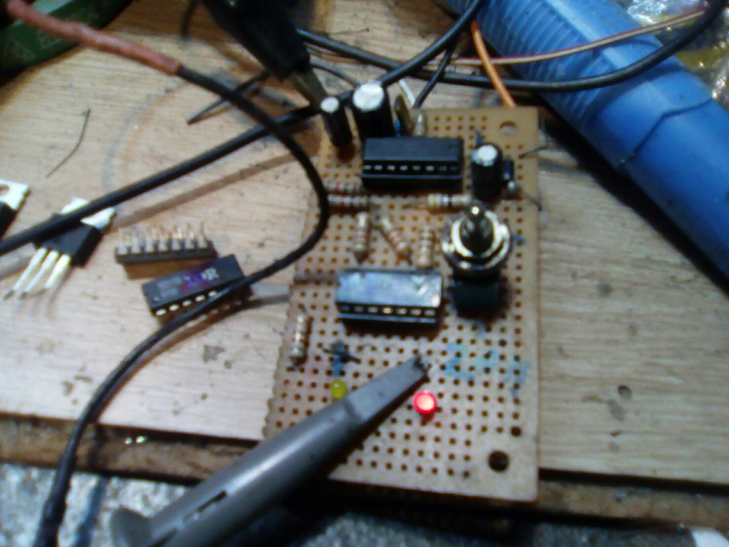

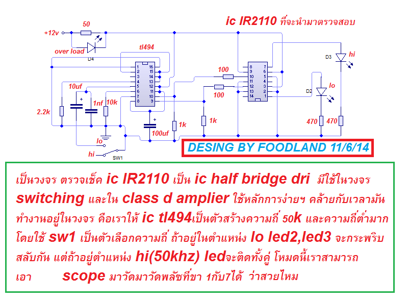

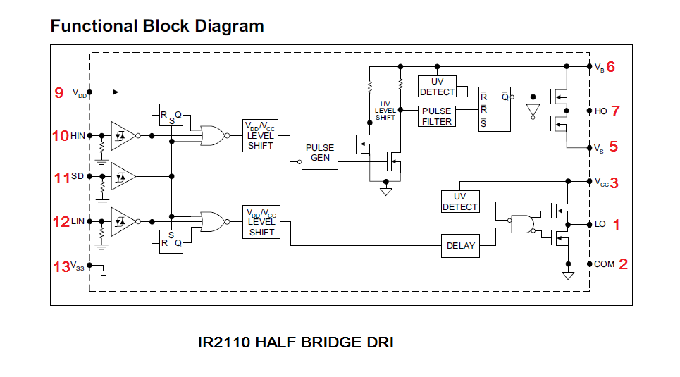

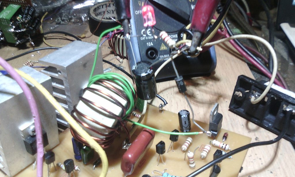

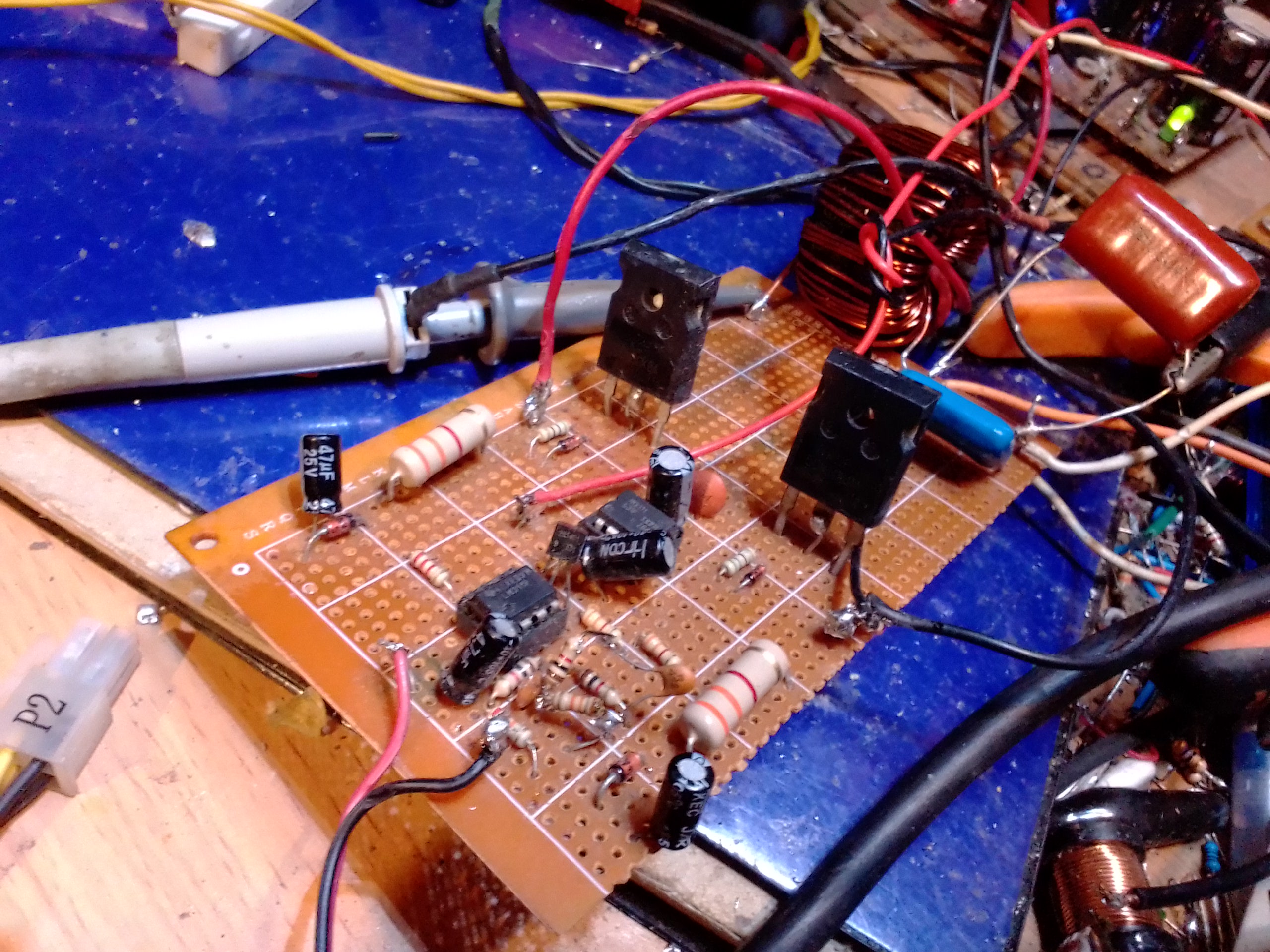

ir2110 test circuit in circuit use tl494 generate 5hz and 56khz sent to ir2110 this output pin1and7 conect led show for ic work

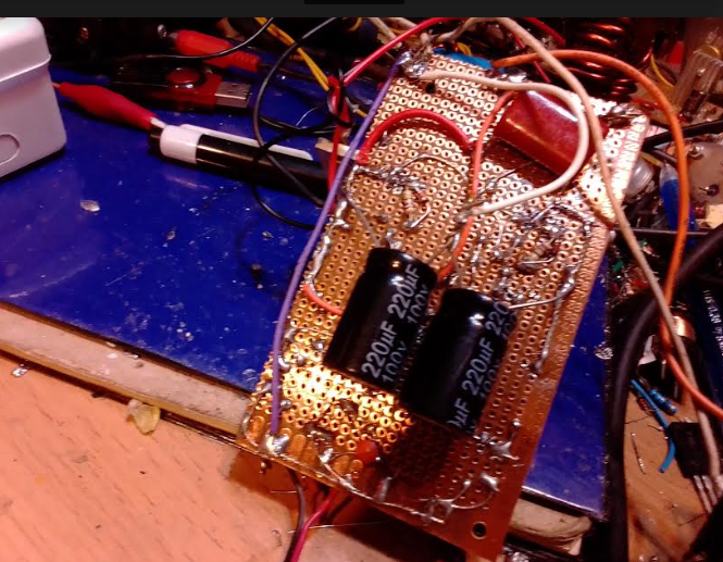

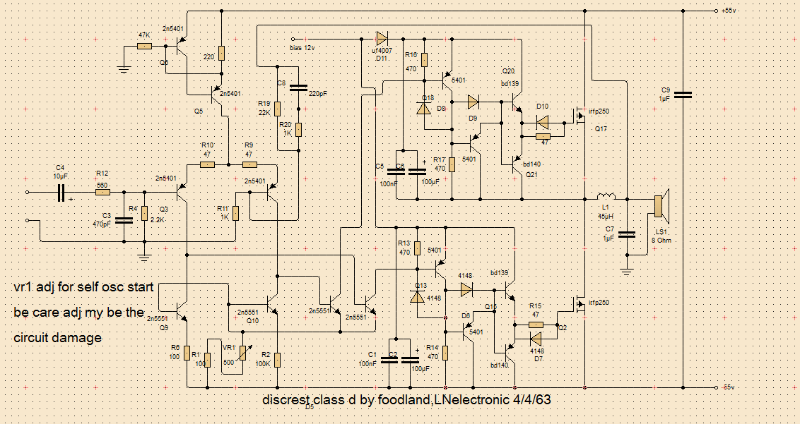

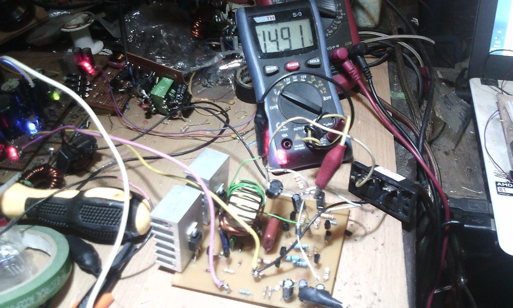

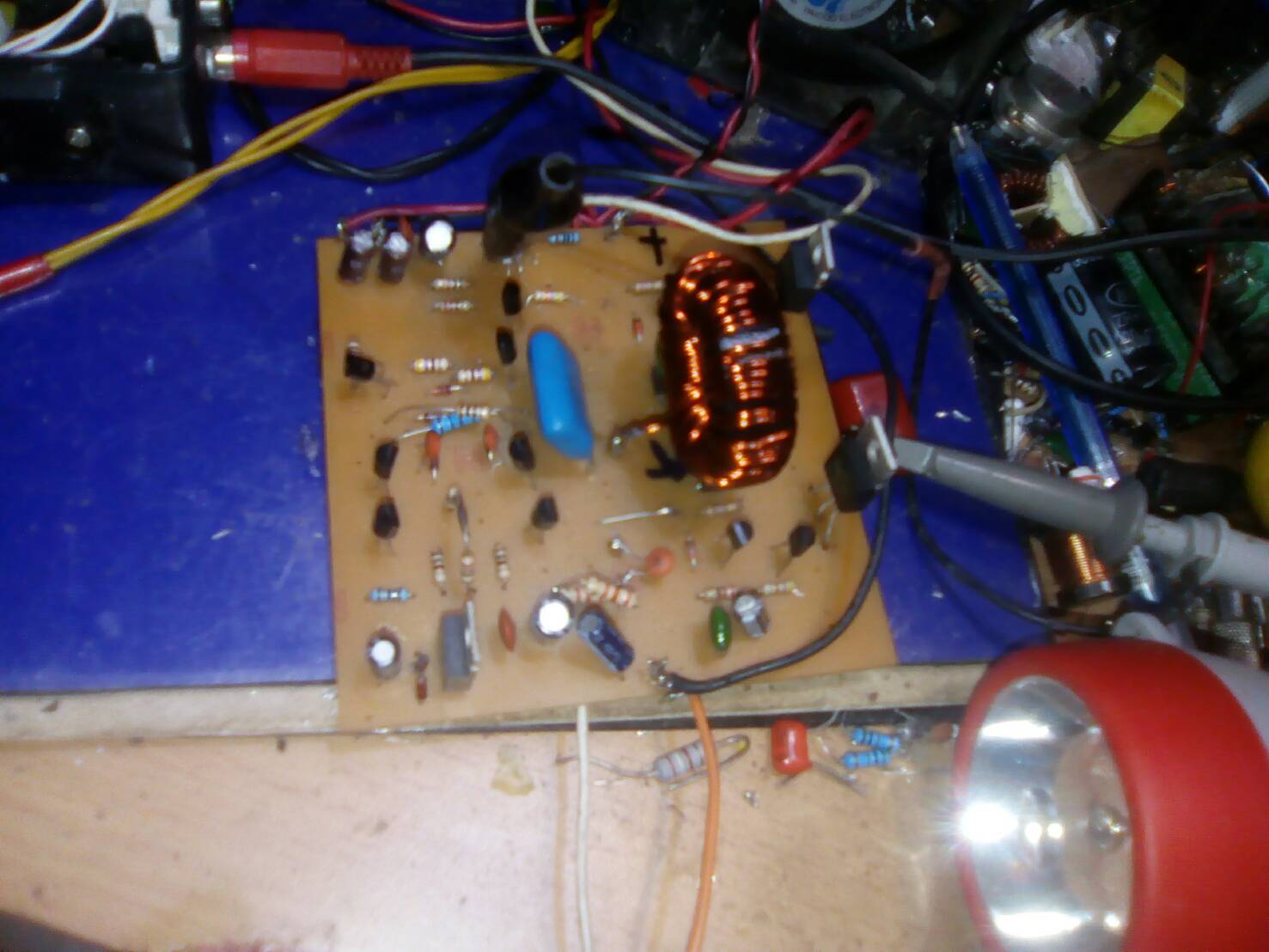

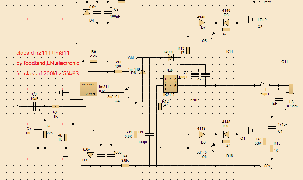

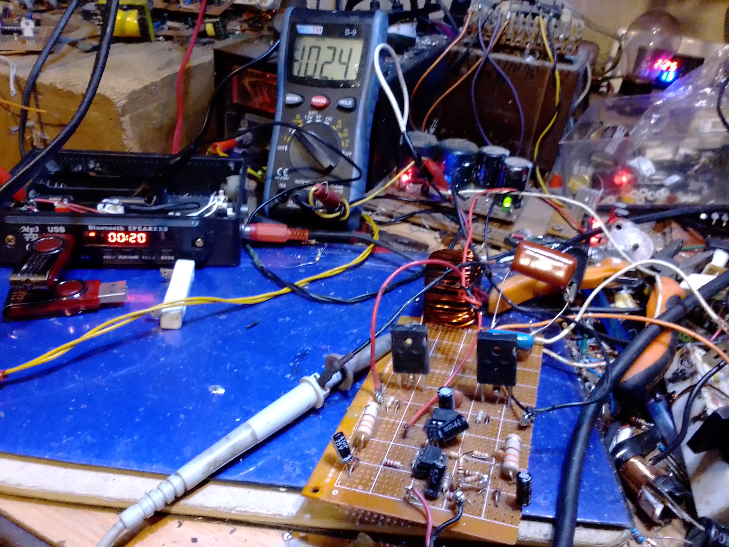

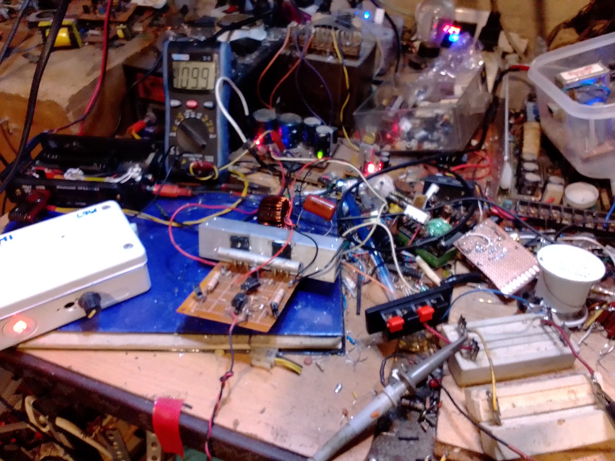

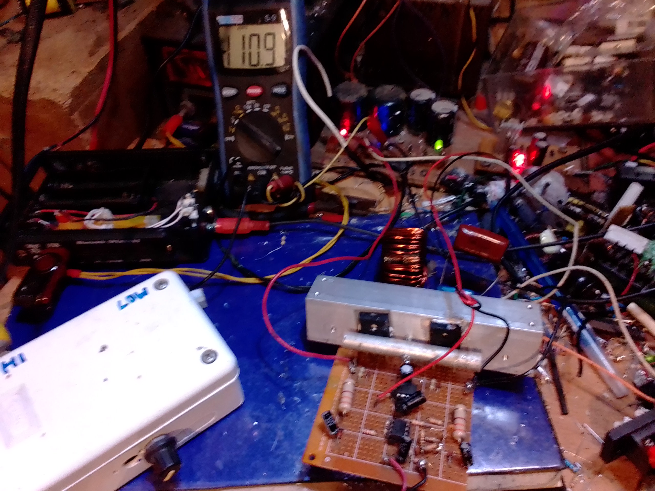

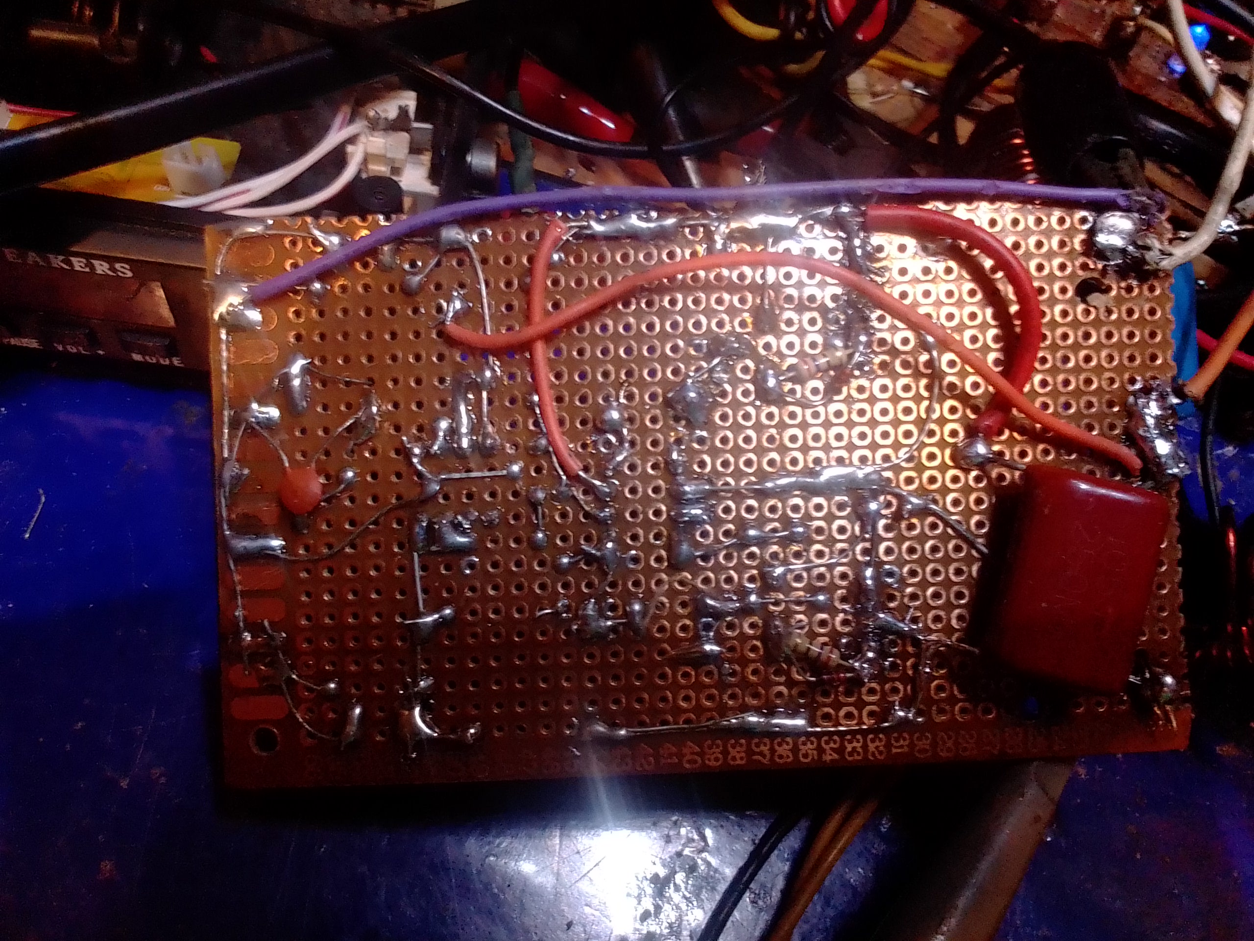

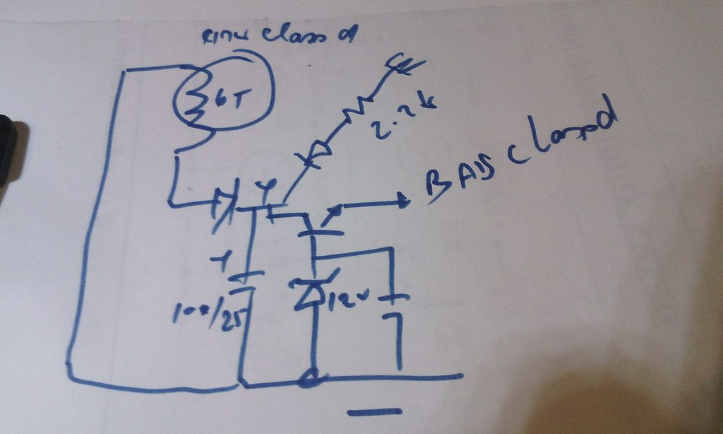

discrest class d by foodland วงจรนี้ต้นแบบมาphilip ucd เป็นแบบself osc ใช้trasistorขับ วงจรนี้การปรับvr1ำคัญมาก ปรับน้อยไปวงจรไม่osc ปรับมากไปวงจรกินกระแสมาก อุปกรณ์อาจเสียหายได้ ควรเอาหลอด100wอนุกรมไฟเข้า220vacด้วย ในขณะทดลอง

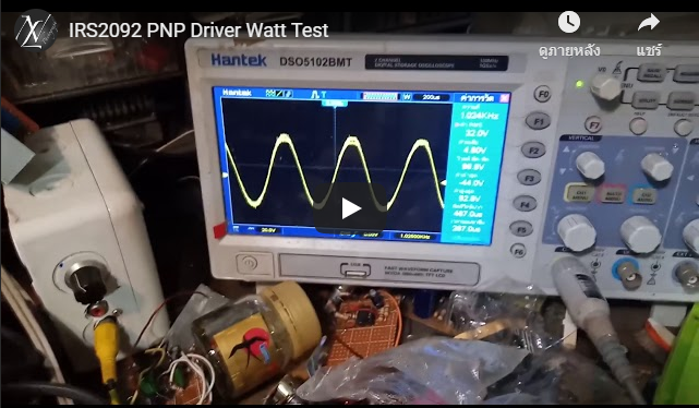

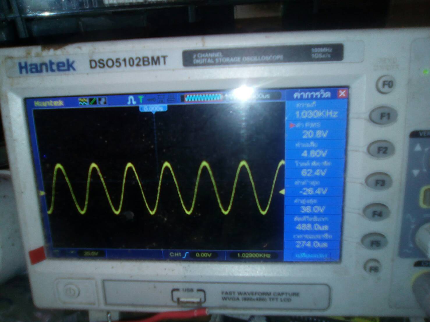

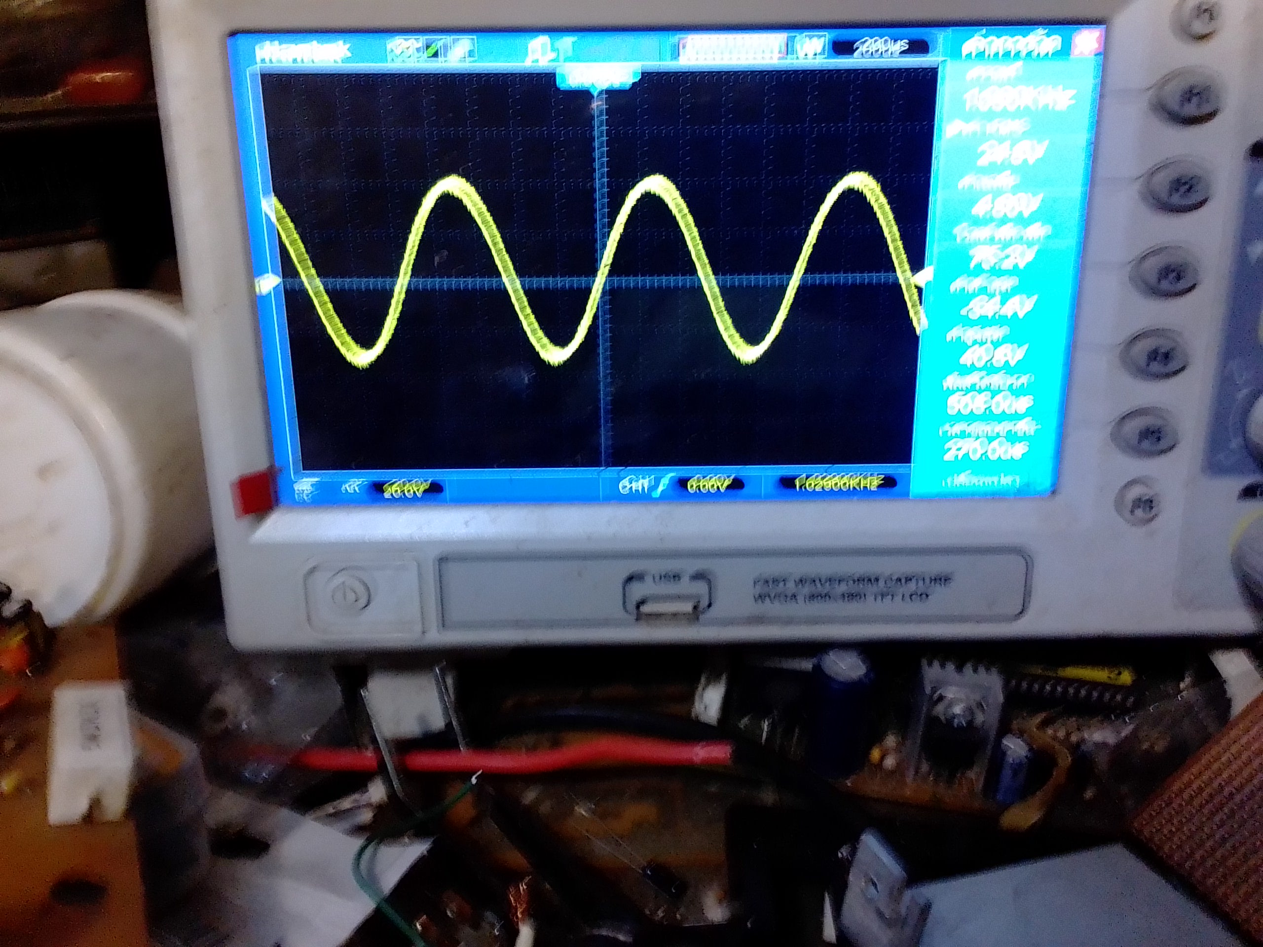

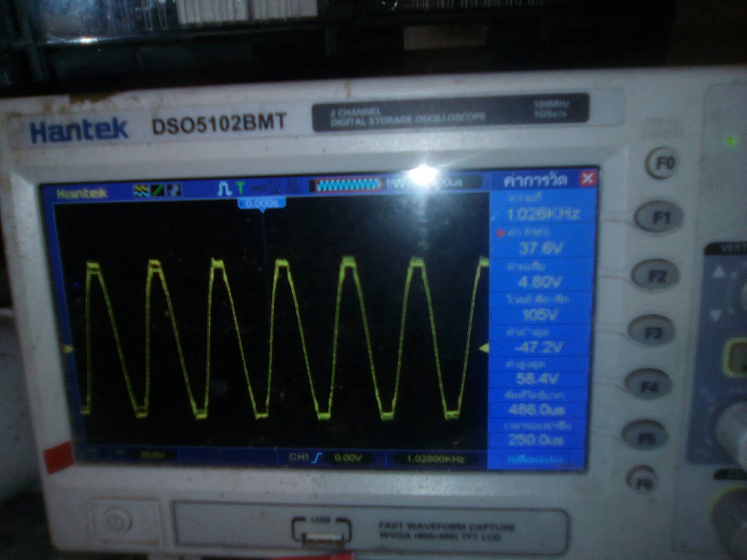

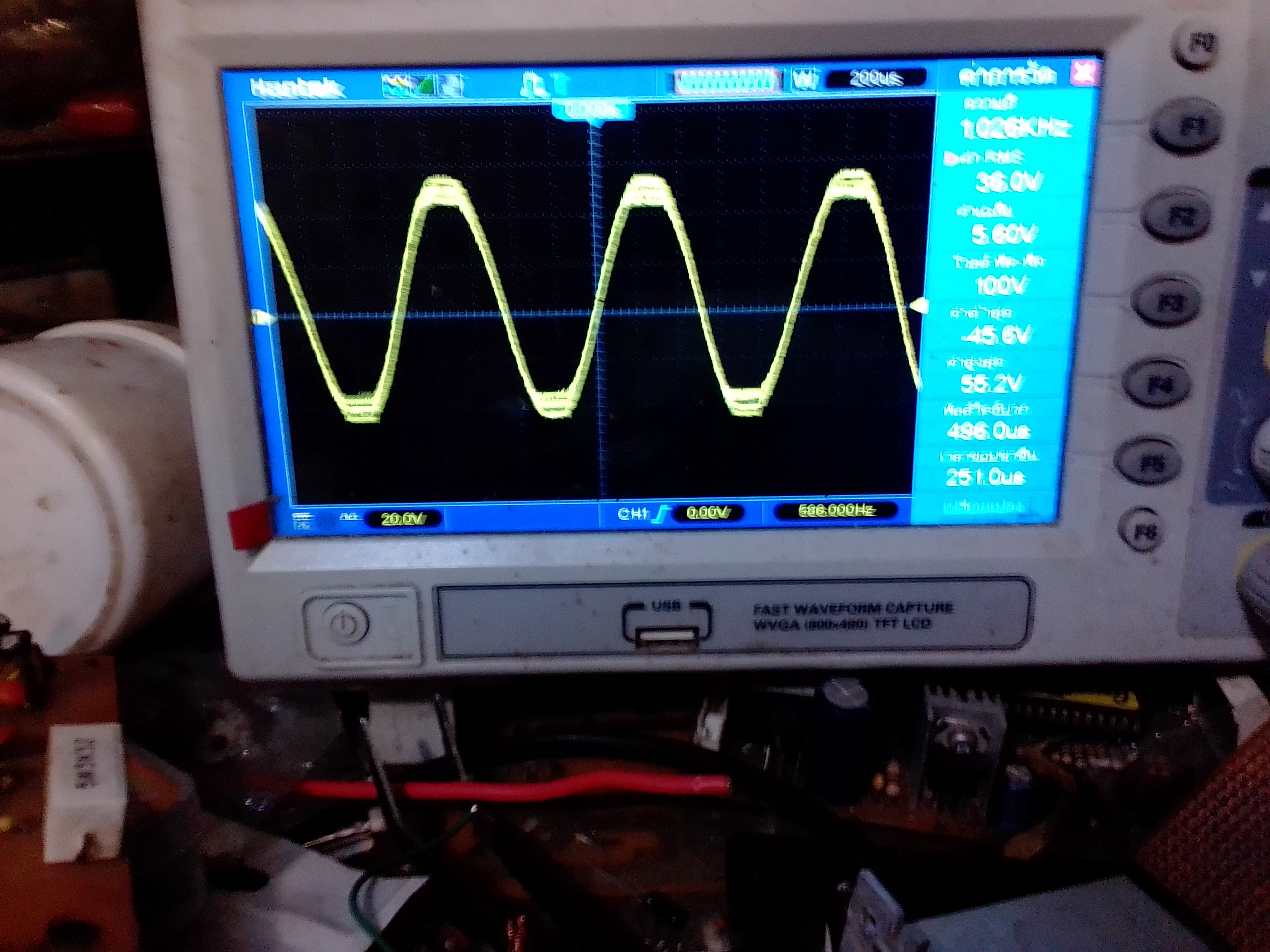

you need to test at max power so people will come and see how stable your class D experiment, put it 4 ohm load, pull max volume, let say you powering from +-50 and so on, that how you can see if your design can handle full load or black bull. 😀
irs2092 test +-55v load4ohm vdo YouTube
ok good, but your power supply drop alot, you need to add more caps bank or use smps, i have test many time for amplifier limit, but i always do with smps + feedback, voltage drop only 1-2 max volt not more. always drop like 1v normally cause of smps cycle the power feedback 1 second. your amp maybe can go more than that with good hi power supply.

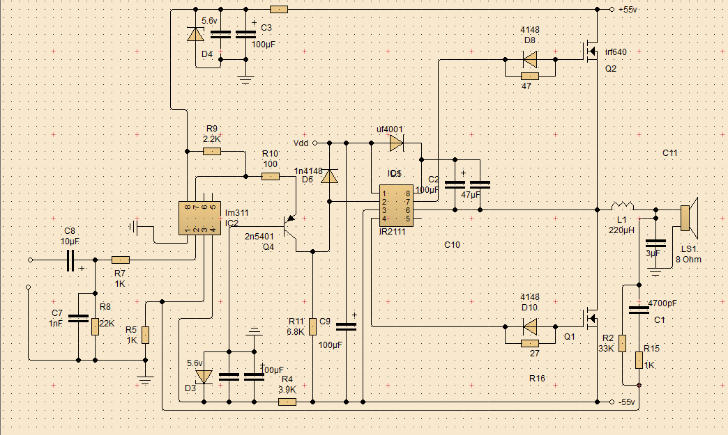

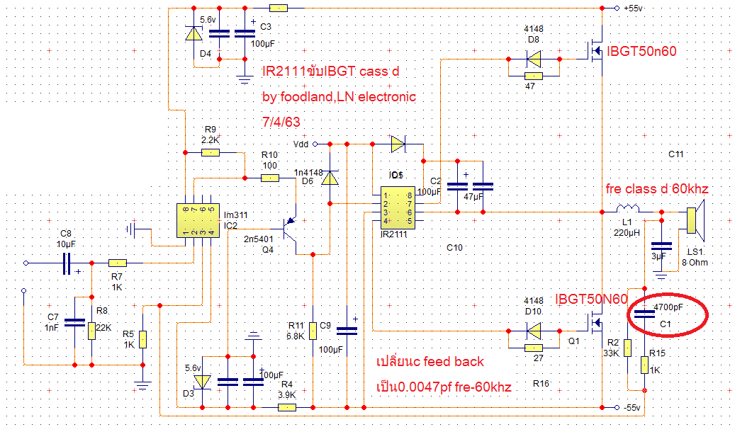

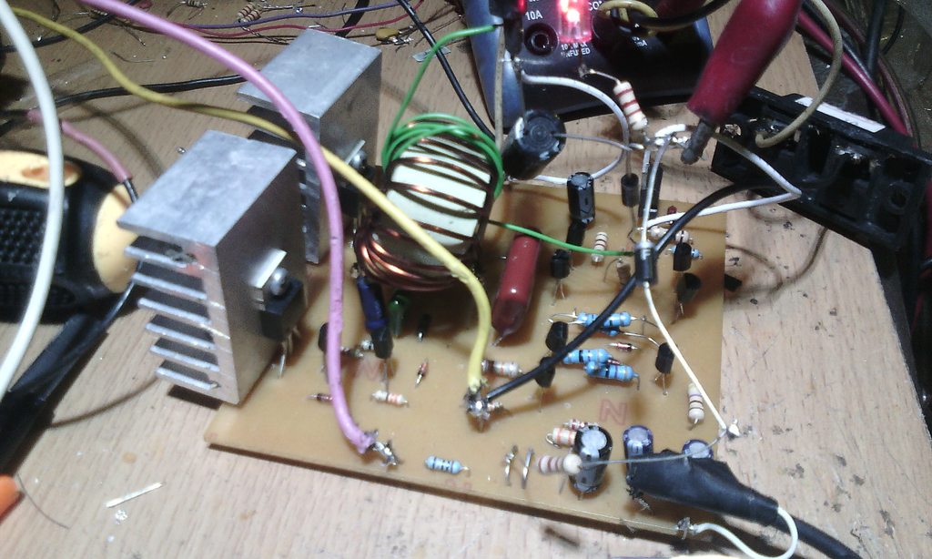

class d ir2111+ibgt part2 chek audio out and power
it test +-55v load 4 ohm vdo YouTube

ive seen nice result from you surachit, i think you are class D fan also we need to support him, because we are now at home, cannot go anywhere because of covid-19, so all this we can do at home., hmmm igbt what running freq? surachit can you make on simple classic IC such as tl494 and sg3525AN so we can make experiment on it lol. let see if you can some for the 494 and 3525.
thank you for comment non i stay my home beacuse covid 19 ,many shop for electronic parts close.
