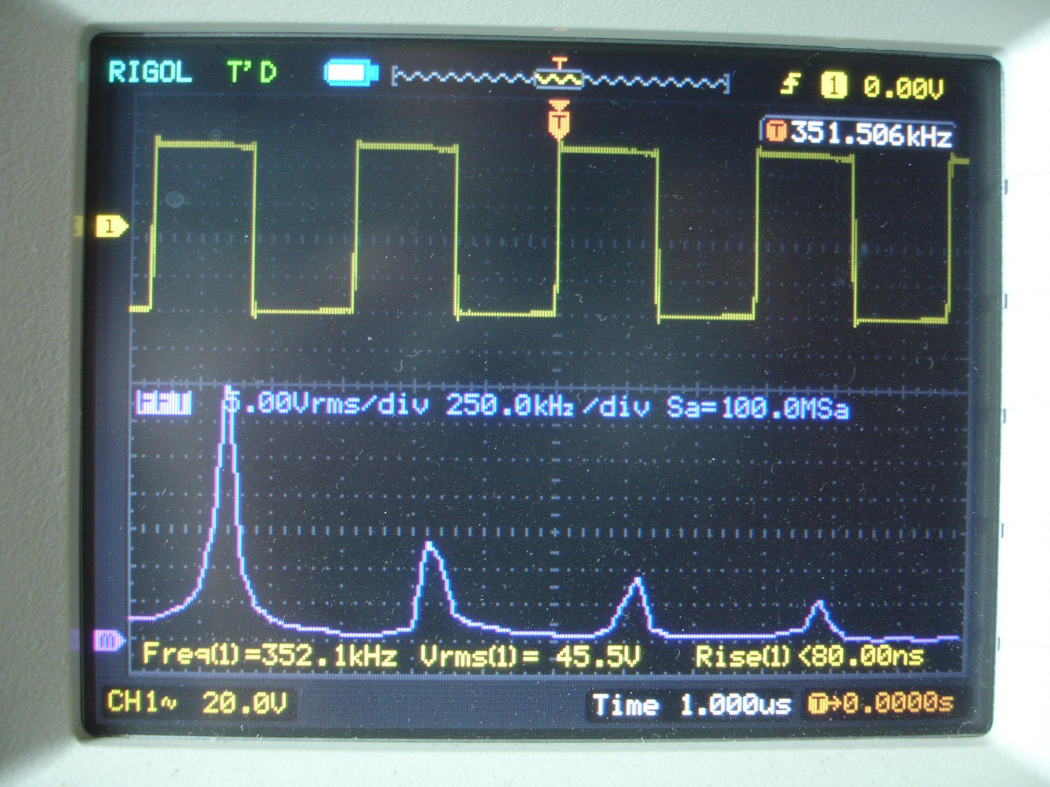

Hi Mile, is it something wrong with my amplifier.I see that it is runing at 280KHz not 450KHz ?
Do you think that is something wrong?
What i can do to disappear this in red circle oscillations?

Use 1k pot instead 510R resistor and set frequency. Amp will work from 250kHz to 450kHz but with proper output coil, use micrometals ring core T106-2 or T130-2 or use coilcraft 33uH inductor post #807 http://www.diyaudio.com/forums/class-d/182900-class-d-amp-lm566-lm393-2xirf530-81.html

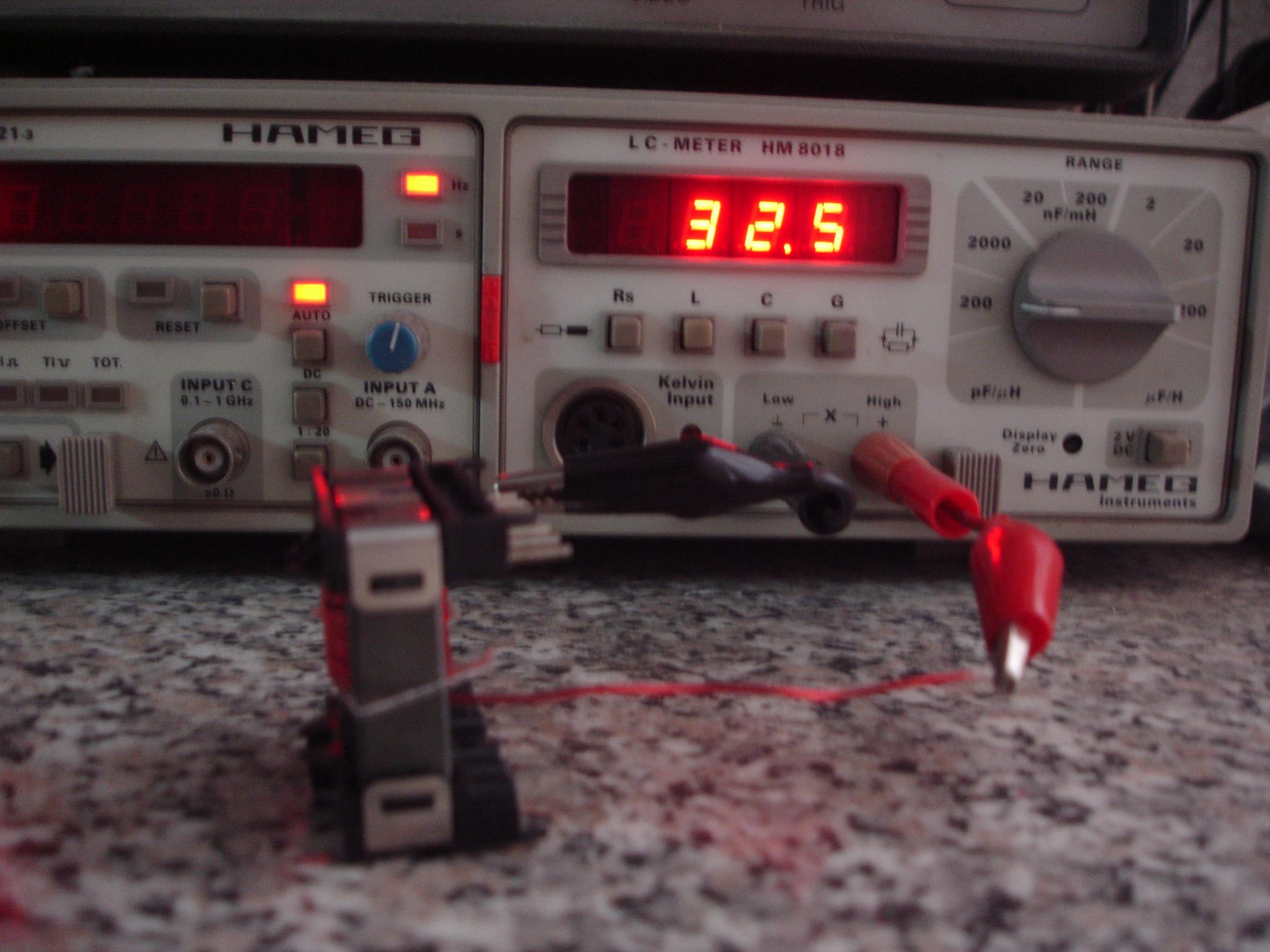

I see this code typed on the ferrite 3c90
The measurement value
Scope behind the Low Pass filter

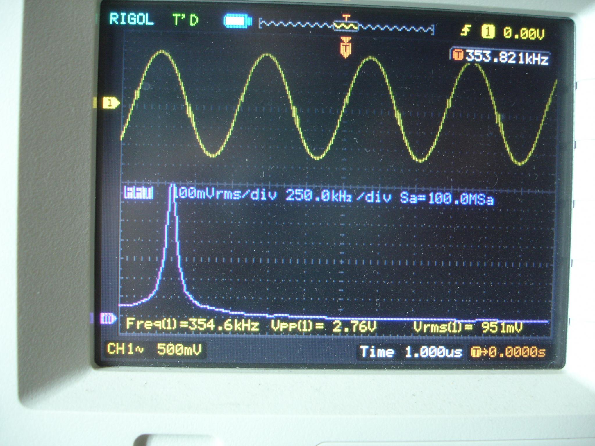

Scope after Low Pass filter.
