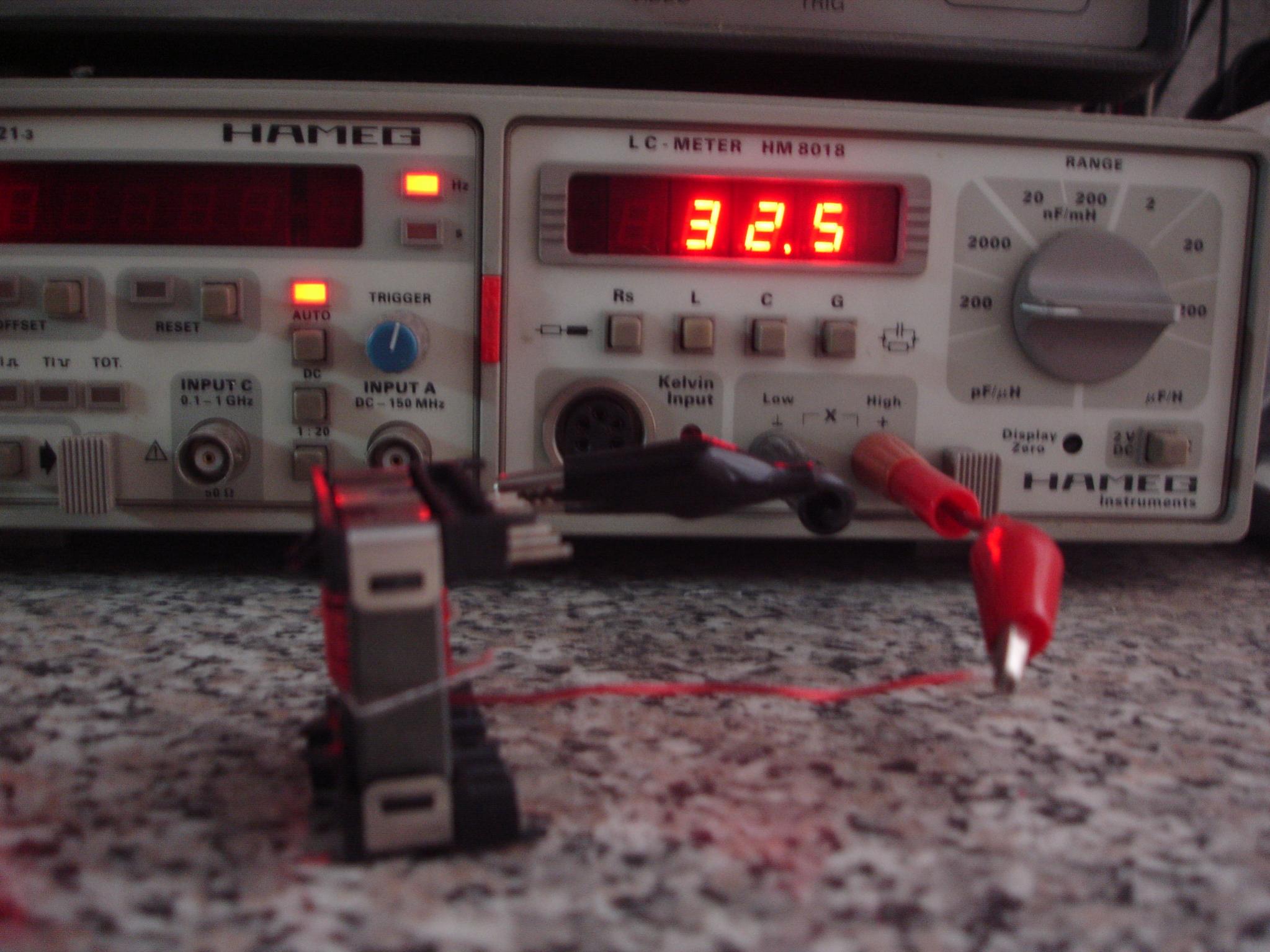

If you need a micrometer to measure it, then it is too thin. It should be close to 1 mm. (And of course more turns.)
Saturation current=250A*air gap (in mm) / turns. For example 20 turns with 0.2 mm gives only 2.5A
Pafi,i haven't a micrometer but i have an LCR Meter.Look this measurement.
