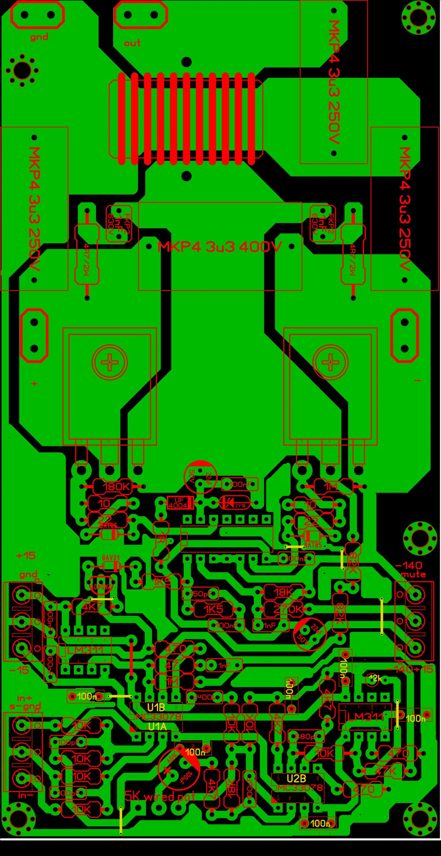

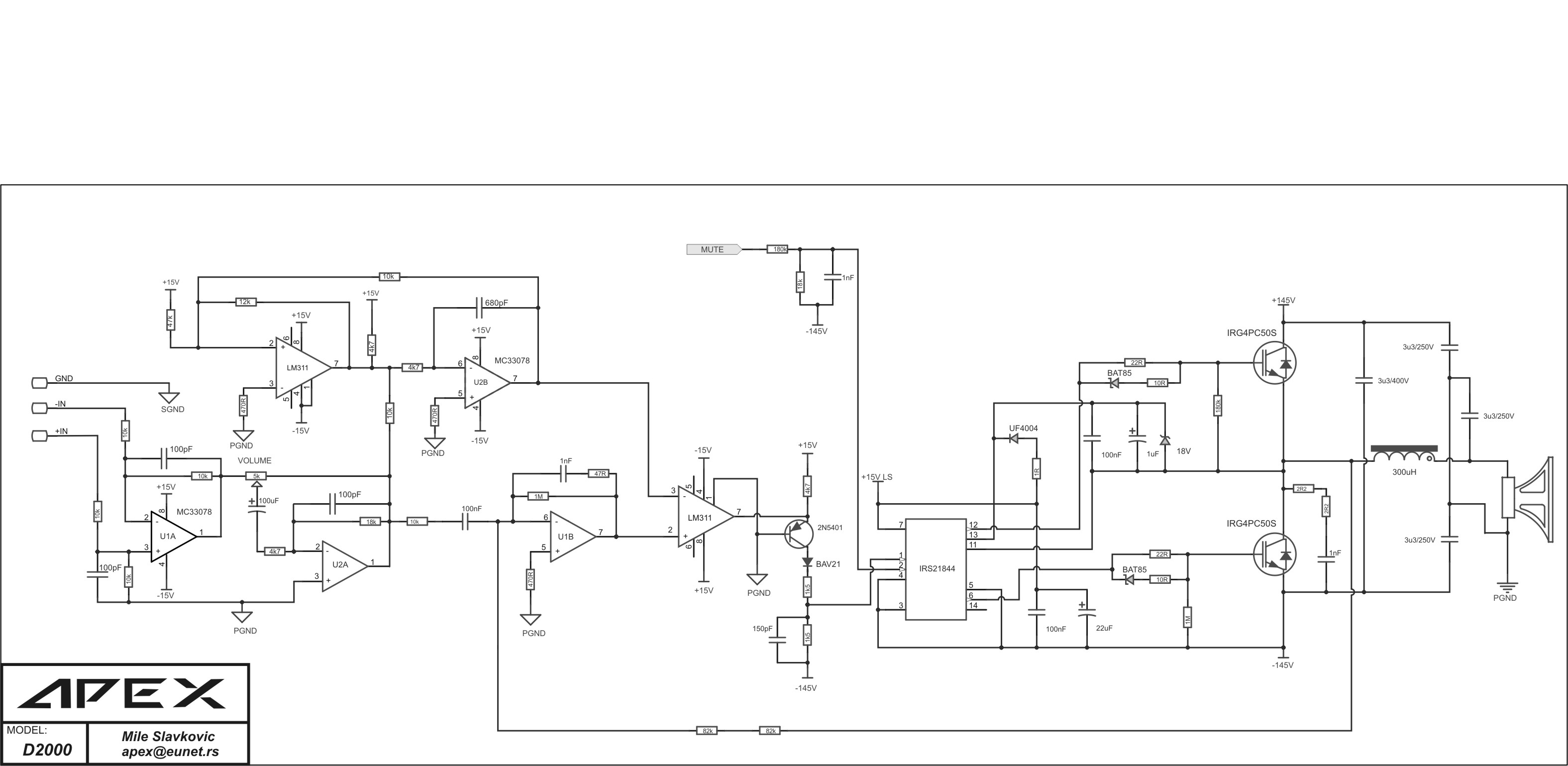

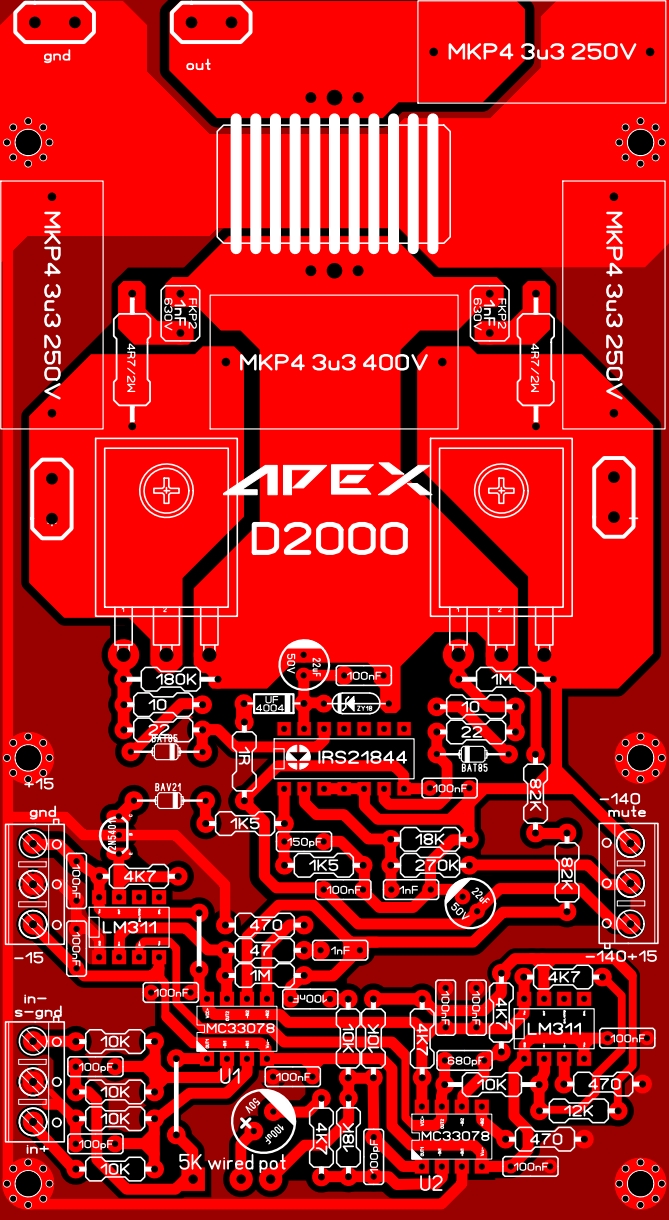

I think i've spoted some mistakes on the left LM311:
out(7) is not connected to emiter 5401,
missing connection left LM311 IN-(3) to OUT2(7) of right mc33078,
pins inverted on schematic, OUT2(7) of U1B it's connected to IN+ of LM311(2) but shows pin 3, and IN- (3) show 2, so maybe connections wrong, mr, Mile could tell us.
Good job for first try, keep practice, use zone instead of track when you want to fill area, route tracks between pins and can ditch straps

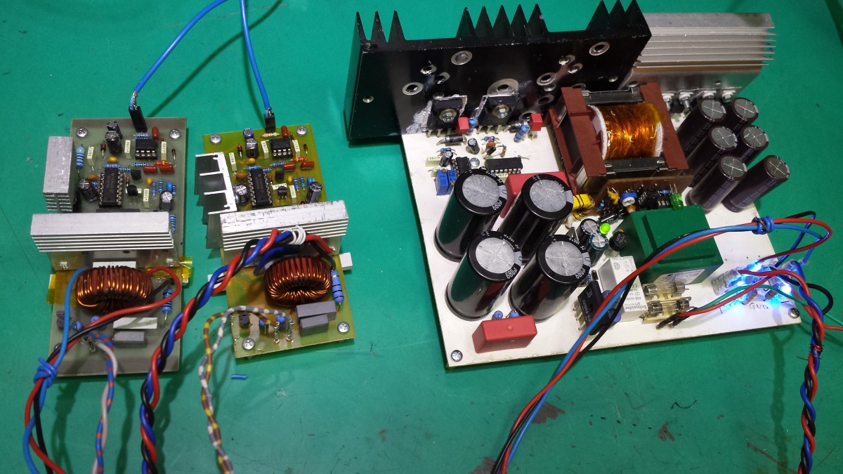

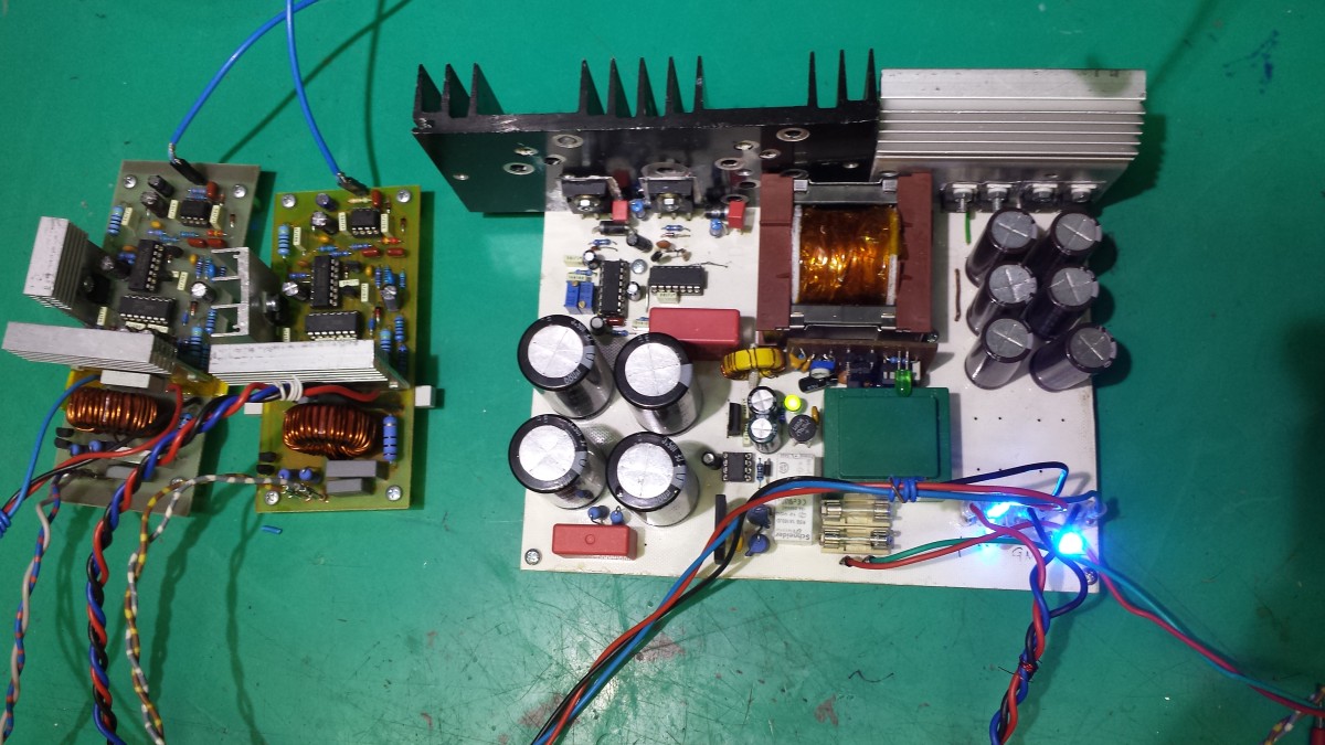

My Apex D200 powered with +-70V SMPS. Some resistors are very hot ,the fets and coil are just warm.Sound is good ,no hiss,no nois from SMPS.Very good amplifier,I will use it for small partys at home🙂🙂.
Regards
zoky2

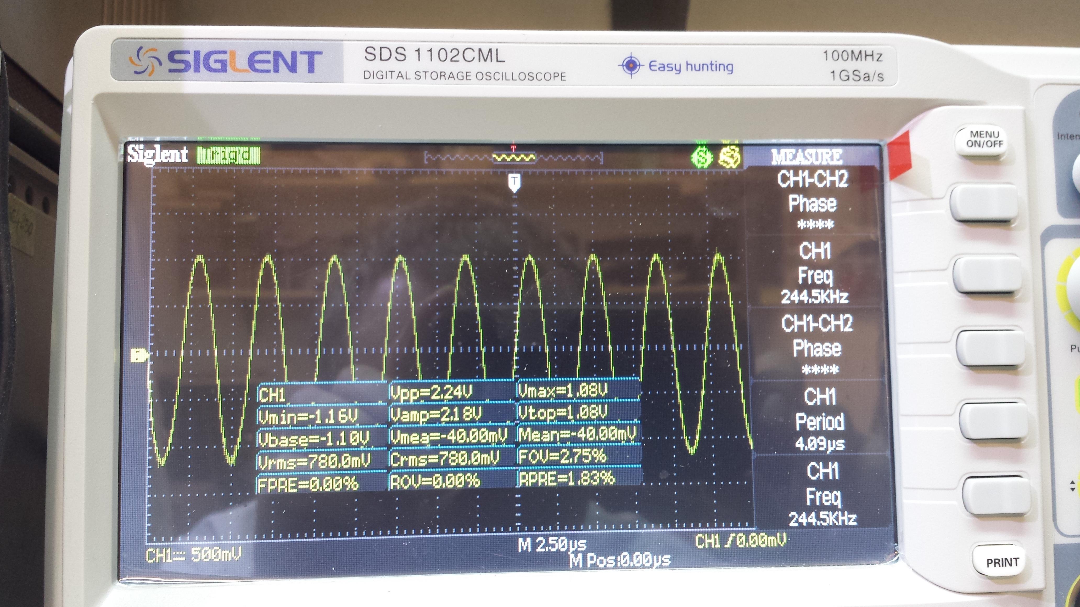

When I was testing D200,i was discover that the zobel resistor is very hot,so I take some measurement with osciloscop at output. I discovered oscilation , around 245 khz and 2,24Vpp.Changing SMPS with linear power supply make no diferents.Any suggest how to fix it?
Regards
zoky2

Link to the schematic?
This voltage doesnt seem to be a bug. Its a feature due to the nature of ClassD. Heat is a different thing. But need to know the values to optimise.
