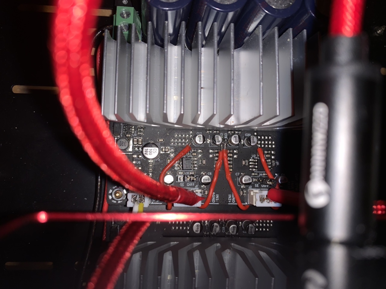

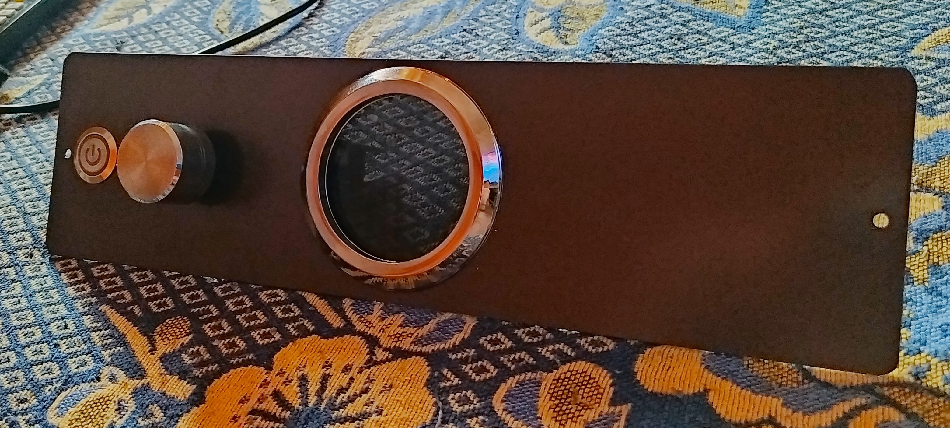

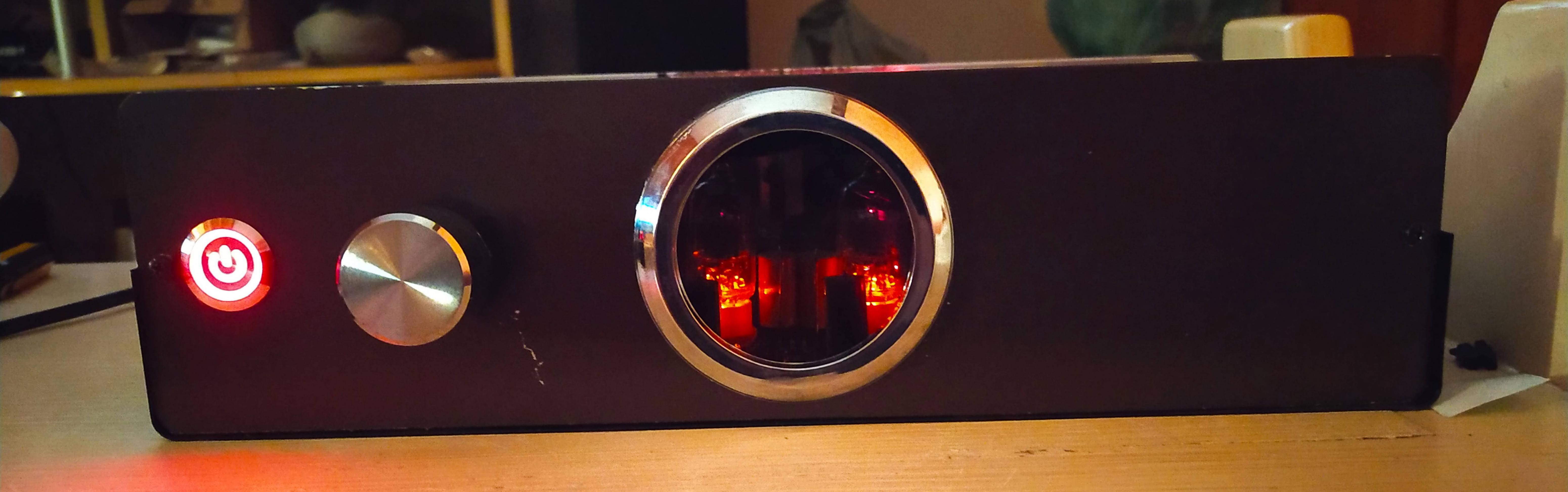

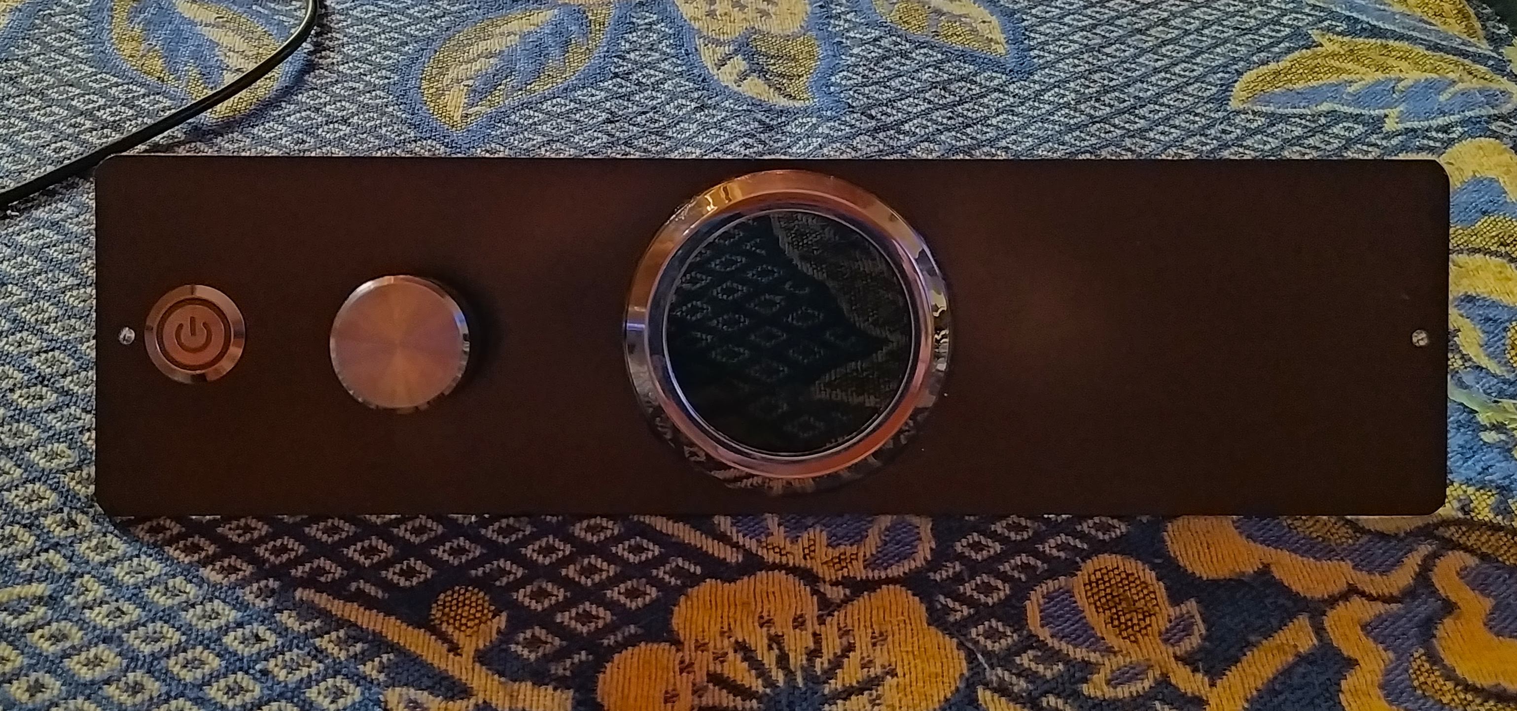

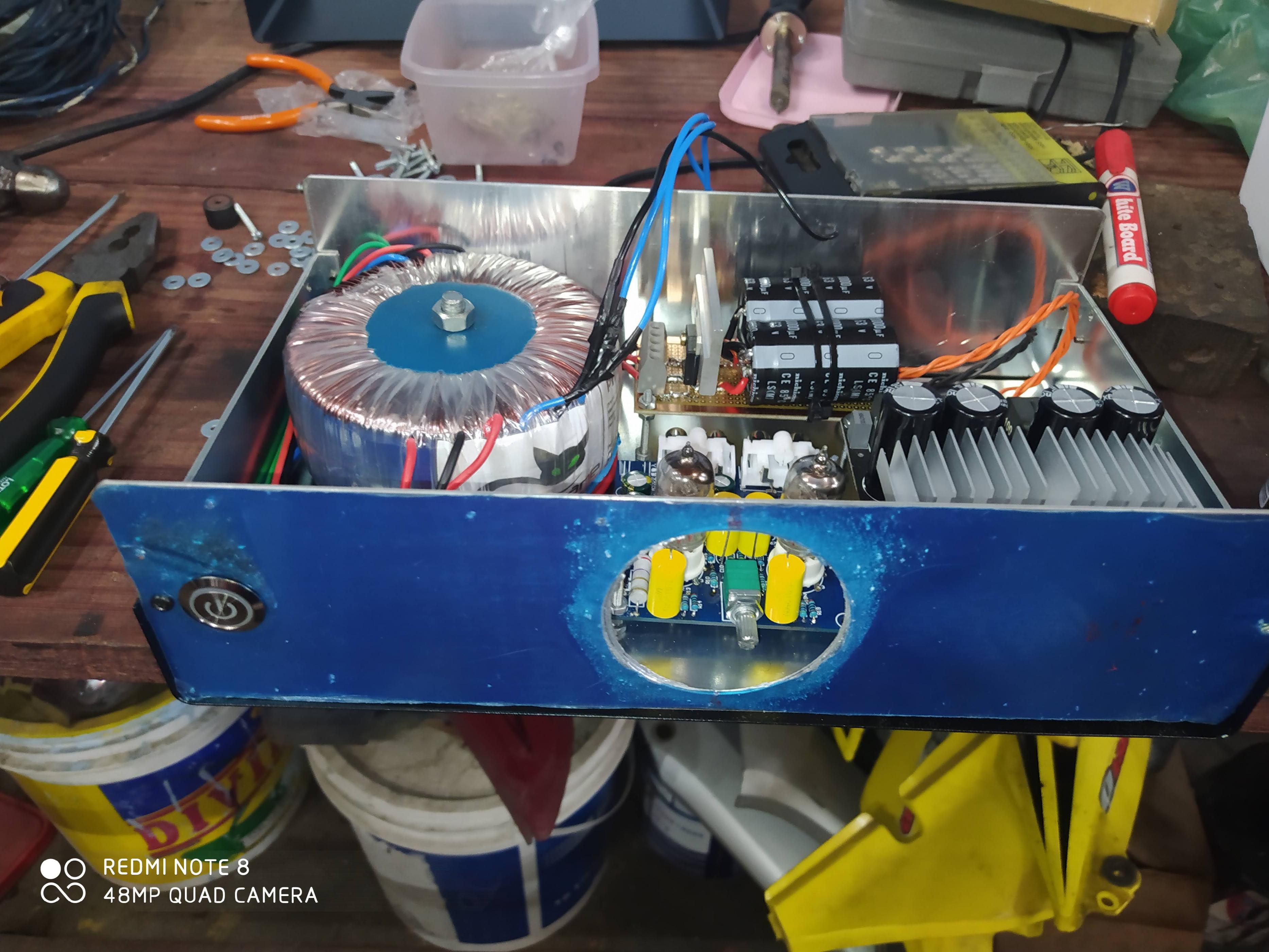

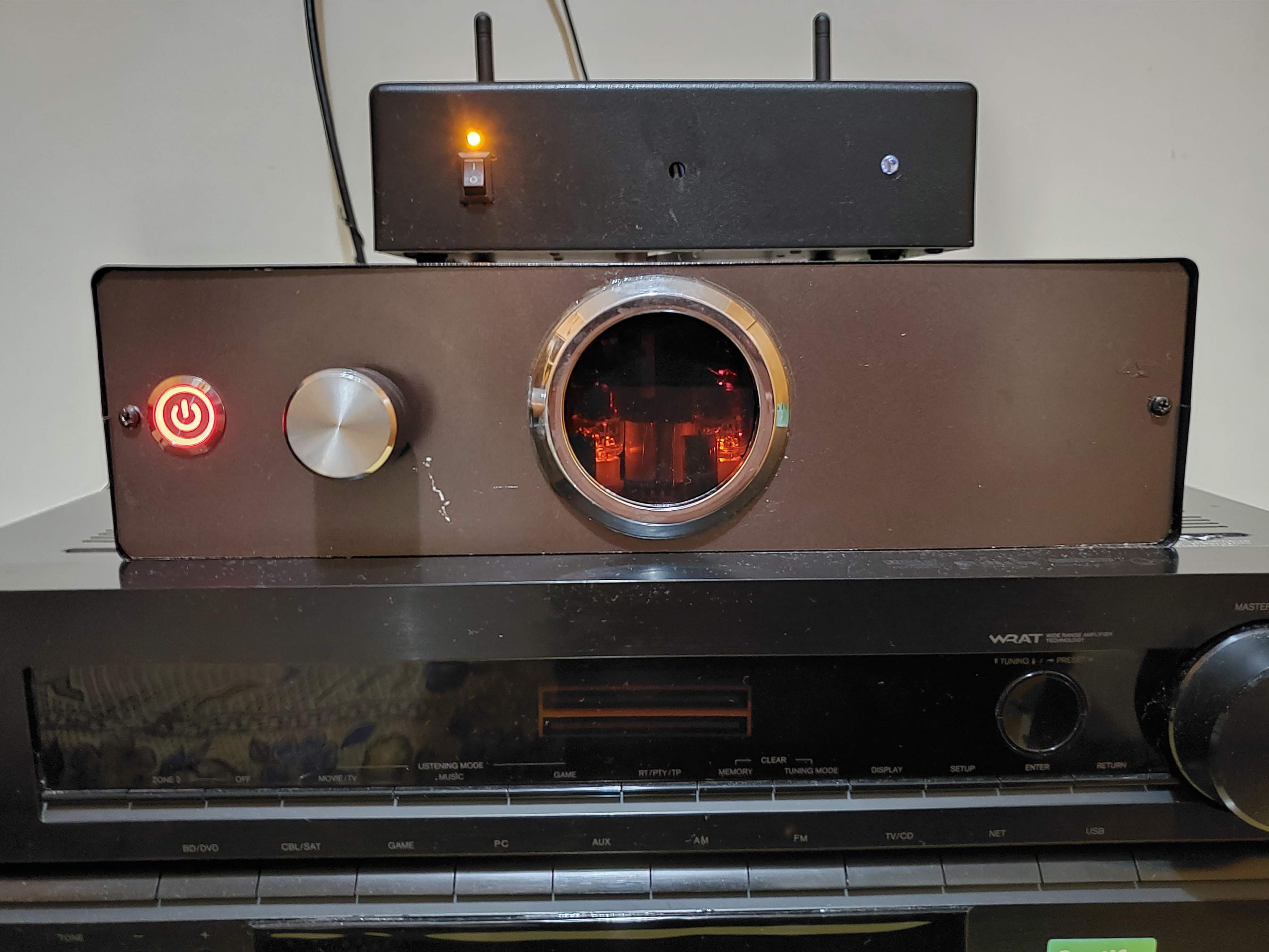

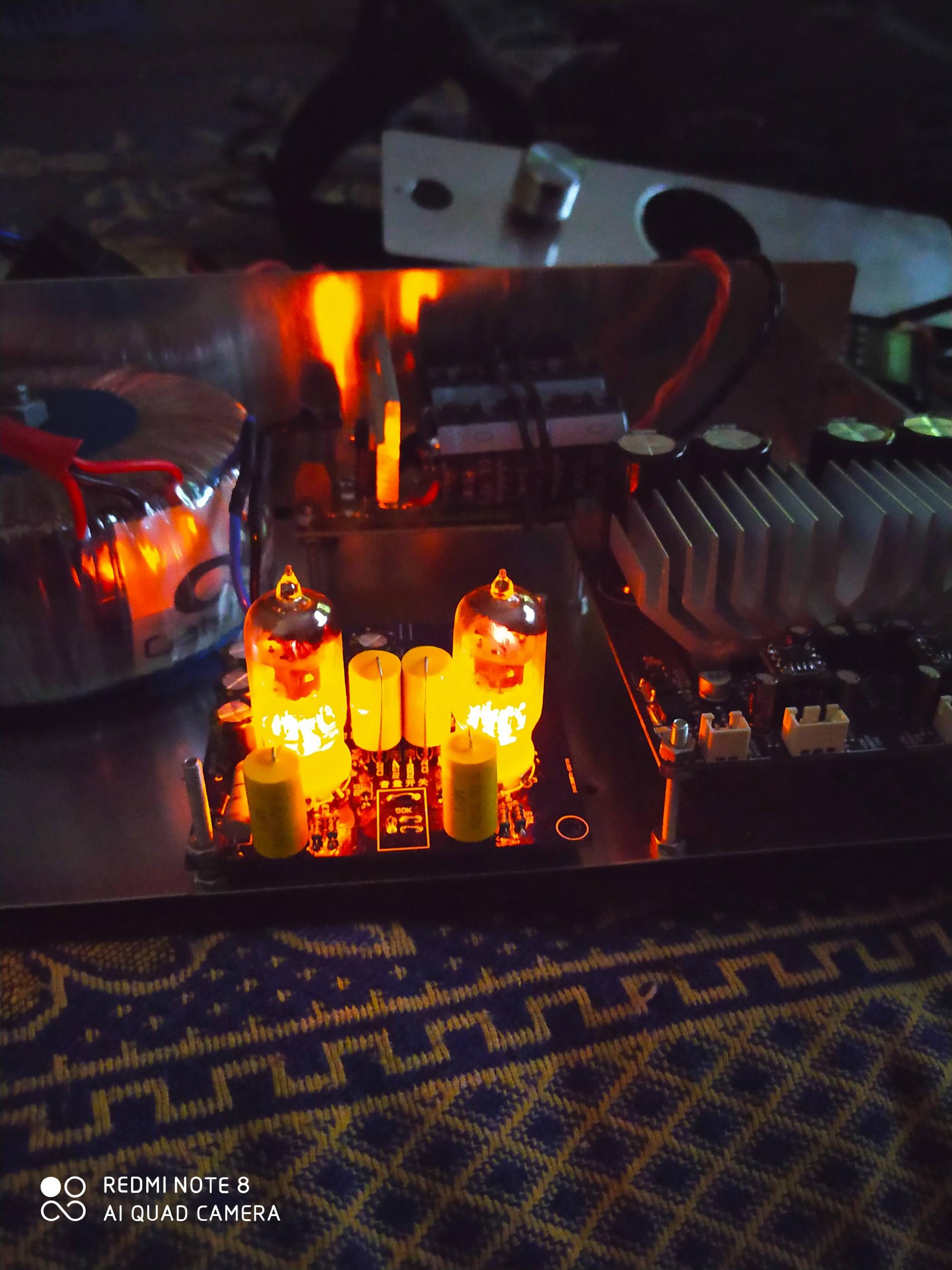

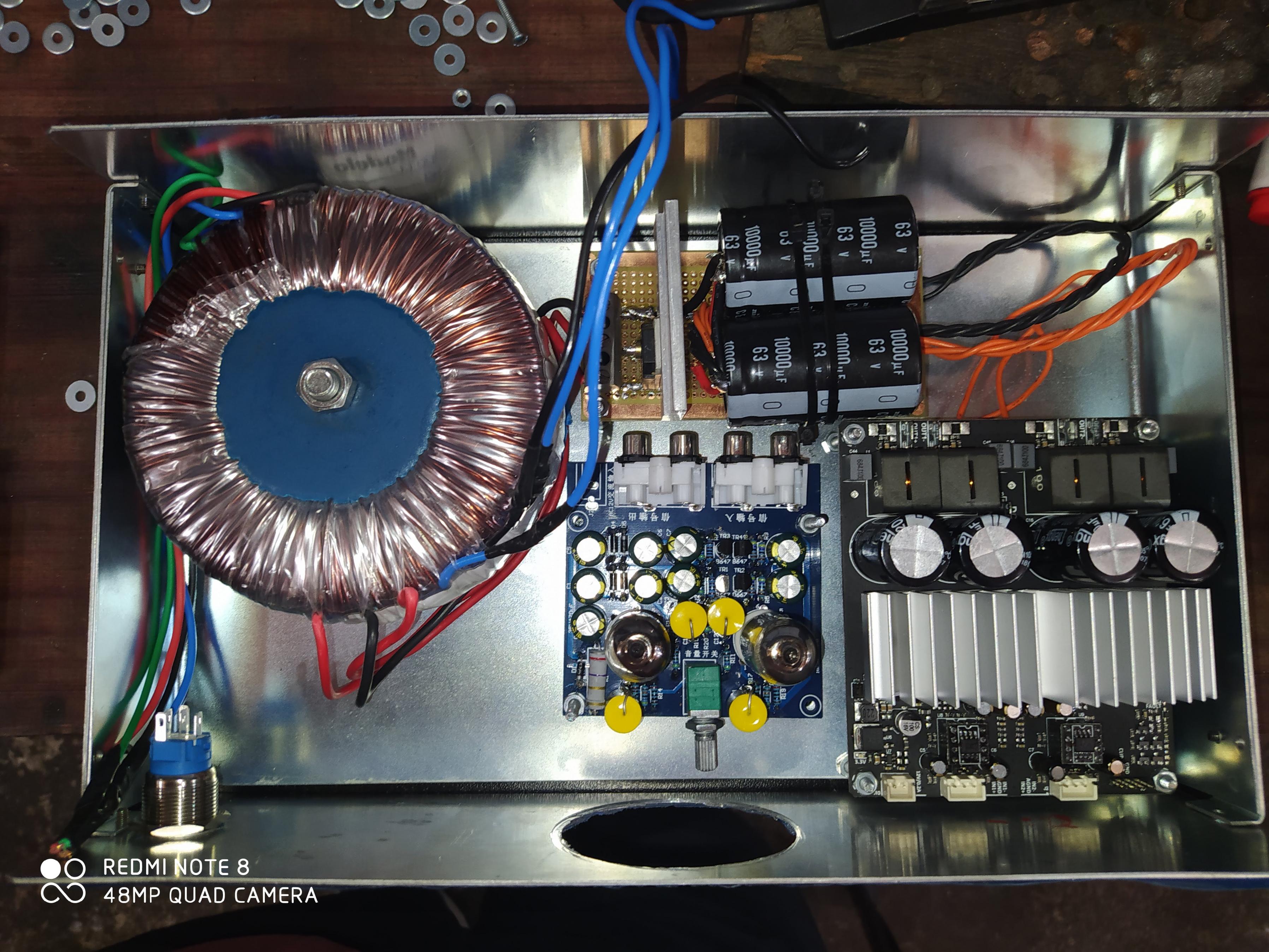

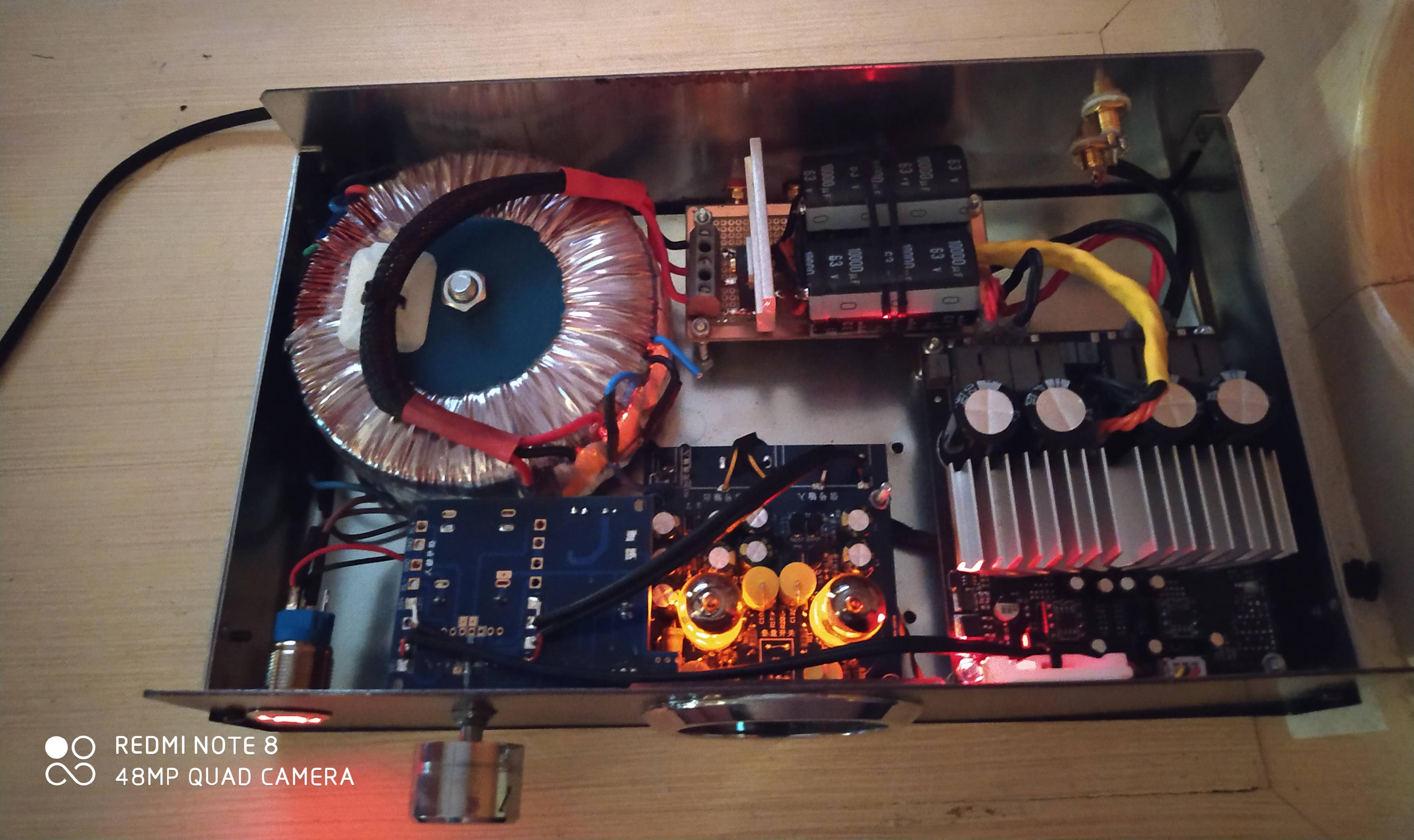

My TPA3255 with PCB 3e Audio, tube preamplifier, 44VDC 20,000uF linear power supply, motorized volume control, "alps" potentiometer.
I think I will have to add a cooler in this case because with this voltage of 44VDC the amplifier's heat sink is getting very hot and I don't like it, even though the fault LEDs or clip_owt aren't lighting up.
The sound is very good, very good, driving 5 ohm speakers with powerful bass without sacrificing the mid and high frequencies.
I am really enjoying the amplifier and listening to music all the time during the weekend and now during my work at home office.
My signal source is an UP2STREAM PRO V2 card where through it I access a DLNA server with my FLAC collections or my playlists on Spotify.
It's a very nice system.
I hope you enjoy watching my work.

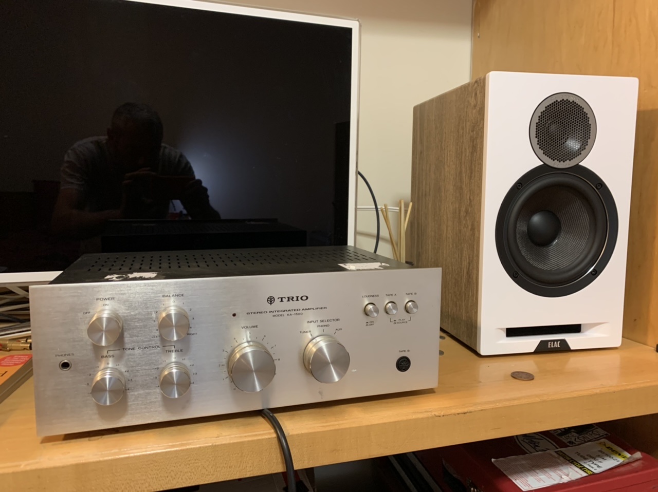

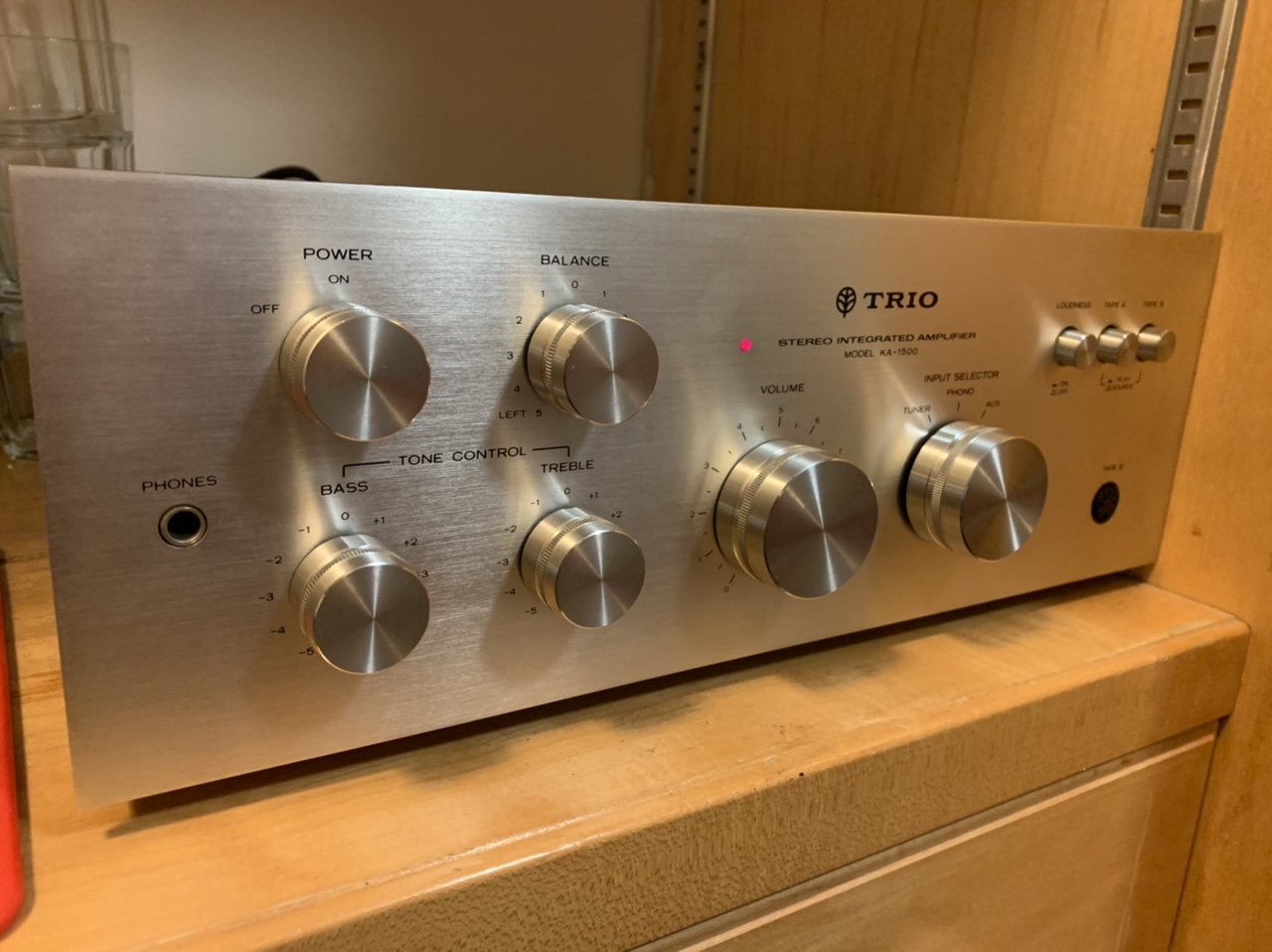

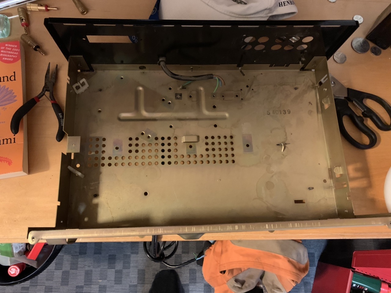

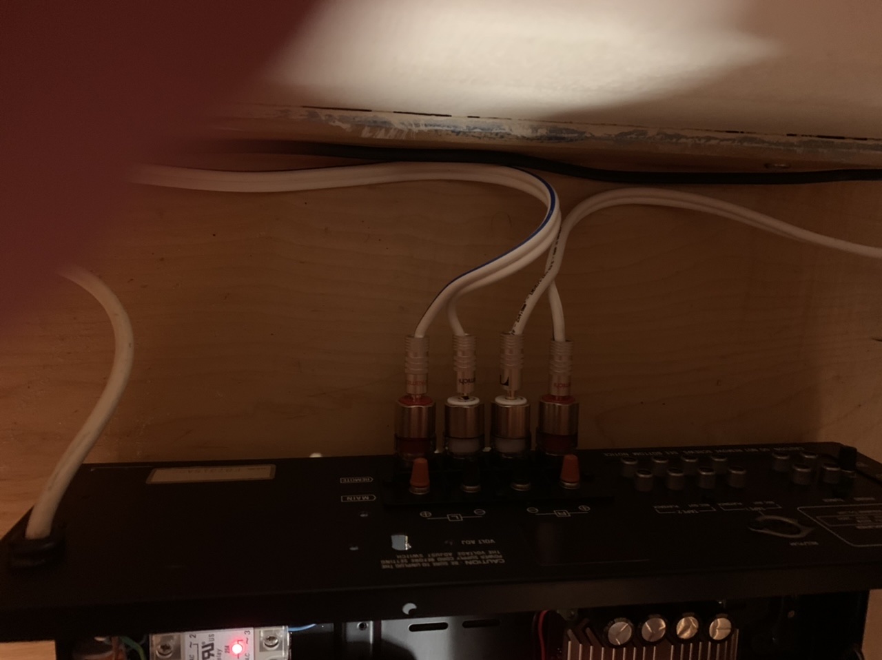

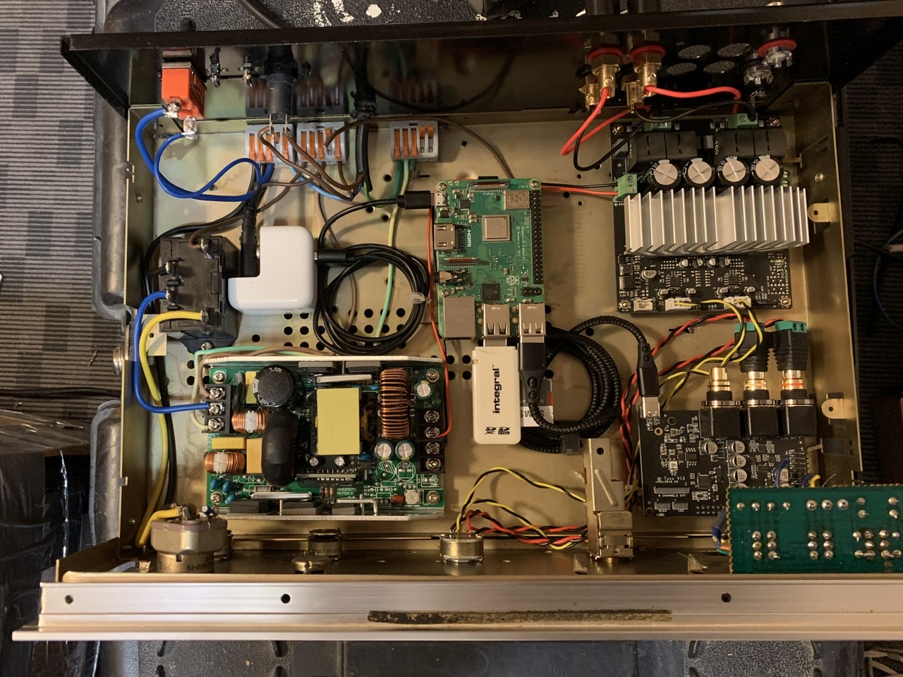

My amp case was too small and was getting really warm so I found this 1976 Trio KA-1500 on eBay which was only working on one channel for £28. I used the Trio power switch and LED as well as the pots to mount the knobs.
Spec:
3EAUDIO TPA3255
Douk 400w 48v dc SMPS
Khadas Tone Board DAC
10k SMD DACT type attenuator
RaspberryPi 3B+
iPad usb charger
240vac relay
Toggle switch for the RaspberryPi
Fuse holder
4xSpeaker Terminals
2xRCA sockets (not used yet)

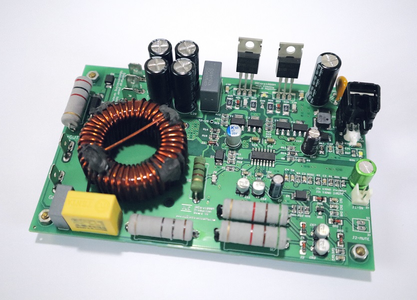

Just another IRS2092 module
±75V Class-D Amplifier
IRFB4227
IRS2092
FZT853/FZT953 gate buffers
Output inductor can be replaced by agp4233
2Ω load capable
IRFB4227
IRS2092
2Ω load capable

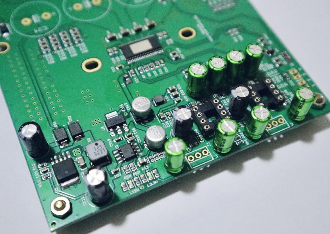

JLESTERP > what about your new TPA3255 with PFFB support ?
can't test it yet, voltages are good but not enough parts to test for performance. Here's the pic.

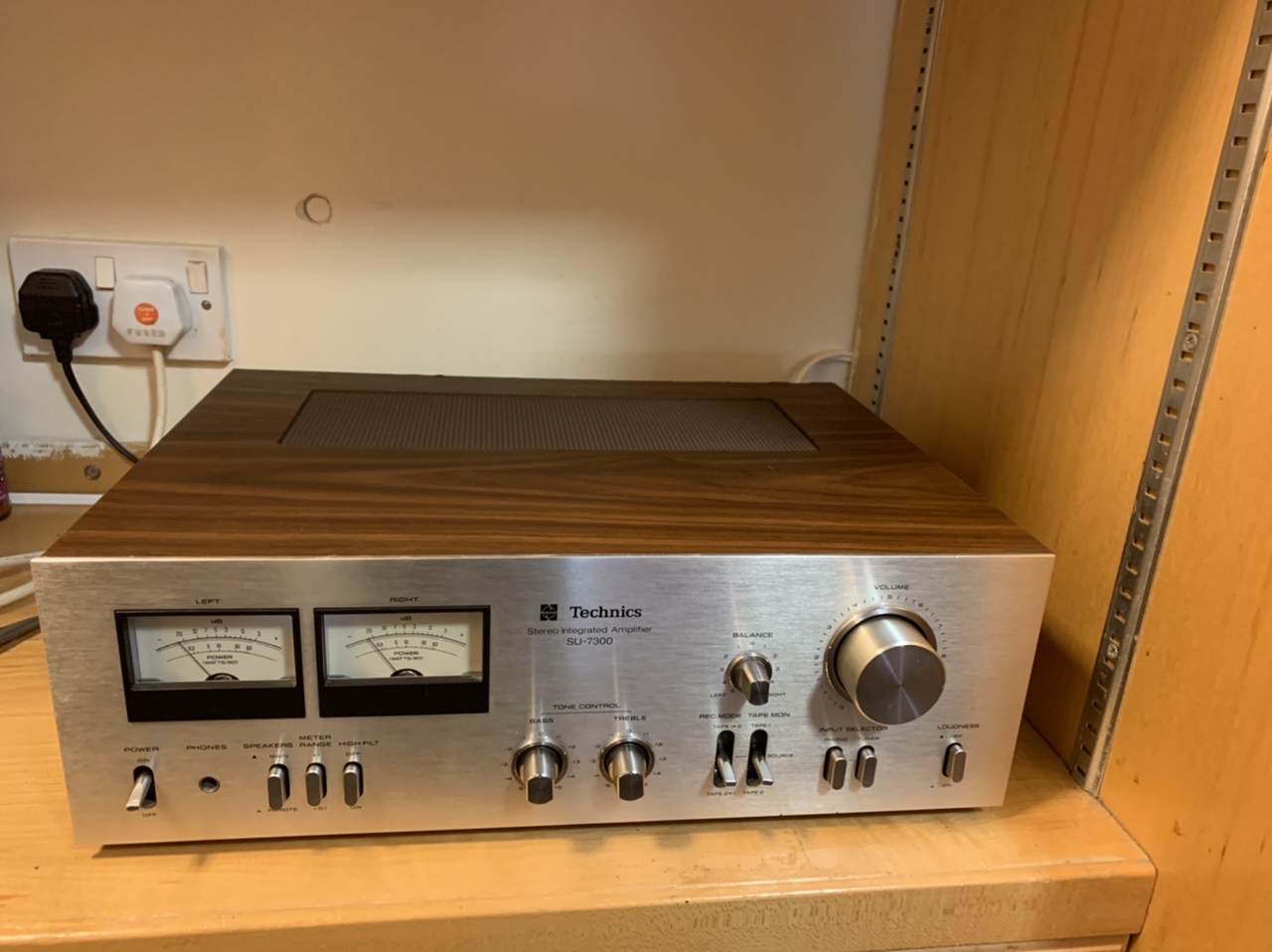

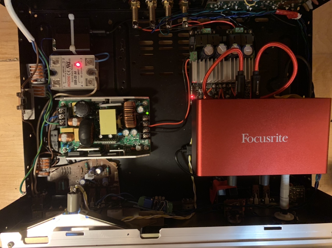

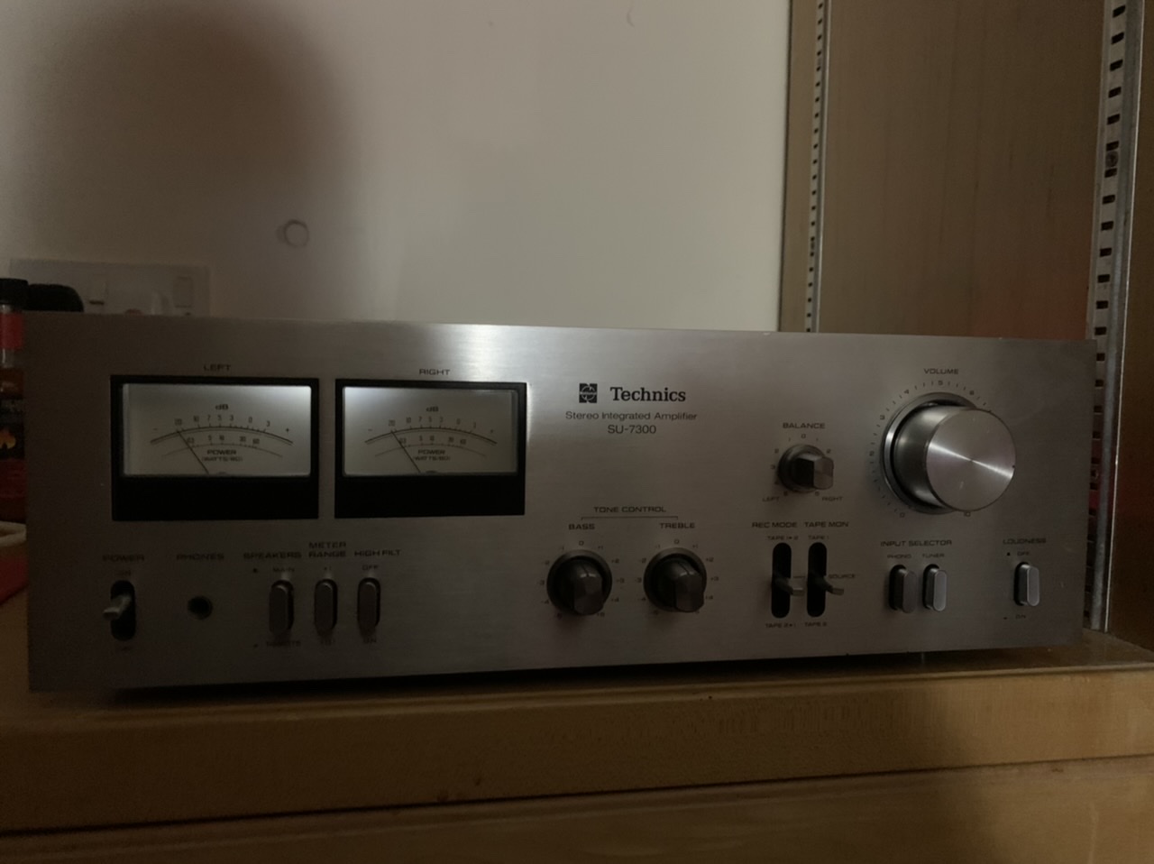

Here is my latest project. The VU/Power meters work but they need about 80w to really get moving. The power switch and volume are connected. I have updated the speaker terminals. Inside is a 48vdc 400w smps, 240v relay for the smps, RaspberryPi 3B+, Scarlett Solo gen3 balanced DAC and a 3eAUDIO TPA3255 with an opamp bypass.
I think it looks and sounds great. I would like the power meters to work differently so they worked off the source, just moving to the music even at low volume.

Very cool! I'm doing something similar but using an old tuner (couldn't bring myself to sacrifice a classic amplifier)
That came out very nice. Are both of those power supplies needed? Could you get away with a single rated for both?
