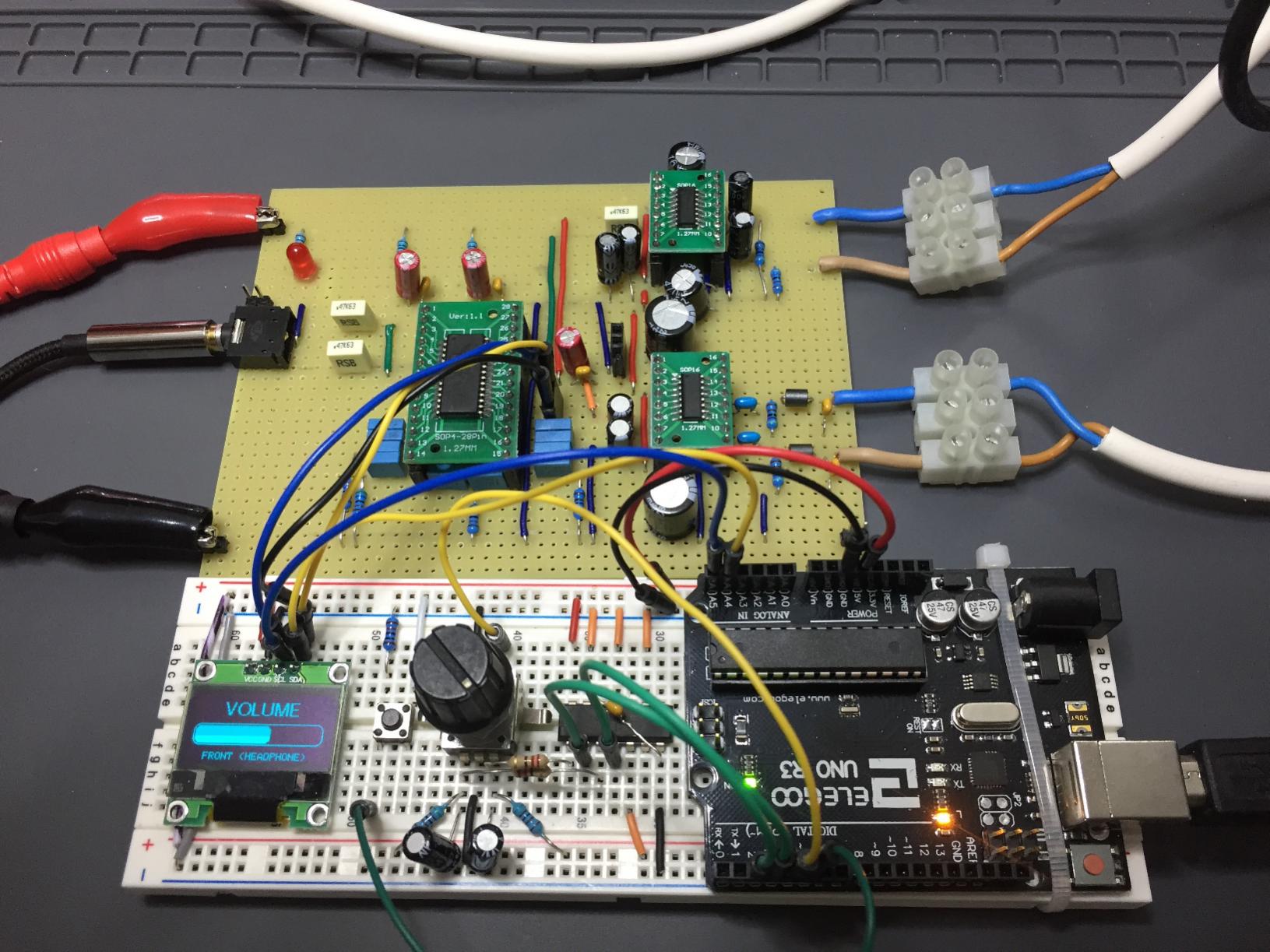

Hi. I'm new to the forum.
I'm building an amp using two PAM8320 mono 20W class D amps, with a TDA7439 audio processor for input selection, volume and tone control (driven by an Arduino I2C interface. I coded all the Arduino front-end myself).
Currently in prototyping on some perfboard & a breadboard. Experimenting with supporting components, hence the differences in the left and right amp sections. Sounds pretty good TBH, powered by my bench power supply with 9v at the moment.
Next up, is deciding on a PSU. I like the aesthetic of a linear supply but may add a 12v switching regulator afterwards to keep things stable. The digital side will have linear regulators (9v and 5v) as they both draw very little power.
I'm a newbie, so please be kind 😀
