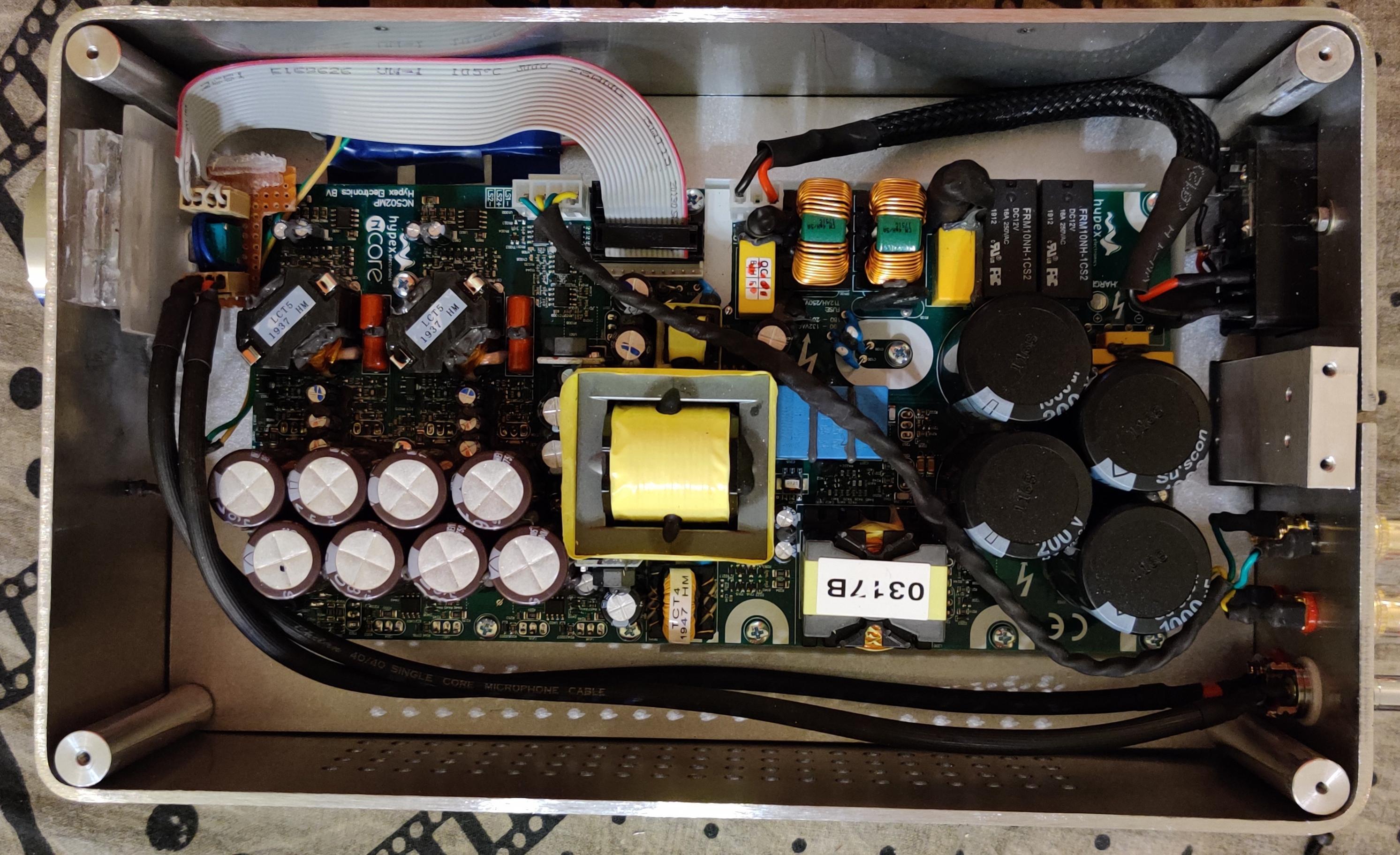

Hi all,
I'd like to present my latest class D amp build. At the core, this project was based on member xrk971's newest class D amp board. This board is based on the TI TPA3255 chipamp. The specifics of this amp can be found over at this link. The amp board is available as a bare PCB, or as completed PCB in his Esty store.
The Hardware --

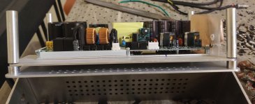

The TPA3255 chip itself is mounted upside down on the underside of the board to make mounting to a chassis a good option. Of course, there are other options to raise the board, traditional heatsink, fan, etc. could be used for cooling as well. What worked well for me was to use a 130mm x 44mm x 6mm piece of aluminum stock, bolted to the chip via the PCB using thermal pad/tape to the bottom of the enclosure. The whole amp assembly secured with 6mm brass standoffs. Note: The heatsink MUST BE electrically isolated from the chassis.
For the PSU I used a Connex SMPS600RS. This is 48VDC single rail SMPS with available auxiliary voltage of +12V. The 12v was necessary for 2 additional boards I used in my build - explained next. I have excellent success using the Connex line of SMPS' over the years in several projects. Highly recommended.
The blue PCB shown attached to the back panel with XLR connectors in the upper right, is the SE to Balanced board since the amp operates natively in BTL (Bridge Tied Load) mode. This allows both balanced and unbalanced (RCA) input connectors. I recently upgraded my heavily modded ES90938Q2M DAC with Balanced outputs, so wanted that capability.
After testing on my bench, I found that the SMPS600 and the amp did not play nice together due to excessive amount of inrush current from the SMPS to the amp. A different kind of soft-start was required, since the SMPS already had a soft-start built-in. What was needed was an inrush current limiter circuit between the SMPS and amp. I contacted xrk971, and with his help, an inrush current limiter PCB was born. It will be offered in his Esty store in the future. The prototype I tested worked fine and I was able to complete the project build. Note: This appears to only be an issue with some models of SMPS' and the amp. So if you're building this amp, please try your intended SMPS first, as it may work fine. xrk971 confirmed it worked with a different model of SMPS from Connex he used for testing. So this simply may be a one-off obscure occurrence. In fact, it worked with a lower voltage/power SMPS I tried as well - without the inrush current limiter circuit being necessary. The Inrush Current Limiter circuit is powered by the SMSP auxiliary 12v output.

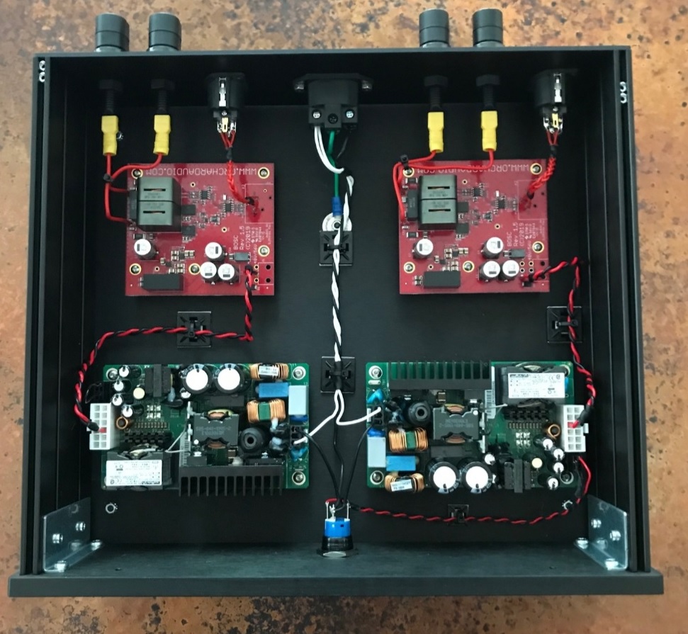

@orchardaudio The SMPS modules in this amp look very compact. Do you know who makes / sells them?
Good question ) let us know
